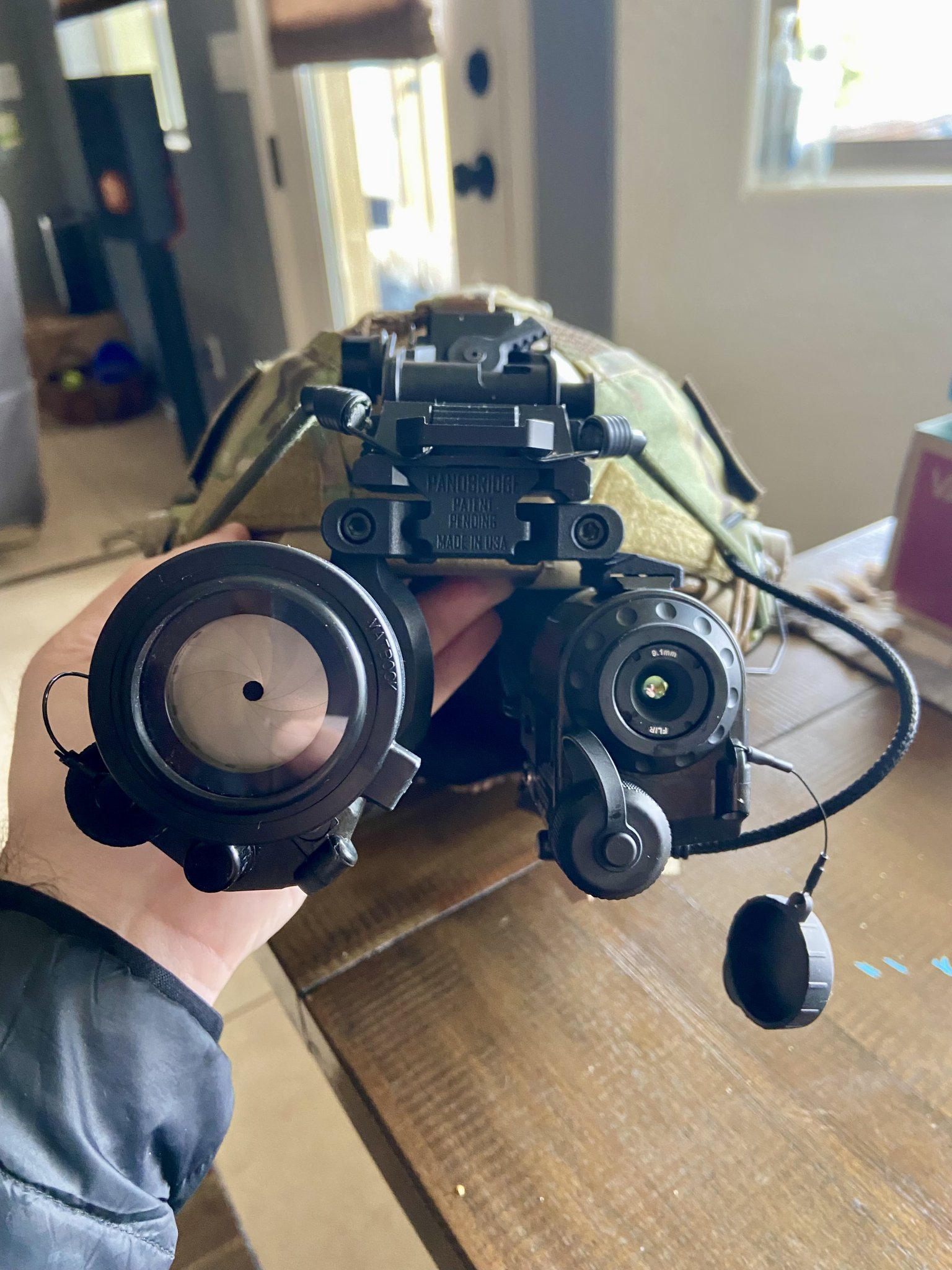

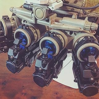

I run the breach and pvs14 and really like it, seems to work well for me. I have the breach on my left eye and pvs on the right. I shoot right handed and close the breach eye when shooting with the laser mounted on the rifle. It isnt exacly overlayed like everyone was saying. My jackrussel looks like a dog and a half when i am watching him run around. Its not a big deal for me, I kill shit all the time with this set up.
You have to work on the brightness to get them set right.
I run a nox18 with a WP pvs14. Like has been mentioned, it really depends on the person and don’t set your expectations too high. I originally imagined the images fusing together really seamlessly but they don’t.
You can use the gain on the pvs to help determine which eye is going to be more dominate at any given time. When walking I turn the gain up a bit and I mostly see the NV. I can get enough data to see a hot spot so I turn down the gain and can better see the thermal image.
It takes constant work and isn’t what I’d consider “comfortable” on the eyes. It does add capability though so just keep playing with it until you find something that works for you.
Set your expectations low so you’ll be more pleased. If you think it’s going to be like fusion you’ll be very disappointed.

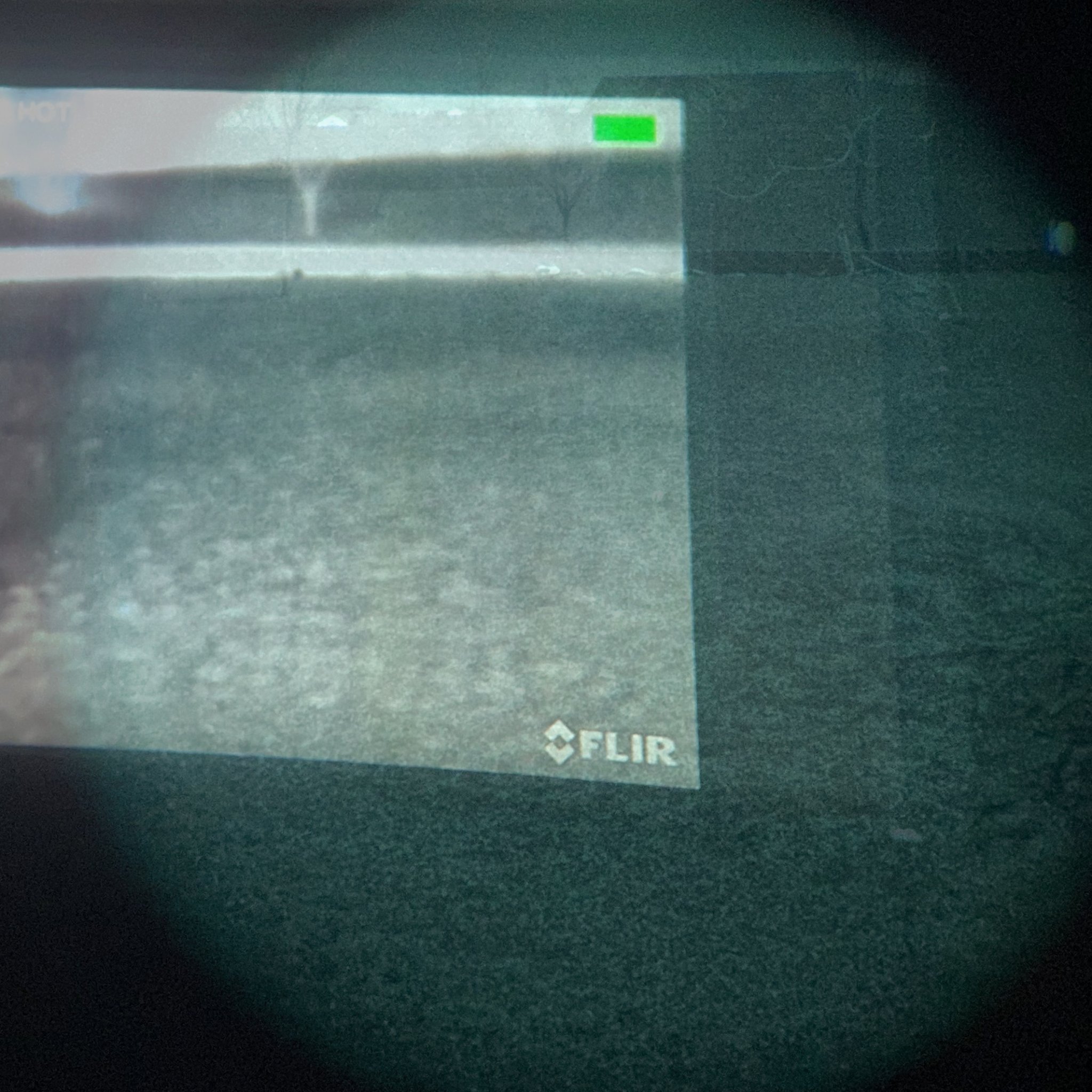

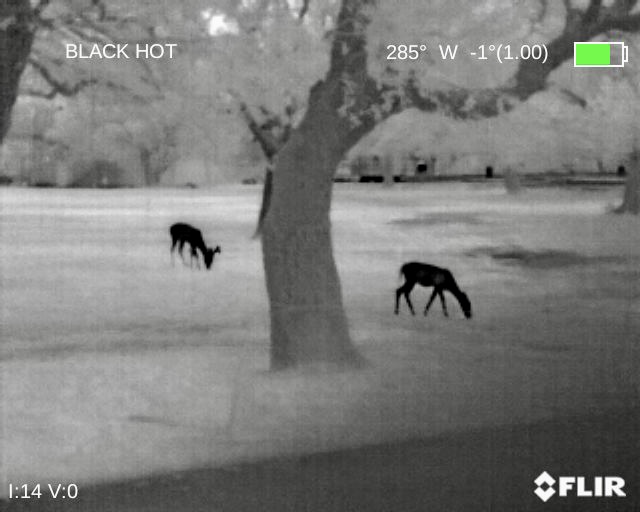

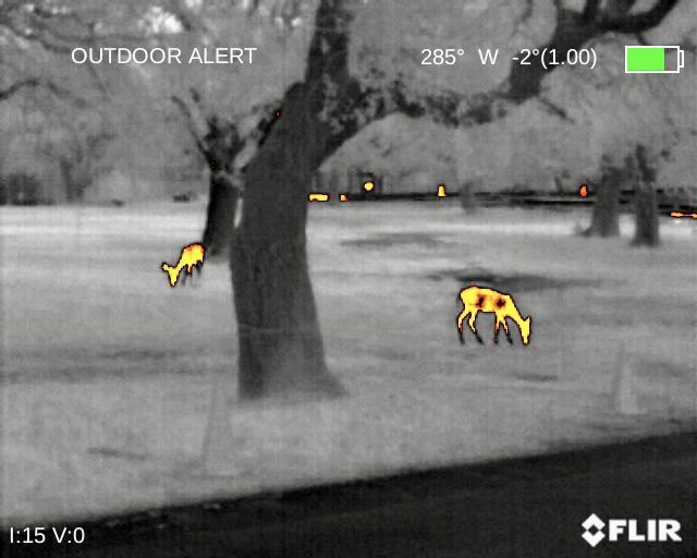

I regretfully have to agree with this. I wanted badly to like the breach and actually think the build quality of the housing is excellent. However it’s ability to detect and differentiate between hot objects made it near useless for me. I require a thermal that can be used in the city if need be, and the breach is mainly suited for detection in open fields. And even then you really need to dial the settings to each environment get it to do the most basic tasks.
Attached are the very best photos I was able to get. In every other situation it was near unusable, to include detecting a full grown man walking on asphalt at 100 yards. People were basically invisible to the breach if they were on warm asphalt or near warm objects like vehicles and concrete.
These deer were at 35 yards roughly. It would do much better in a cool/dry environment with open fields. The breach works great at distances in which you are already able to see and identify with the naked eye. These photos probably do it too much justice. It took about an hour messing with settings and finding a perfect place and large enough animals to actually work

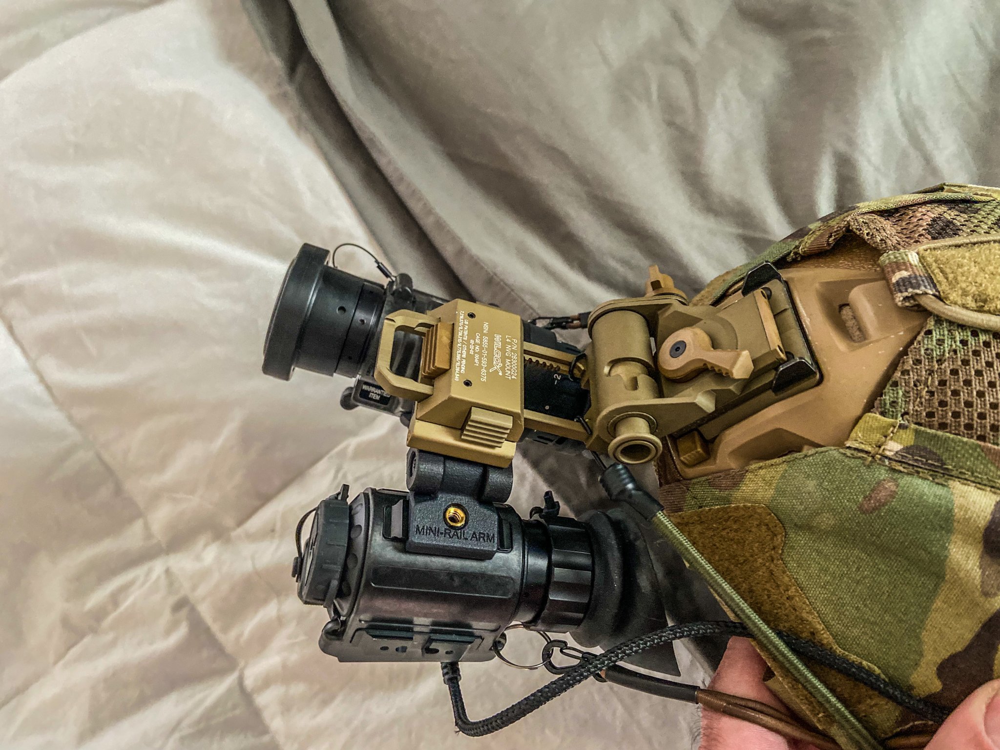

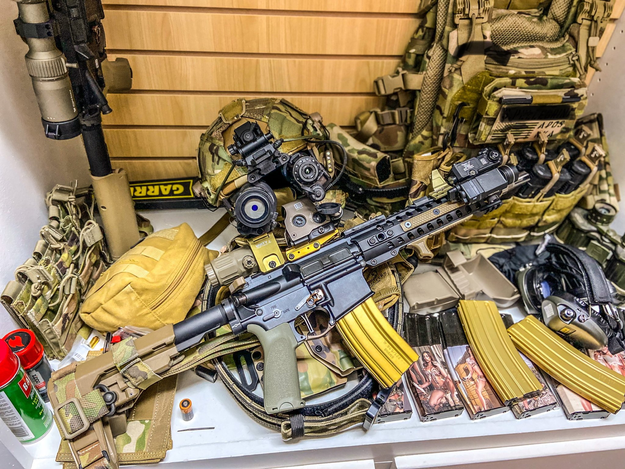

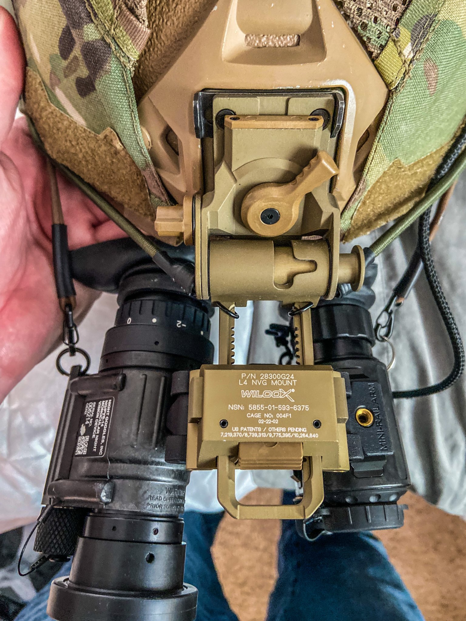

I run a PVS-14 and a FLIR Breach, it has Pro's and Con's like any other setup. Unless someone has the setup please don't take any advise from them.
Pro's:
- Greater capability to see organic targets that night vision doesn't detect.
- When properly mounted and centered your eyes can adapt to blending the images. So people struggle with this but I have no no problems and mine is adjusted prefect with the NoiseFighters Panobridge.
Con's:
- For CQB Dual NVG is better. PVS14 & FLIR Breach shines when outdoors.
- Some people struggle to get good image alignment for image blending.
I have been using my setup for about 9-months now and have no complaints.
- Ballistic Armor Company Ballistic Helmet.
- Wilcox G11 Mount
- NoiseFighter Panobridge
- FLIR Breach PTQ136 w/ battery pack.
- PVS-14 WP
The NoiseFighter Panobridge and a Wilcox mount is really needed to get proper imagine alignment.
