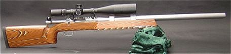

Oh,
for you new kids on the block, no pun intended.
Barrel blocks:
Do not tell me it does not work. It has for YEARS!!!!
John
