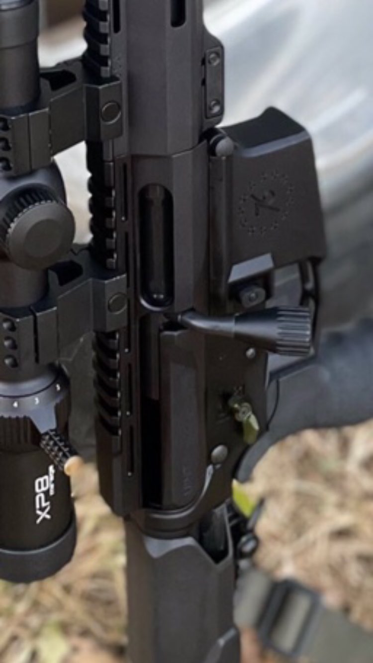

I’ve already added the big bolt knob so at this point I’d welcome a heavier bolt lift if I could get at least close to 100% reliability. A nice bolt lift does me no good if nothing happens when I pull the trigger lol.
That’s interesting about the bolt design though. I’ve not taken mine apart that far, only enough to get the new bolt knob in.

whats the big bolt knob?

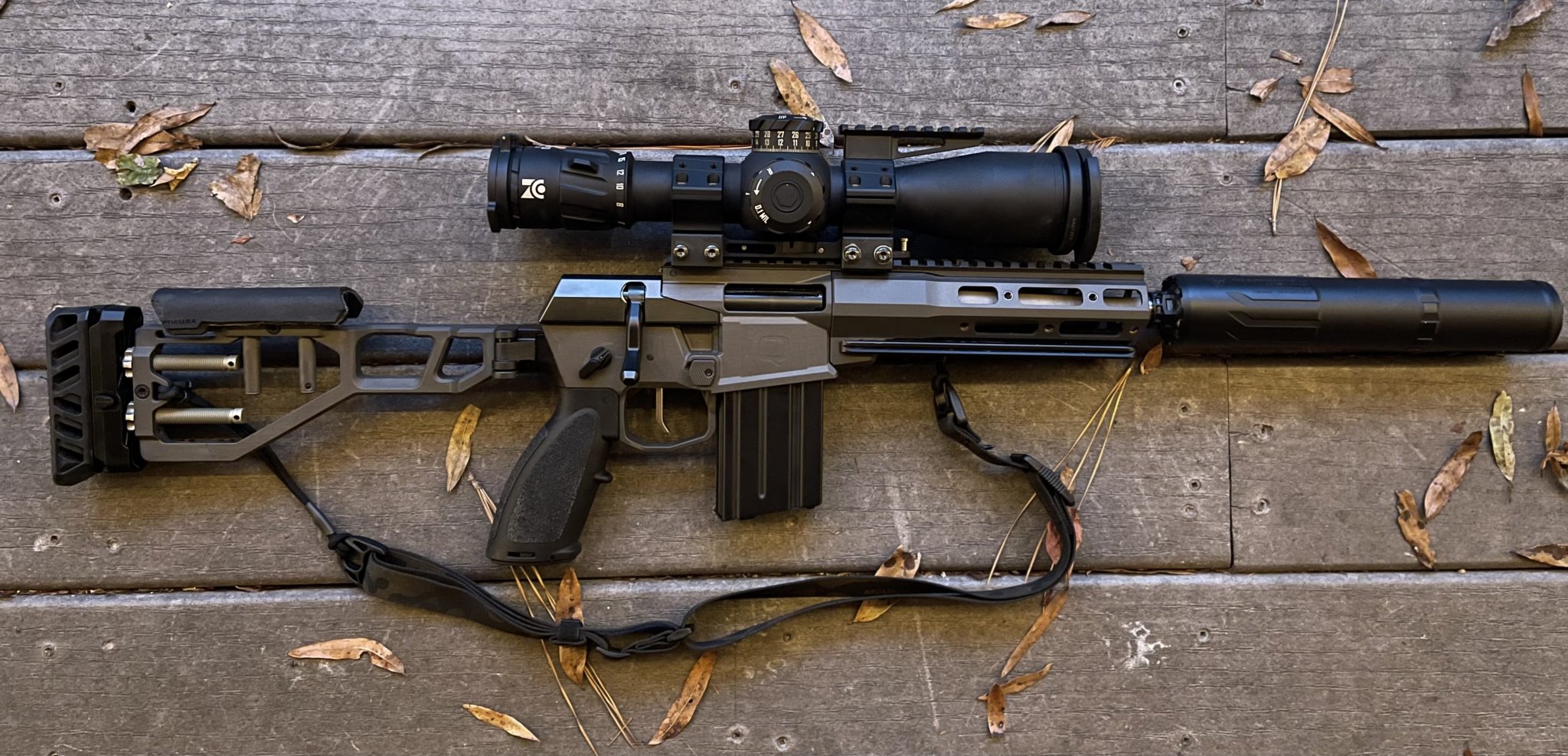

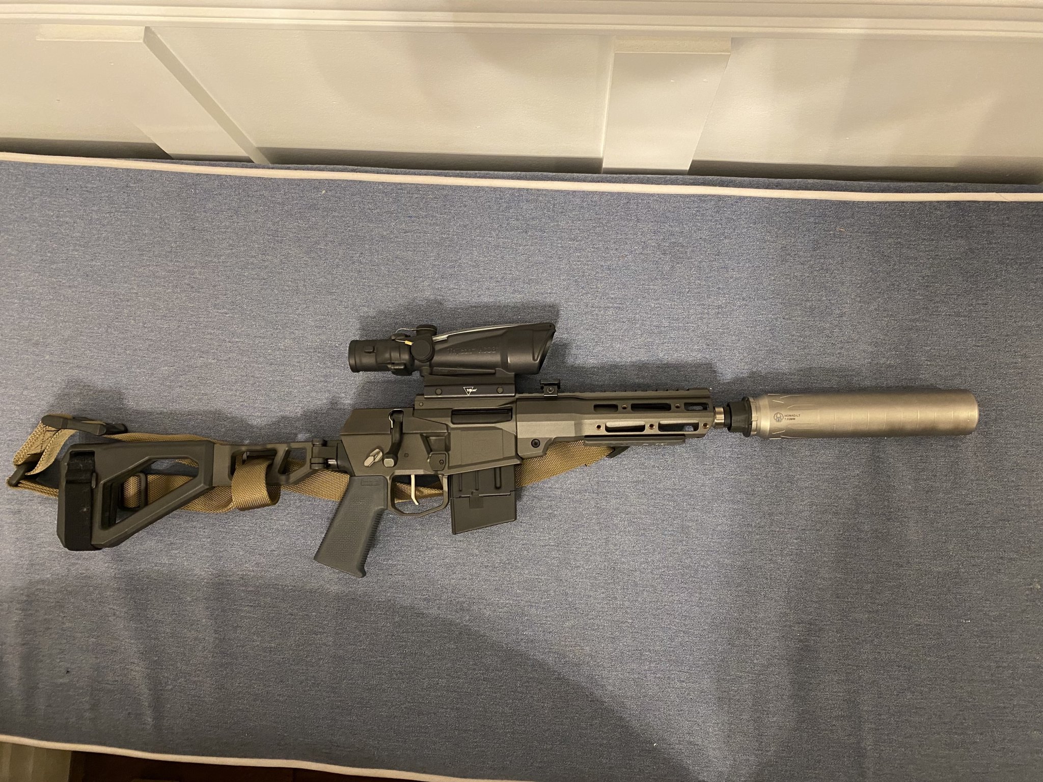

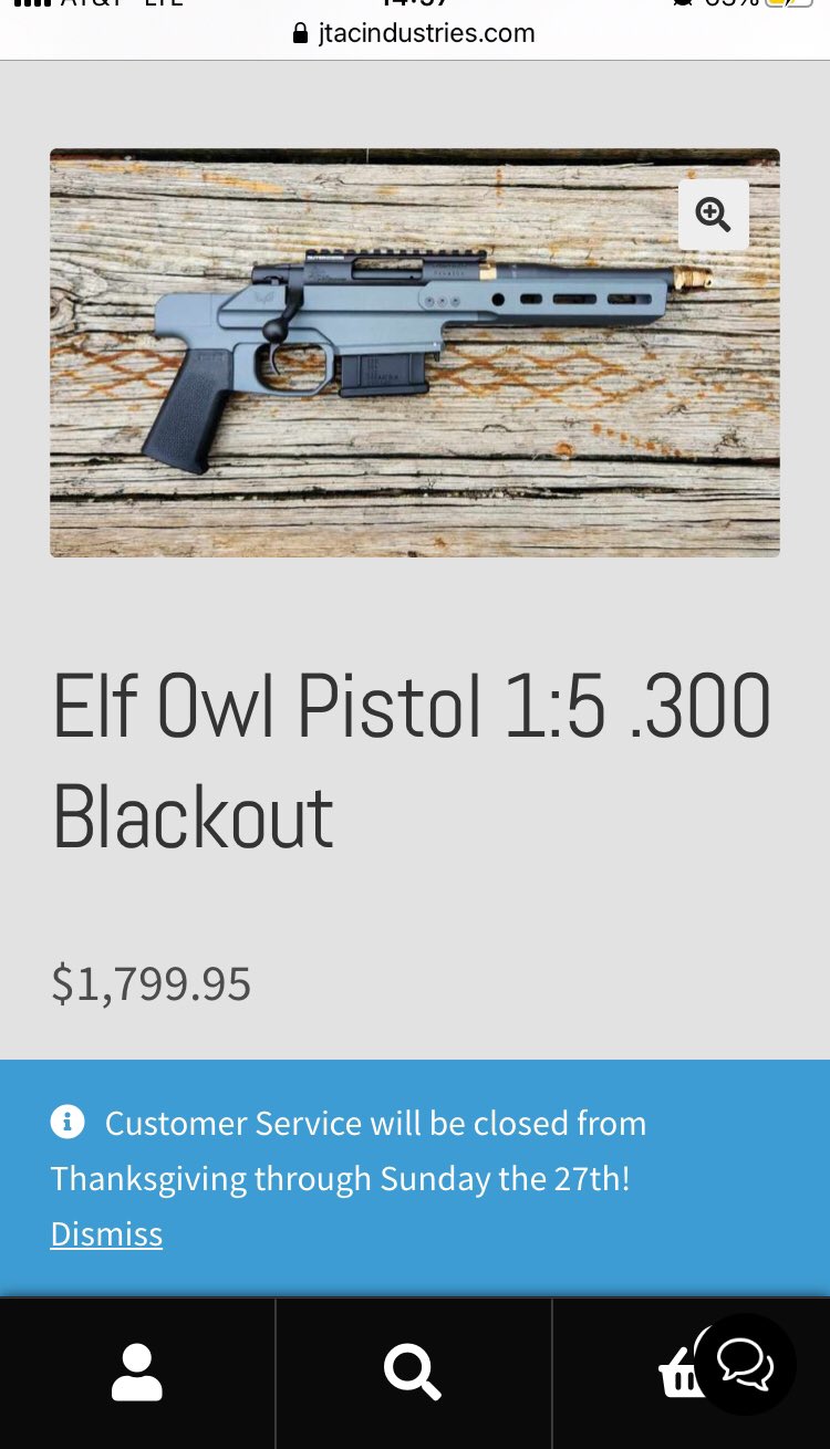

I’m a budget guy. I had a receiver set and a bunch of parts and picked up a Unitah Precision bolt action 300 blk upper. I need to get a small can as got a huge one and it doesn’t fit this purpose. On it is a again something had laying around. It’s 1:7 not 1:5 but it did well with most I threw at it. It killed two deer. Daughter killed a Doe at 110 yards with Maker boars tooth 110 grain supers. The upper was $1000. Probably got $1500 in it. I would buy the JTAC 1:5 Elf owl if I had to do it over.
