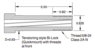

Sorry if I wasn't clear enough in my first post but my barrel has been profiled at the muzzle for this gemtech quickmount. I believe it is a their "tension" mount, the one that slips over the barrel.
If I were to remove it, there would be approx. 1.5" of smooth, turned down barrel between the threads and the shoulder that a crush washer would seat on.
Am I stuck with Gemtech now or could I use something else without cutting off an inch of barrel?

You would need to redo your barrel for a TBAC BA, here's a picture of what you have;
I can't find the exact mount that matches that description. If you could email me a photo of it that might help, or even better unscrew the existing brake and take a photo of what's under it, with a few accompanying measurements.
I haven't tried to pull it but from what I understand, It's about .630" for 1.53" after the threads. That's according to the drawing posted by Eben.

Eben thanks for finding that, I've been searching for a while. I was afraid that would be the case, what to do.....
