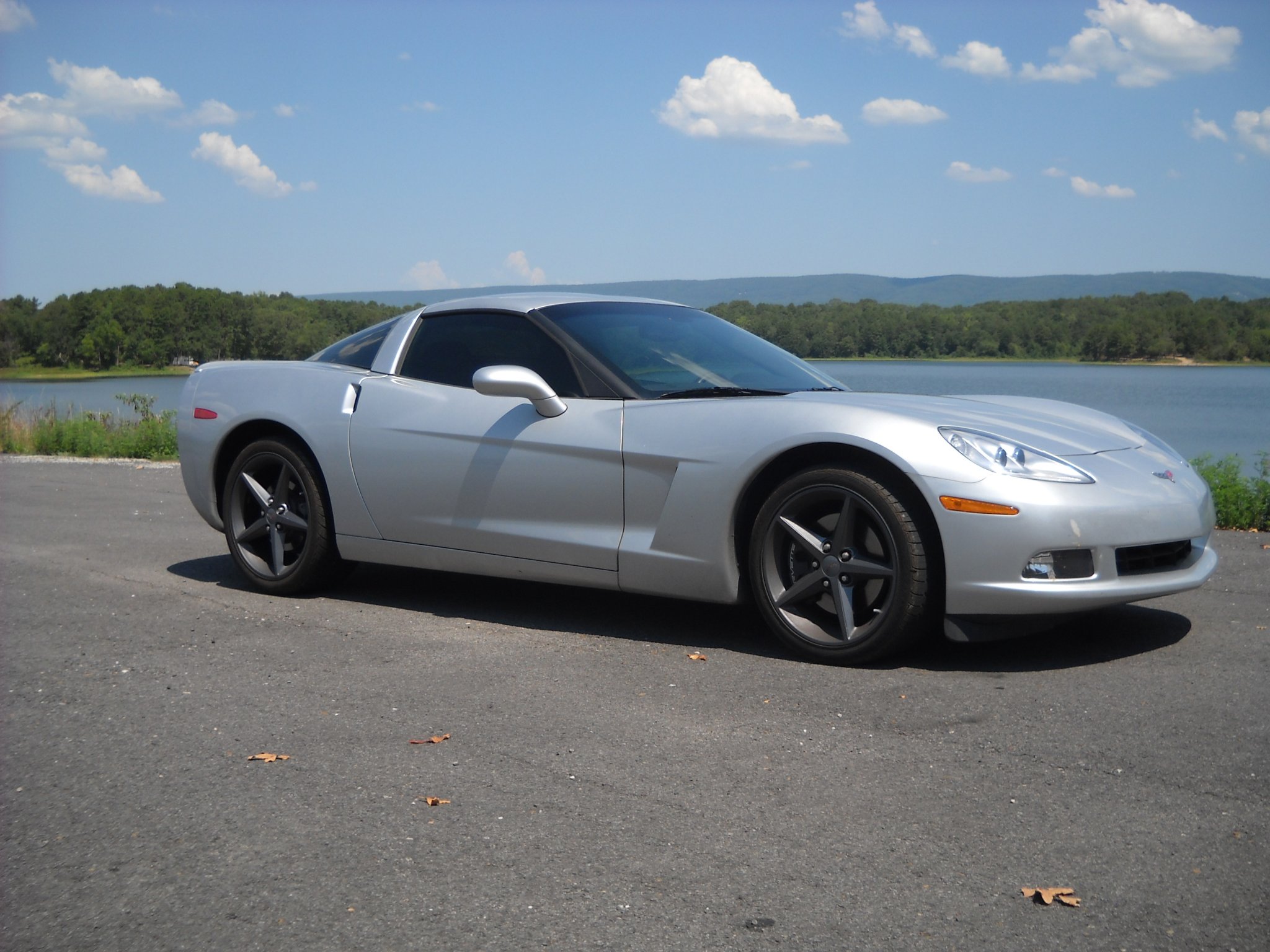

I wonder how accurate the G meter in my vette is. I don’t think I’ve ever seen higher than .76, but I’m on public roads attempting to keep the hooliganism under control. I also don’t want to wreck it because of stupidity.
The HUD in my ZL1 is pretty damn close to reality. Of course, even watching it in the windshield is unwise while approaching the limit.
At 0.76g, you've got a lot of grip remaining, but it doesn't take large errors in corner entry speed to eat up that margin. Combine it with a puddle of fluid, a pothole, some gravel, etc. and things get potentially ugly.

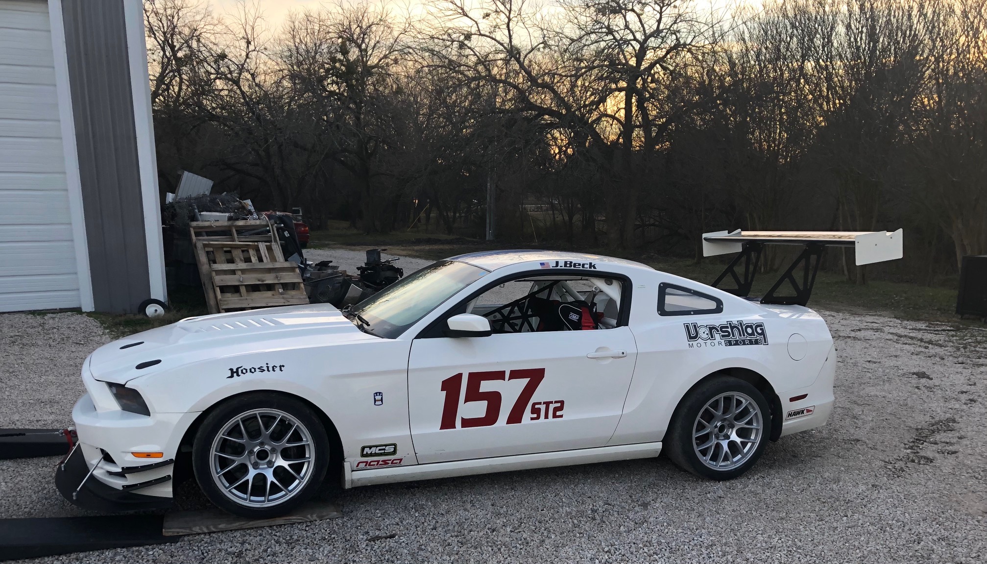

I drive a 2013 Mustang GT throttle limit to get only Max 371 RWHP and Average 367 RWHP. Still a blast to drive. I have training with my coach tomorrow and a race next weekend. I gave up on trying to be fast in my SUV or truck.
