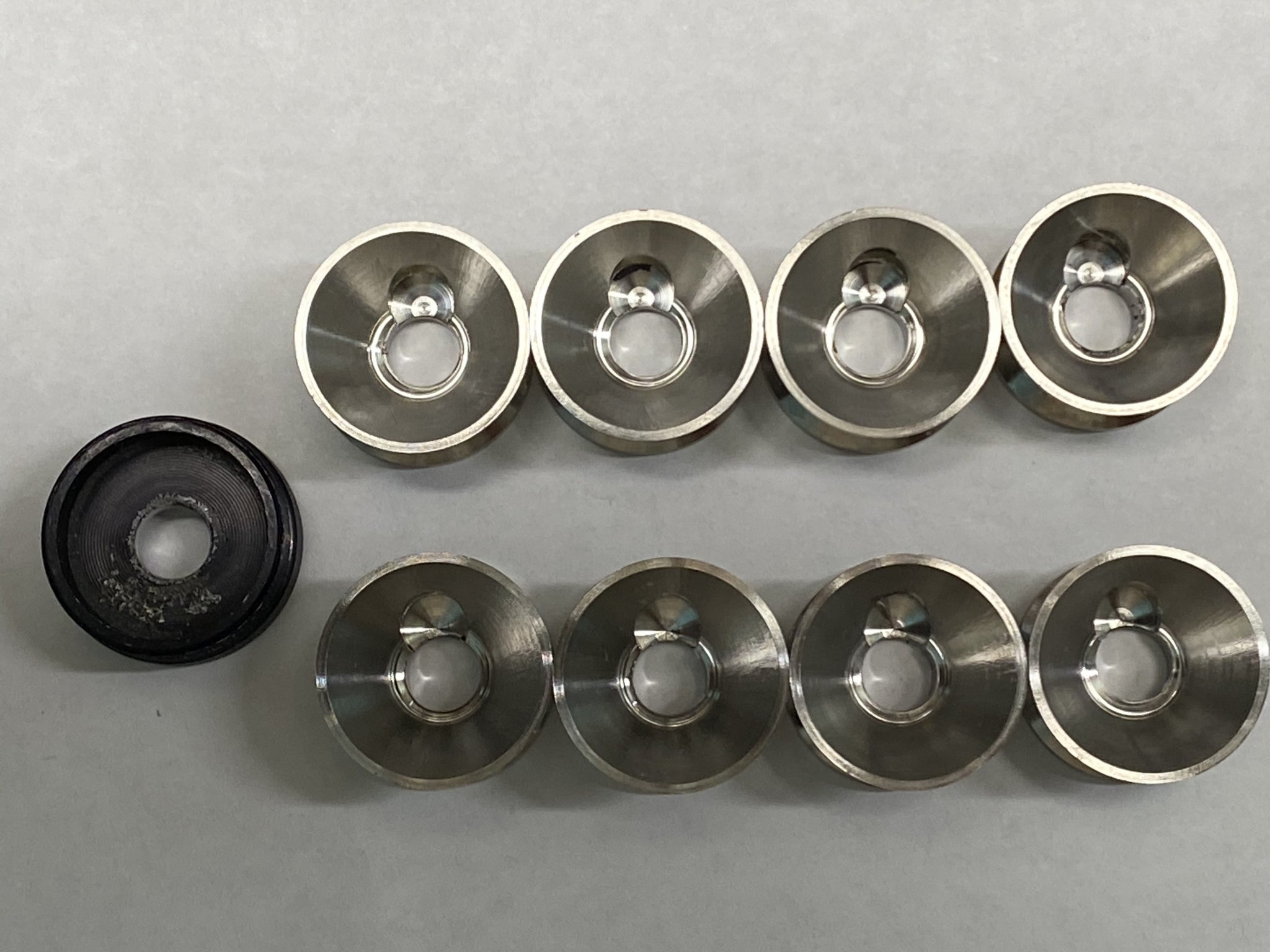

Baffles that are clipped, how do you guys get them to stay orientated in line with eachother? Or do you just have to allow them to end up where they end up? Or are the internals held in there tight enough that it doesn't allow them to rotate?

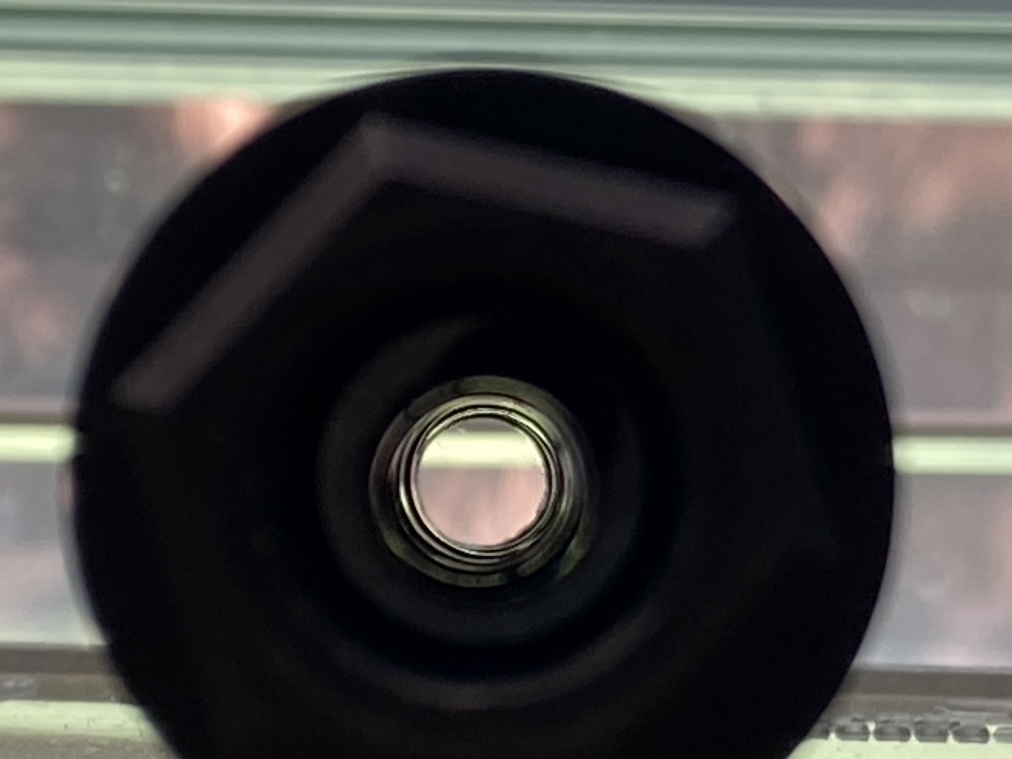

Just cleaned the baffles and they look fine to me. (CLR is great stuff for this) Tried taking a pic down the tube, but the picture sux.
Not sure what’s left to do. Seems odd I’d have to shoot 100-200 rounds to get a can accurate.
