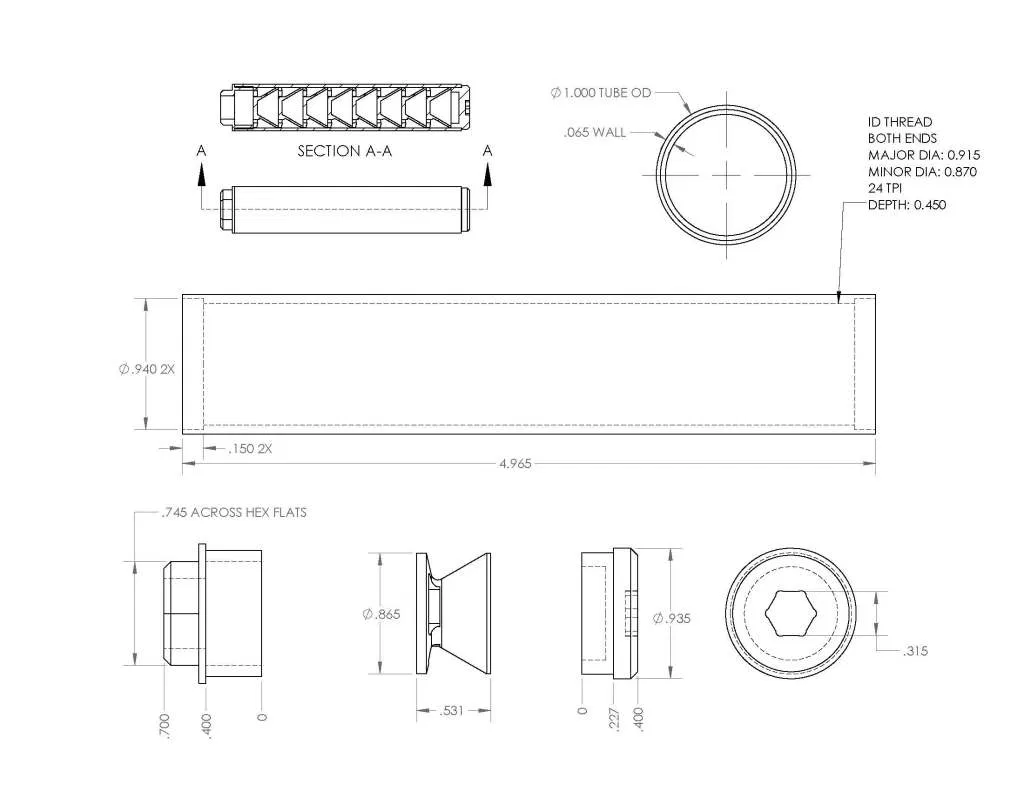

Question for those that have already assembled their kit? .... Also, real stupid question regarding the K baffles. Which direction do they get placed in the sleeve? Small cone side toward the muzzle or large cone side towards the muzzle? I didn't see any assembly instructions come with my kit.
I had the same question and sent an email to quietbore; they responded nearly instantly.
"Dumb question.
I'll be drilling my 22 trap but didn't pay attention to the baffle direction inside. When I put it back together do the baffles go in with the flat side facing or away from the muzzle end?
Thanks"
Not a dumb question at all!
The flat side will go towards the firearm.

I had gone back and looked at the technical drawing on their website and it showed the small end of cone towards the weapon. Its how I assembled the system and I am very happy with how it works.

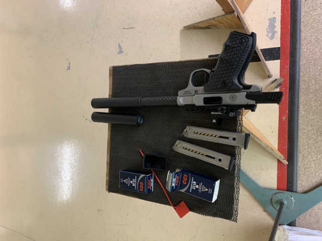

I finally got my 22lr can drilled and put together, today. I tried it on a Bergara BXR and a MK4/45. It worked fine and sounded about the same as my neighbor's Sparrow, maybe a little quieter.

Finally had a chance to run 200 rounds through the qb .22 and honestly I can’t tell a difference between it and my warlock. Now I just need to drill the .45 out.
