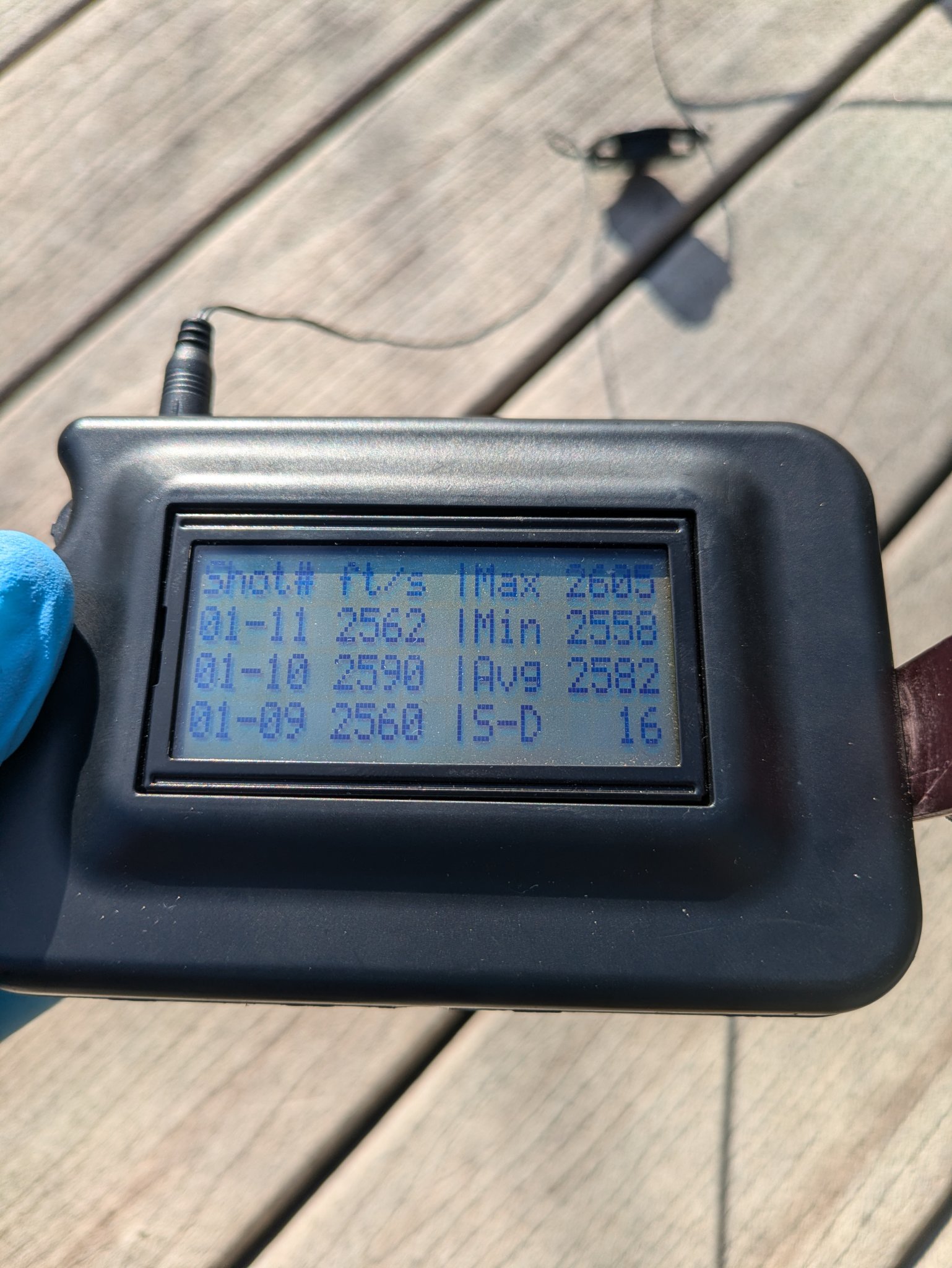

Holy crap that is really, really hot and fast out of a 16". What are you running for a load?
Did it take a while for the proof barrel to speed up and settle in?
Report back if you don’t mind. I’ve spoken with someone who bought an upper and it didn’t include a test target. I’m curious if the uppers share the same performance and accuracy that the rifle marketing shows.
All LPR uppers are made on the same assembly benches, to the same standards. The standalone uppers get pulled prior testing as there are simply to many variables with components outside of our control to bother with, them being standalone sub-assemblies.
99% of the time it should be fine but we definitely stand behind our concept so even in that 1% scenario we’ll do our best to help you out.
Obligatory warning I am just another idiot online who may reload while drinking so take the load for what its worth.
LC Mil Brass
CCI 41
25.8gr Ramshot Tac
77 smk
2.300 COAL (Yes still feeds out of mags)
QL has it at about 65000psi
Barrel took about 200rds to really settle in.

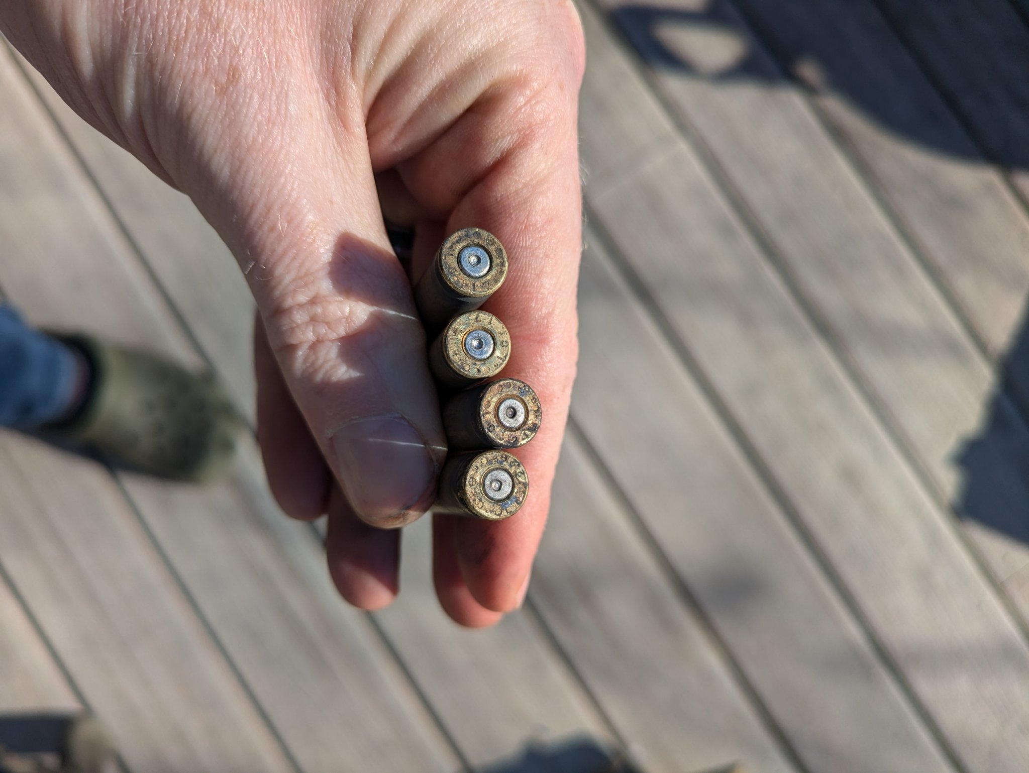

How does the brass look?
Did the barrel shoot accurately out of the gate and just keep speeding up?
How is the temp sensitivity on Tac?
Brass looks fine but in my experience .223 doesn't show pressure signs until it does... So while I've had success loading .223 hot I try not to push the upper upper limits. Extra COAL helps a bit keeping pressure down.

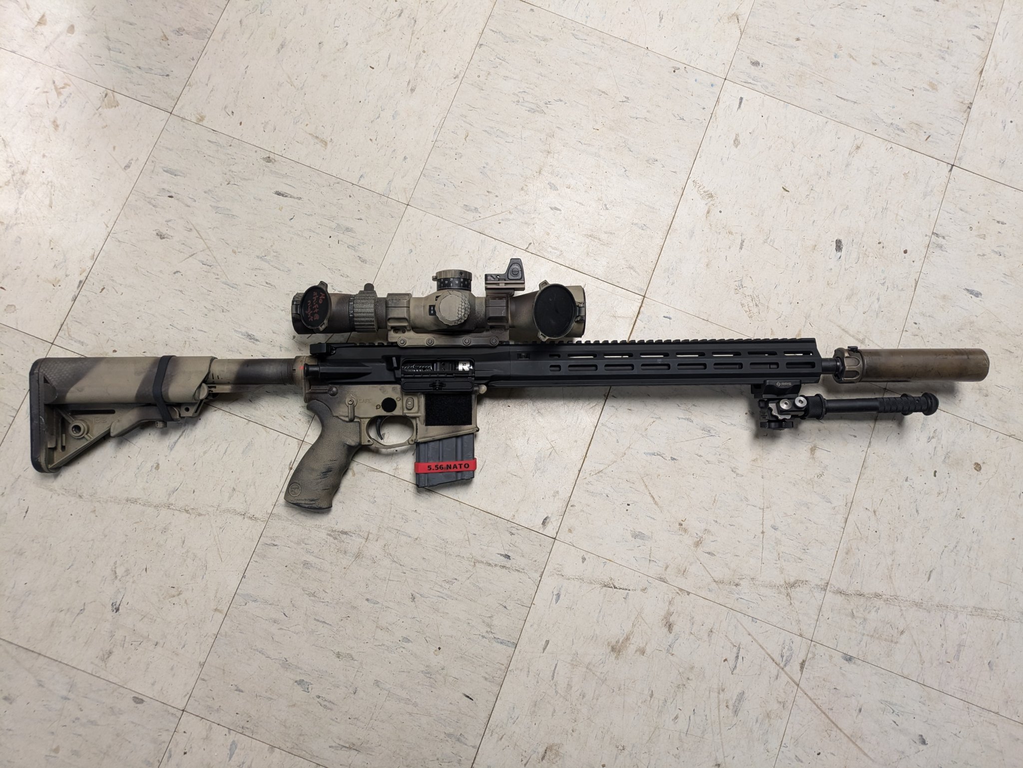

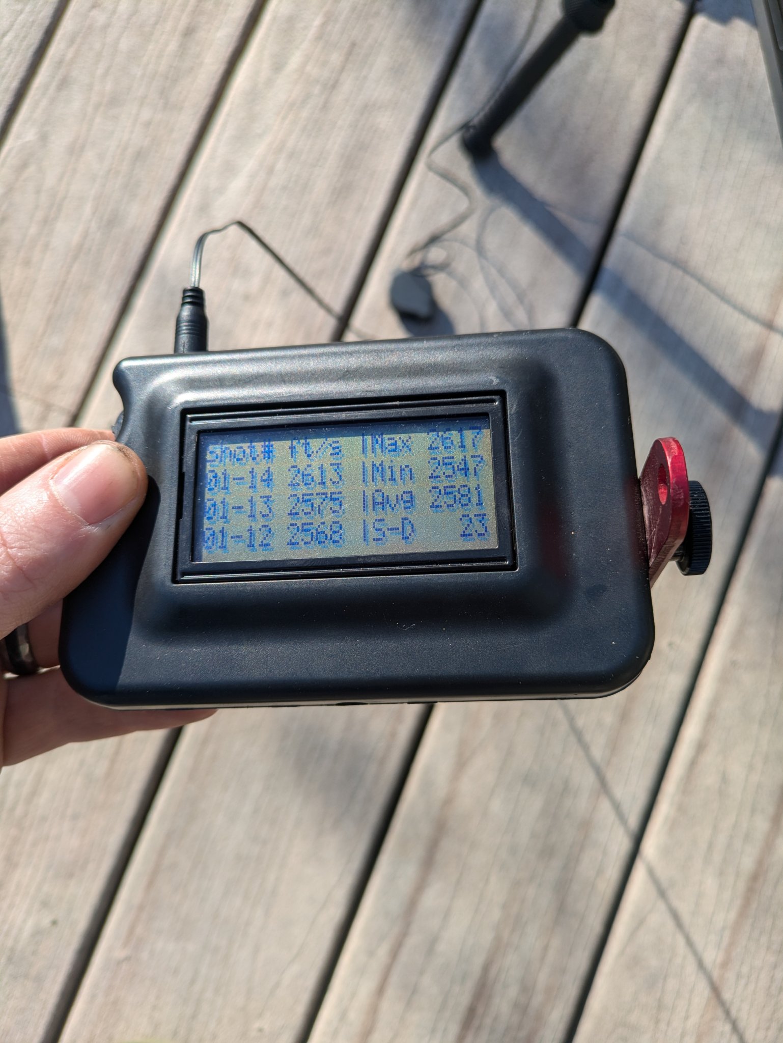

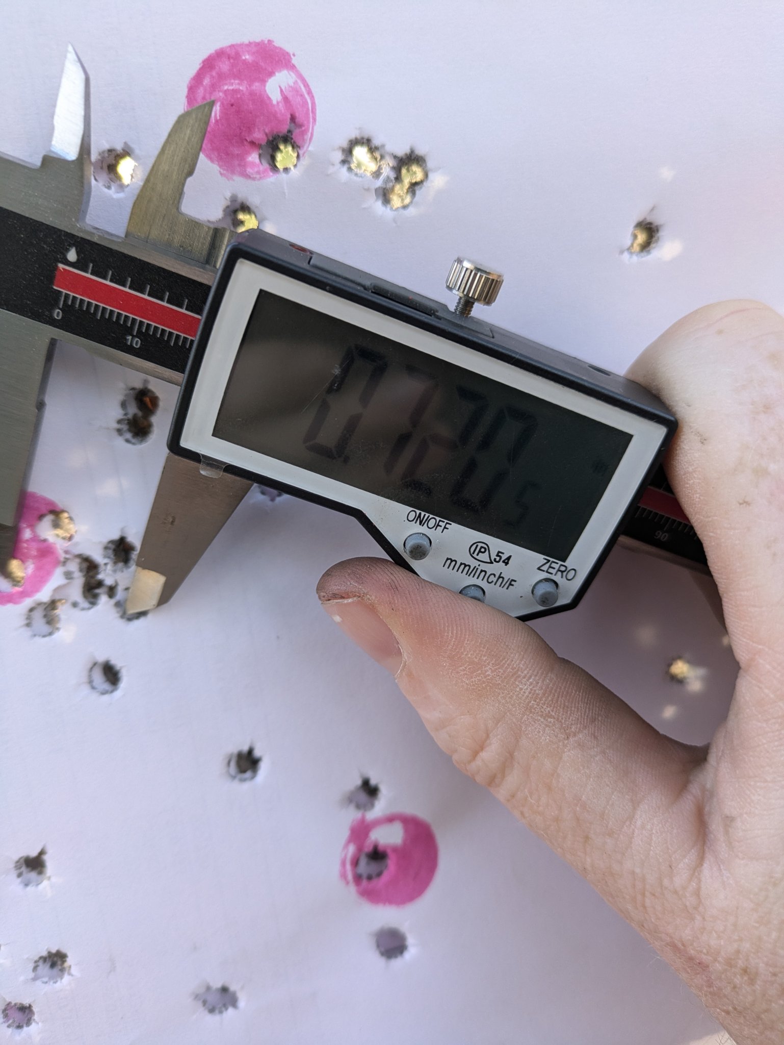

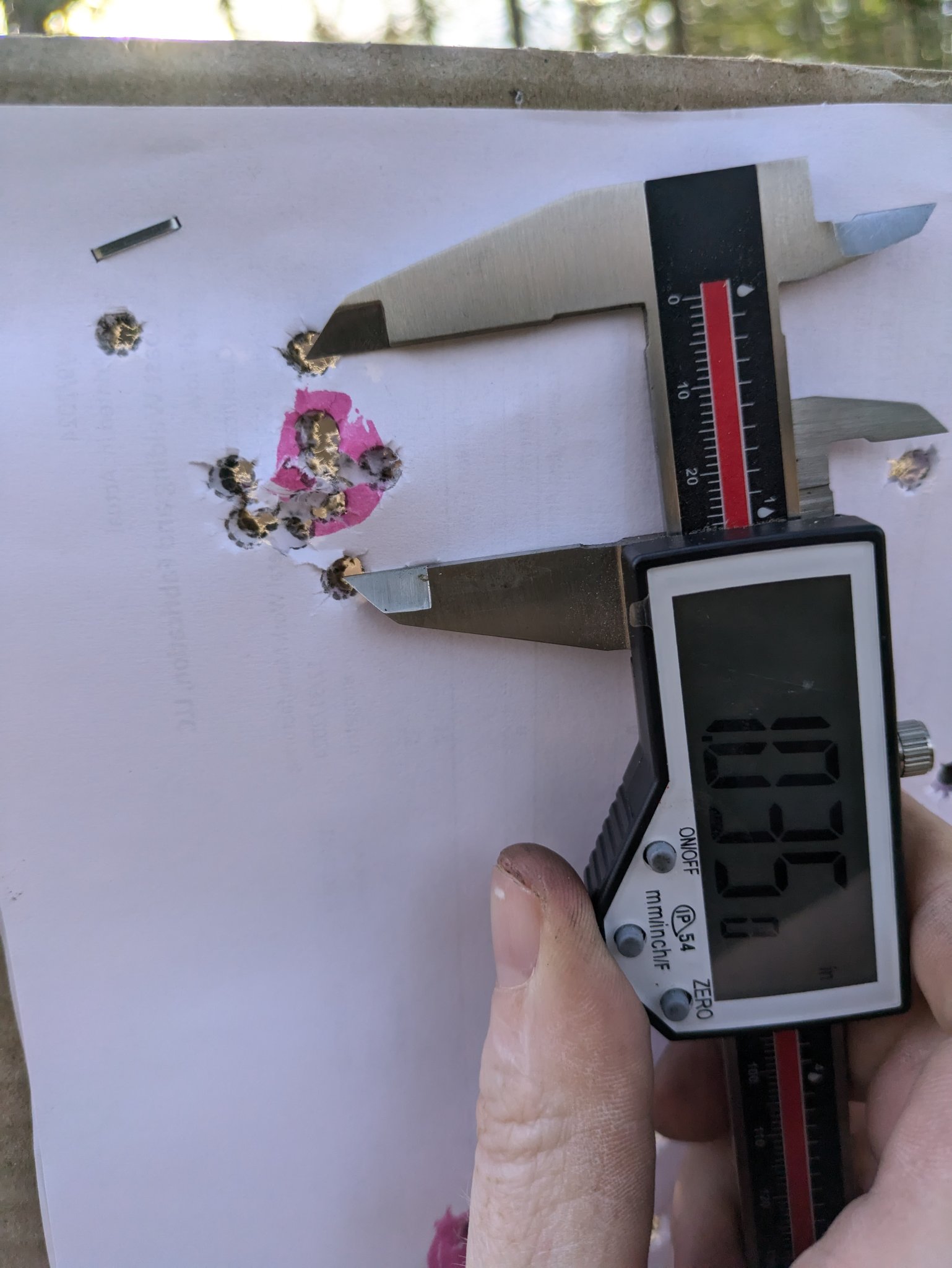

Upper is in and I am really digging it!
The fit with my PRI lower is tight. I mean right. Zero wobble.
It is the softest shooting AR I have ever fired. I ran it with an RC2 and closed time flash hider (waiting on an RC3 and 3 prong). It is as soft, if not softer, than my Mk12 Mod 1 with an OCM5 and BRT reduced gas tube.
I ran my 77 Nosler handloads through (23.8gr 8208 in LC brass with CCI Small Rifle primers). No pressure signs.
The paper was pretty shot up, but I shot several 10 round groups from prone with a bag with each group shot in under 10 seconds. It's a clear shooter. Both groups were 1" with one that would have been 3/4" of I hadn't dropped a round now. That's fantastic for 10 round groups.
The handloads get 2750fps out of the 18" Mk12 Mod 1 Douglas barrel and 2650 of of another 16" Douglas barrel. I chronoed 14 rounds after shooting 50 rounds and got a 2570fps average with an SD of 23. I am hopeful it will speed up and settle in 300-400 rounds. Time to burn some blasting ammo.
I am super happy with it so far.

Round count is now around 100 with the 77gr 8208 handloads plus another 100 of 55gr blasting ammo.
The barrel has not sped up much, however the SD did really start to settle down. This isn't a load I developed for the rifle as I really like to run the same 77gr 5.56 loads through all of my rifles. It shoots 1MOA or slightly better with 10 shot groups and is now producing a velocity of 2582fps with an SD of 16. I will recheck this again in another 200+ rounds.

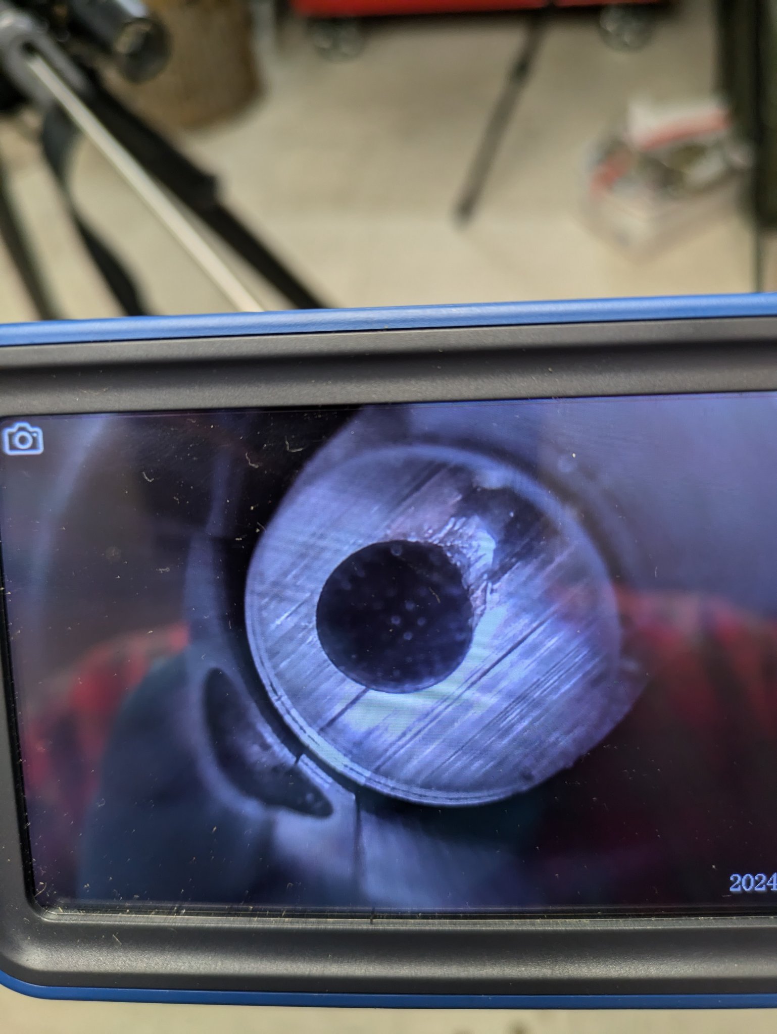

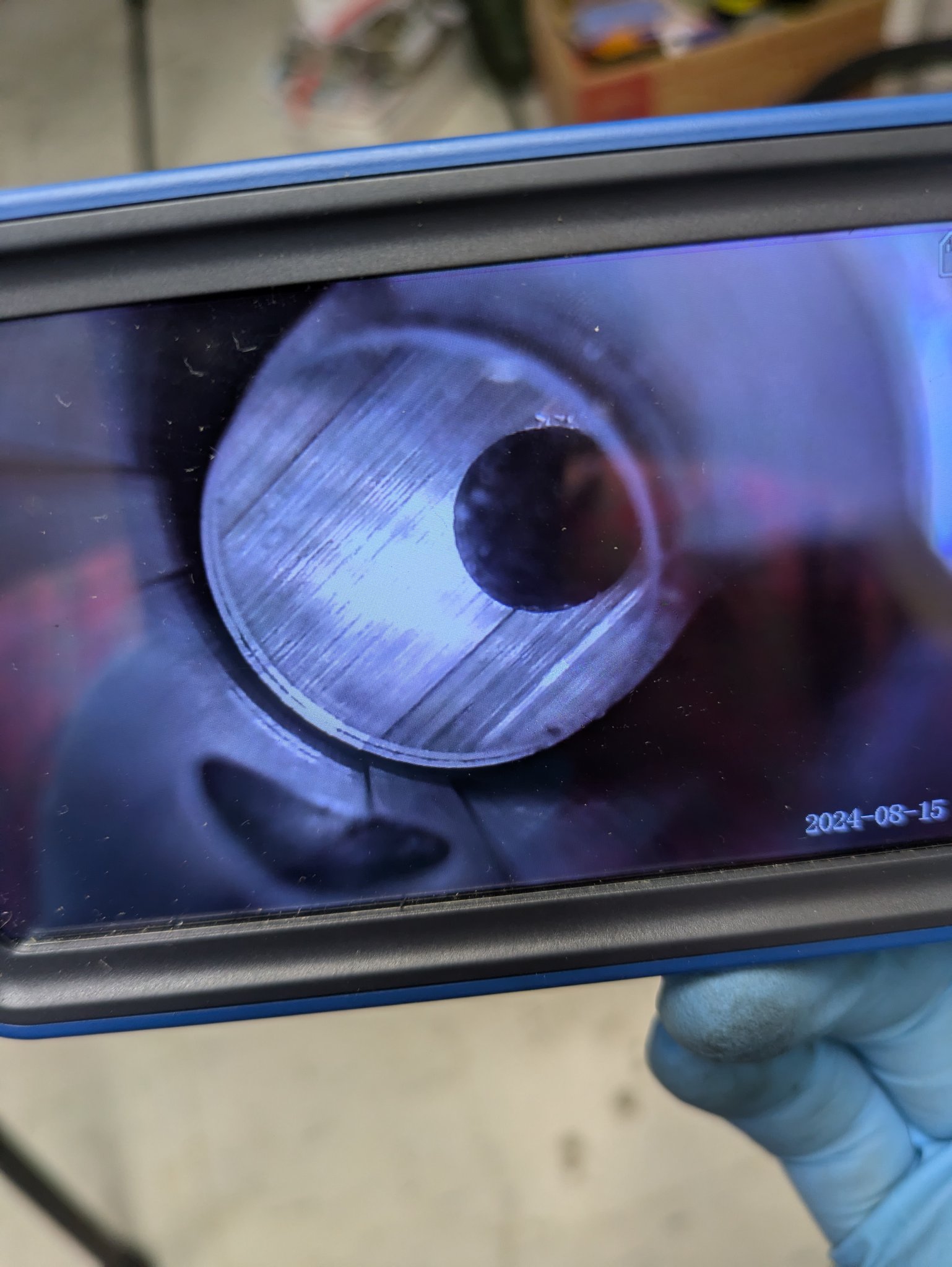

One thing that caught my eye is that the rifling is the lands within the barrel are frankly just rough. I compared it to the Douglas barrels I have (16" and 18") and both are just a lot smoother. Borescopes aren't the be-all-end-all, but I do wonder if that is why this barrel just seems a bit slow. If I can get it to low 2600fps I would be very happy. My 16" Douglas with the same loads is about 2650fps.
Of note, the gas port was not drilled in the groove completely, however neither of the 2 PRI Douglas barrels did that either (the Mk12 Mod1 barrel I think is a 6 groove vs the 5 groove in the Proof). I am hoping that I don't get any weird erosion that could cause issues in the jacket of the bullet.

@NHPiper That velocity is a bit concerning to me. My 12.5" barrel with AAC 77 OTM is 2601 - 2634fps. Granted slower with other loadings. Does your handload have some room for extra velocity and/or pressure?
It does not, that is the top end of an 8208 charge. it should be getting around 2650fps once it settles. It is definitely slow right now. Several online videos said their barrel sped up by 100fps around 400 rounds in.
Reactions: matt33 and PBWalsh
My previous barrel appeared to speed up around the 500 round mark. Hopefully yours does as well.
Reactions: NHPiper
