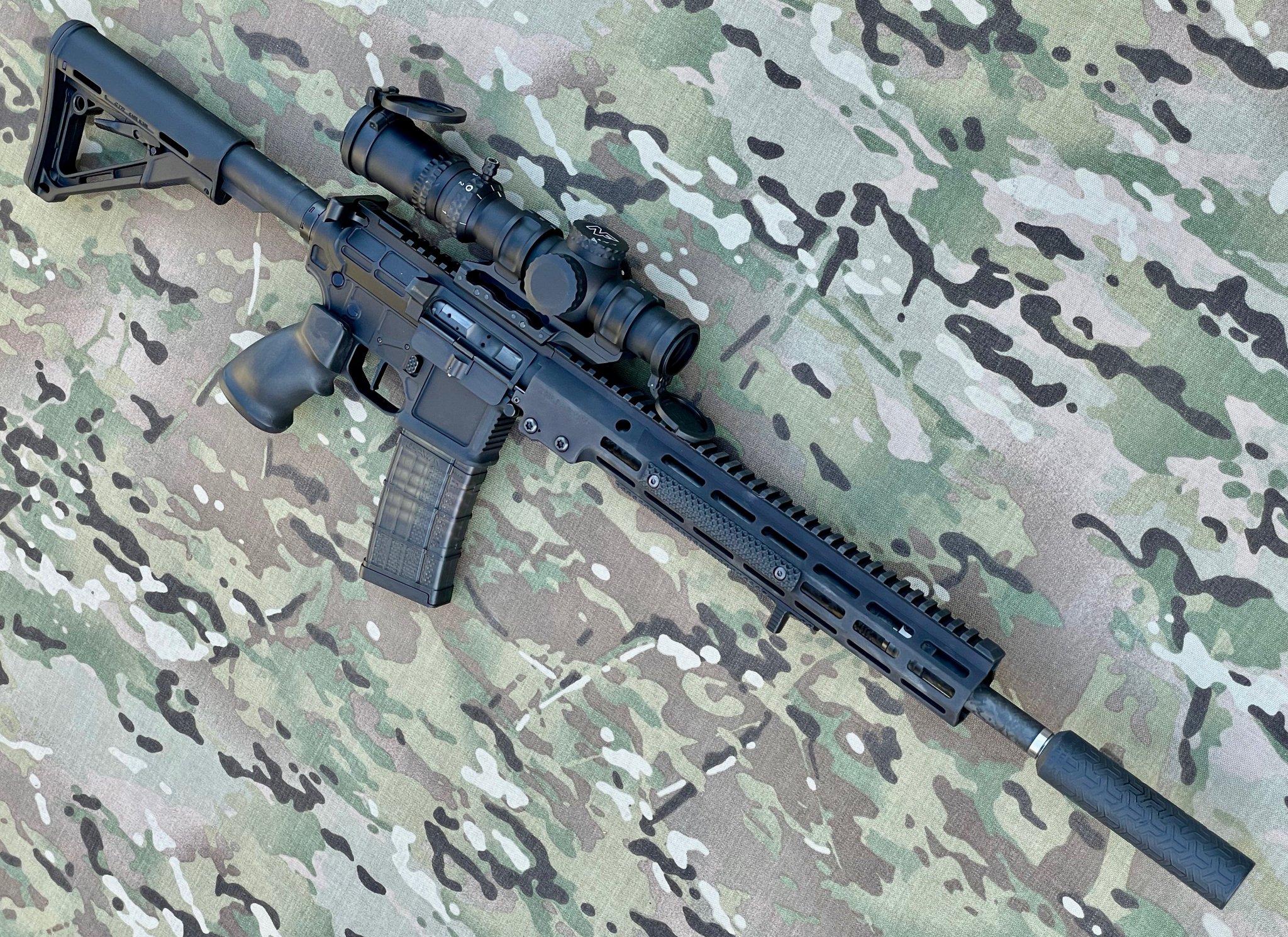

The first is a 16" Recce format with Proof Research CF barrel. The bare rifle weight is quite light in weight, just over six pounds, and with MK 262 Mod 1 I'm getting 2695 fps and consistent sub-MOA performance. That's still over 1300 fps at 800 yards at my density altitude of 5000'. So, yeah, 800 yards may be running up against reality.
This rifle is light, easy to carry and deploy rapidly, and has proven to be 100% reliable. I've enjoyed it tremendously and consider it a favorite.

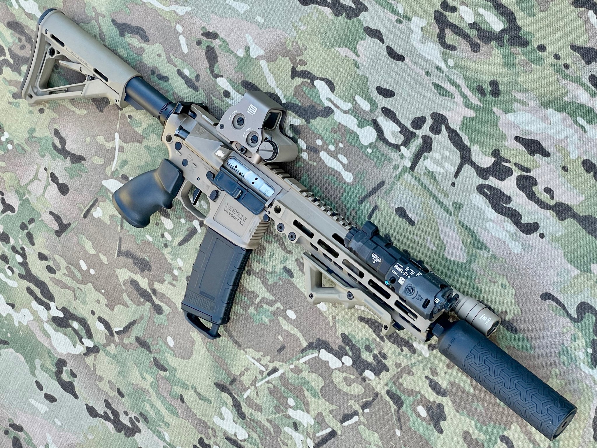

My newer rifle in this category, surprisingly, tops this performance rather easily. It's a 14.5" 6mmARC SBR with a Proof CF barrel. It too is just over six pounds in bare form, provides sub-MOA performance, and is 100% reliable with the right magazines. With Hornady 108 ELD-M, it has a muzzle velocity of 2553 fps, but at 800 yards, it's still doing over 1550 fps! Note the two-tone FDE effect. The lower has been host to multiple uppers in the past. This is its best yet.

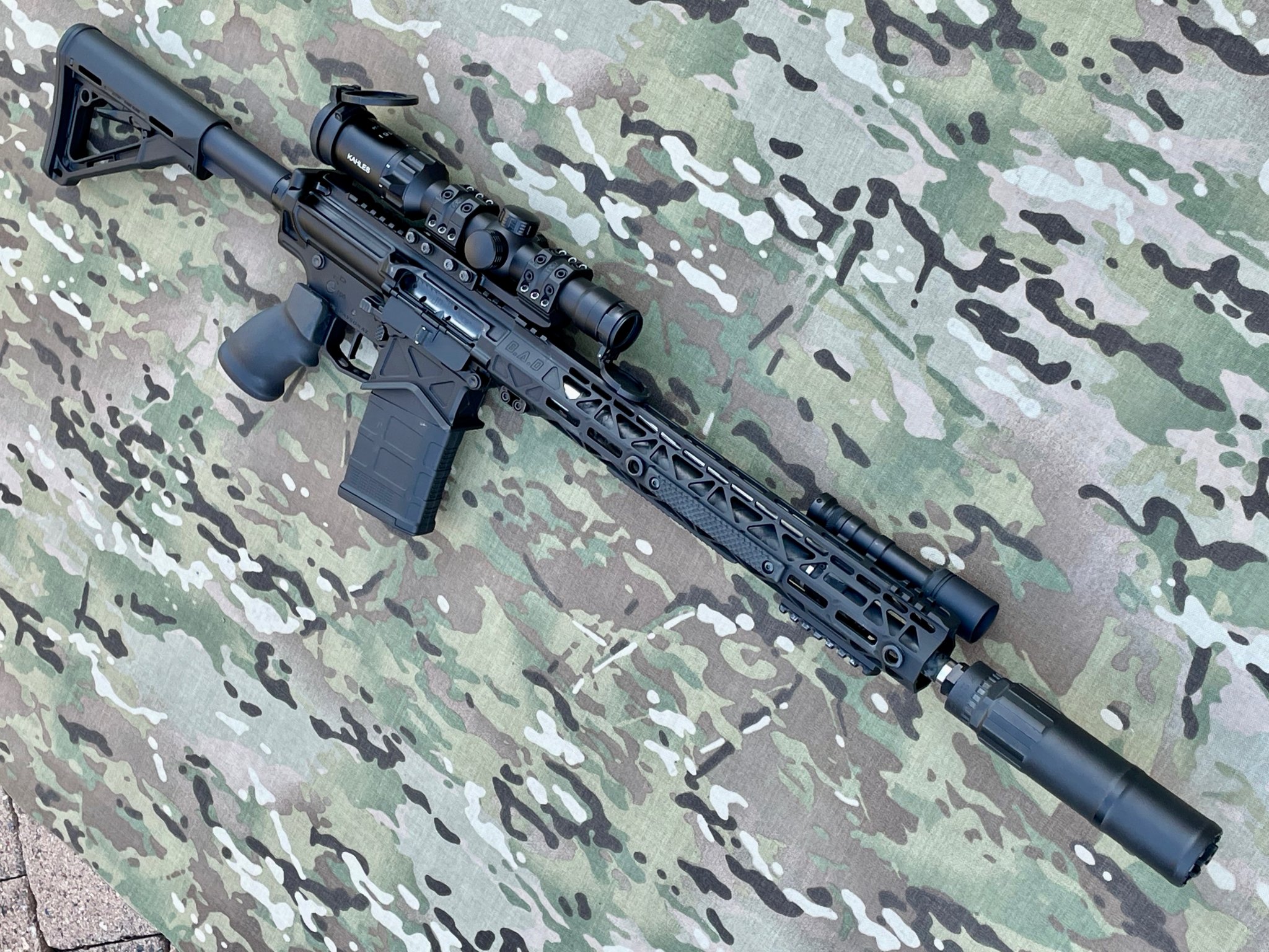

My 100 yard gun is what I'd call the "house gun" in .300 Blackout. It's really like having two rifles in one, and with the dual dot reticle in the Eotech, I've stumbled on a way to really make it work both supers and subs. With the EoTech circle/2-dot reticle designed for the M4, the top dot is POA/POI at 50 yards with supers; the bottom dot is POA/POI at 50 yards with subs.

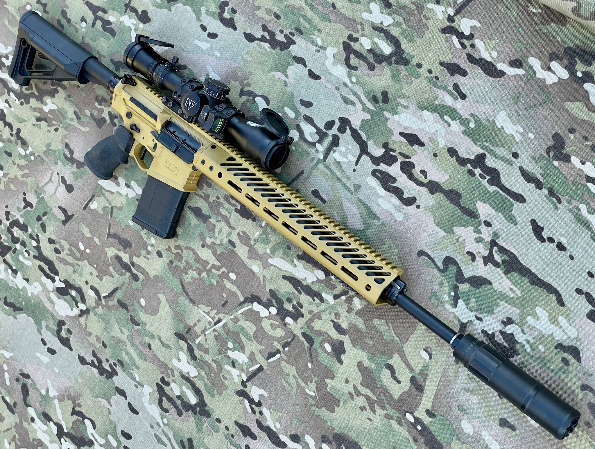

First, there's the 6.75 LB 18" Proof CF barrel 6mm ARC. With Hornady 108 ELD-M, it has an amazing muzzle velocity of 2686 fps, along with an even more amazing remaining velocity of over 1500 fps at 1000 yards. (Yes, my high density altitude does help.) With the right mags, the gun runs 100% and is the best rifle in the lot for groups at 100 yards.
This is the type of long range rifle and ammo you'd want if you had to hump your kit everywhere.

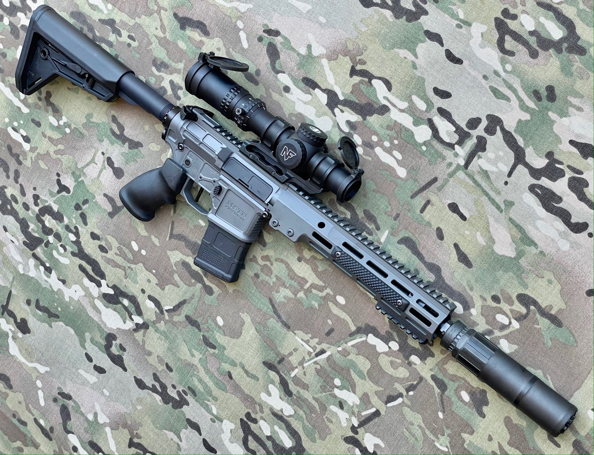

If you can drive your Jeep right up to the firing point, this is my newest build - a 6.5 Creedmoor with a Proof 20" SS barrel. At just under 10 LB for the bare rifle, it is no lightweight, but it's about three pounds less than most comparable precision bolt guns. It shoots easily sub-MOA with the first three factory loads I've tried in it, but I don't know if I've found the best choice for it just yet. I'm wanting half-MOA, and my best is 0.65. For some strange reason, this big block gasser is not at all finicky like others of its ilk, in that it seems easy to shoot like a small block blaster. Hold it hard, hold it light, it doesn't care. Zero malfunctions in the first 300 rounds.
In the 0 - 400 yard category, I have an amazing 11.3" 5.56 with a Bartlein barrel (+1 gas system) by Craddock Precision. Weighs just over six pounds but feels lighter because it's so short. I've really insulted it by inferring that it's just a 400 yard gun. With my ASYM 77 SMK, it's doing 2527 at the muzzle and is still traveling at over 1700 fps at 400 yards. You can get some surprising groups with just an 8X optic with this thing. My local Cerakote pro, Ronin Arms, painted it to exactly match my Jeep.
View attachment 8024096View attachment 8024097

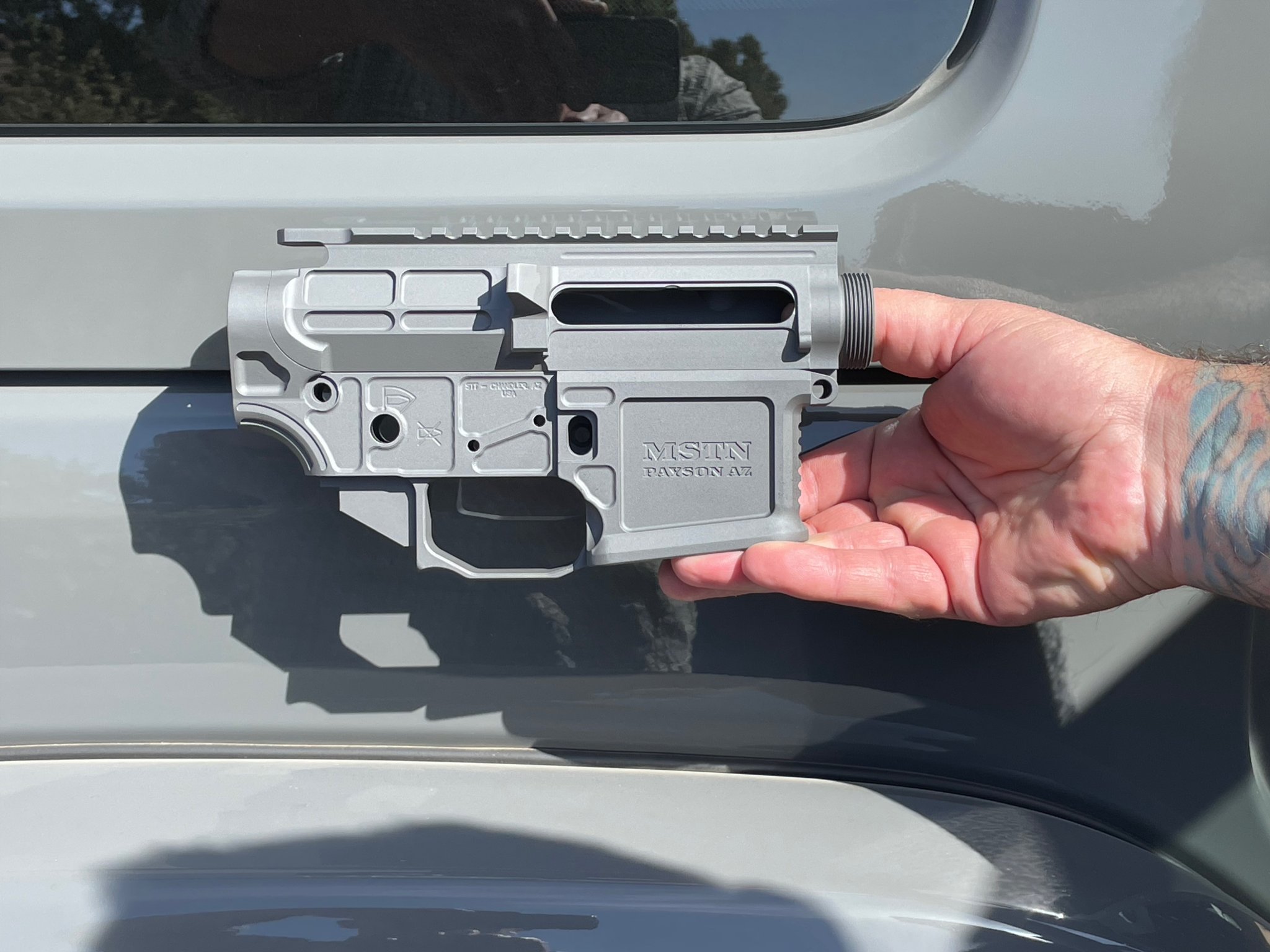

MSTN,
As usual, beautiful stuff that's highly functional..................and that's why I suggested early on in this thread that he just send you an order for 3 or 4 nice guns & be done with it, since money seems to be no object for the OP.
That upper / lower receiver set looks eerily like what I've used from SanTan.................;).
MM
That AR-10 6.5 Creedmoor is absolutely gorgeous, I'd love to build mine out like that. Especially that handguard with the slant cuts and the cerekote. I wonder how much weight you could save with the CF barrel over the SS one. 10 lbs is not bad, I think when I build out my LMT, it's going to weigh more. The 6mm ARC build is really pretty too, these are some really good-looking rifles!

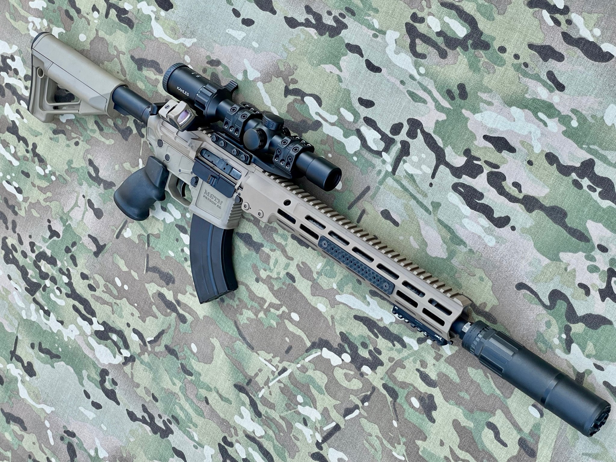

Making it run with both supers and subs is awesome. I love the length of the rifle. It looks really good in this color. I've never heard of MSTN lower receivers, I can't get them now but they look really good.

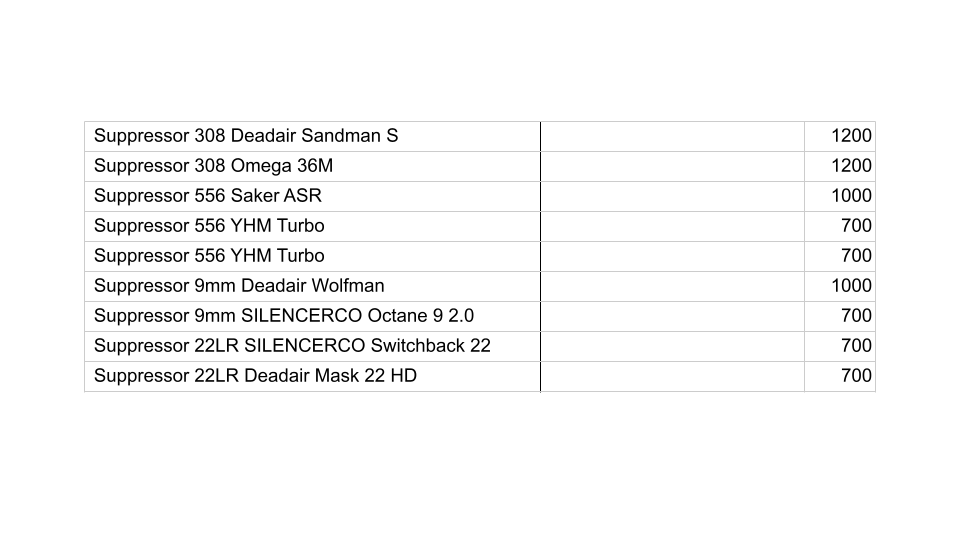

I love your setups. For my compensators, I'm still deciding which ones will work best with my suppressor list. I will be using two YHM cans and a Saker ASR. I haven't looked into surefire yet. Do they make good 556 Suppressors?
The only suppressor not on this list that I want to get is the TBAC Ultra 9.

These aren't really my receivers, in that I do not manufacture them - They're 100% SanTan Tactical with no logo. They're just the best I've been able to find! The ATF requires all FFL manufacturers (And I am one of those) mark their firearms with "NAME - CITY - STATE". That's why the "MSTN PAYSON AZ" is laser engraved on the lower receiver.

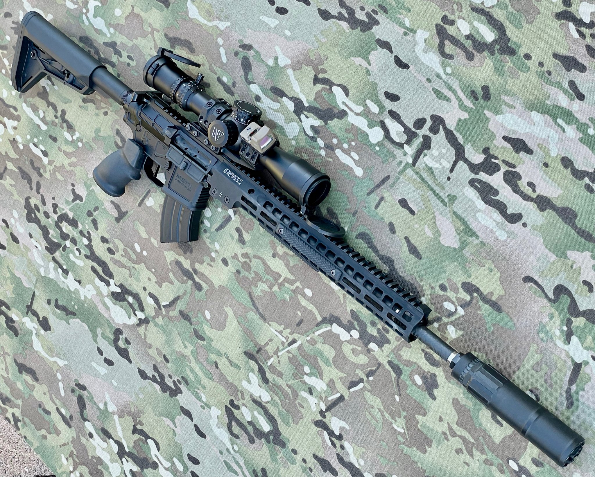

This one I built as an "experiment" in 2016. It has worked out surprisingly well, even better than hoped.
The Kahles K16i is a pretty slick piece of glass. Short, super light, super bright, with a really big eye box. At 1X, it's almost an Aimpoint. 6X is I think a good match with a lightweight .308, too. If you can't hit it at 6X, you're comfortably far enough away to call in an air strike.
Kahles, like other top shelf optics manufacturers (cough - Nightforce), quietly improves the quality of every aspect of their designs over time, and this 2016 relic just plain isn't as good as their 2022 version.

The 0 - 1000 yard guns come in two flavors.
MS, can you give more specs on the 1000 yard build, Im looking to build something like that for my Santan, I want a 6mmArc and a .223 uppers on the sea e spices so I can trainee .Thank you the rifles looks amazing.
1000 yard gun:
SanTan STT-15L upper
Proof 18" CF barrel with feed ramps contoured & polished
SLR adjustable gas block w/ set screws torqued to 25 IN-LB
Geissele MK14 15" rail w/ barrel nut torqued to 50 FT-LB
Geissele Super Charging Handle
JP Full Mass 6.5 G Bolt Carrier Group
KG-2 barrel prep

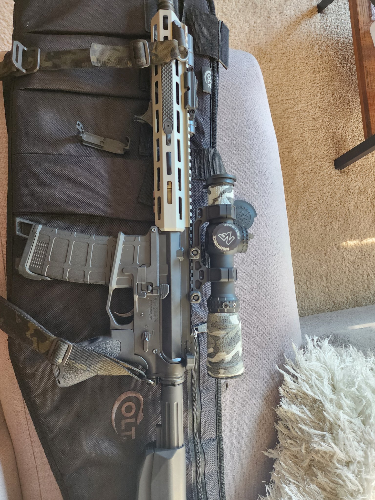

The one I already use for work:
Pws 111
Aimpoint T1 with a gbrs hydra mount
Geiselle 3 gun trigger
Modlite
Peq-15
Gbrs sling(issued but I like it)
Just issued the new eotech night vision in white phosphorus..jury’s still out though..don’t have a lot of experience with them..don’t see how they can be better than my pvs31’s
And a surefire compact can..not actually sure of the model
I got a lot of rifles and carbines..but this is hands down my favorite issued rifle
