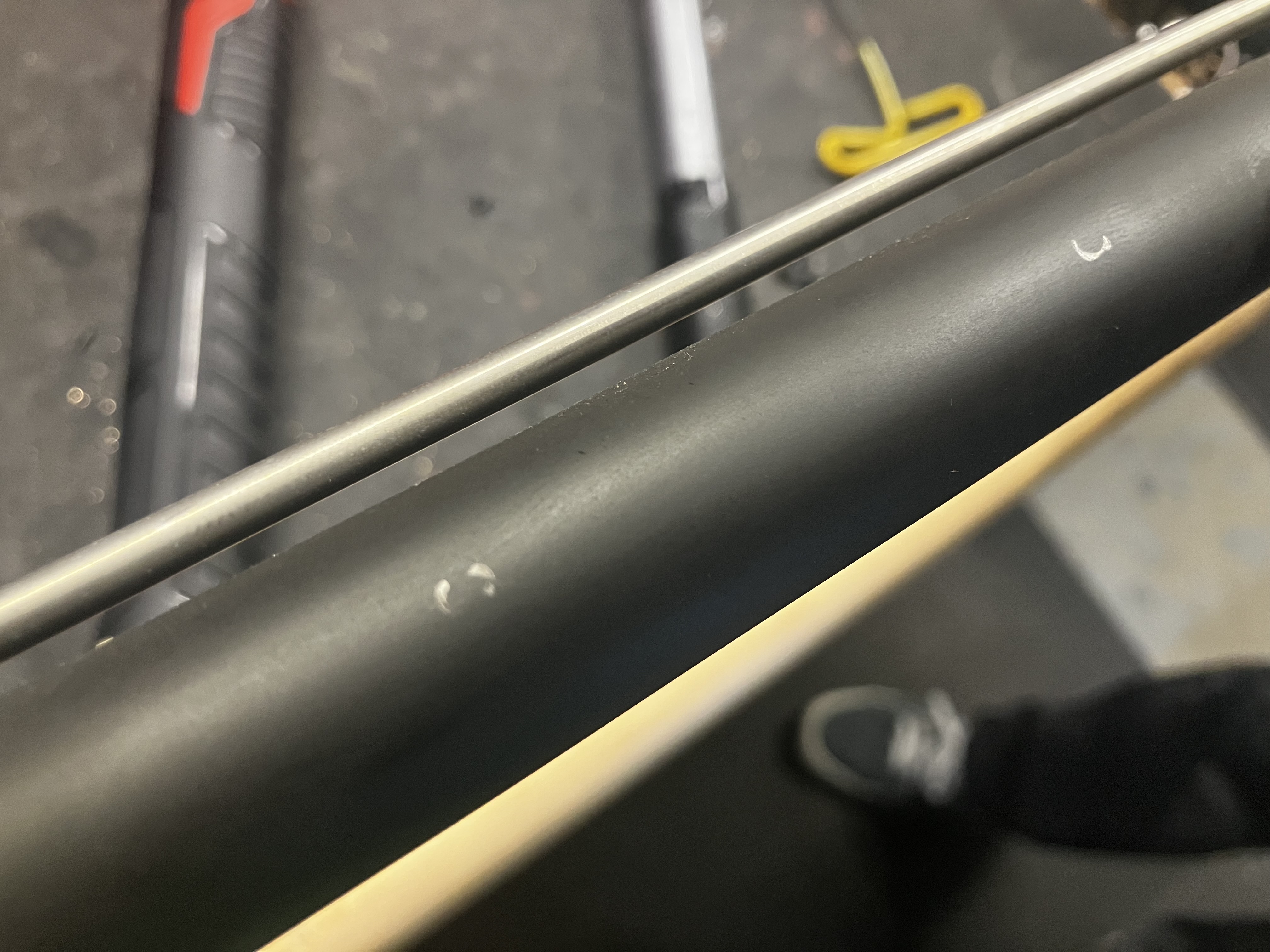

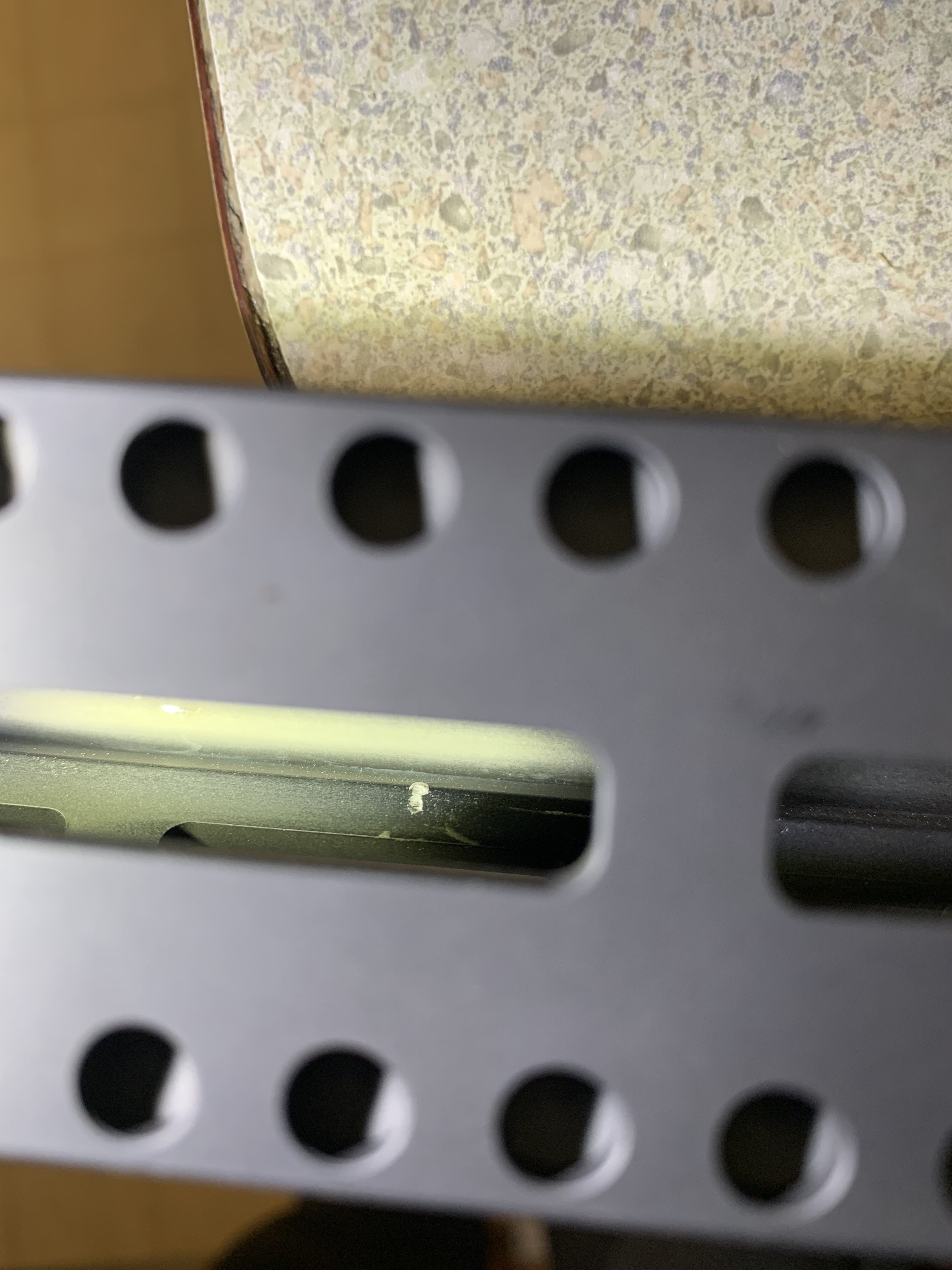

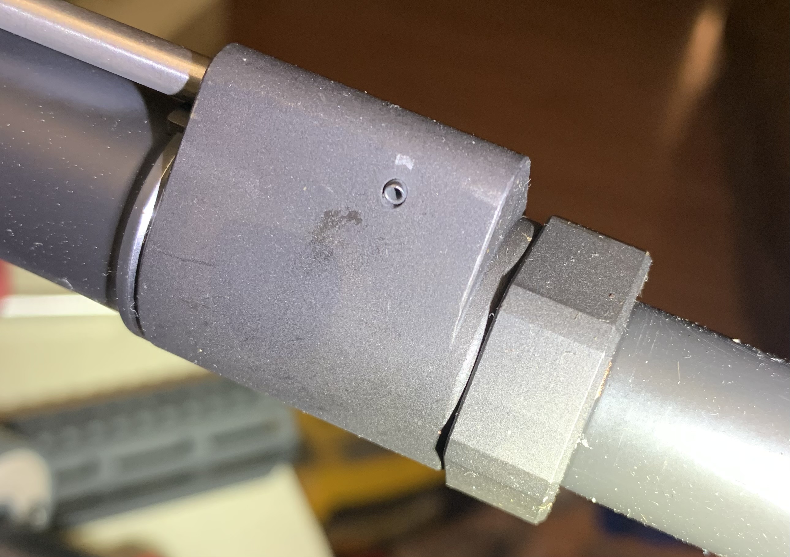

My blem upper. Gas tube roll pin wasn’t driven in all the way and gas block practically touching the handguard while static. I know of two or three other dudes who had uppers RMA’ed because of overly canted gas blocks.

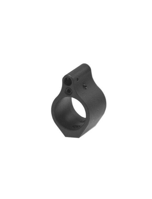

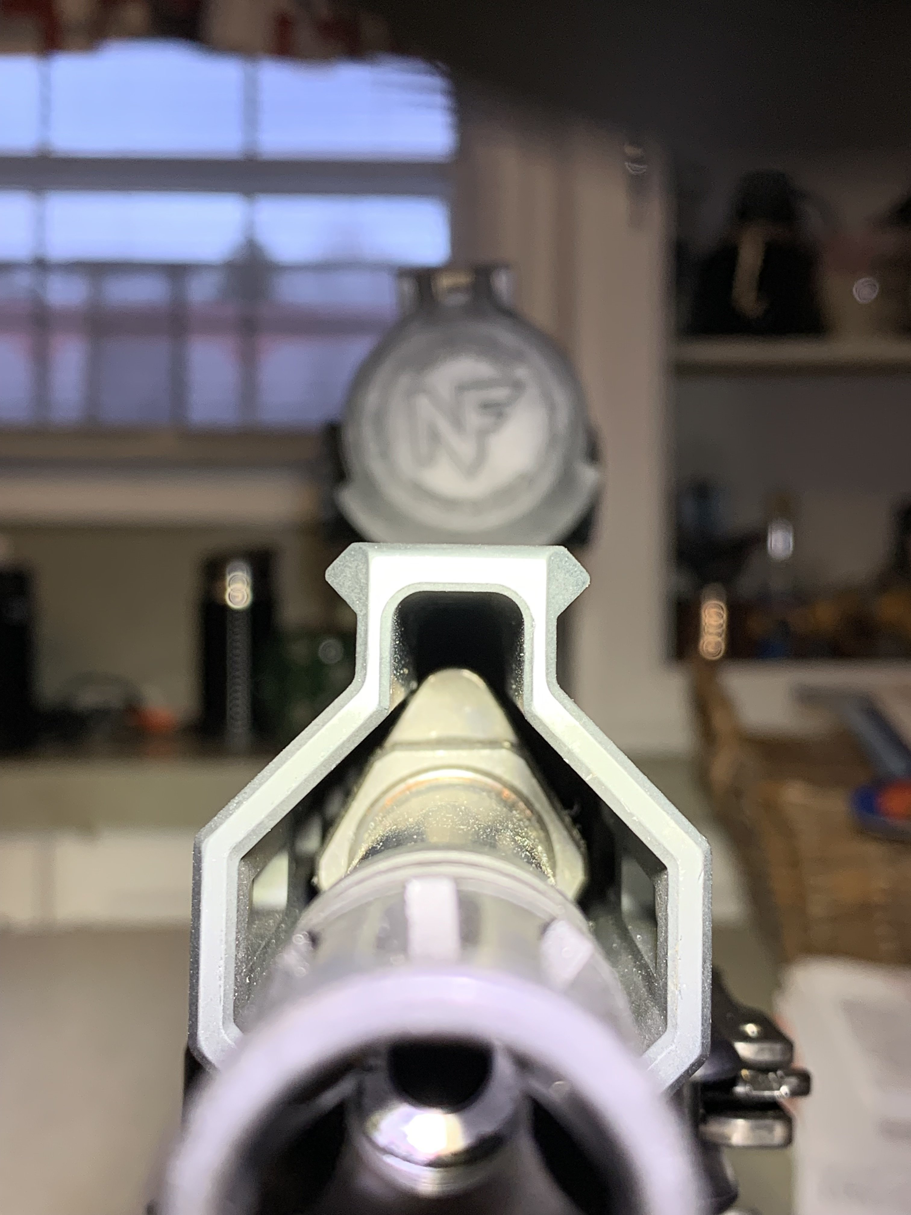

Yes, I tried two .750 gas blocks that did not have enough clearance to not impact the inside of the handguard when shooting.
You talked about using 875 and 936 gas blocks a couple pages back and I've mentioned a couple times in this thread that the inner diameter of the handguard is pretty tight and you probably won't be able to use those. I'm happy to let others talk about what gas blocks they've used but until people start building on those kits, I'm probably the only person who swapped a barrel out so far.

I tried a .750 Seekins Adjustable and a .750 Aero non-adjustable. I ended up with a BRT non-adjustable .750. I didn't shoot the Seekins, I could tell just looking at it, that it wasn't going to work. They have those nonsymmetrical banana shape at the top.

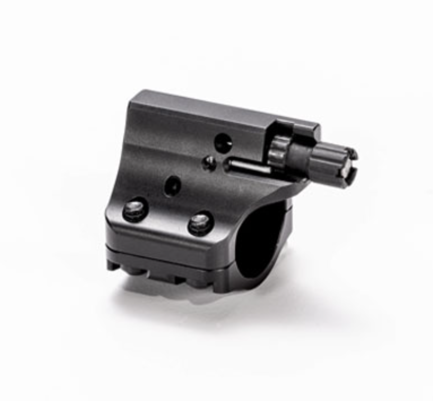

The JP lo profile ADJ would be interesting to try out. But you're also limited down at the bottom of the block as well. The traditional square bottomed blocks have a little more meat at the 6 0'clock to make room for grub screws threads.

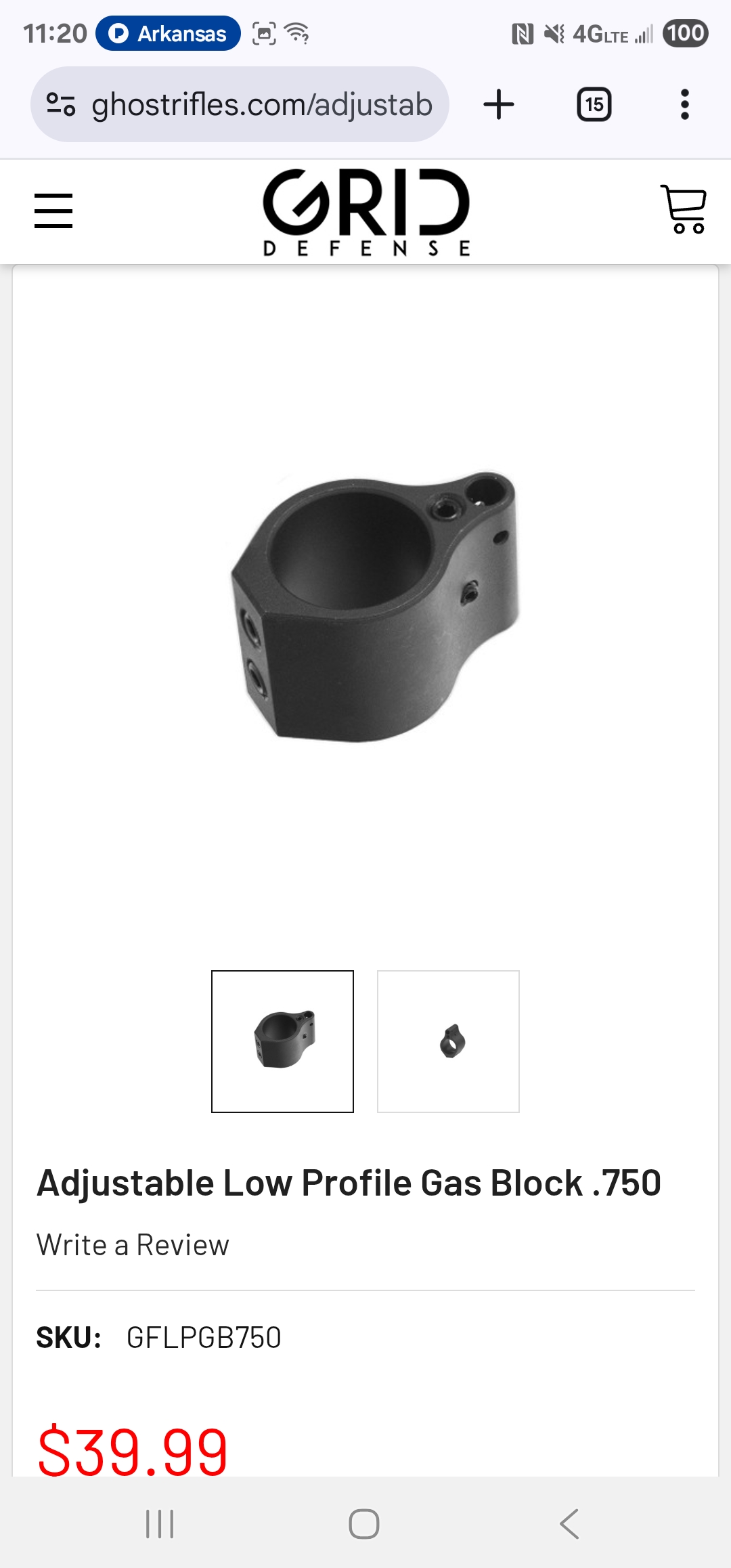

View attachment 8682308View attachment 8682309
I think most people on here will be running superlative arms gas blocks. They look pretty low profile, maybe a smidge wider in the adjustment area than something like a BCM. I ordered mine yesterday so I’ll be putting the uppers together when they arrive at my dealer. 10 day CA jail for the lowers.
I have that gas block under a geissele rail which seems similar in dimension to the RD rail. It clears the geissele MK16 just fine on my 11.5 but not sure if barrel whip on a 16" would be worse enough to make contact.

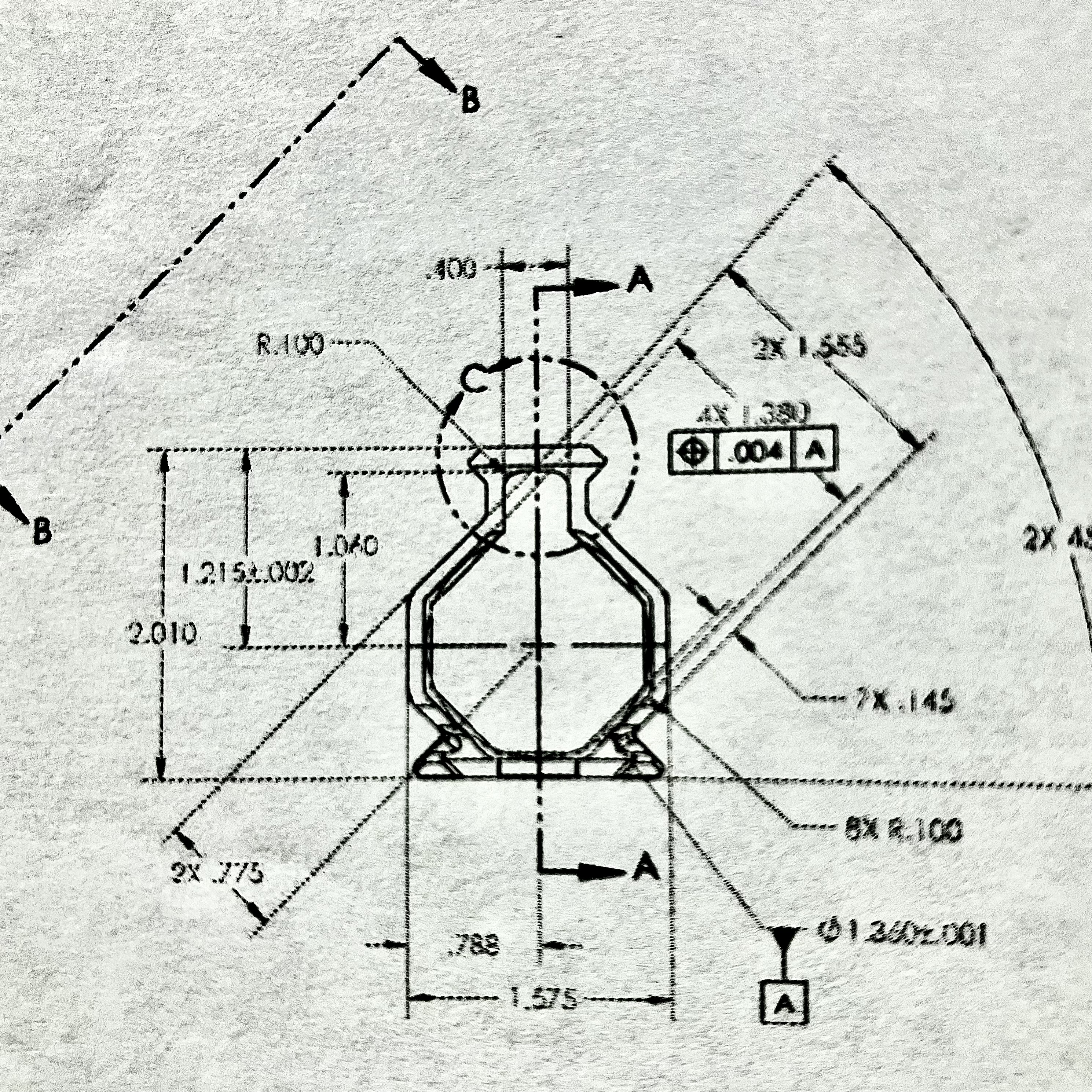

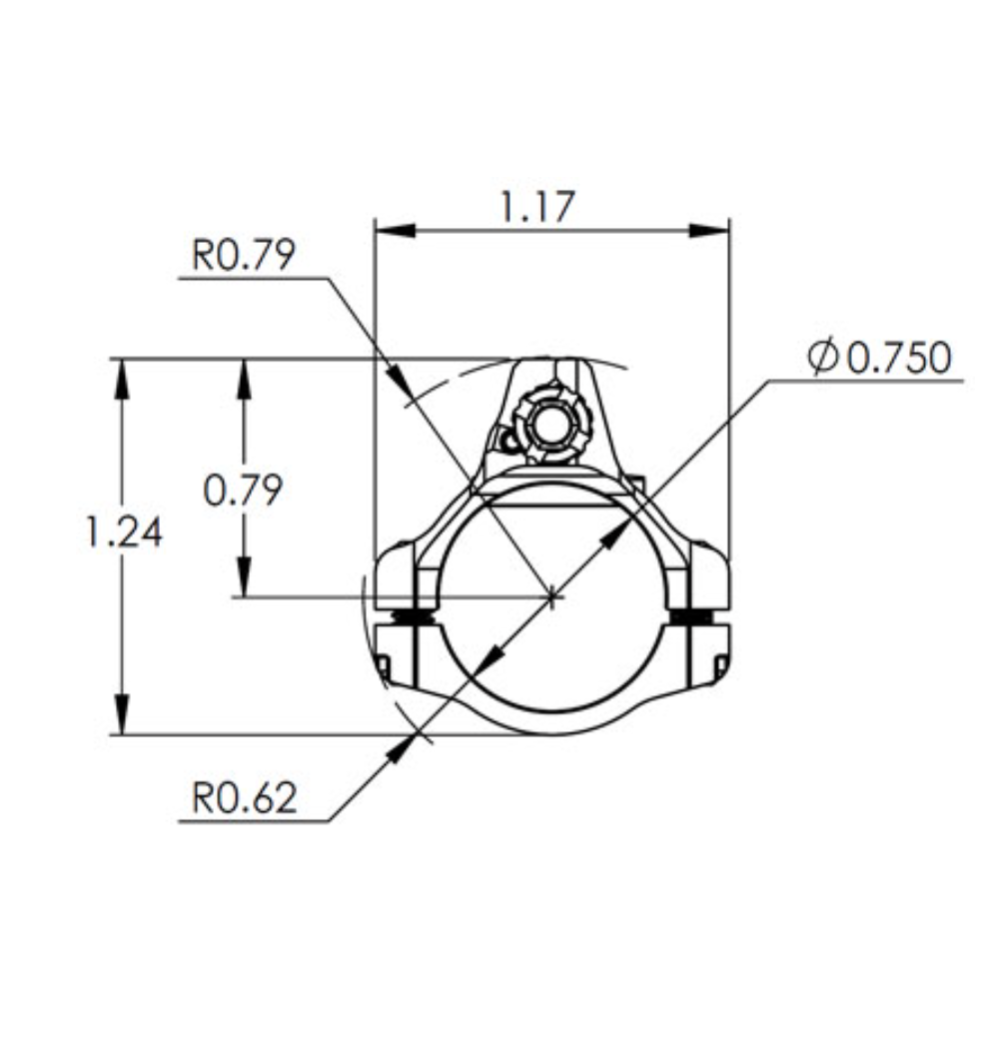

Alrighty, since there has been some discussion about what gas blocks may or may not fit under the handguard, I figured the best way to help is simply dropping the actual dimensions of the handguard cross section…
This should help, but remember it’s not necessarily an absolute given the variation of barrel whip but at least it’s something to start with.
While we’re on the topic of handguards, I have a PSA to remind you guys to double check the length of your MLOK screws. Especially if you are experiencing “POI shifts”.
I have received just about shy of a dozen or so RMAs from shooters who have claimed documentation of POI shifts with their LPR. I respect each and everyone because there are legitimate aspects that need to be corrected for from time to time.
That being said the vast majority of issues I’ve documented are hardware interference. Situations where shooters have inadvertently installed rail weights/grips/bipod/etc. that end up touching the barrel.
Here’s a tell-tail sign.
So just double check. Again anyone can make a mistake (or dare I say “screw up”) and I am always here to help but this could save us all a bit of time.

I wasn't able to use any mlok attachments on the handguard because it was too tight. Even trimming the length of the screws. The only thing I wanted to use was a short pic rail for a brass catcher but it's even tighter closer to the receiver due to the barrel contour. Other than maybe a gun light (for your SPR 🤔), I don't know what a person would need to attach via MLOK.
Around the gas-block is very tight, I would be very cautious trying to mount any though those slots. Everywhere else is functional. Again we just need to be aware of actual screw lengths. I’ve come across 3 or 4 different length MLOK screws, they’re far from universal.
