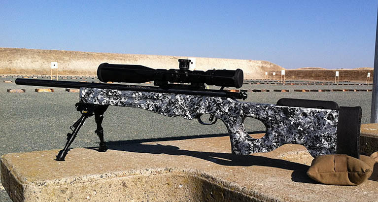

.17 HMR in a leopard stock, painted with a few sponges and black, white, and gray Krylon. Added pillars to the stock, dip metal, BSA 4-14 mil mil midway special.

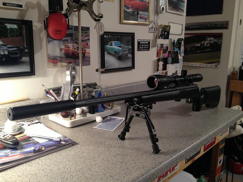

My Savage TRR-SR posted before. However, rail was removed and 20 MOA base added. HTA can and zeroed for 300 yards.
Pretty much shoot this exclusively at 300. Good practice for long distance .308.

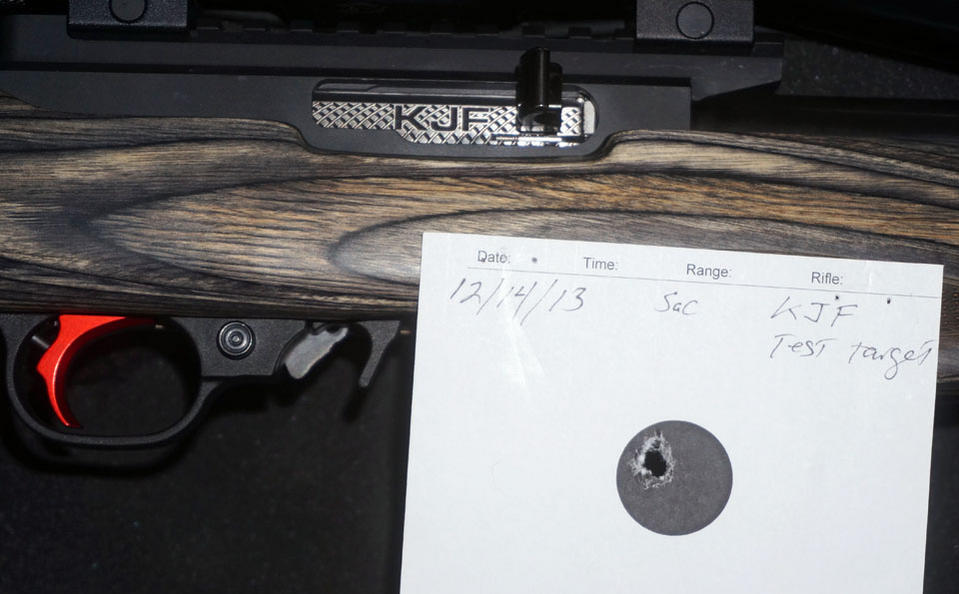

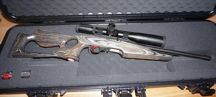

Built a couple matching 10/22's for my nephews first rifles, the only difference between the two is the initials on the bolts. Test targets included in the case that I shot after zeroing the scopes yesterday. Need to shoot the first one over again, didn't concentrate as much as this one, 5 shots, fifty yards.

Me thinks you are going to have some seriously happy nephews.

That is getting it done! What are the details on the build?

Well it all started when I picked up three tactical machining receivers pretty cheaply, of course I made up for that later. I'd taken the nephews out a couple times and they really enjoyed shooting. I'm the only one in the family that shoots. ;) Got approval from the wife to build them rifles for Christmas. It was a lot of fun and a couple vendors gave me a discount when I told them I was building them for my nephews first rifle. I think they'll be really excited Christmas morning, not so sure their mom will be all that happy.
Anyway here's the specs, tactical machining receiver, JWH bolt with their initials on them, it came in a kit with the charging handle. It's very nice stuff, and they were great to deal with on ordering what I wanted. Altamont Barracuda stock, which the kids will love, they're very cool looking, the inlettting is very good, I also added a brass screw that indexes on the receiver cleaning hole and helps as a second hold down. I may put in a pillar some time in the future. Factory triggers that have been cleaned up by a local smith. They're about 3 1/2 lbs but break clean, the red trigger is just for a little bling. Green Mountain barrels, 16 inches, Gunsmither block and a Midway special BSA 4-14 mil mil scope with cheaper vortex rings that were on sale at Midway. I lapped the rings but didn't take much off with the lapping just a little anodizing on one edge. I think that's everything, the other rifle shot almost as well, not one hole more of a clover leaf but that was probably me.
