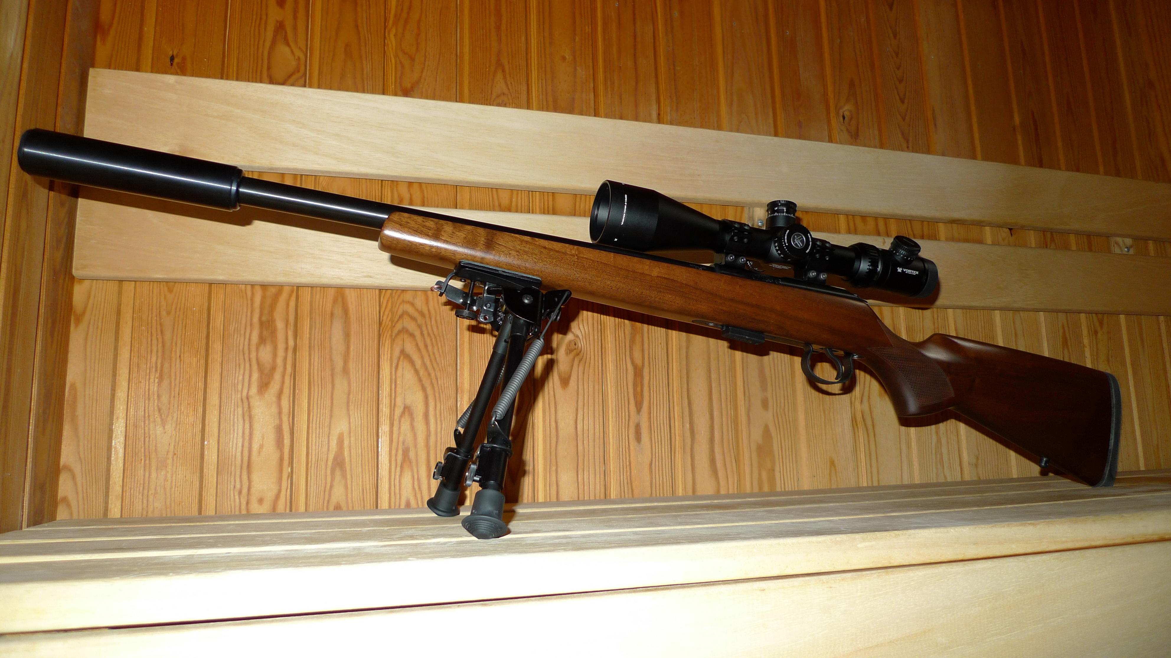

Here is mine
- CZ 455 Varmit 22 LR 16"
- Vortex Viper PST 4-16x50
- Hawke Match Rings medium
- Harris Bipod Series S-L
- SAK Suppressor
Very accurate, great fun to shoot :D

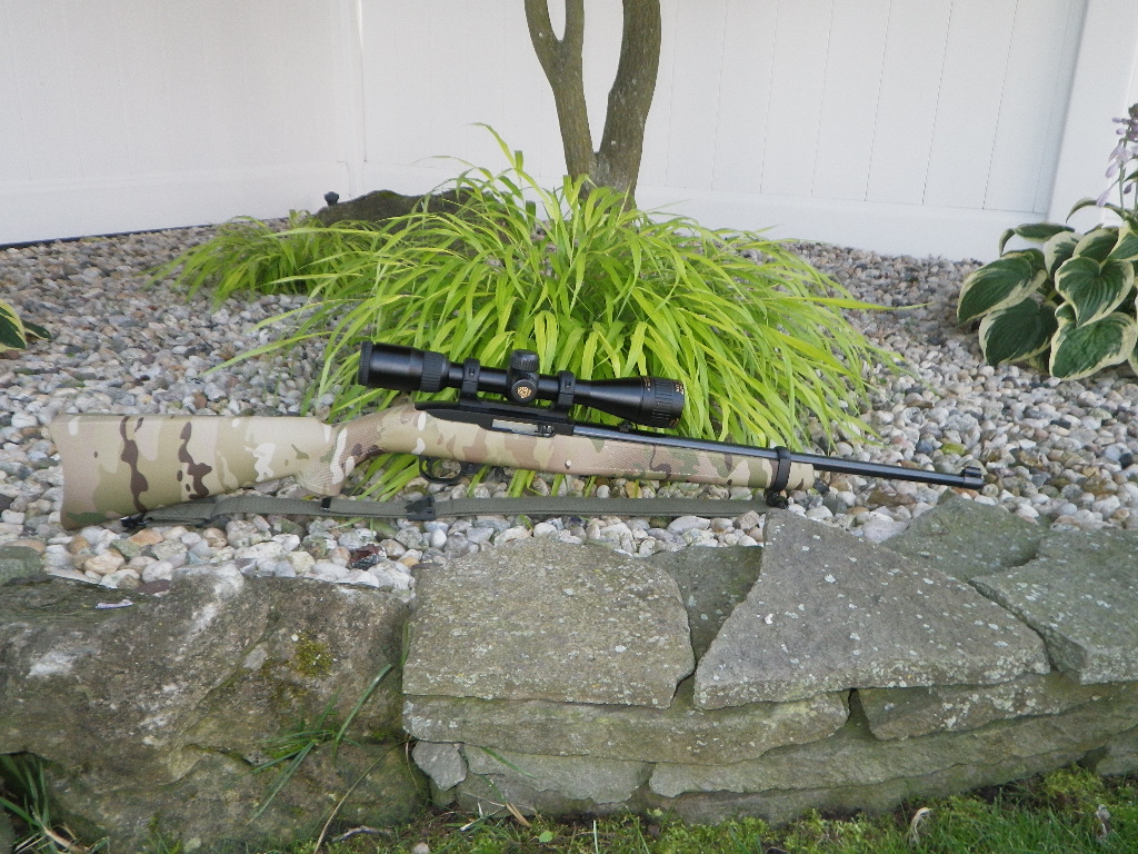

Ruger American Rimfire .22lr
https://flic.kr/p/myw2wQ https://www.flickr.com/people/87653153@N00/ New here...love this site :) Showing off my first build: Ruger American 22LR, standard length barrel, Boyd's stock, PTG Bolt Knob, Nikon P-22 2-7x with BDC 150 reticle, DIP rail, Uncle Mikes sling swivels. I started with TechSights and a GI sling but since buying this scope, my first, I'm really starting to enjoy it (I've since taken off the flash hider). I hope to get some more time behind the glass this weekend!

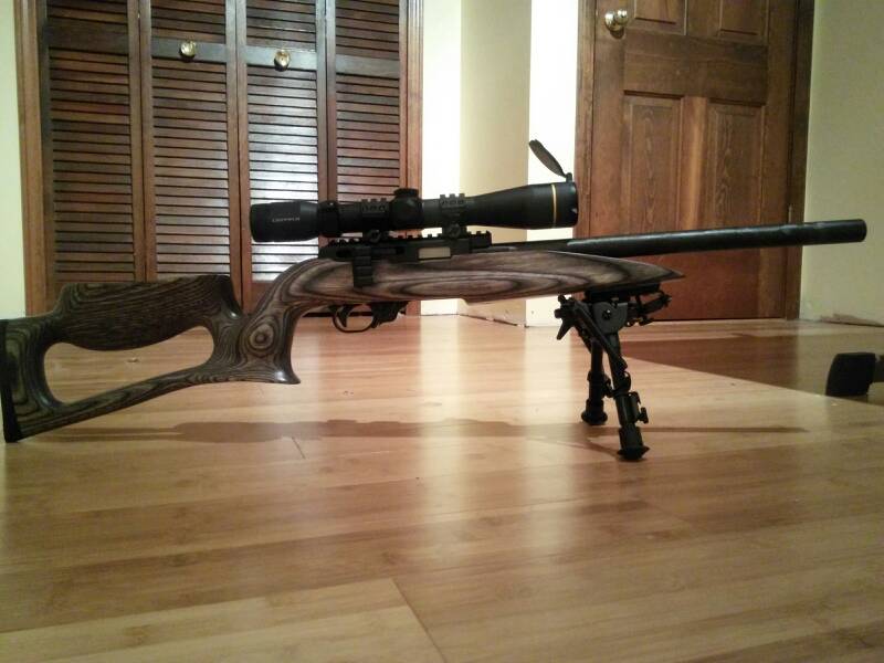

First one is a 10-22 ruger with an arch angel stock. Then I added a ER Shaw Match grade Helically fluted barrel that was threaded 1/2-28. I then added a Leupold 2-7-33 var x 2 scope. And finally a Volquartsen trigger group. Then the gun was confiscated by my 8 year old (at the time) daughter. Who then add her own very special touch. A whole lot of "HELLO KITTY" stickers.
Next we have a full blown Volquartsen in 22 magnum. It has a straight fluted barrel with the compensator brake added. I had them thread it 1/2-28 so that I can use a suppressor on it. It is housed in the McMillan thumb whole stock. Probably my favorite gun. Has a Leupold var x 3 3.5x10x40 scope on it. This is def not the right scope on this rig. I am working to get the right scope on it.

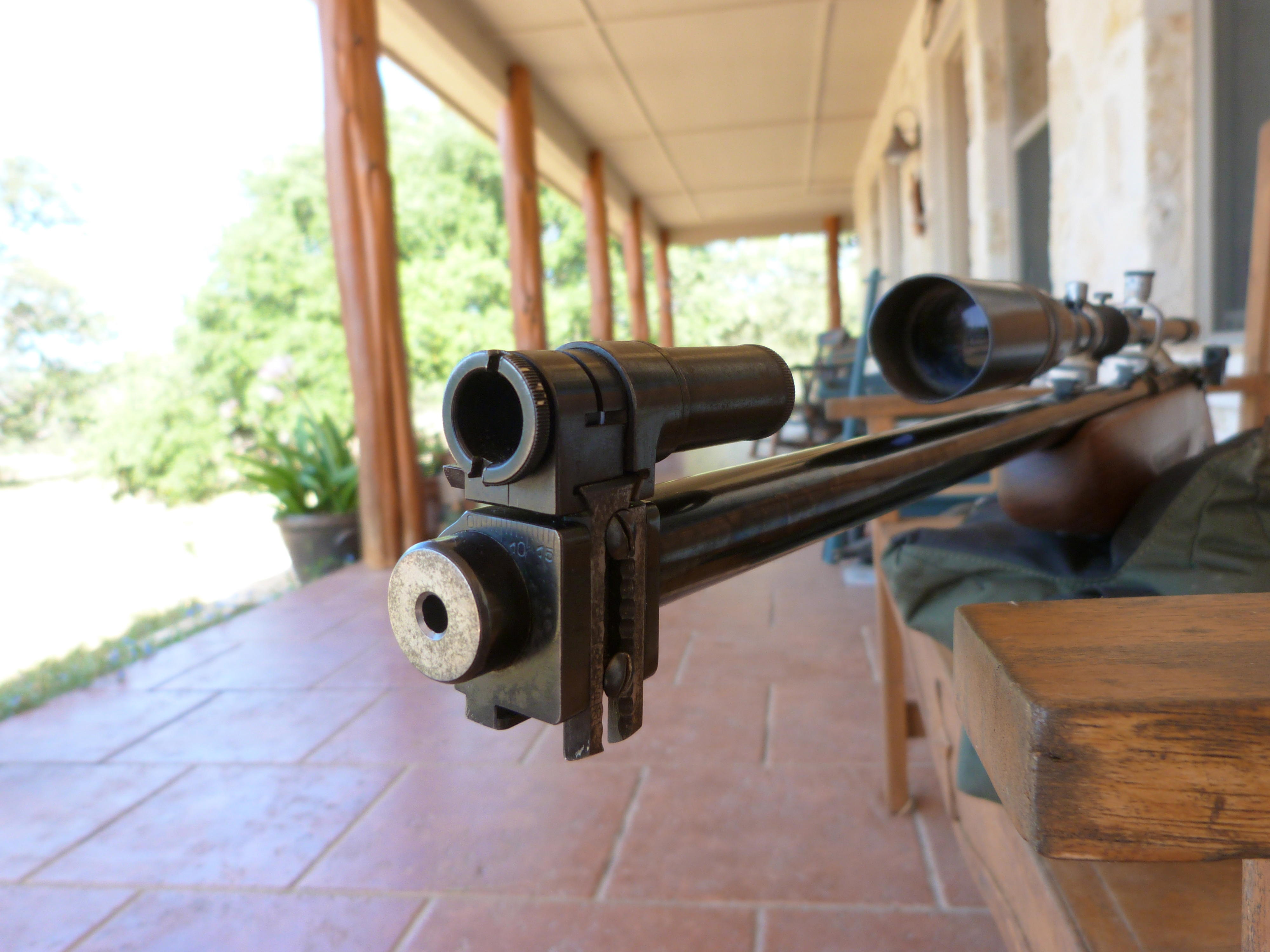

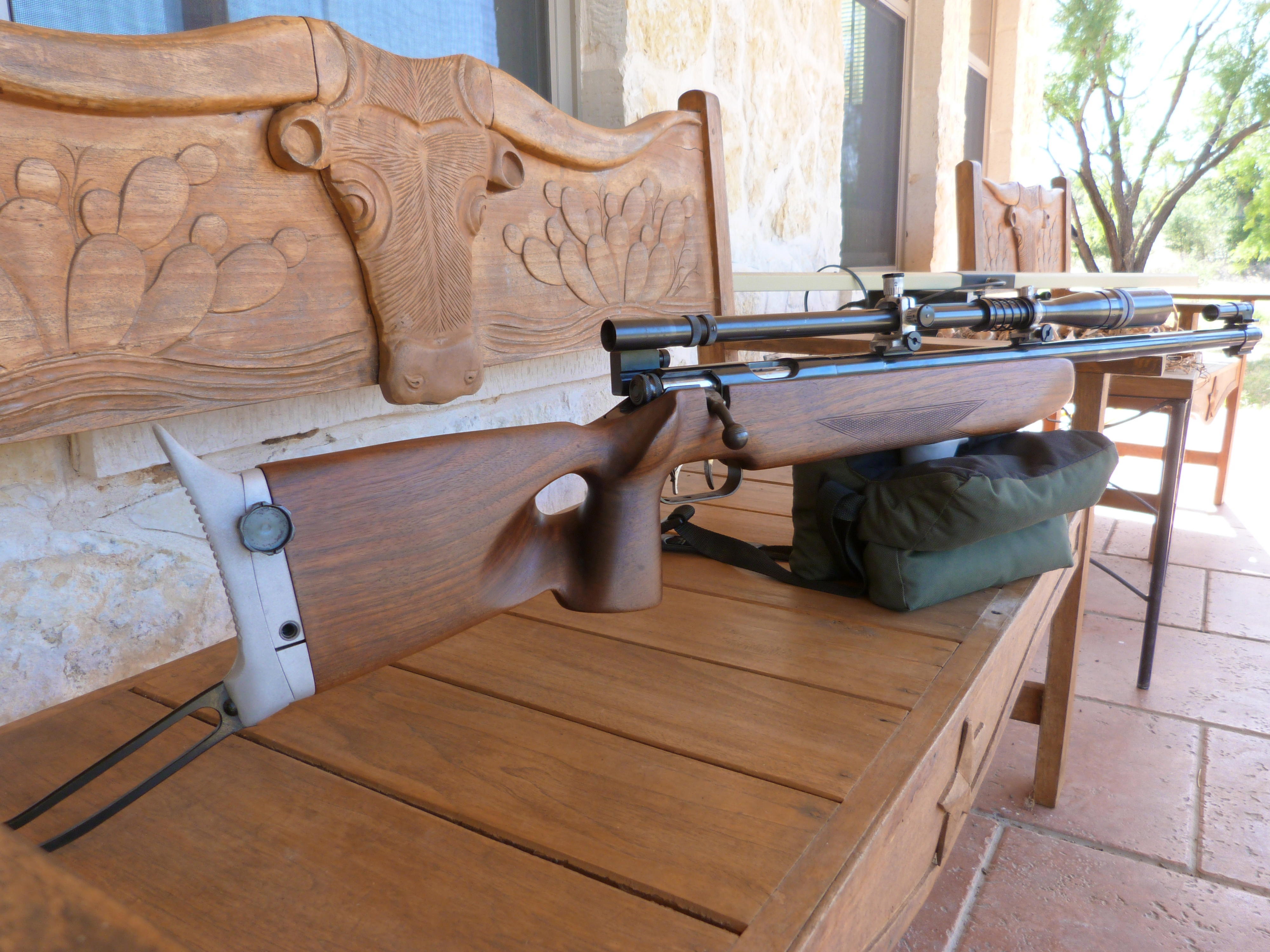

Here is another one for Frank... my Russian Zenith 3 .22lr target rifle, circa late 1950's to early 1960's. I just finished restoring it and test fired it...pretty good for an un-bedded rifle from the '50's. I believe this was an export model as it is marked "made in Russia" in english sript. I put an old Unertl 10x on it to test for accuracy. I used Eley Match. Not a bad group at 50 meters considering the low magnification, less than top grade ammo, and somewhat windy and hot (100 degreess) conditions.

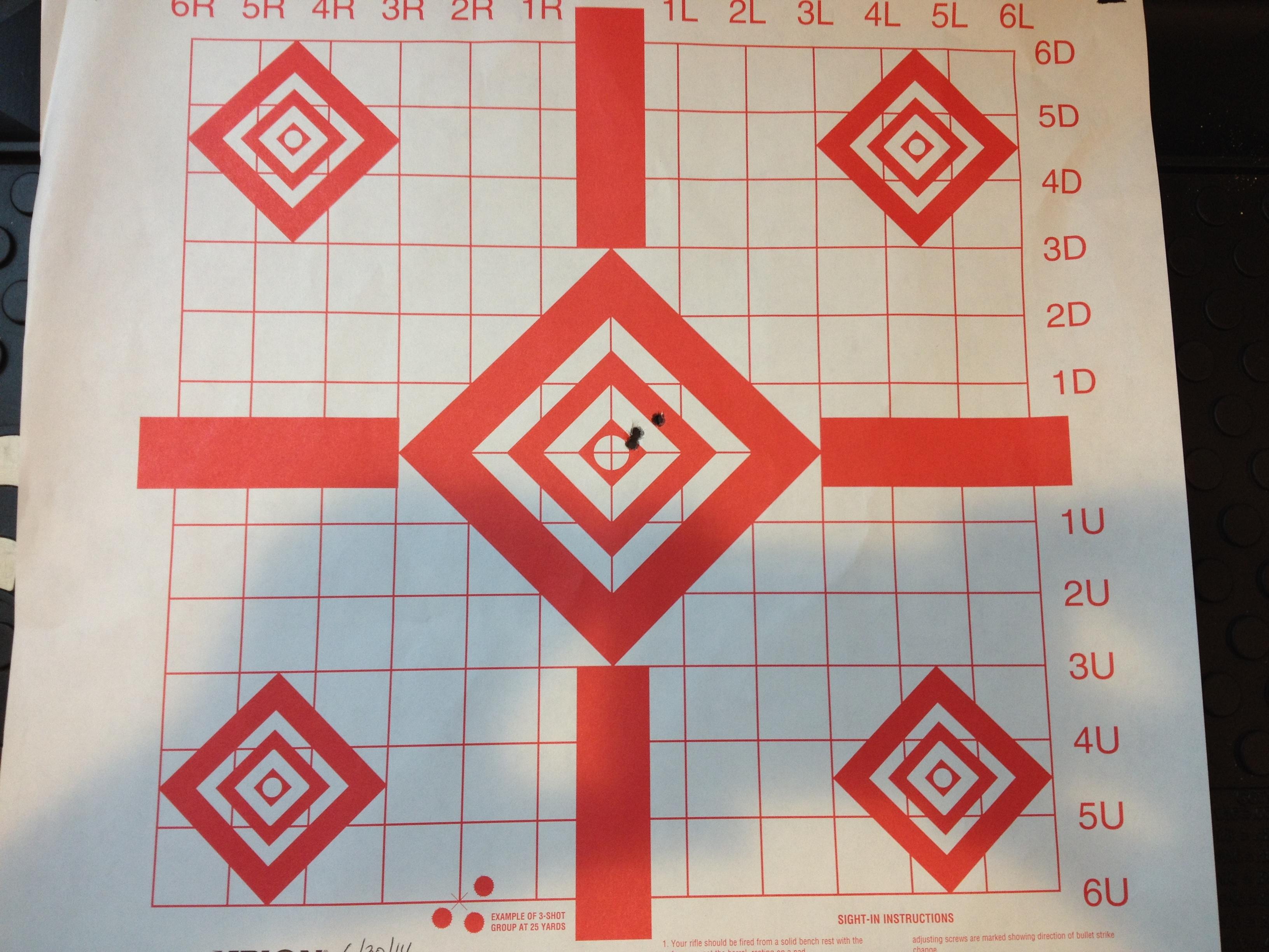

A stock Ruger 10/22 and the three round group was taken from a bench rest at 100 yards.

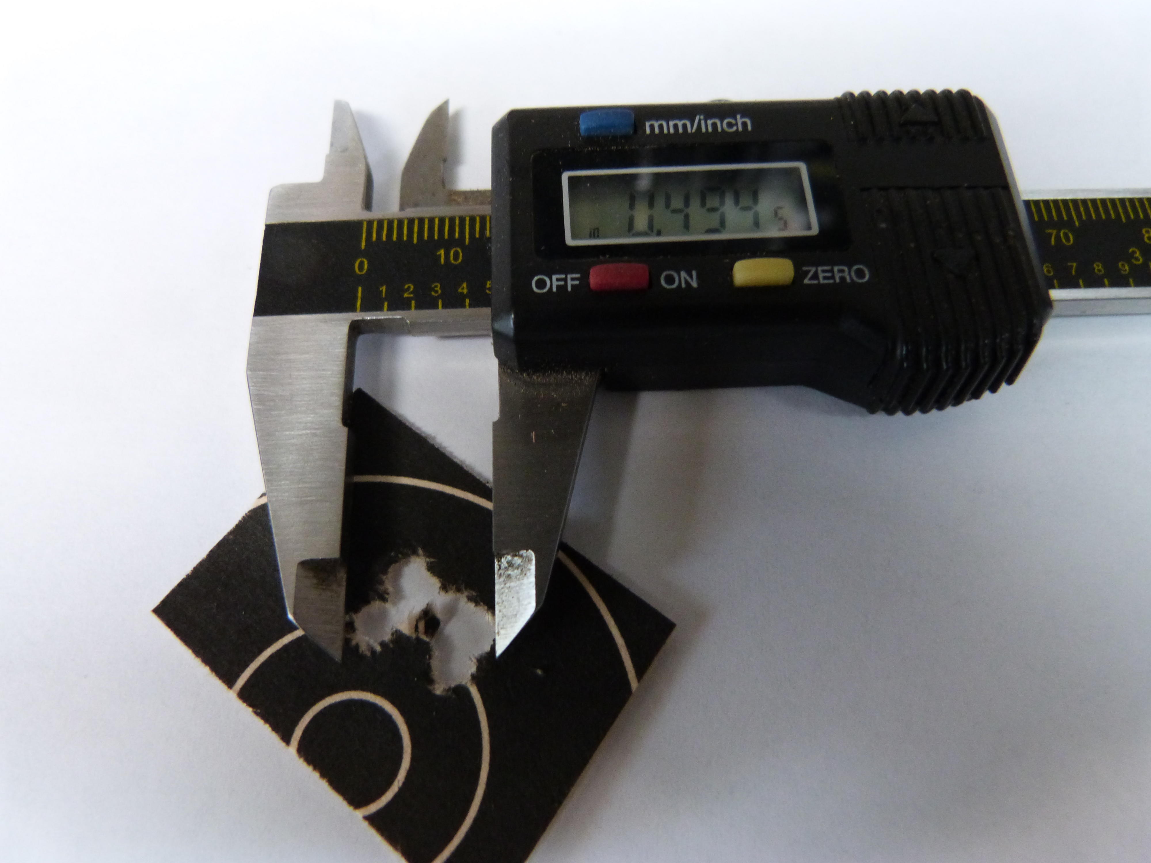

Savage MK II in an Airsoft G96 AICS stock. Action completely free-floated and pillar bedded to the chassis. Anschutz bolt knob. 60% Burnt Bronze 40% Sniper Grey Cerakote. The fake supressor actually improved accuracy markedly...harmonics I guess. Shoots one hole... 1/2 inch edge to edge at 50 meters with Eley Match.

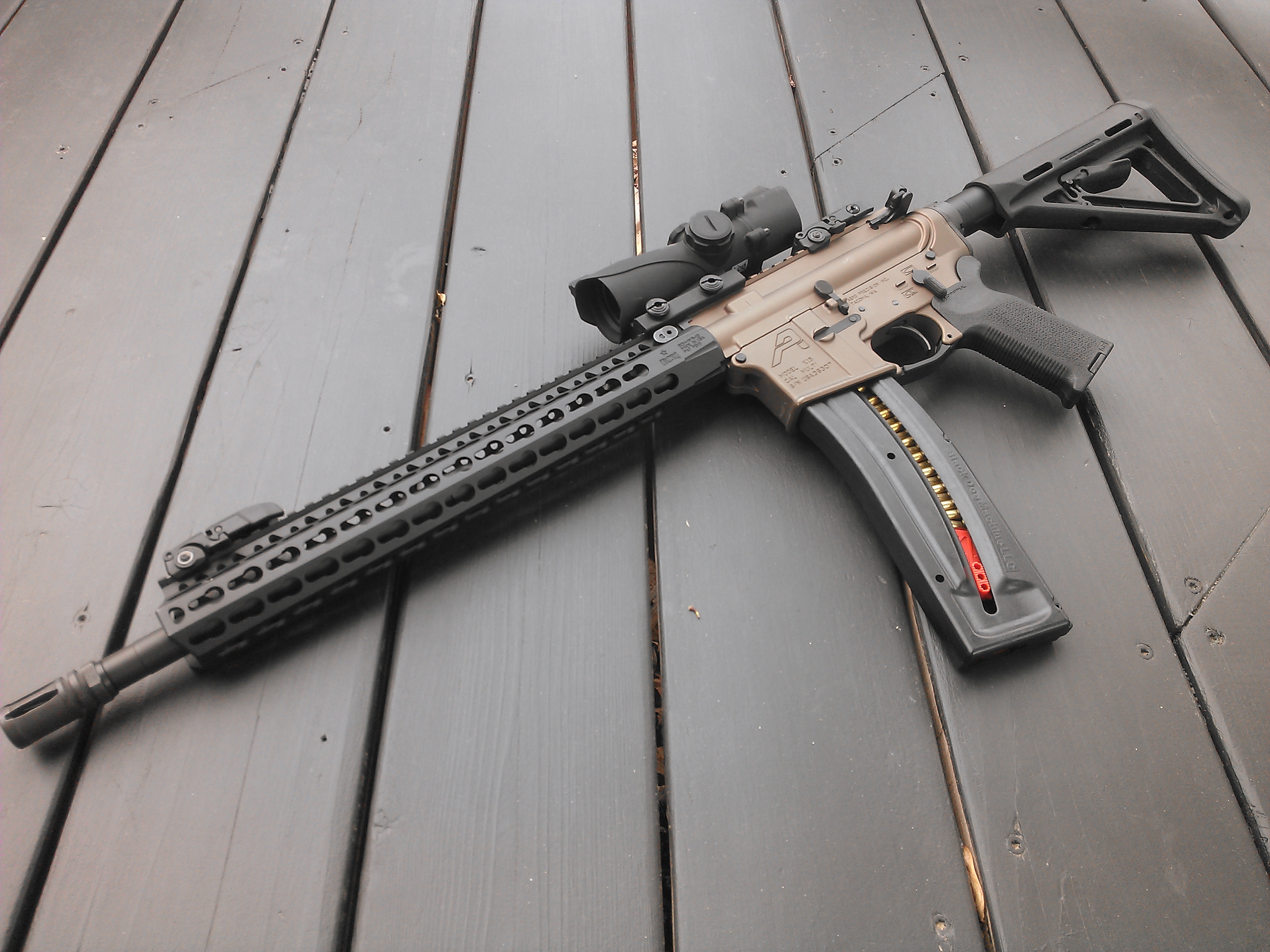

AP upper and lower, CMMG .22lr barrel and BCG, KMR rail, Magpul stock grip and BUIS, QMS trigger, Bushnell red dot. I plan to cerakote the rail to match the upper/lower.

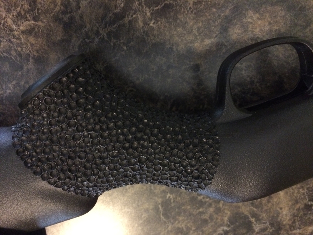

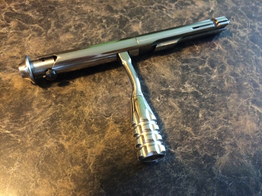

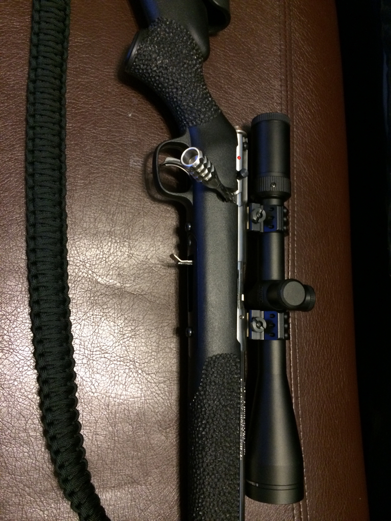

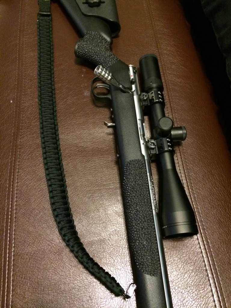

Savage .17 HMR FVSS
Picked up this .17 HMR the other day and bedded the action first thing along with filling the complete stock with bedding material to stiffen it up. Free floated the barrel a little more, lapped the bolt, and decided to stipple the stock with a wood burner instead of Marine-Tex since the tupperware melts easy. Added a weaver 25x and some Burris Tactical mounts, Karsten Adjustable cheek rest, and milled the bolt knob down to add a stainless oversized I picked up on ebay.
Savage 93R17 FVSS
Karsten Cheek Rest
Stainless Tactical Bolt knob
Burris Rings
Weaver 25x
Stock bedded and filled
Lapped and polished bolt
Removed checkering & stippled stock
ImageUploadedByTapatalk1409499374.512676.jpgImageUploadedByTapatalk1409499432.166558.jpg
