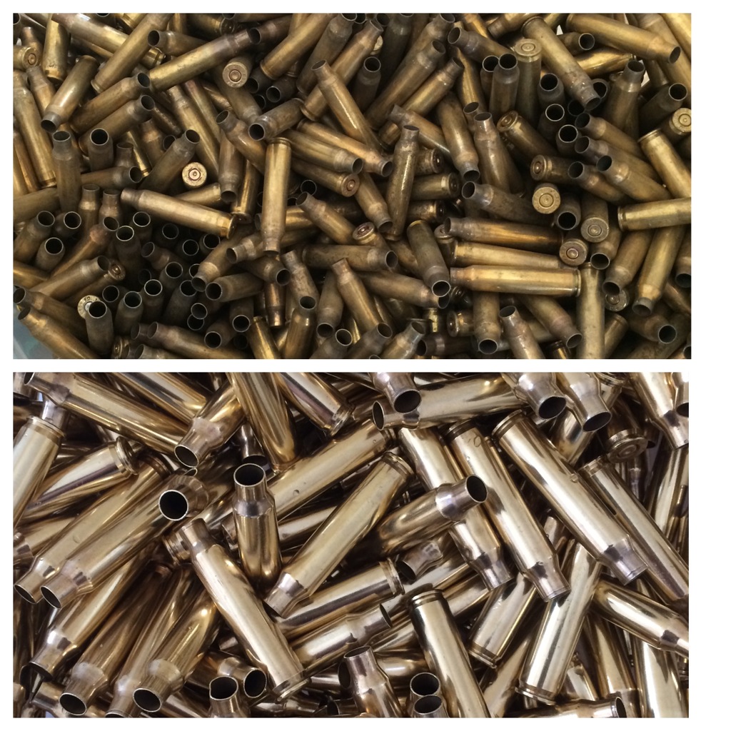

I learned about stainless steel media in a wet tumbler here on SH in Feb 2010 when some guys were selling the 5 pound bags of media.
What an improvement!
I am done with the corn cob, walnut, and ultrasonic cleaning of cases.
I have the STM rebel 17 setup. It's amazing!!

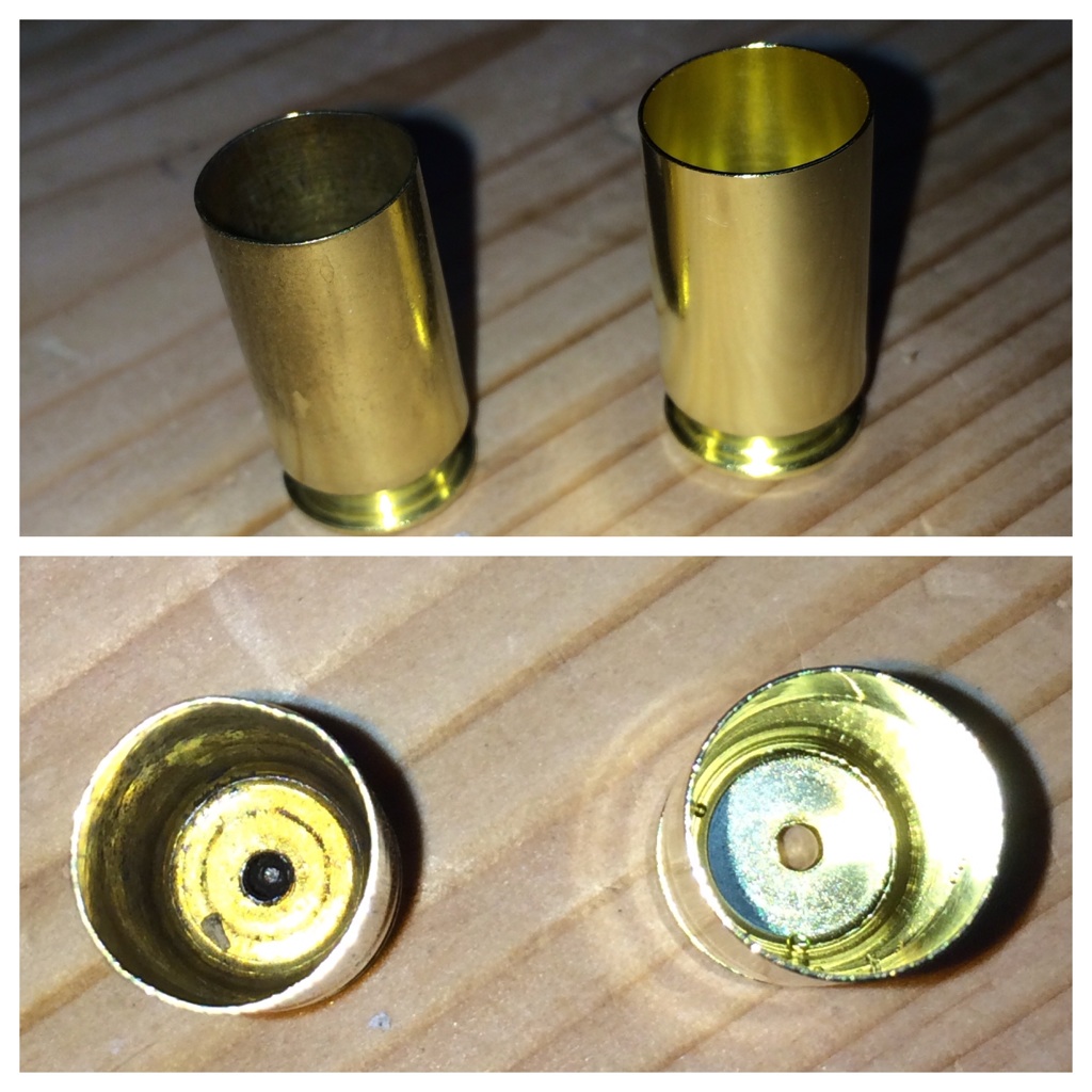

If you deprime first, the SS media will even clean the primer pockets. The media I have gets stuck in the flashholes. There is a new size that advertises that it doesn't stick.
