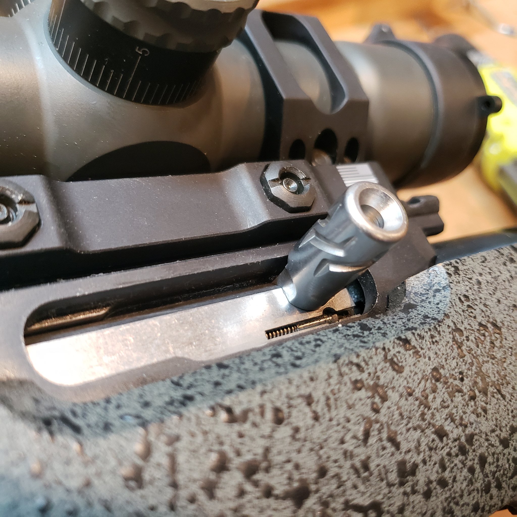

I did all these upgrades because the gun wasnt accepting enough loads. Its accepting most loads now so these parts made a huge difference. I plan on finishing my own kidd rifle with all my recently purchased upgrade parts.... then my Ruger and it's original parts will go back together for my daughter who's just starting up.
Yeah, if you're reading this and your on the fence about buying a Ruger competition, theres a 50 50 chance you'll be good out of the box according to what I hear around here and there's probably 100 % chance ruger will make it right but you'll be without your gun for a while. Sucks they dont get it right the first time. I really hate that, especially with a premium price point and with custom shop status.
Hey, when I get this gun out for final tests it might shoot lights out and I might end up being really happy with its accuracy.
My last kid part went in tonight, what a difference. After all this work, I think rhe feeding and ejection issues stemmed from a Ruger factory bolt handle which was slightly out of spec and rubbing to much.

That's very odd when the claim that this new competition action is supposed to super premium machined. But good idea, once you finish your KIDD build, just send yours back to ruger for them to make it right.
Whoa! I got my rifle cycling EVERYTHING. even 45 gr subs by federal ( 950fps ) ,45 gr subs by CCI 875 or so ...everything goes now. What a great feeling! Everything chambers,fires and cycles.

Silly question, did the kidd bolt have a kid bolt handle by chance?
Reactions: gdonley308
Ive got about 4 10/22s currently and they all have a kidd rod and handle, they are so much slicker then the factory. Ive never personally had issues with any of mine stock but I havent bought one since the 50th anniversary editions.
If you drop a Kidd bolt into your receiver, you see immediately how much slicker and tighter the bolt fits and travels. On the Brownell’s receiver you do have to trim back the guide rail opposite the ejection port to get the Kidd Bolt to fit. Takes about 5 minutes of some careful Dremel work.

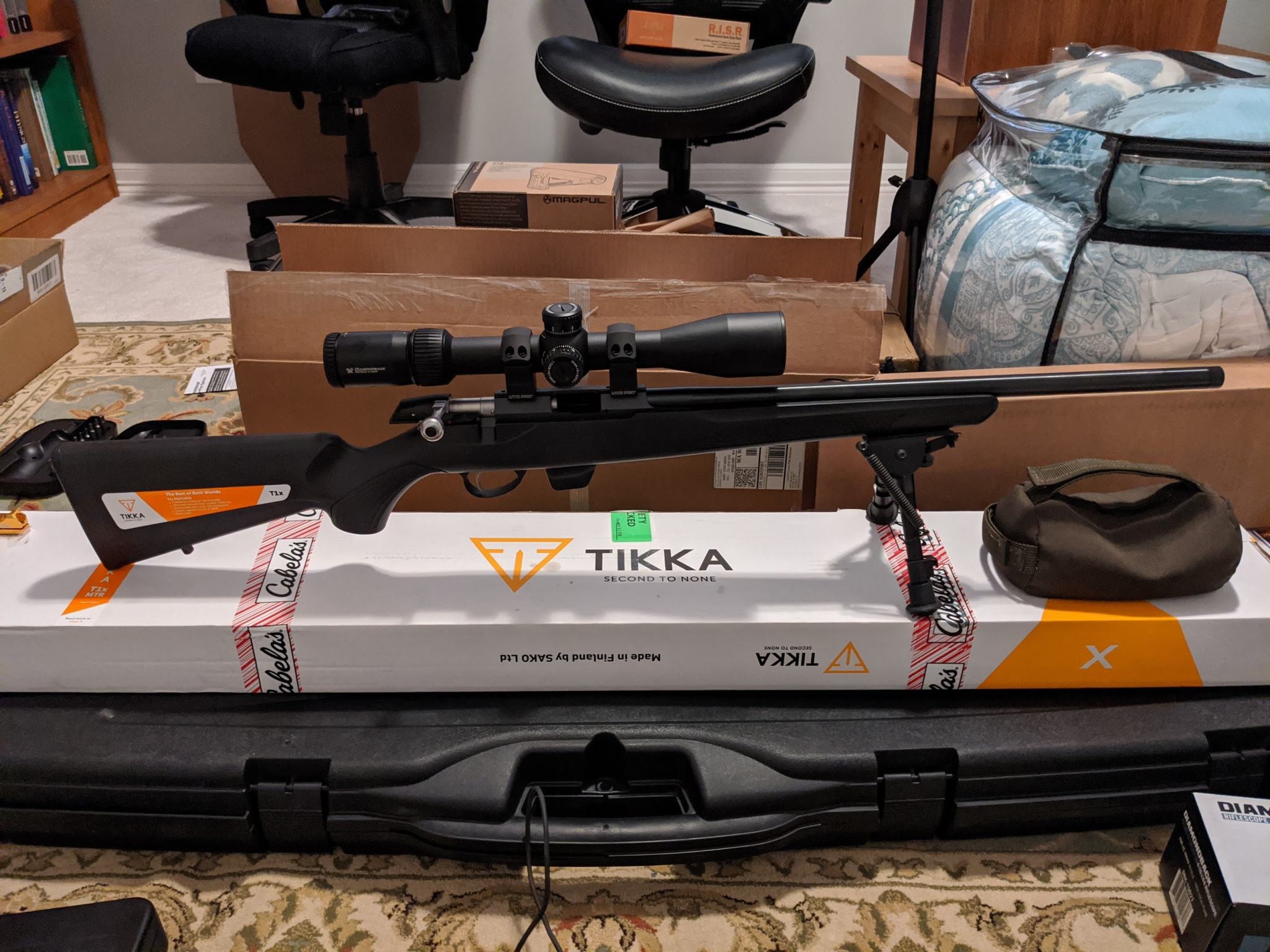

If you were looking to get into precision, and want a bolt. I think the Tikka T1X would be the way to go, or some CZ 457.
I looked at the new Ruger competition yesterday and a beautiful gun it is, just not $800 worth to me. I bought the Ruger RPR and put a Vortex Strike Eagle 3-18x 44 scope on it for the same money. I have 4 10/22's now and 2 have aftermarket heavy barrels and fit the bill for what I need. Just my .02
I also have 4 10/22 plus 1 cz455. I just need 1 more bolt gun leaning toward the t1x.

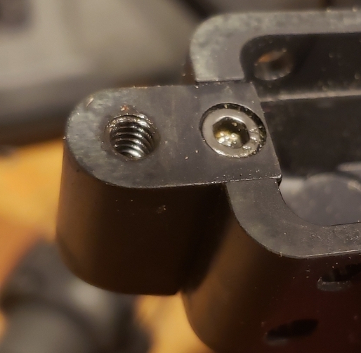

The factory trigger left me feeling sad, so I ended up dropping the 2-stage Kidd in it. Had to remove the slightest amount of material inside the inletting above the tang area to get it to fit.
I shot a mix of Eley (Force, Contact, Target), Aguila Super Extra Standard, Norma (TAC and Match), and Federal Champion Standard. I had FTE issues with the Contact ammo, everything else was 100%. From there, I swapped out the guide rod, spring, charging handle and extractor with Kidd, and using the -10% spring solved the Eley Contact FTE issue. When I went through all of that, I figured I'd swap the firing pin as well, but once pinned in, my Kidd firing pin won't move at all - not sure if it is too tight against the main retainer pin or what. Figured I'd play with that more later - might need to loosen up the retainer hole on the Kidd firing pin.
The part I'm most surprised by quality-wise is the bolt. It is actually pretty solid and slick, so I left that alone. Between it, the Kidd charging handle and spring/rod - it cycles like lubed glass now.

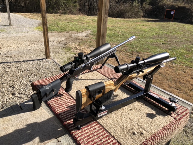

After another range session and in this final config, mine definitely shoots the Norma Match and Eley Force the best. I print in the 5 shot/.5" range @ 50 yards with those routinely and I am by no means the best shooter. I'm sure it'll change tomorrow when they make a new batch, but here's full box data for each of those out of the 16"-ish barrel from my last session if it helps anyone:

My thought is to use the Norma for suppressed and the Eley Force for hunting. I've seen Norma be a little squiffy through the years, so hopefully I don't have to do another multi-box shootout evaluation any time soon.
Overall, I do really like it, although I didn't purchase it expecting to turn it into a project rifle. It is my first 10/22, so I'm pretty sure at least half of my decisions were made through the haze of the "aftermarket kid (or Kidd) in a candy store" effect.
Personally, if I had it to do over again and knew I'd spend this much, I'd probably just consider one of those Volquartsen Summit straight pulls I didn't know existed before I started lurking on these forums - although the 'humpback' look on that receiver doesn't score high appeal points with me - but it still seems like a fine rifle.
