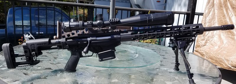

Just brought home my Ruger Precision Rifle in 6.5 Creedmore. It has a temporary scope on it till my Vortex Razor HD comes in and I can start shooting out to 1500 meters...well at least a 1000m for a while.
The compensator is clocked a little to the right and the lowest I can get the trigger is 2 1/4lbs
Overall impression is good ...trigger is OK if you are used to AR triggers this should feel just fine but having been used to real crisp, little take-up triggers on my other centerfire and rimfire bolt guns it feels a little weird, also its heavy and I'm sure it will get worse when I put the Vortex on it. I can't wait to take it out and test it to see if its money well spent or not.
The Vortex is perfect. I got the EBR-1C. Sunday I will go shoot the 600 yard. Wish me luck.
