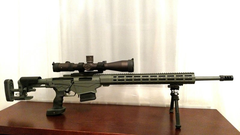

Hey guys I need some help, I just got a vortex 6-24x50pst for my rpr I need a set of rings to clear it. I had a vortex 4-16x44hst in a set of Nightforce (high) rings worked great. just want to know if any of you guys have a similar set up and you can give me some advice on a set of rings for the 50 to clear. Thanks
I use these. Gives my 2.5 inches of sight height from center of chamber to middle of tube. Sits just perfect on the top rail on my Bushnell ERS
http://www.badgerordnance.com/scope-rings/34-mm-dia-scope-ring-high-1-275-for-ar-series-rifles.html
Thanks for the info on the rings. After seeing seeing your rpr now I really want one of those MI handguards, is that the 15 or the 18?
