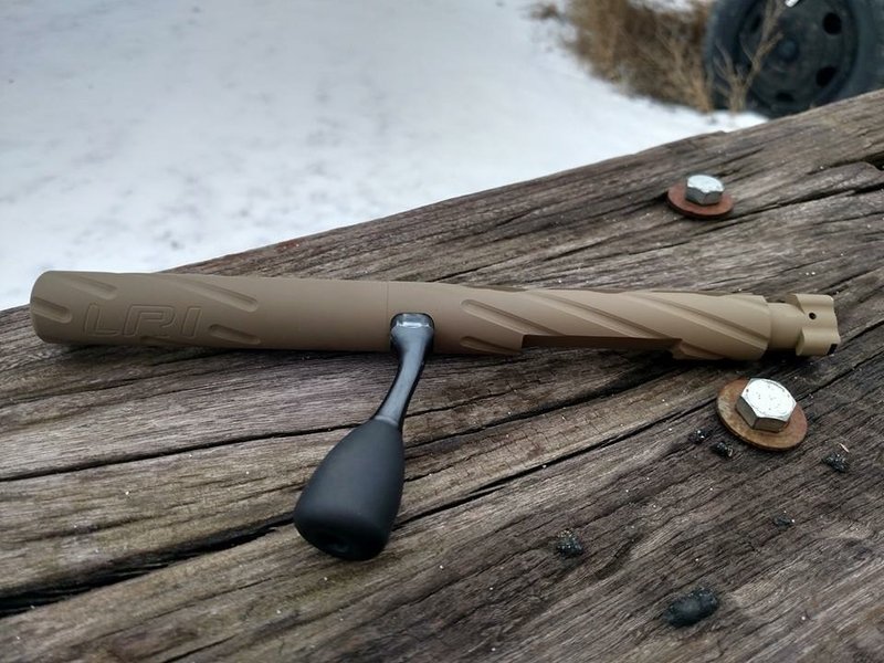

Ok so I found a couple on the FB group and this one looked the best as far as machining goes. I don't care for the cerakote.

It is an enhancement, but probably not the way I'd go with it. I too don't really care for the cerakote. After fluting, I'd want to see it shine and see that machining, and the coating kinda covers that up. The flutes are kinda far apart too. The ones on my MVP were a bit tighter and I think that looked better. It's ok though.
I like it too. But then you're gonna have a blank hollow space where your shroud should be with a closed bolt no?

Thats true but I don't think it would look that bad. Sucks about the snow.
