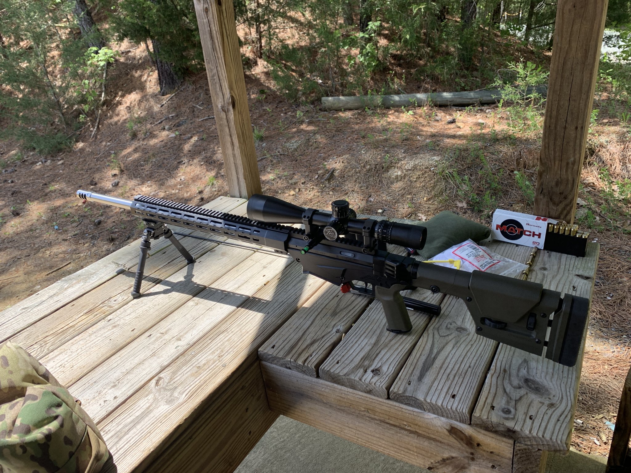

havent made it out yet mounted the scope and bipod, I had a leupold M3 laying around, so on my digital bathroom scale I tried it multiple ways including holding the rifle and subtracting my weight and all were 11.4 pounds 11 pounds 6oz
Leupold m3 21oz
Vortex Seekins high rings 4.7
gg&g bipod 15.4oz
so subtracting scope rings and bipod actual rifle weight is 8.8 pounds a little lighter than I thought, so Im 11oz over factory weight with scope and bipod
