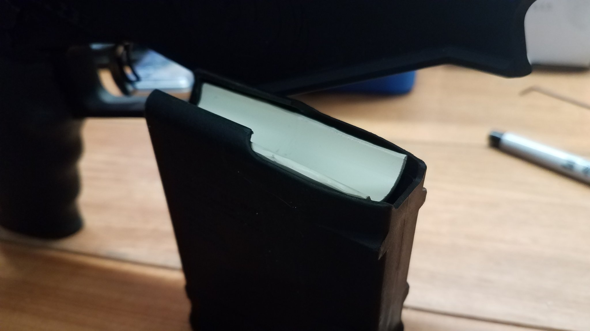

You can also put a piece of 3/4 inch (or 1 inch, I can't remember which size) PVC pipe on top of the magazine follower allowing single loading.View attachment 7111885View attachment 7111886
This. Cheap, fast, and effective.

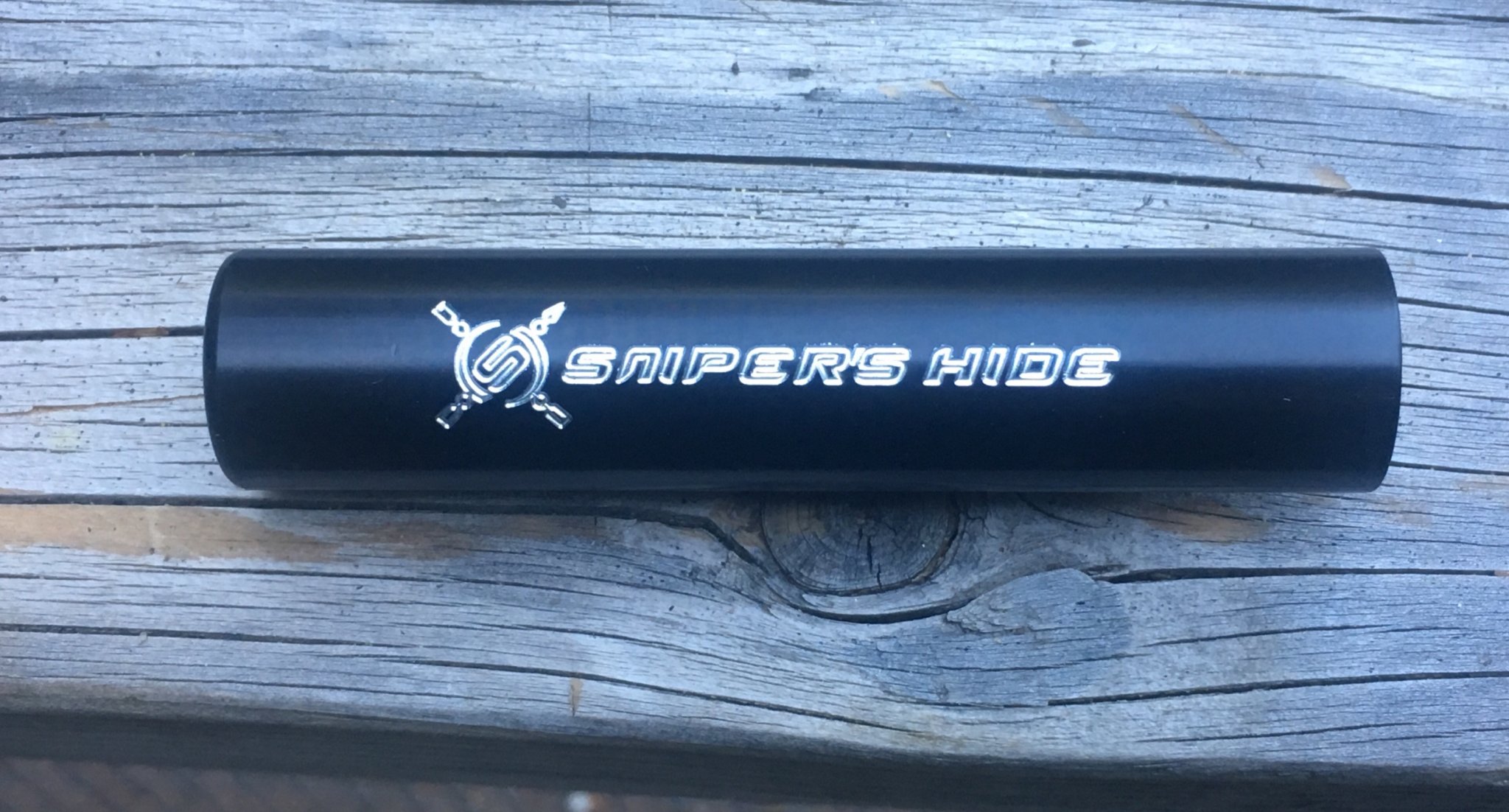

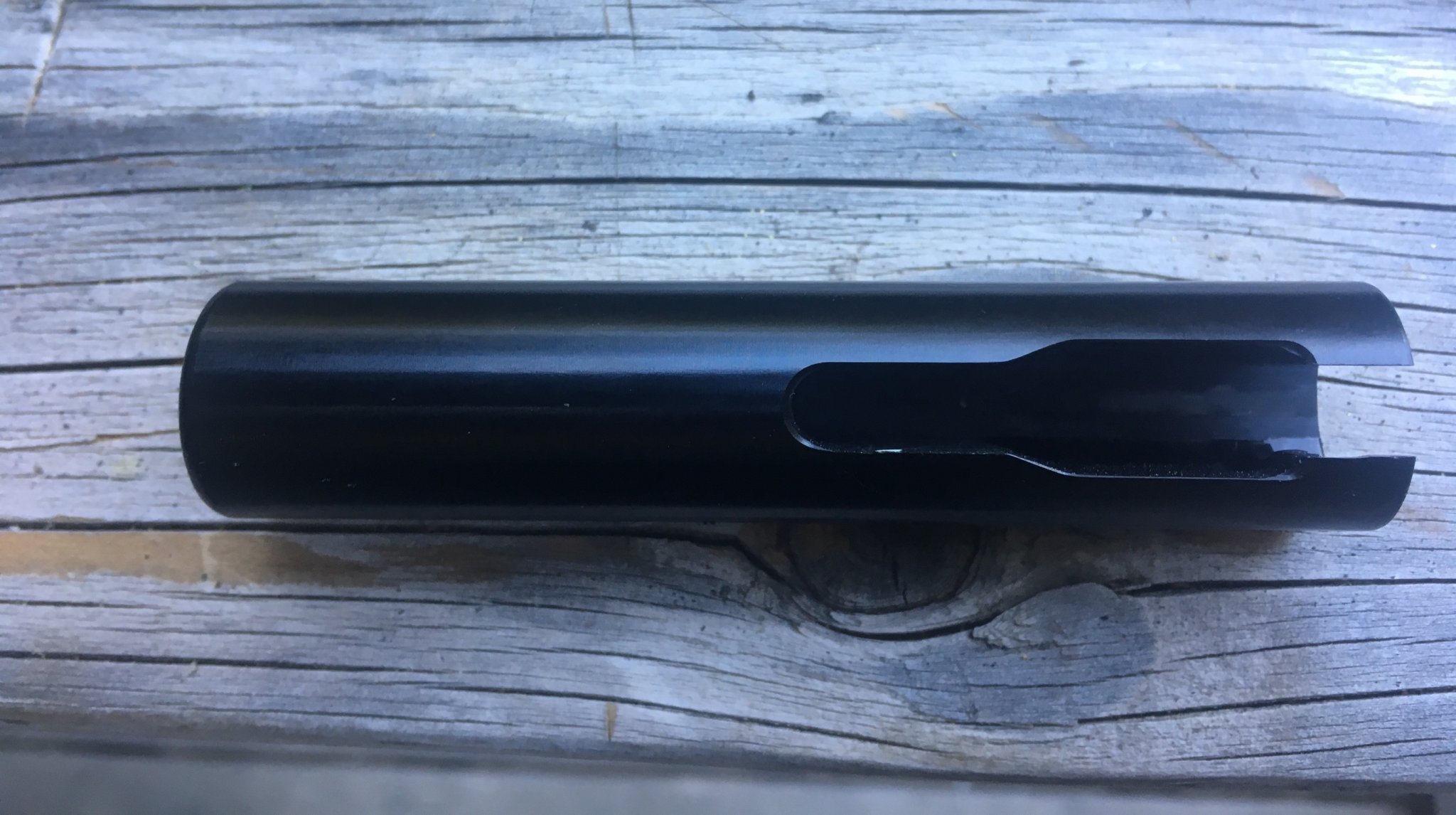

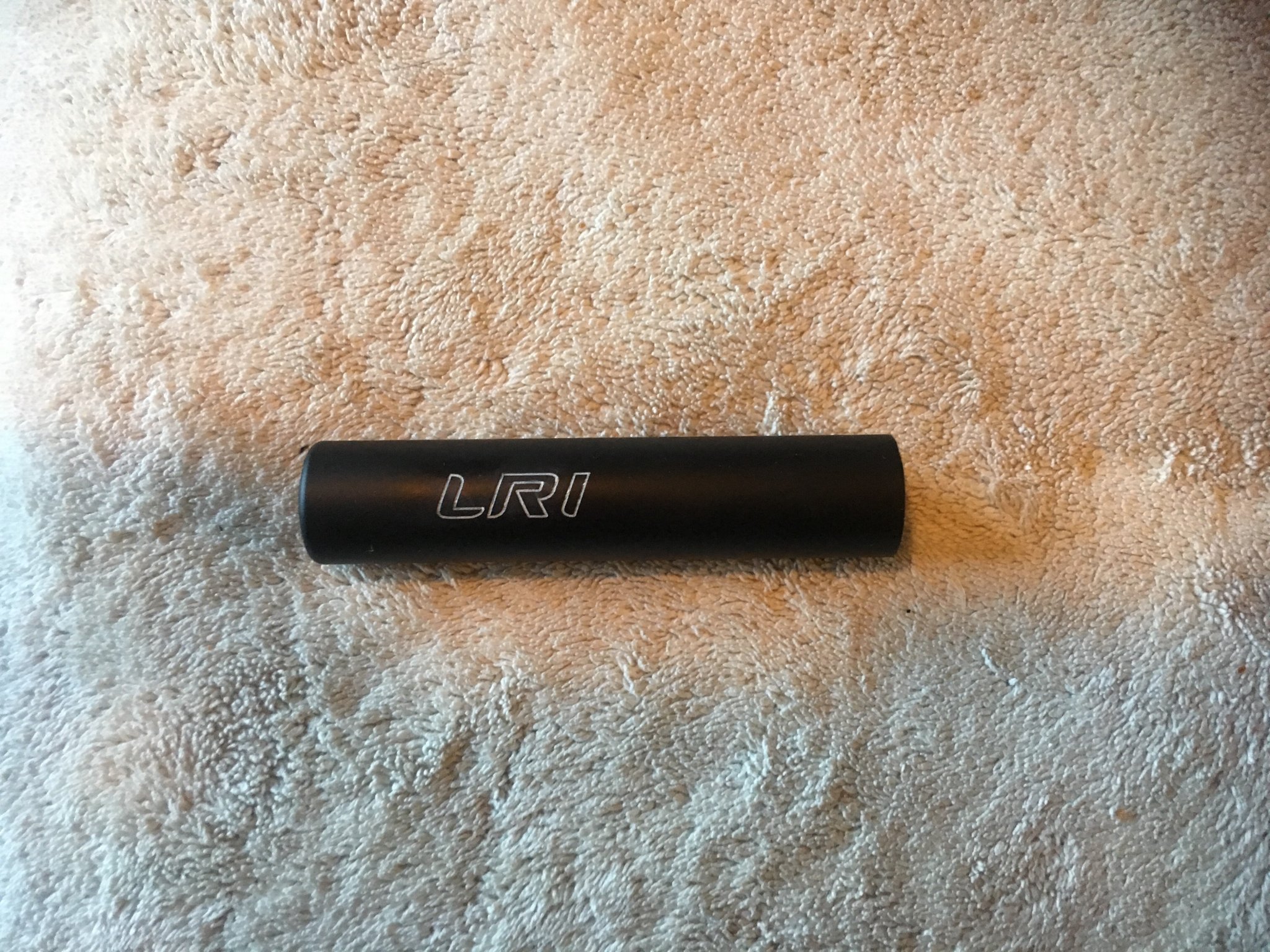

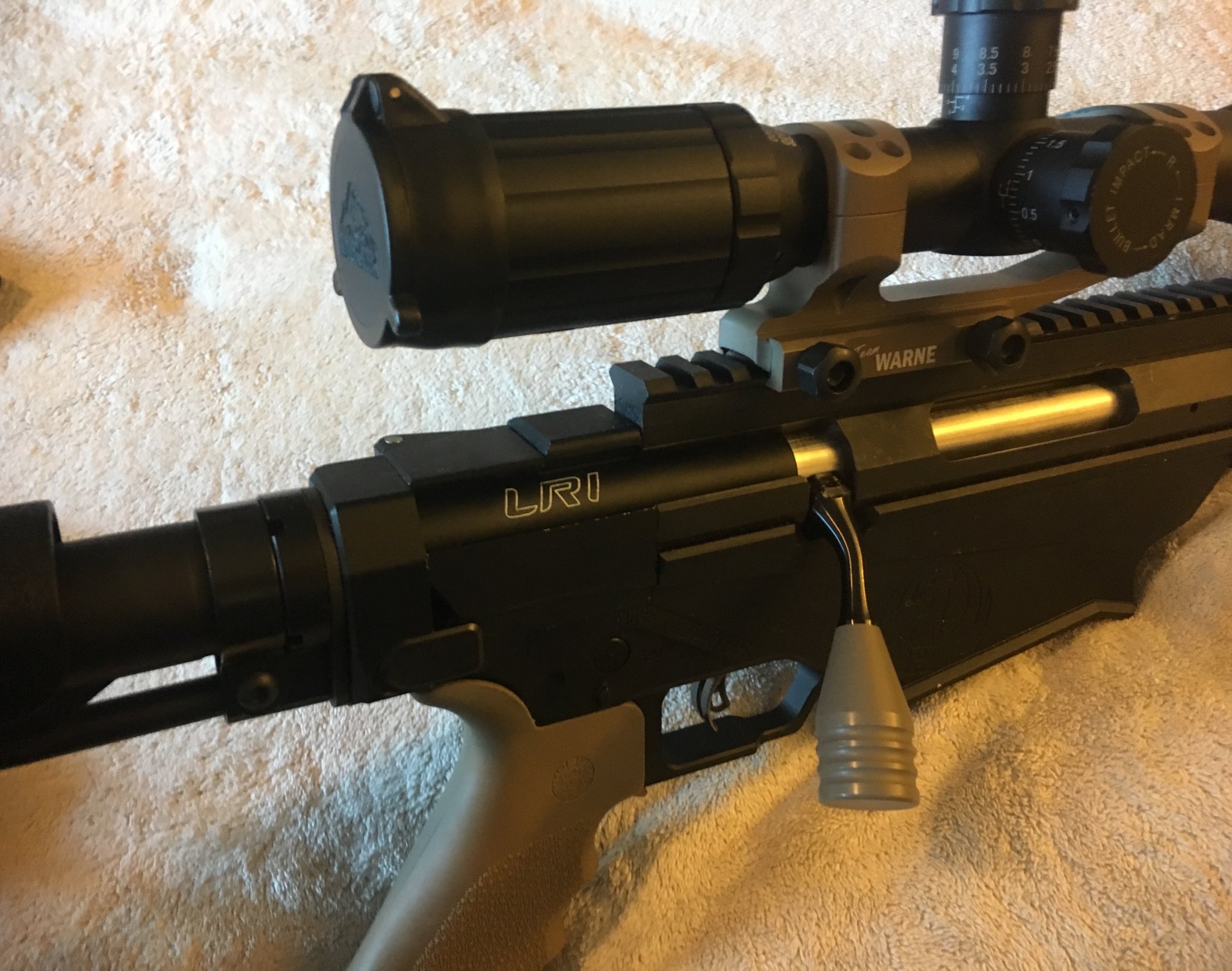

I have a Gen 1 or 2 RPR in 6.5 CM.
the replacement shroud that Ruger sent me is a piece of shit, it doesn't even fit correctly or snuggly.
Its all janky like a key on a keychain.
That said, I was looking at the aftermarket aluminum shrouds by LRI: Long Rifles Inc for about $60.
Anybody tried them? know about them? good? reliable?
thx
thx
I have one and it fits great. I had it cerakoted by them too in armor black (did the white inlay myself).

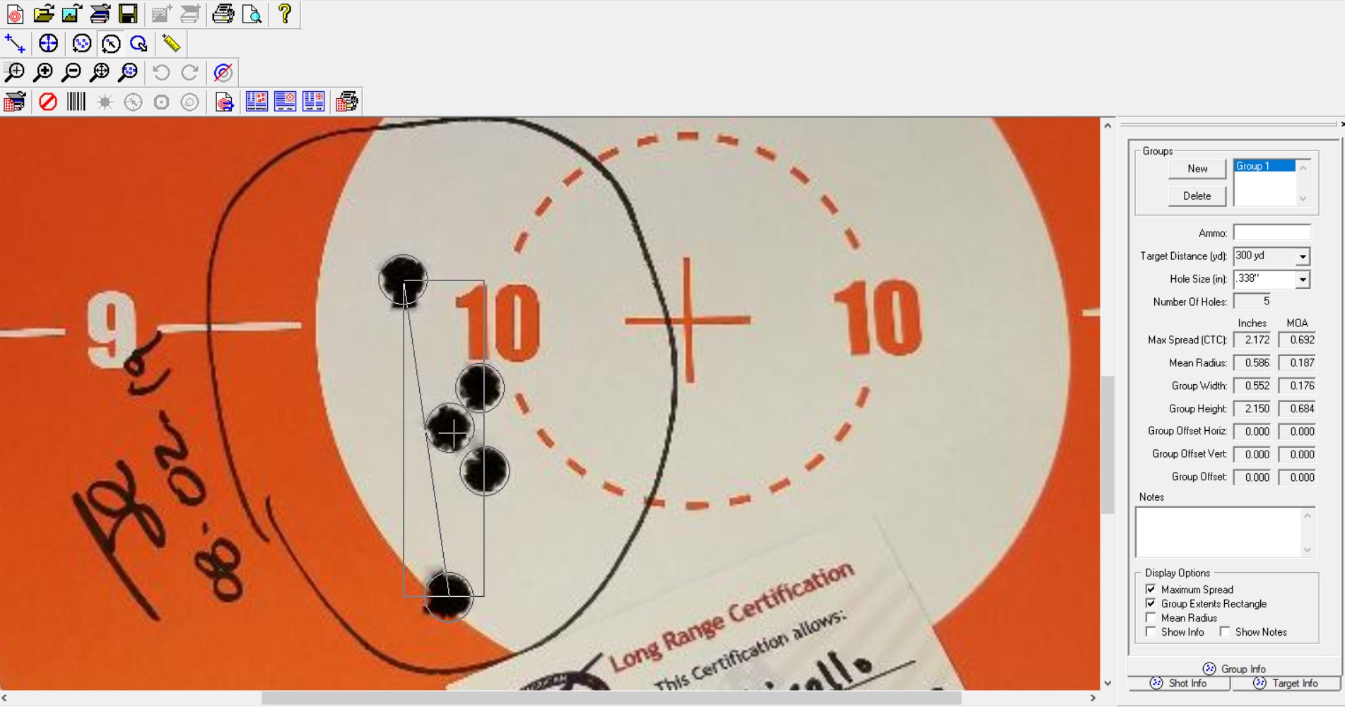

I just got a rpr in 338 and really enjoy it. I wont be doing hundreds of rounds at a session anymore, but did 60 on my first range trip with it. Target is from 2nd trip to range. 300 yard qualifying group for longer ranges.lm.jpg338qual.jpg

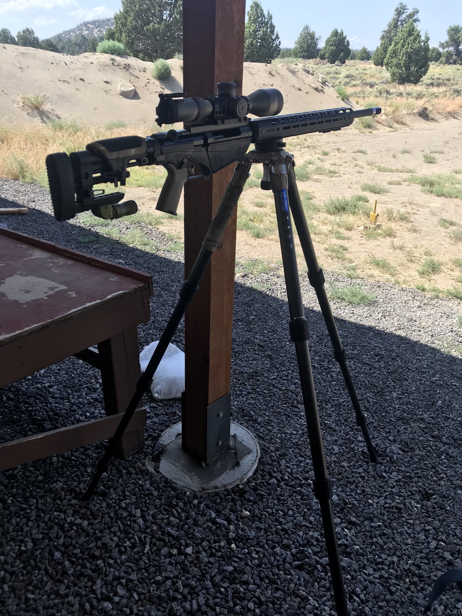

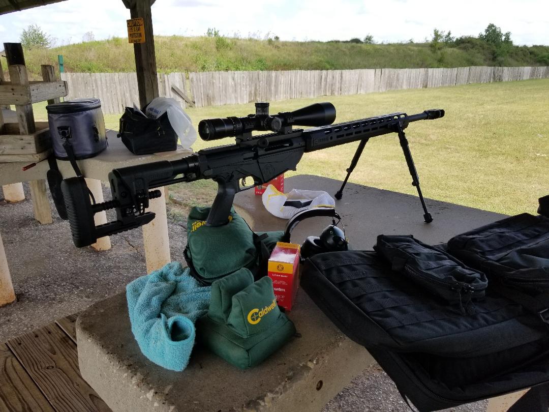

Been a while since I've been on here. Saturday was my first range day since I had mine Cerakoted. Went just for fun this time around. Next range day, I'll dial in again and get started on tight grouping in hopes of shooting competition next year. Have tons of brass saved up.
View attachment 7124788View attachment 7124789View attachment 7124790View attachment 7124791

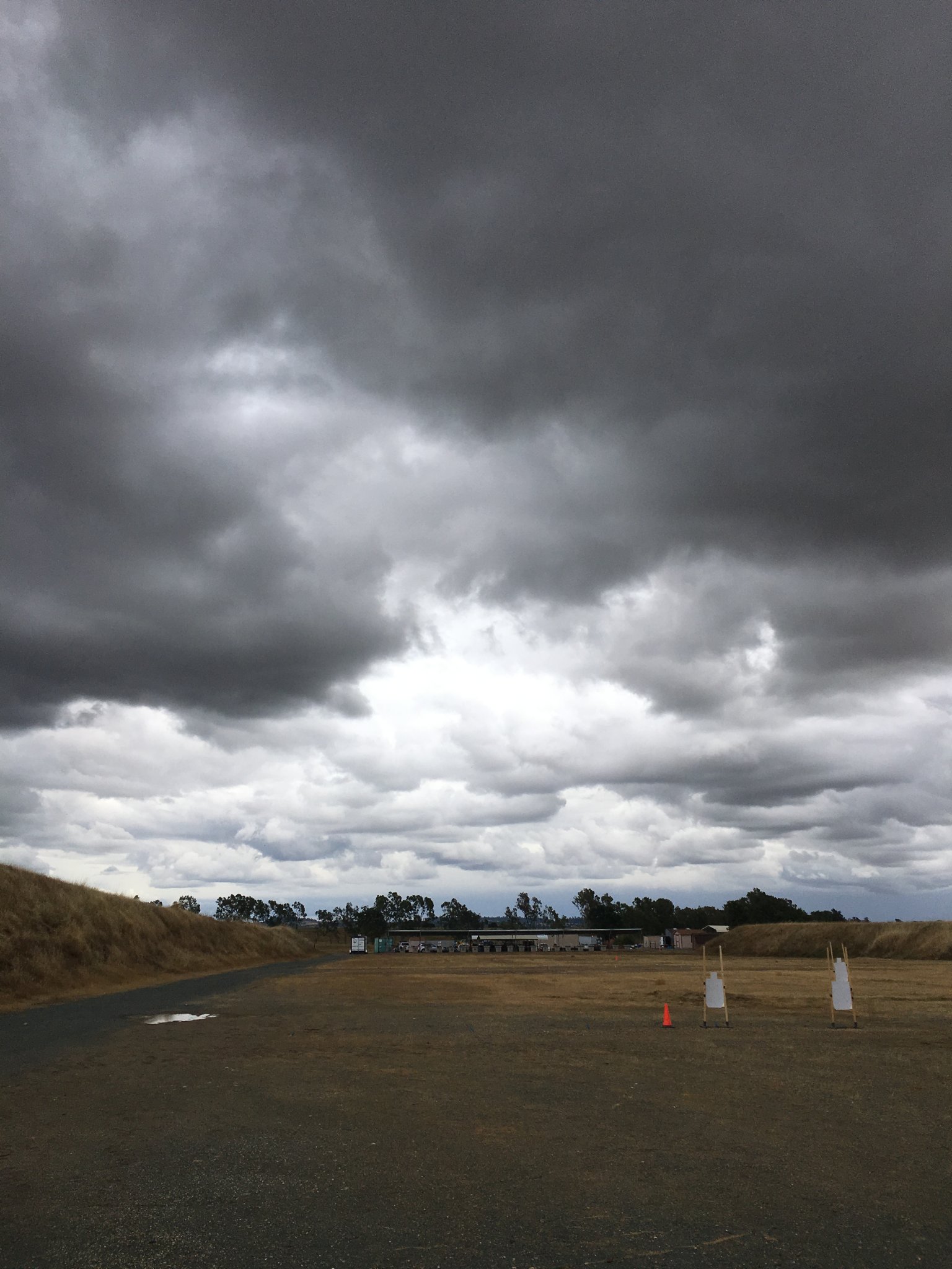

Those are nice looking (green) ranges.
In CA, you gotta drive up to a few hours just to find a range over 100 yards, and they look like this: In CA, we get the drought and dead vegetation, followed by big rain storms!

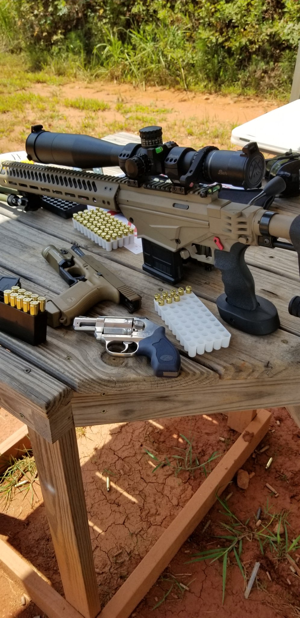

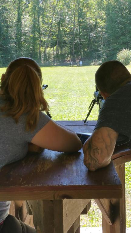

My lady shot competition in high school so it was like she was back on the range. She was hitting steel at 400 yards like nothing.
Sweeeeeeet. It’s so much easier when your wife is into it too lol. My wife just likes to shoot bench at 100 but she really enjoys it, and likes to shoot something tactical . She’s pretty good and shoots sub moa but is more the type that just enjoys firing it more than where it hits lol. She never touched a firearm before we got together
Reactions: GA_medic
