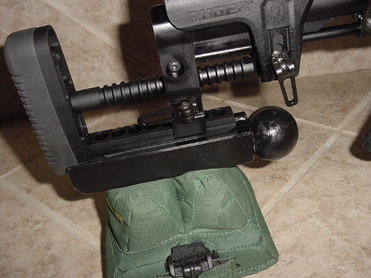

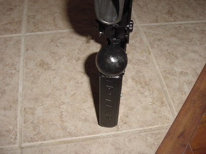

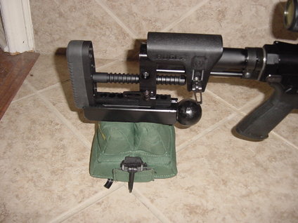

So I was hanging in the cave last night, and wanted to do something about the buttstock on the Ruger Precision before the match on Saturday. After looking around I gathered up a few loose pieces and fixed it. My issue with this rifle has been the horrid buttstock. Specifically the rough, unsliding bottom where the rail is and the sharp edges on the nose where a bench shooters hand must reside. After a 100 count day of shooting, my left hand felt like I had stuck it in a blender. The pictures show my version of a fix. The "rail" is a section of PLASTIXrevolution picatinney work block turned upside down so it engages the rail, some creative grinder work to taper the inside snugly engage the buttstock pad, a sliced off wood press handle ball, a 7/8" bolt and some JB weld. A little black rattle can to smooth up the appearance and the result is a slightly (1") elevated slick bottom bag rider with a very comfortable ball grip for pulling the butt into my shoulder. This helps relieve some of the tension I was holding on the grip to keep the rifle firmly planted in the shoulder muscle, leaving my trigger hand and finger with very little tension to get a great sensitive feel on the 1.5# trigger.

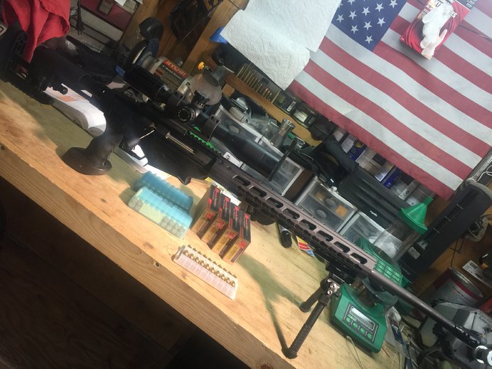

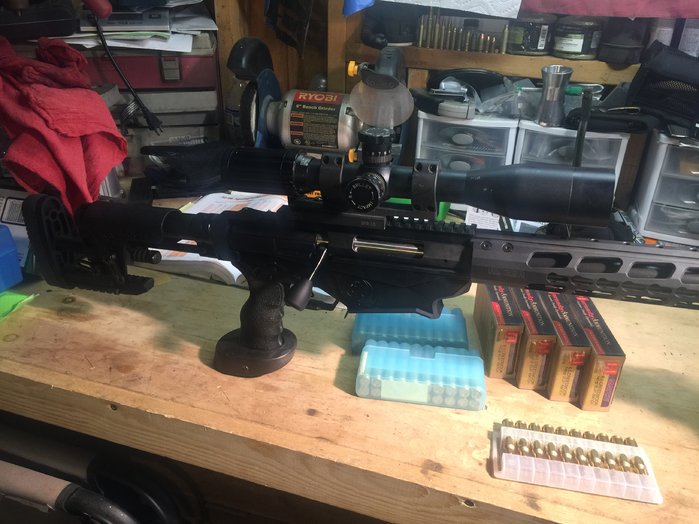

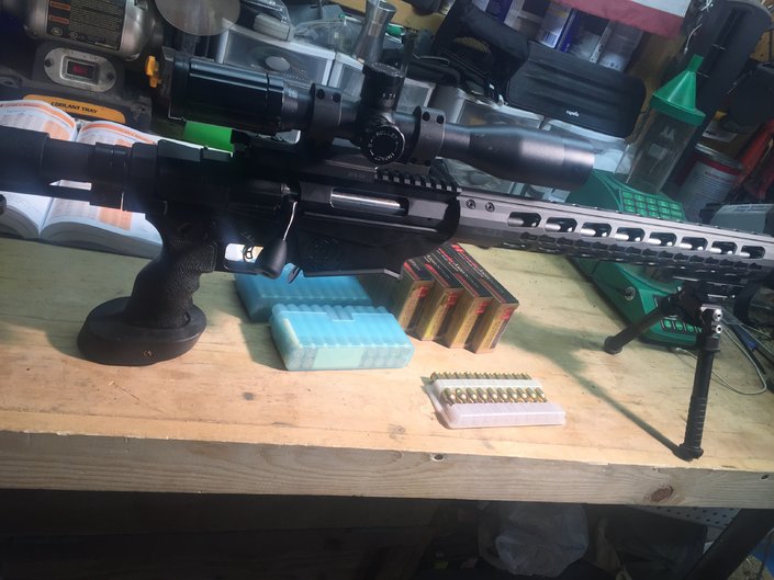

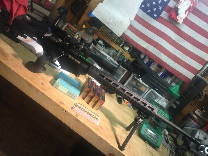

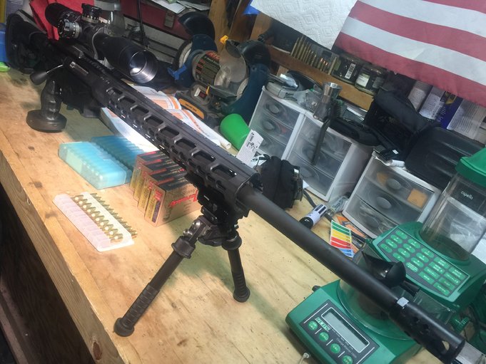

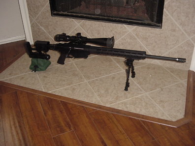

Just brought home my Ruger Precision Rifle in 6.5 Creedmore. It has a temporary scope on it till my Vortex Razor HD comes in and I can start shooting out to 1500 meters...well at least a 1000m for a while.
The compensator is clocked a little to the right and the lowest I can get the trigger is 2 1/4lbs
Overall impression is good ...trigger is OK if you are used to AR triggers this should feel just fine but having been used to real crisp, little take-up triggers on my other centerfire and rimfire bolt guns it feels a little weird, also its heavy and I'm sure it will get worse when I put the Vortex on it. I can't wait to take it out and test it to see if its money well spent or not.

My 6.5 CM RPR has the same issue with the brake. Does not affect accuracy. You doing much humping with that rifle Jarhead :) If not, no biggie on the weight.....it's lighter than a SAW w/ 200 round drum or a 240 :)
I changed out that clunky stock with a Luth AR MBA1 and sold the factory stock on Ebay for $200....that was a net gain monetarily. I'm going to shoot the factory barrel for a while and see how it goes. I have 233 rounds down the barrel and it seems to be settling in. I've been using Prime 130gr but have some Hornady ELD 140gr coming in to try next. Early indications are the Hornady is grouping a little tighter than the Prime. My trigger came very light out of the box.....almost a little too light from what I'm used to but I've grown to like it. Accuracy/stock trigger for a factory rifle is far better than anything I've come across (Remington/Savage).
My trigger was 1.99lbs when I got it. Most people I have spoken with have seen same thing. It seems roger sets the lightest pull when they ship them.
I just want to know how in the hell the barrel is canted on mine. Not just the muzzle brake which has no effect, but why is my barrel pointing to the right. As far as assembly goes doesn't the barrel get screwed into the receiver then just tightened down? Makes me think the hole and threads for the barrel cut into the receiver are cut at an angle. I would hate to put a nice barrel like the ones offered from LRI in it and the new barrel be off to the right too. Either way still shoots lights out.
^ I actually use it for both and it works very well. The bench is of course more rigid and I find it likes to be given an inch or so to ride back. Long range I use it prone on my mat.
Thanks.
I had borrowed a friend's monopod and shot with it prone a bit. I'm not as bendy and I was in my youth and at the height I have to have things, the monopod felt a little wobbly.
A pity. It looked really good on the rifle. ;) I bet it would be fine on a bench. I might borrow it again sometime to make sure I was not just reacting to something different.
No problem. Mine got a little wobbly after some use too. So I put some blue loctite on the screw that holds it to the rail and have been good ever since. To be honest, I probably squeezed the tiniest bit more accuracy out of the rifle by using a bag, but it's so convenient that I've just stuck with it.
