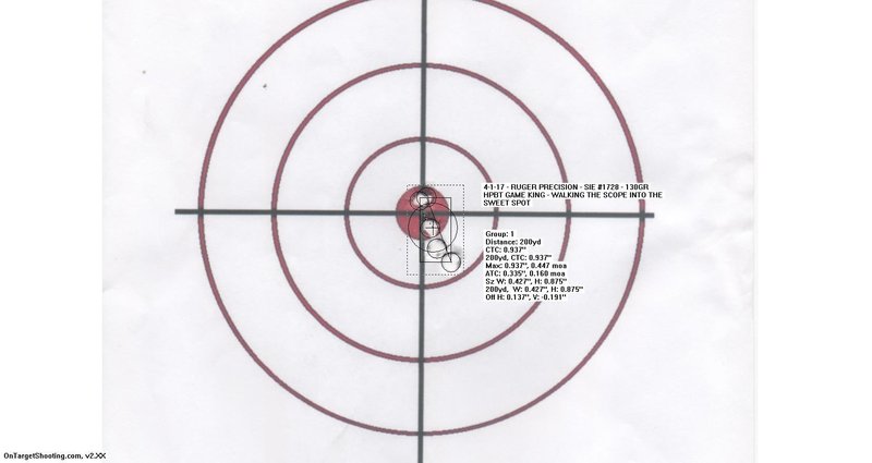

Just joined and this is my first post here. I picked up a Gen II in 6.5 last week and went out Saturday to break it in. I am very dedicated to a break in for ANY rifle, have been doing so for more than 50 years and have always achieved great results. 1 X 5, 5 X 5, 10 X 7 = 100 rounds, full cleaning after each set with a jag and Butch's bore shine. The copper that came from the 6.5 barrel tells me that it really did need a proper break in. The first of the ten round sets produced solid bright blue patches, lots of copper. By the time I got to the last set of ten, copper had subsided to a very light mild pastel color, telling me the barrel was smoothing out. Along with that, the groups got really tight. The link to the progress pics is https://photos.google.com/share/AF1...?key=WDhwTS1FU21hcENSMGprWkJreFNLUVZqMU1KNlFB

While breaking in I used a Rem 700 bore guide (Possum Hollow). It worked, but was a very loose. I contacted Possum Hollow via telephone - (Call 321-338-7757 and ask for Eric). The #313 is for the 308 parent case rifles. It is not in the dealer distribution chain yet, but they will ship direct to the user for 25.00 each. Mine is on the way!

Very cool to see the progression like that! Thank you. Never been very big on the cleaning rituals during breakin myself. It would appear you and the rifle are damn good shooters. Awesome groups at 200 yards.

Grizz44Mag ....... nice grouping at 200Y and especially nice watching those groups tighten up as you went.
I appreciate the comments and responses. I have used a break in process since I watched my grandfather do that on a new rifle (somewhere South of 1960) and had such a deep respect for him and his natural ability with a rifle that I have always followed suite. After meeting Dan Lilja and being exposed to his philosophy on breaking in a barrel, my dedication to a break in routine was re-enforced. Dan makes some of the finest barrels I have ever purchased. I built a 6.5 Creedmoor on a Bushmaster Gen 1 receiver using his LFAR 1" target barrel. It's a shooter and will hold .6-1 MOA. For an old semi-auto that really impressed me. I have two more of his barrels on bolt guns. His recommendation on breaking in his hand lapped barrels is pretty much the same as how I do mine, except he reccomends the use of a bronze brush. I don't use them except in extreme cases. http://riflebarrels.com/support/centerfire-maintenance/ Breaking in a hand lapped barrel is normally much quicker and the copper deposits taper off much quicker. The factory Ruger barrel on the Precision was chewing the copper off the jackets at a pretty heavy clip. Copper in the throat that has not been evenly deposited is an issue. I have spent time recovering several Rem 700s from close friends that had great shooters they did not clean. When they went South on accuracy, I got a hold of them and got the copper out. I have almost always been able to save a coppered up barrel. Your rifle may shoot great now after a few hundred rounds, but I'll bet it goes sour a lot quicker than it should.
