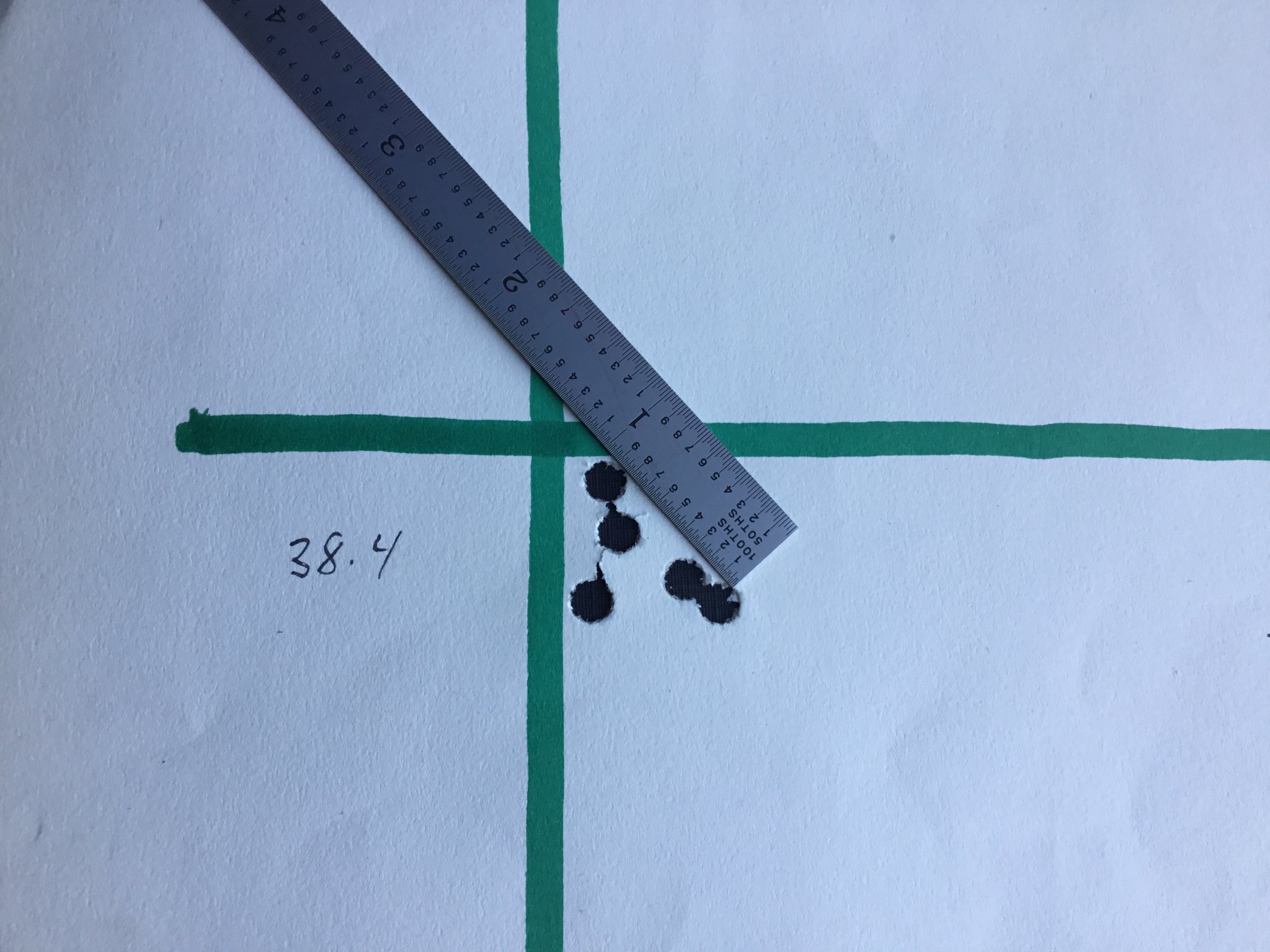

My trigger is actually pretty nice. I haven’t put a gauge on it but it breaks clean and feels light enough. I just got this rifle a week ago so I’m still getting use to it. I’m going to hold off replacing the stock until I shoot it a little more. The LOP kept coming loose but I really tightened up the cam lever and that seemed to work. I’ve been doing a little barrel break in and load work at the same time. Groups are not terrible, hopefully they will shrink some with a little more work. Here’s the best 100 yd. group so far.
The groups will get a little better after break in. Try different cartridges to see what it likes. My factory barrel like 130’s. Others have liked 140 and heavier.
