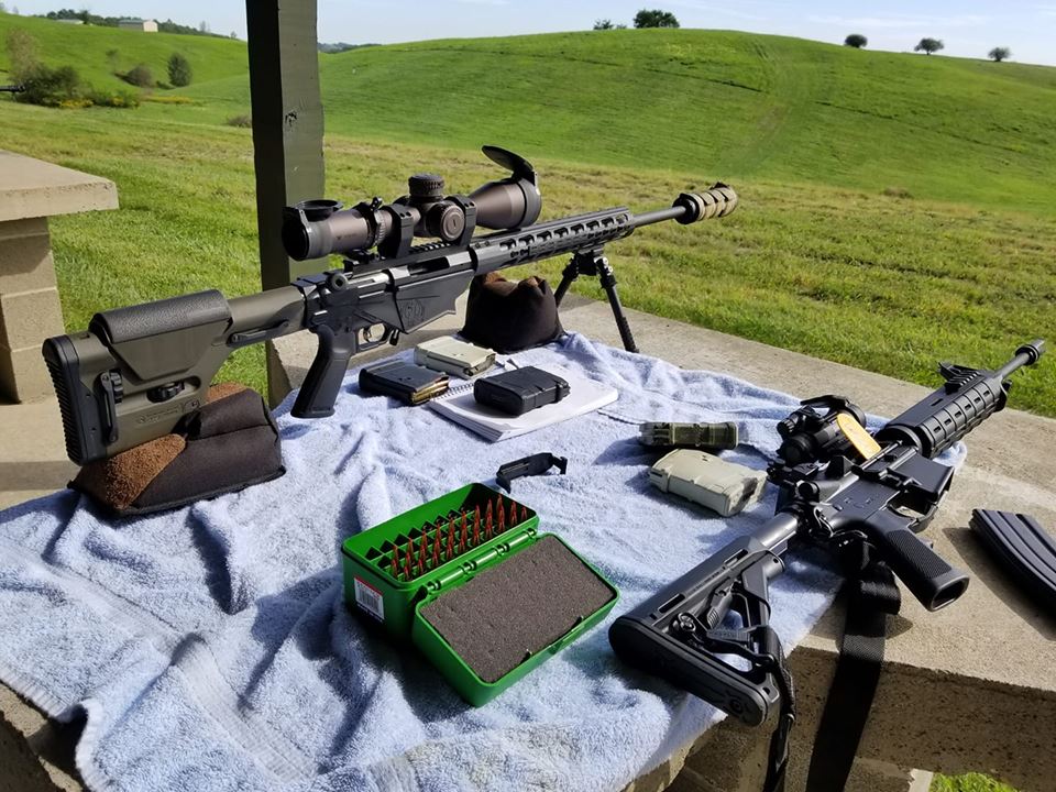

Definitely helps your groups when you get a quality rear bag. It was 107* in the desert today when I shot this group. I have 120 rounds down the pipe and it is really getting dialed in.
Kudos to you for being out shooting in that kind of heat. Down here in Phoenix area I get out early and quit when it gets to 100°F. I'm too old to put up with that kind of heat. :eek: ;)

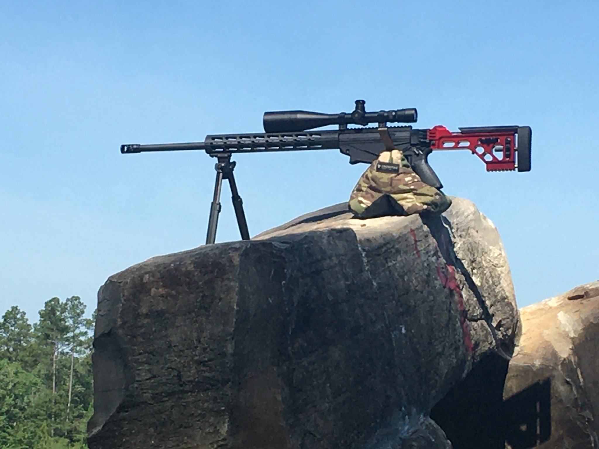

Original stock was a pain to adjust and collapsed without warning as well.
Target Tool Stock, pricy but a really nice addition. Stiffer and seems much easier to shoot different positions. Also easy to adjust and the adjustments stay set.
It definitely is much easier to adjust and much nicer overall. I'm very pleased with mine.
