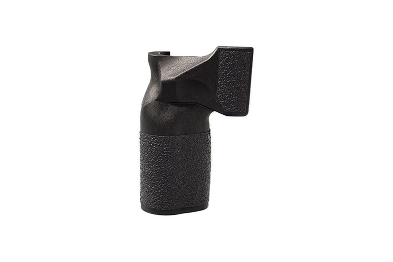

Just bought this in 300 PRC and looking at upgrades. I've already ordered a fluted titanium shroud and going to get the magpul prs stock but as far as grip and replacement of the firing mode selector I'm stuck. I don't like how the selector feels against my thumb so want an option, saw the seekins on Anarchy Outdoors and want to make sure this works with it.
Also anyone have a suggestion for a rifle grip that has a decent thumb rest for a right handed shooter? Thanks for the input folks!

I put the MPA-EVG from Anarchy Outdoors on my RPR. When I first got it I wasn't sure I was going to like it as the grip felt so much larger the the factory grip. But it really did help with my shooting consistency and I've gotten used to it to where I now love it.

Anarchy Outdoors also makes a straight grip for the RPR called the Penguin. If you have larger hands they make a larger version called the Emperor. Both have a thumb rest.

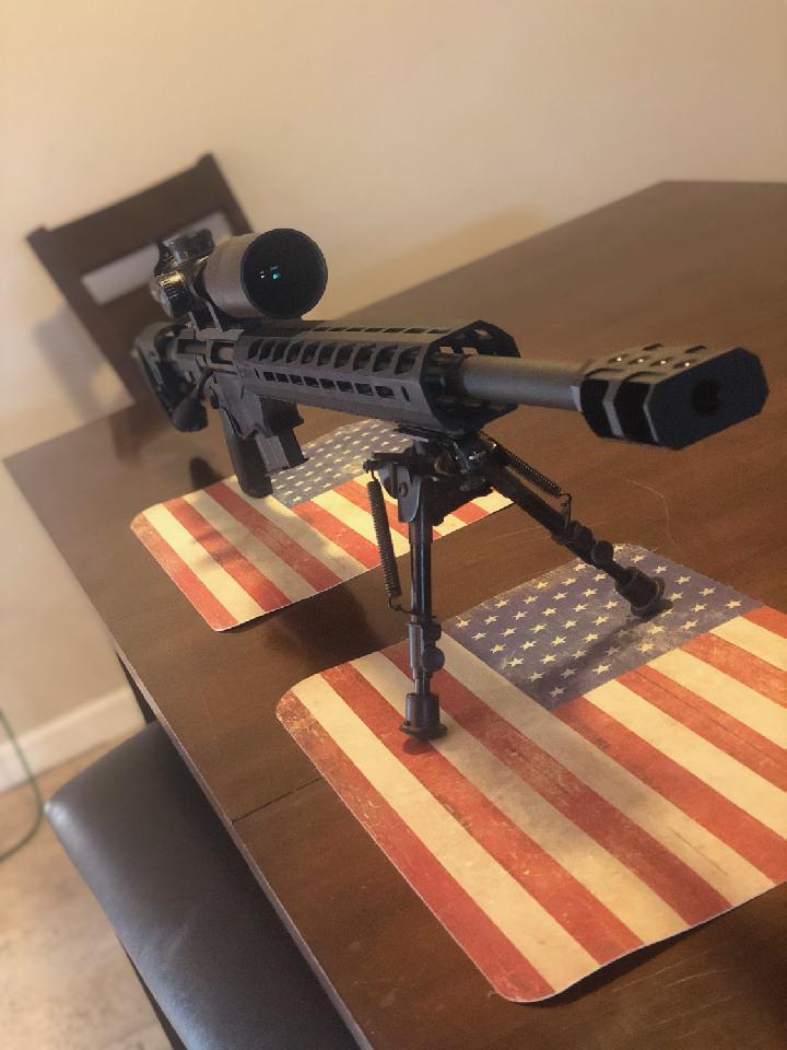

Took the new .300PRC out to a 100yd range today to sight it in. I was suprised by the lack of recoil. It has maybe a quarter or half the recoil my AR-10 does. Also, I love the stock trigger on it. From a trigger perspective, my only comparison for is my Aero Precision AR-10 with factory trigger, but I was really pleased with the trigger on the RPR. I saved the targets and can post them if anyone is interested, but just based on eyeballing it I'd say I'm getting .4 MOA maybe slightly better.
