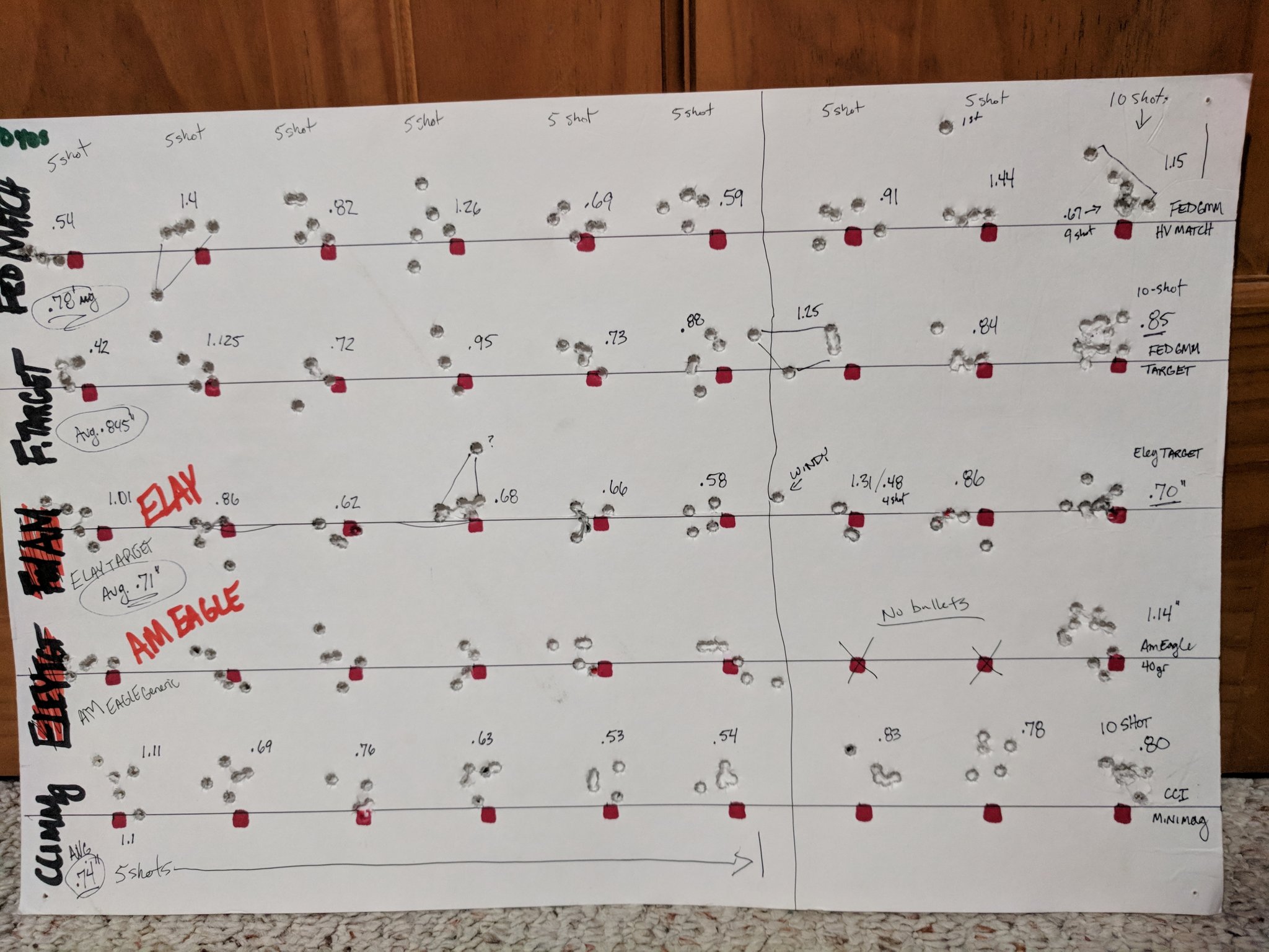

Shot my RPRF (like this name so as not to be confused with the actual RPR) today for first time. I took my time scrubbing the absolute s&@t out of the bore because it was filthy; took nearly an hour of scrubbing to get rid of the dark brown crap they coat the bore in to prevent rust.
Shot it at 50 and 100yds with FGM HV Match, FGM Target, Eley Target, CCI MiniMags, Federal AutoMatch and some generic Am Eagle 40gr. Target pics below but at 50y, I shot 30 rounds into separate 5 shot groups for each ammo then circled back and shot two more 5 shot groups and a 10 shot group. Figured for a new barrel that would let me work in the bore a bit and retest each to see if they improve over the first 200-300 rounds.
FGM HV Match 5 shot avg .78" and 10 shot at 1.15/.67. one first round flyer way out of group.
FGM Target 5 shot avg .845" and 10 shot at .85"
ELEY Target .71 5 shot avg and .7" 10 shot
Am Eagle didn't bother measuring 5 shot avg but 10 shot was 1.14"
CCI MiniMags .74 avg 5 shot and .8" 10 shot

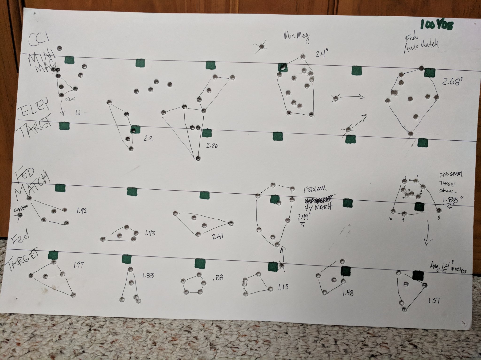

At 100 yards, most stayed pretty close to double the 50yd groups.
Fed HV Match 1.92" 5 shot groups and 2.5" 10 shot
Fed Target (best ammo so far) avg 1.4" 5 shot and 1.88 10 shot (note first 7 shots landed in .85" then next 3 dropped low as wind switched into face)
ELEY Target 1.8" avg didn't shoot 10 shot
CCI MiniMags 1.5" avg and 2.4" 10 shot.
Fed AutoMatch 10shot group 2.68"

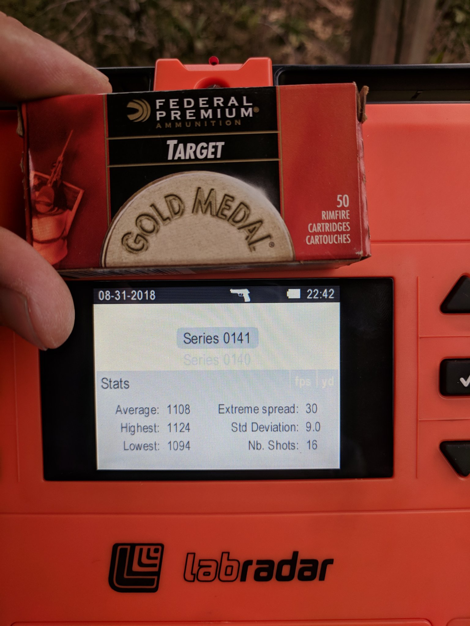

So I finally got to Chrono my RPRF and I'm a very impressed with FGM Target. Here is a 16 shot string:
And I'm beginning to think the accuracy issues (flyers specifically) are not so much with the ammo but with the bedding/vblock. I shot several different ammo types today before bedding with aluminum tape and am about to go shoot it after bedding. Also, I taped two layers on each side of the vblock to make it anmuch more firm fit into the stock.

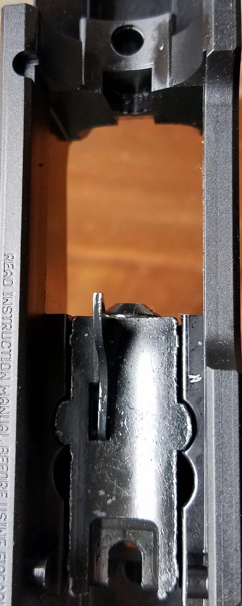

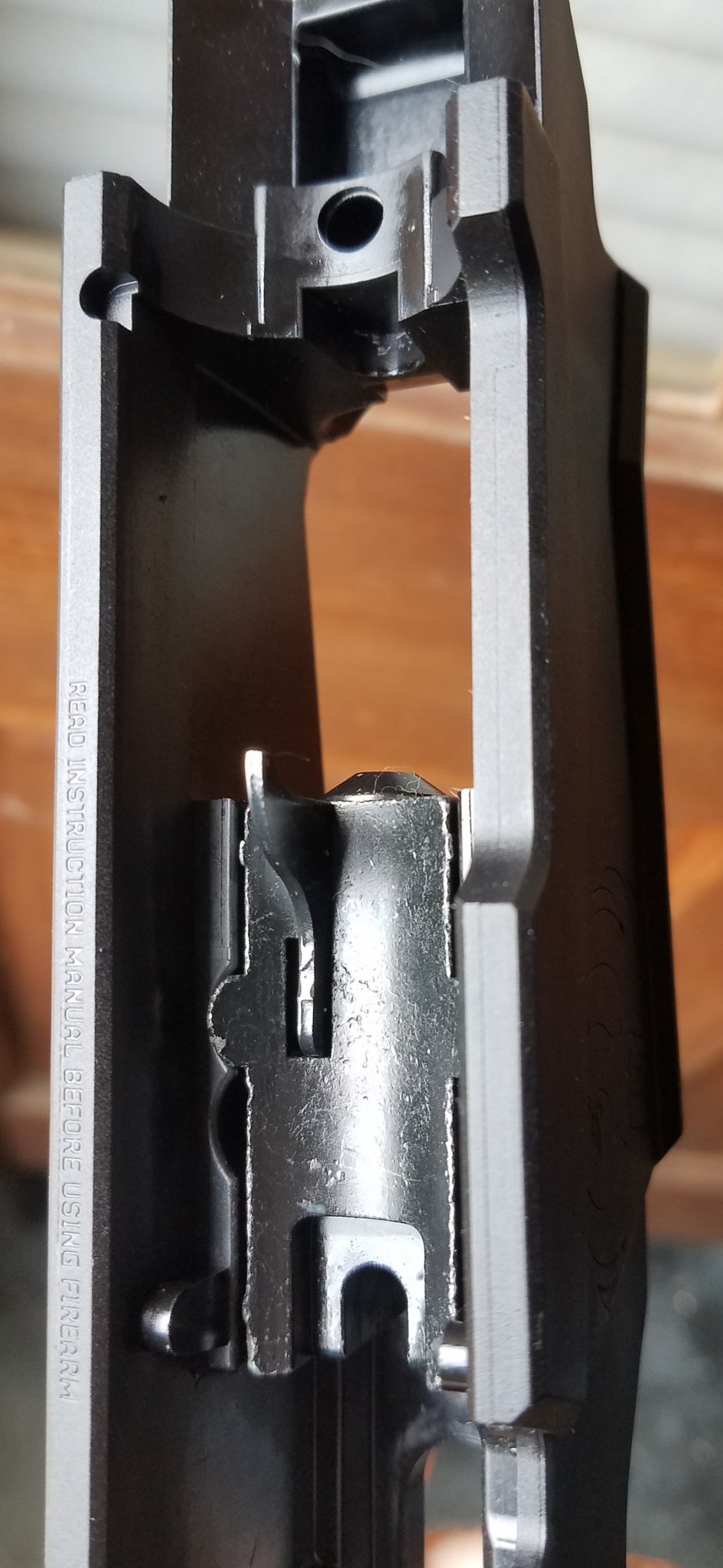

It appears to be aluminum shims of some sort on the lower where the action is bolted to receiver?
I'm not a professional gunsmith so thoughts are very mucg appreciated, as are ways to modify/improve the bedding.
Here's some pics in case some of you haven't taken yours down yet. I torqued action screws to 35in lbs.
View attachment 6939014View attachment 6939016
Here's an aluminum tape application on the action to bedding block surface:
With my gun the action rocked fore and aft a bit due to the rear take down being a bit higher. The tape neutralized the rocking..... in MY gun.
