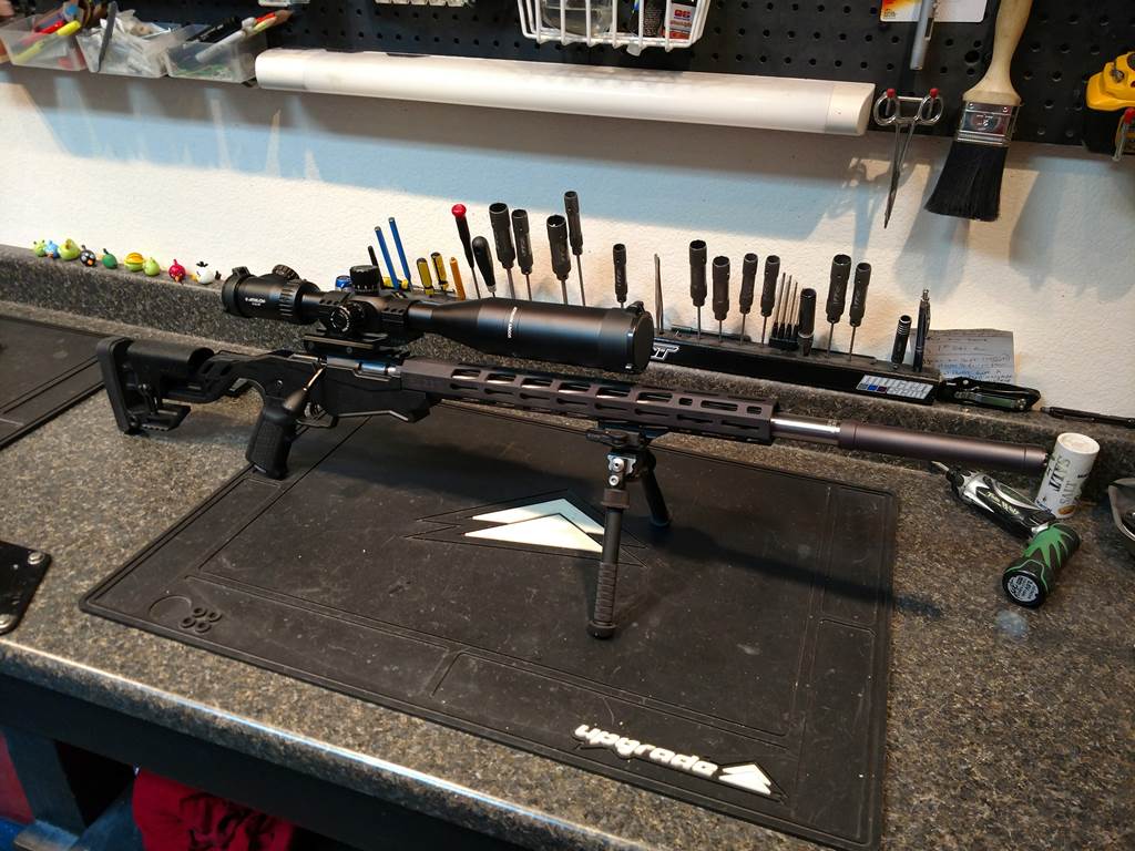

I have the first ER Shaw RPRimfire sent out the door. I have been very impressed with it. It is very well made and I couldn't ask for better accuracy. I honestly think they could charge another $100 for them and it would still be a good deal. Mine likes Federal Match and Eley Match.

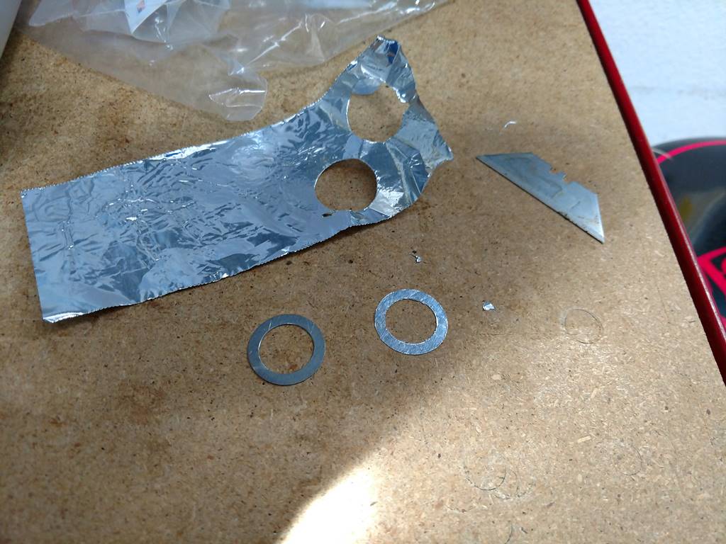

Almost forgot..i beded my action with alluminum tape where action and barrel block sits... It shoots with my kidd 10/22 now...

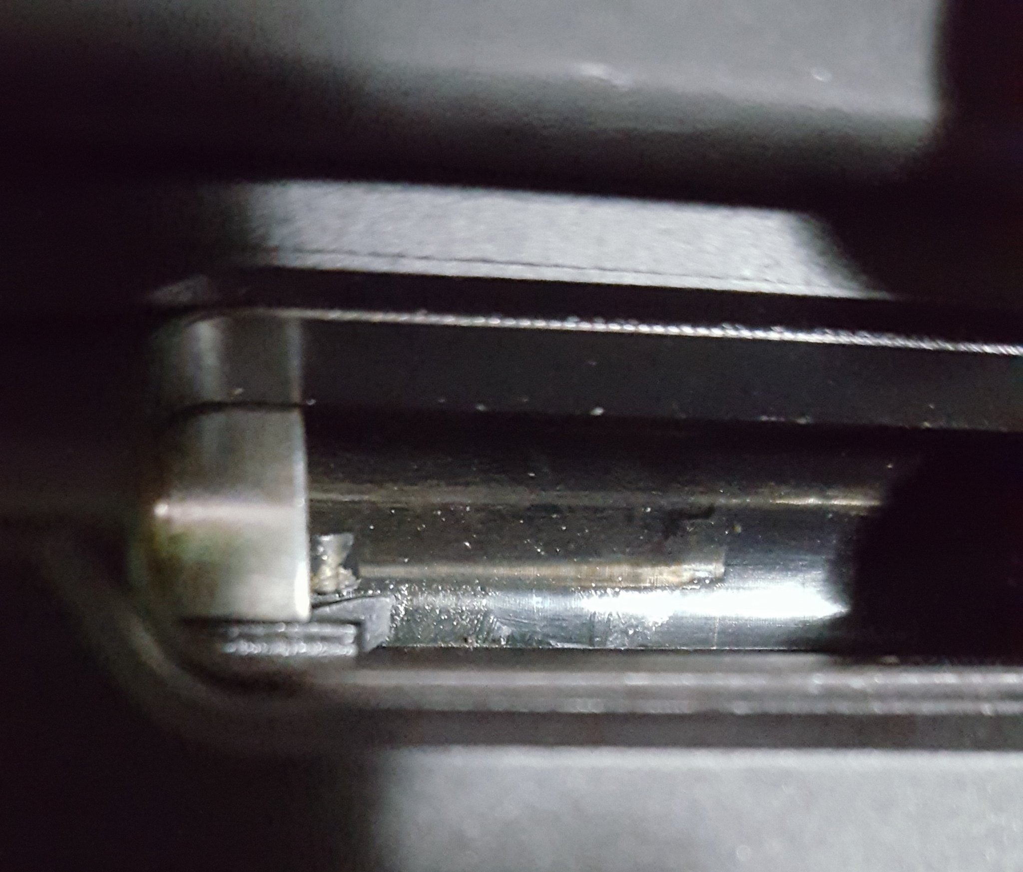

What is with their warning that "unfired rounds will not extract"? Anyone had an issue with this?
It seems they have that warning because of the "tight chamber" and the differences between various manufacturer's specs for their ammo. I hadn't given this much thought until now and as a precision reloader, cartridge specs are really important. So, I went at it and measured some of the various .22LR cartridges I have to see the difference. Here's what I got:

They state reason in the packaging of barrel but it's easy to miss. There is no freebore in this barrel; the rifling engages bullets as soon as you start to close the bolt. Most if not all bullets are jammed when closing bolt, so extraction will be very hard if unfired.

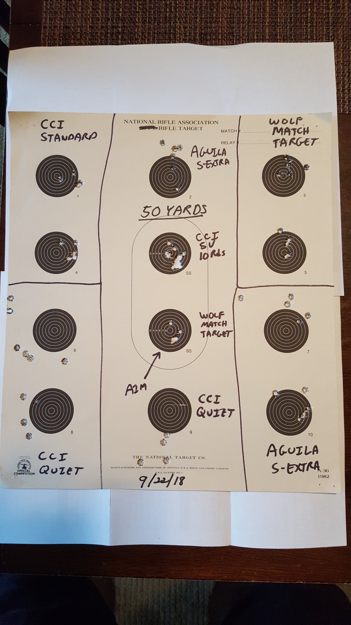

Only had about 50 rounds through it. I cleaned it and retorqued the action, hopefully I can get out and test it again. Lrps260, I was using Aguila Pistol Match. Had great results with it the last time out.
That's likely part of the reason. I'd shoot at LEAST 100-200 rounds before I start looking for any serious precision/accuracy analysis. Just crossed around 900 rounds with mine and it has shrunk considerably with most ammo. CCI Standard Velocity: started at .5-.6" 5 shot group average and now it's .3-.4" 5 shot group average.
I'd recommend buying 4-5 boxes of CCI SV or Federal Target and shooting those through, then buy 1 box each of a variety ammo. CCI SV, CCI Green Tag, Fed Gold Medal Target, Fed Gold Medal HV Match, Eley Target, Eley Club, SK Rifle Match, SK Standard Plus, etc.
Shoot those after you cross the 200-300 round mark then see report back.

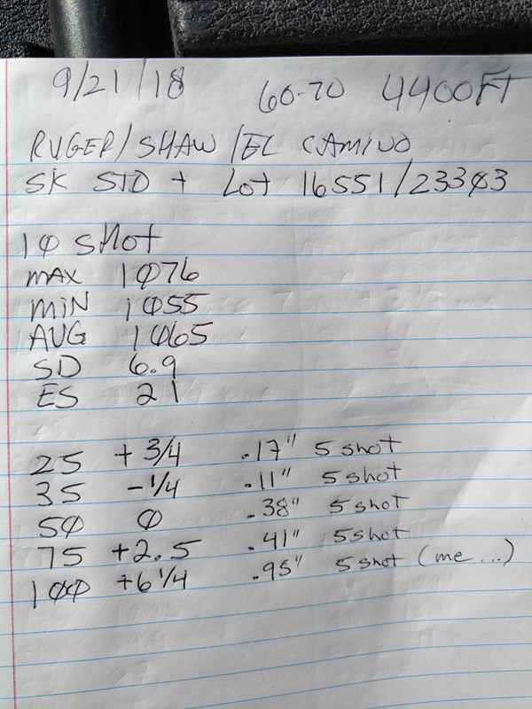

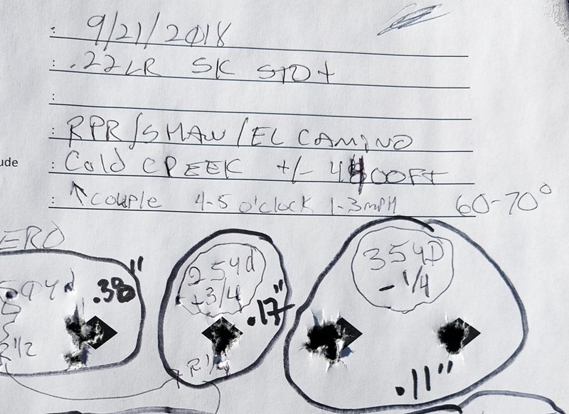

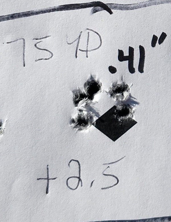

Ran a torque tuning test on RPRF yesterday. Here is link to the post:
https://www.snipershide.com/shooting/threads/rpr-rimfire-torque-tuning-does-work.6902114/
Give it a shot and see if you get any similar results. I think you will need to have good ammo to be sure results are measurable. Probably very hard to determine any effect with bulk cheapo plinking ammo. CCI SV, Fed Target, Fed HV Match and Eley Target have all produced decent groups at relatively low cost in my barrels.

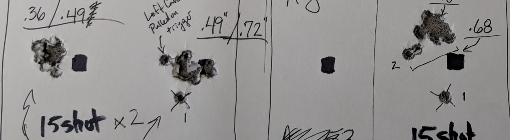

SUCCESS!
I have probably spent enough on ammo to come close to the cost of the rifle seeking accuracy. Up until I received my second Green Mountain barrel (first was defective) nothing was working other than the use of tape to "bed" the action to the stock.

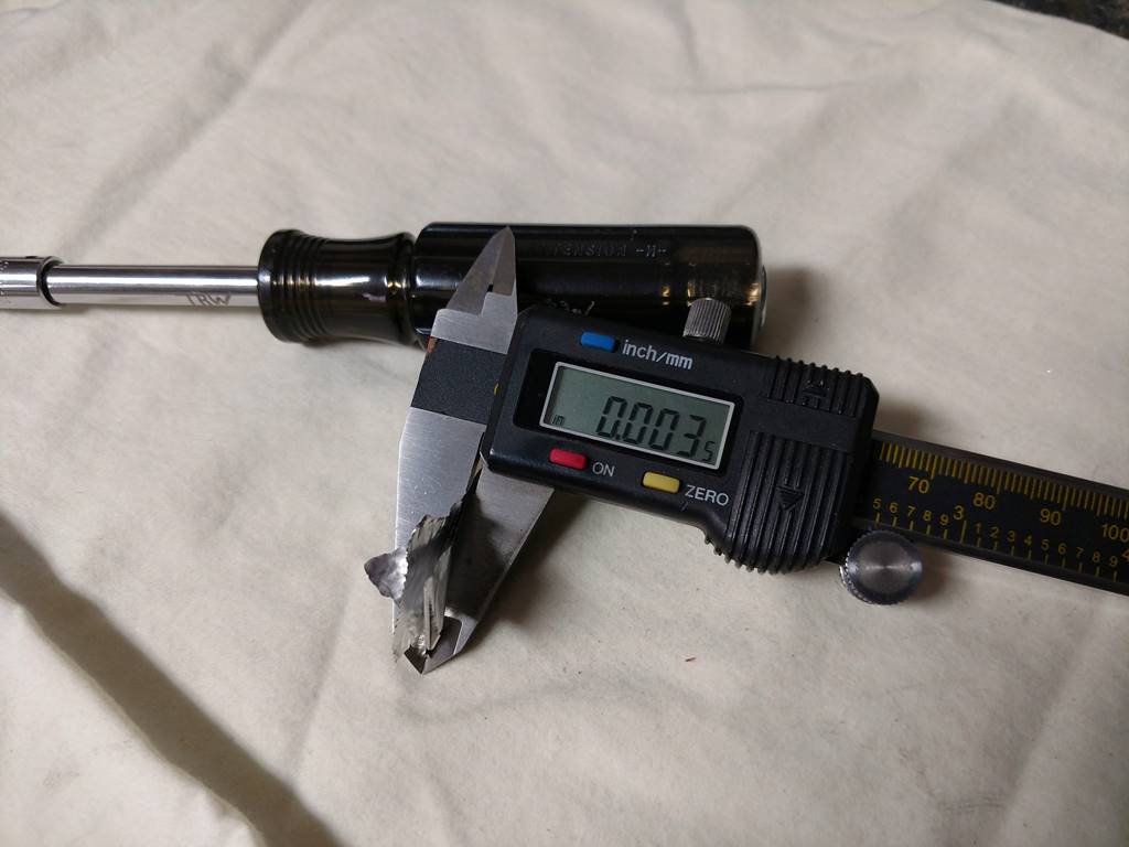

Today I shot the rifle using a Green Mountain barrel, tape to help with mating the barrel to the action and torqued the action screws to 35 inch pounds. I was using a Harris bipod and a leather rear bag filled with heavy sand and a Leupold 6.5x20 EFR scope.
Groups were consistently in the 1/2" and less for 10 shots at 50 yards (no flyers), and under 2" at 150 yards.
I'm a happy camper now.
SUCCESS!

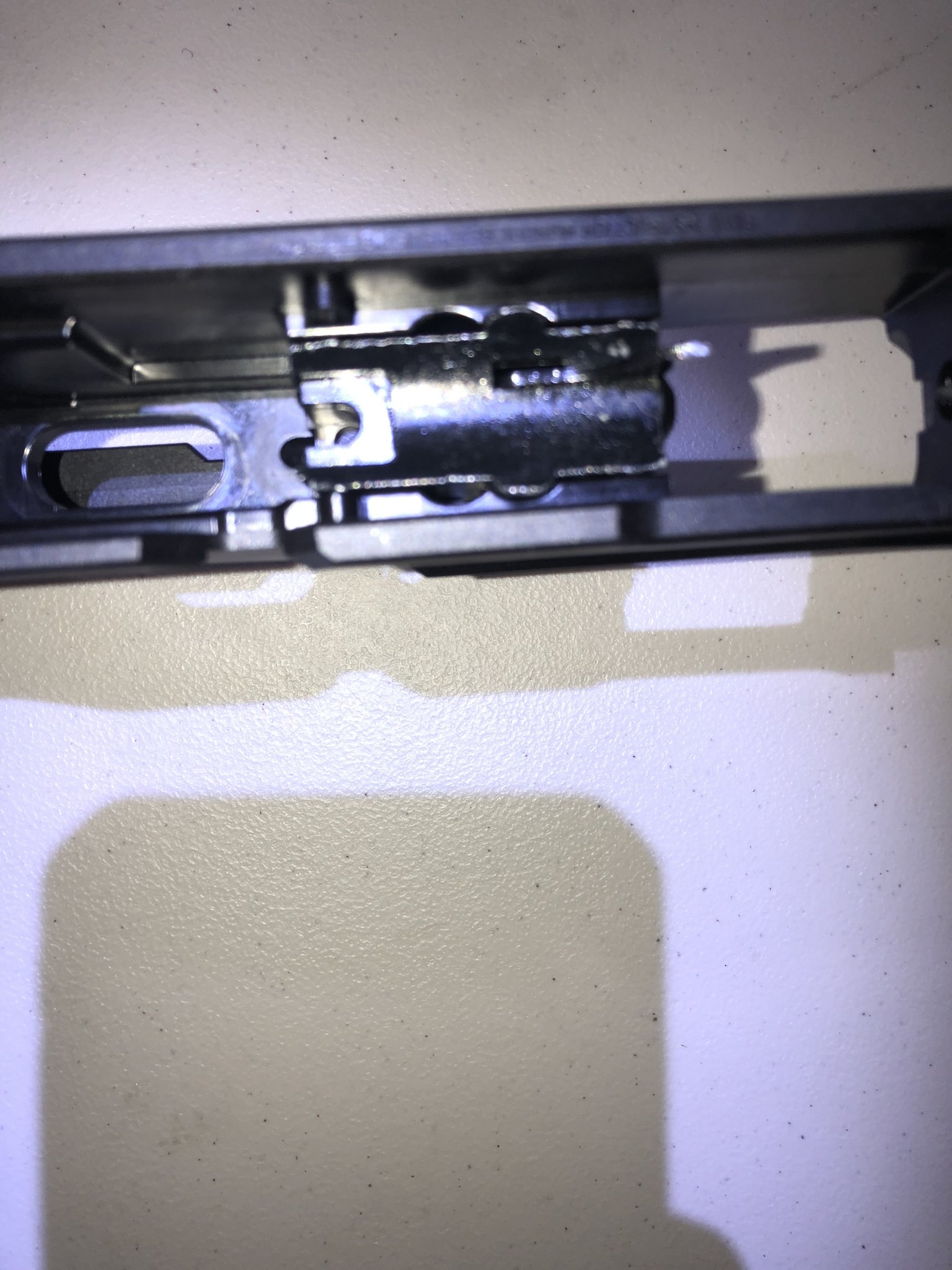

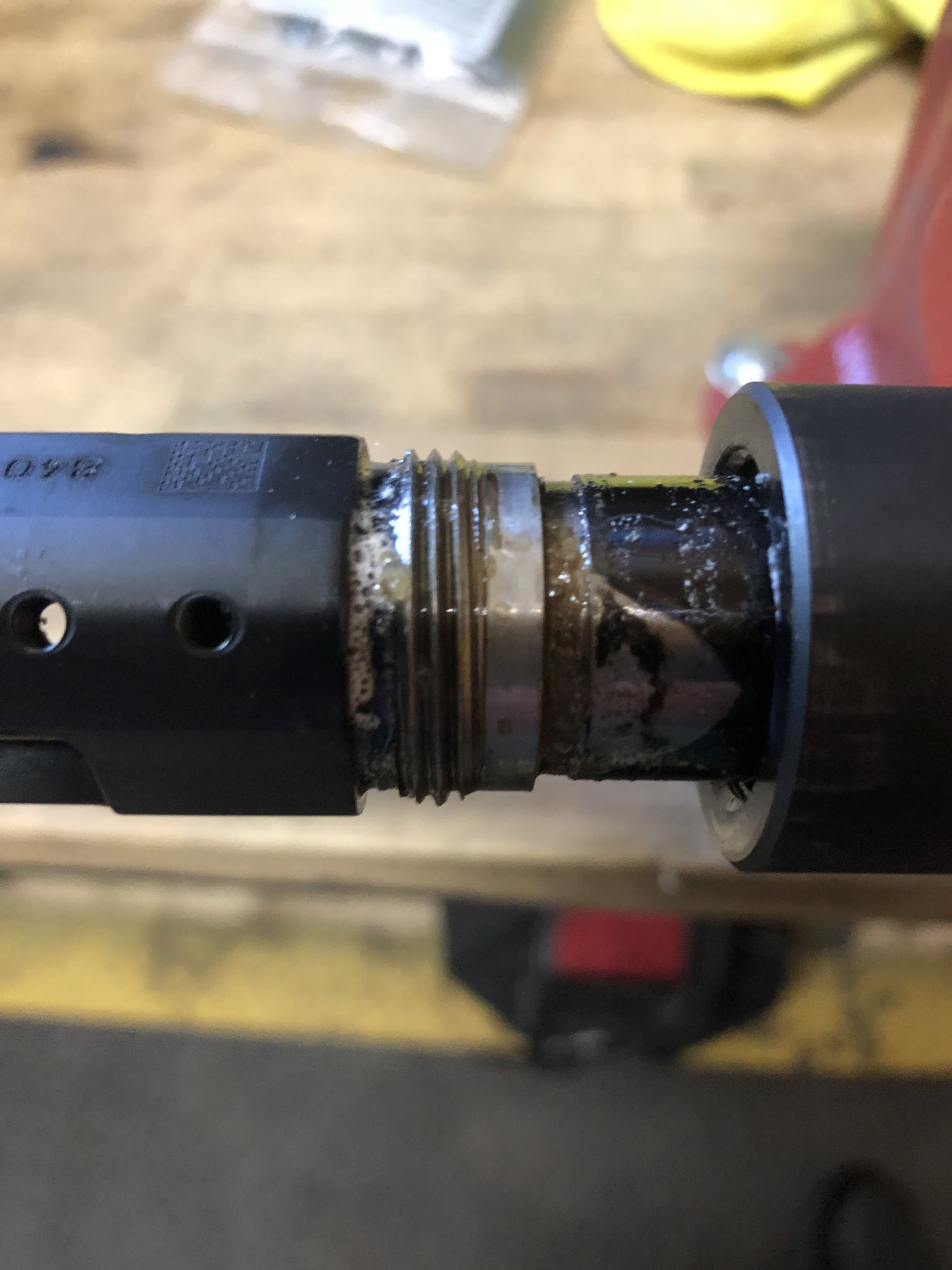

Pulled the barrel off.
What a PITA.. here are some pics of the thread locker they used .
Also noticed that although the magazine locks up tight with the 15-25 round mags you can cause the front of the bullet to dip by pulling back on the bottom of the magazine. I don’t know if it will be a problem but we will see.

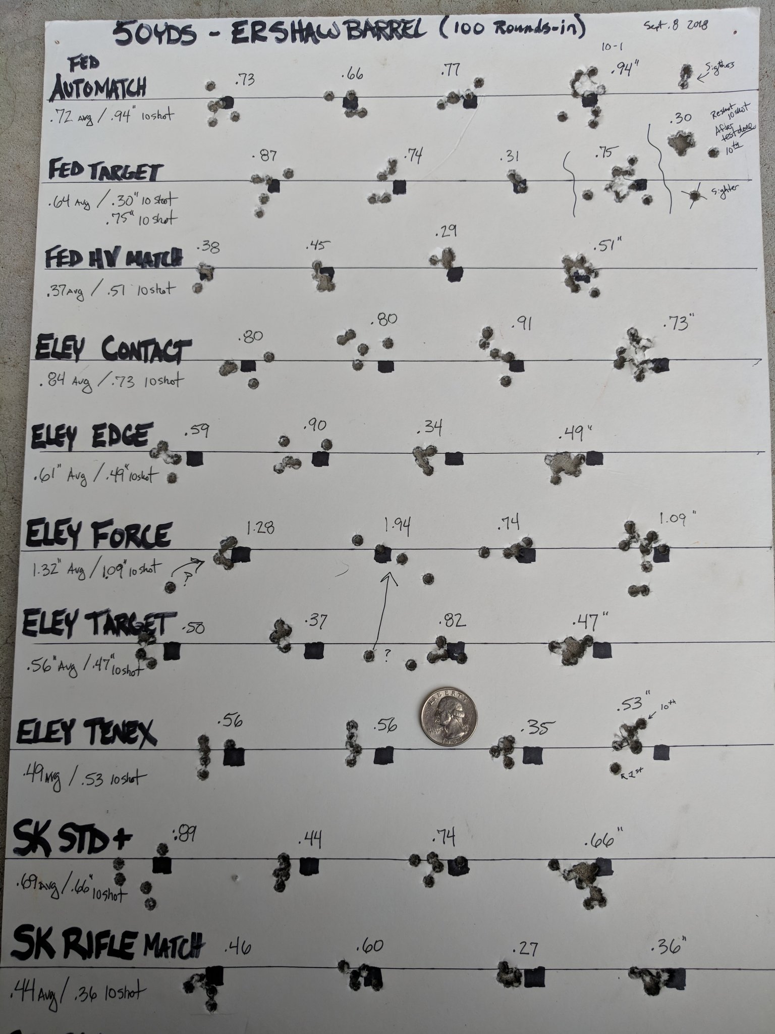

Greetings.
Thanks Subwrx300 for you earlier response. It's the failures to load and eject that are most concerning to me. I also expected the RPR to be more accurate than the 10/22, but that remains to be seen as many folks at my club have more accurate 10/22 with factory barrels.
Has anyone else notice this problem with their RPR? My bolt is digging an indentation in the receiver. I can feel the bolt catch when it reaches the end of the indentation. Is this something I should be concerned about? I've fired about 400 rounds at this point.
Greetings.
Yes, I had the same problem with the bolt "digging" (as you describe it) and that was concerning to me at the time. Once, as i took the bold out to inspect it and see why t was "digging" like that, I cut my finger pretty good on the sharp edge of that long grove in the bolt. In fact both edges of that long group were razor sharp. I had already decided that it was going to take a little time to get the bolt broken in where it would run smother, but those razor sharp edges just wasn't acceptable as I didn't want to worry about inadvertently cutting myself again. So, I pulled out my jeweler's files and filed down those edges and afterwards when I put the bolt back in, it no longer did any of that "digging" in as before and has run smoothly since.
I also had problem with failure to eject where the brass just doesn't always make its way out of the chamber. I've tried some of the fixes some people have mentioned, and it's has improved quite a lot . . . BUT, I still have way too many FTE's and the often the ejection is weak where it brass is not thrown out very far. Some have called Ruger and had a new part sent to them free of charge that seems to have solved their problem. I think I'm going to do that too, very soon.
From what I can tell in that picture, I think I'd have Ruger replace it.
BTW: Keep in mind that the barrel on this RPRF is not a "match" barrel, but it's a "target" barrel. So, one shouldn't expect accuracy equivalent to high end match rifles with match barrels. But . . . we should certainly see better accuracy than a 10/22 (10/22's without upgraded barrels). My 10/22 shoots pretty well with certain ammo . . . for an off the shelf standard factory model. My RPRF with the factory barrel was definitely shooting better than my 10/22, particularly after I had a few hundred rounds down the pipe. But then, some of that depends on the ammo one is using as one gun will prefer on brand/type over another.
Reactions: Subwrx300

Greetings.
If you have file and a Dremel, you could do as @straightshooter1 suggests. I've used a Dremel with the polishing wheel amd jewelers rouge on few bolts to improve smoothness.
If no Dremel, you can do it by hand too failure quickly. Strip down to barreled action, remove trigger, remove the clip on bolt to increase bolt throw (3" throw setting), plug the chamber with a patch, put Flitz or JB borepaste on the bolt surfaces and cycle action literally 400-500 times.
Do it while watching TV and it will be amazingly smooth when you are done. Just be sure to give it a thorough cleaning afterward with brake cleaner and lots of qtips to remove any residue.
I cycled mine this way about 600-700 times (1 hour TV show) and it is ridiculously smooth now. Almost all rifles that are on the budget end of the spectrum have their weak spots and machining parts faster is a quick way to keep costs down. But for that savings, we have to work them a bit more to get them finely tuned.
With respect, while some of the issues you mention are definitely worthy of a call to Ruger, others are simply part of the design.
I don't know your background or shooting skill, so this is not meant to be offensive or combative, simply points to consider given the many people that have found success with the platform.
  1. Failures to eject: a few people have had this issue and most resolved by bending the ejector spring inwards towards center of bolt. However, if you meant "failure to EXTRACT" that would be worth a call to Ruger for fix.
  2. Loading issues sound like you may have received a bad chassis; a few people here have had similar issues and Ruger sent them a new chassis at no cost.
  3. V-Block/Mounting block: it's designed to come out easily for cleaning and routine maintenance.
  4. V-Block Pin falling out: see number 3. If you really want it to stay put, put an ever so small drop of silicone or super glue on pin (unassembled) and let dry and it should add the friction you are looking for. Even without any modifications, it will not come out when assembled into rifle, so it's more of a maintenance point.
  5. Accuracy: while some have have had mixed results, it seems a good number of guys usually find an ammo type or two that produce good results. (@elfster1234 , @straightshooter1 @Noobshooter86 , @MTWelder , @Lrps260, @Snuby642 just to point out a few, along with several YouTubers like 22Plinkster and many others that Im sure Google will list). I tested 15+ different quality options from Eley, Federal, CCI and SK during testing break in. Also once I found decent result, tried a few different lots to see if any shot better/worse and precision has improved further.
  6. Accuracy part 2: if #5 hasn't worked, it could be worth checking action screw torque, scope, mount etc. (You know, the basic stuff). Ruger has a page in the manual listing those items to try.
  7. Accuracy part 3: How many rounds down the barrel? There are a TON of precision rimfire shooters (check out rimfirecentral.com) that can document most barrels/rifles take upwards of 1000+ rounds before they shoot their best groups. I put 1100 rounds through factory barrel before deciding to upgrade. It went from .7-.8" 10shot group at 50yds to about <.5-.7" with most of the flyers disappearing over that time. Not all but most. Custom barrel is shooting even better .3-.5" at 50yds and averaging 1" at 100yds using match ammo.
  8. Accuracy part 4: if #5, #6, and #7 haven't worked, cal Ruger and they will likely replace barrel. Or alternatively, get an aftermarket barrel if cost isn't an issue.
  9. Price: sometimes it's easy to forget that this is a $350-450 dollar rifle with no competition coming close feature to feature: adjustable comb, length of pull, great trigger, modular M-Lok rail, 30moa base, modular bolt throw, allowing and designed for easy barrel swaps.... All for less than $400 if you find a good deal. It would be hard to source parts to build a similar rifle for anything near this cost unless everything is second hand, which is not apply to apples.
With all of that said, if your unhappy, call Ruger and either give them a chance to make it right (which I'm certain they will) OR, I'm sure you could sell to a member here looking for good deal. ?
Like any product, sometimes you get burned even on a "sure bet". I'm dealing with a second $500 barrel that's struggling to keep anything near 1 MOA but I'm working with manufacturer to make it right.
I hope you get it figured out and Ruger takes care of the issues you've identified.
Cheers!
Subwrx300
[Edited some typos]
What kinds of ammo does your barrel like?
@Hardpan , Ive had good results with a few different types. My definition of good for rimfire of any kind is <1MOA @50yds and <1.5MOA at 100yds. Great ammo will be ~.75MOA at 50 and <1MOA avg at 100.
Goal was to find a practice ammo (best groups per dollar) and match ammo (that cost under $10-12 box, which is most types expect Tenex, UM1 and XAct).
Picked CCI SV & FGM Target for general Practice and SK Rifle Match for matches and a few match-like practice sessions.
Ammo test - three 5shot groups followed by 10 shot for record.
CcI SV 15 shot groups from recently cleaned barrel.
Also did the same for factory barrel.
Here are the original posts:
Factory barrel: https://www.snipershide.com/shooting/threads/ruger-precision-rimfire.6827519/page-10#post-7204390
Shaw barrel: https://www.snipershide.com/shooting/threads/tested-er-shaw-ruger-precision-rimfire-barrel.6901759/
Reactions: straightshooter1

New ER Shaw barrel is installed!
-ER Shaw barrel was SSUUPPPEEER stupid tight. Had to heat up receiver and in still needed rubber mallet to get into action. There will be ZERO movement inside action.
- Bolt closes fairly hard now, so I'm guessing the headspace is slight off (rear camming surface on bolt handle) on new barrel or just very tight fit of bolt face to barrel breech.
I got my Shaw in late Aug.
Noticed all that you noted for the most part. I didn't have to heat anything up but did do a little tap with a rubber mallet to get the barrel seated.
My bolt closed extremely tight also. Too tight IMO. I did shoot it as is the first time out but what an extra workout with the bolt closing so tight (200-300rds no change). I contacted Shaw about it and they wanted me to send the rifle in for inspection. A few emails later the Shaw representative, via email, mentioned they have seen this before with some 10/22s since they have noted Rugers tollerances are not as consistent as theirs. Not wanting to send my rifle away since I had a match coming up I did some messing around and came up with a "shim" to adjust how far the barrel seated into the upper. I sent my results and pictures to Shaw and they called it "ingenuinty"... Also noted that my foil shim will not crush and I should be good to go from here on. Thousands of rounds later and no issues what so ever. Extremely happy camper.
I noted that the factory barrel seated into the receiver somewhere around .998 - .999".
The Shaw seated 1.001 - 1.002".
(Cheap calipers...)
I created/used 4 shims which equaled +/- .0035" of HD Reynolds aluminum foil to get the bolt action where I liked it. I found a semi thick shim laying around in the stuff bin that was close enough and used it to trace/cut out foil shims with a razor blade. I started with one shim, assembled, tested, took apart again, went to 2, etc to get where I finally ended up at.
(These shims slip over the barrel before it is seated in the upper.)
If I do my job and there is no wind I'm closing in on 1/4" groups (maybe a hair closer to .030" than .025") at 50yds with SK Pistol Match. Where I need to be to shoot KYL matches where the smallest target is just a hair over 1/4" in diameter.
But they are not the round to go with beyond 50yds. The group opens up too much. So I use these only for 50yd KYL matches.
For NRL22 matches I'm using SK Standard Plus. Much better grouping at 100yds. (With the factory barrel I preferred SK Standard Plus for KYL matches over SK PM...) I have shot some sub 1/4" sized groups with SK standard plus at 50yds but not as consistent as the SK PM rounds.
These below I was just shooing quick for dope with SK Standard Plus and spent most of my time shooting 75, 100, 125, 150yds etc. My first NRL22 match was targets at 25, 35, 50, 75 and 100yds with some match director extra rounds at 100-200yds. Fun times and not too spendy to do at all.
I was shooting semi quick on these. Not for groups but dope. All I needed for this outing.
I haven't dived too deep into the expensive stuff. I have a hard time spending that kind of money for a .22lr round.
What I really need now is someone to get a trigger out... I'd sure like to see something under 1lb for KYL matches.
Tom
(Cheap calipers...)

This is a good idea to try. I though about shiming the barrel but decided to try it as is. It’s making the back end of my bolt handle when closed rub the notch cut out of the reciever. I found shavings in my barrel after I cleaned it so maybe I might try this to rid the problem

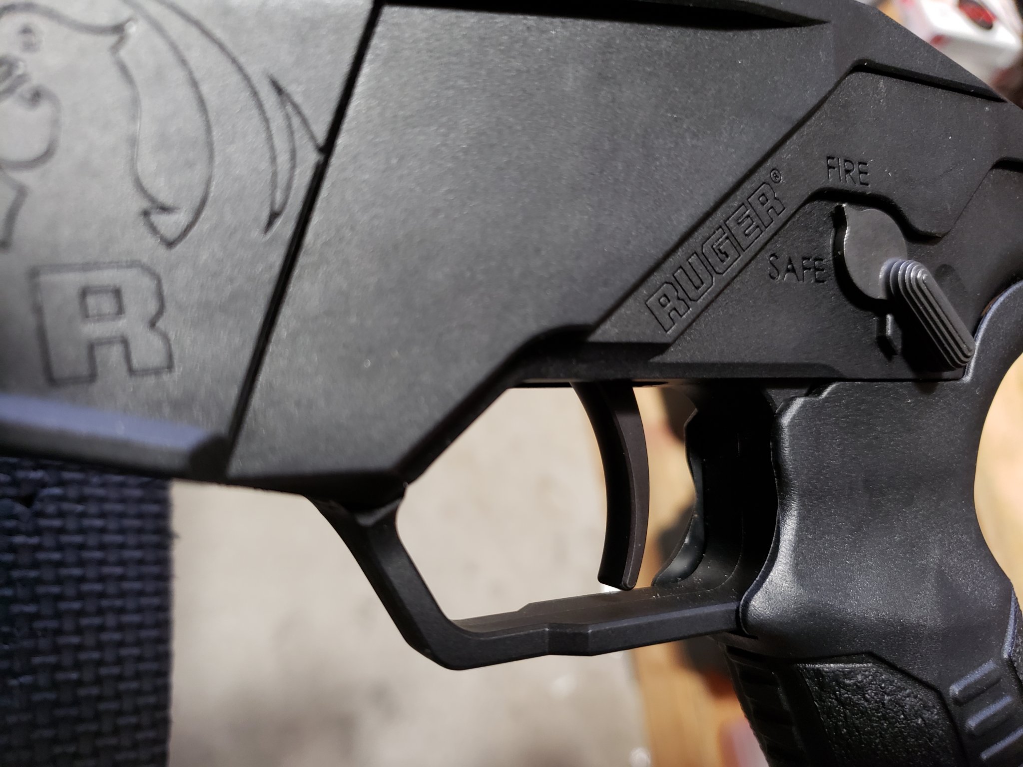

Thought I might throw is up as a teaser....have been using it for about 1200 rounds or so over the last two weeks and it is GREAT! For those wanting a replacement trigger for the RPRF, at least one company is in progress with beta testing. I'm sure details will arrive at some point soon from the manufacturer.
Reactions: John_vinblad
Thought I might throw is up as a teaser....have been using it for about 1200 rounds or so over the last two weeks and it is GREAT! For those wanting a replacement trigger for the RPRF, at least one company is in progress with beta testing. I'm sure details will arrive at some point soon from the manufacturer.View attachment 6948115
So cool. Except removing my trigger group is almost impossible. Probably will need to remove material to take the old out.
Oh tell us some more... I read somewhere on some forum that some person was beta testing a trigger for some well known trigger manufacturer. Will it be worth the wait?
Yes. Definitely. Factory trigger is good but this is substantially better. Smoother, cleaner and lighter. Helped control break until exactly when you want.
Will be worth the wait.
Reactions: skinnj1
