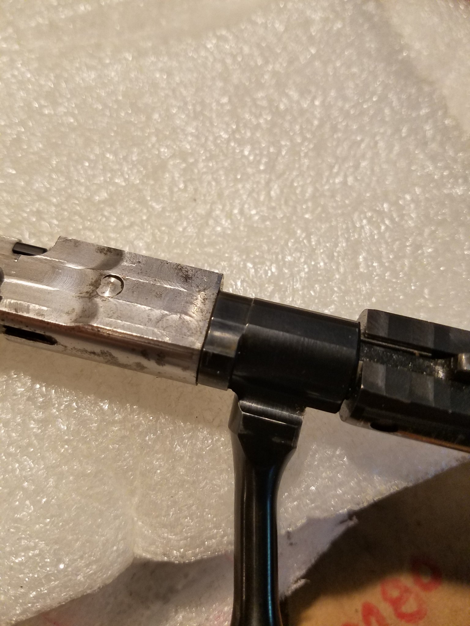

This is my RAR Target in .17HMR replacement gun bolt they returned to me.
This is my RPR, it's better but IMO the machining indicates less than ideal speed, tooling, and fixturing practices.
Is type of rough milling work on a bolt normal? Mine shows these milling marks also. Not sure if it would affect anything, it just looks sloppy.

Is type of rough milling work on a bolt normal? Mine shows these milling marks also. Not sure if it would affect anything, it just looks sloopy.
We have a Cabela's locally, I've inspected the bolts on a few RAR's they've had in the rack. I've seen some that have exceptional machining and some not so good. None as bad as the bolt in my replacement .17hmr rifle.
Mine looks to have won the trifecta: Poor fixturing, dull tooling, and high feed rate.
The accuracy makes it all acceptable.
:eek: Just when I thought it couldn't get much worse than mine. I've never associated this caliber of machining acceptable in firearms manufacture, obviously times are changing. :(

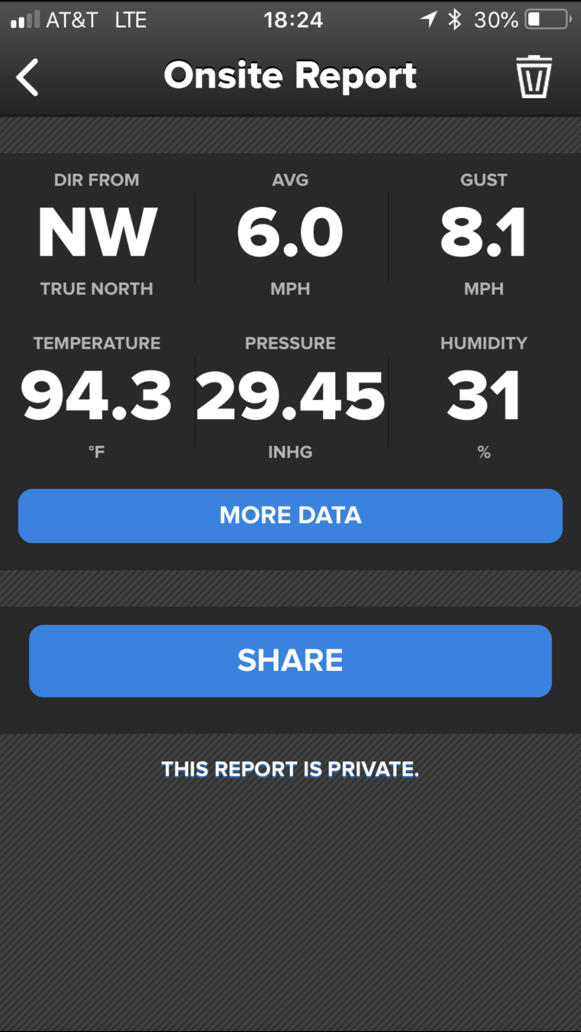

So I don’t know if this was around 1.5 inch but it was a guess. I forgot to get the tape measure out at the range. The weather was taken around 1130 am that day. That flyer to the left I squeezed off
