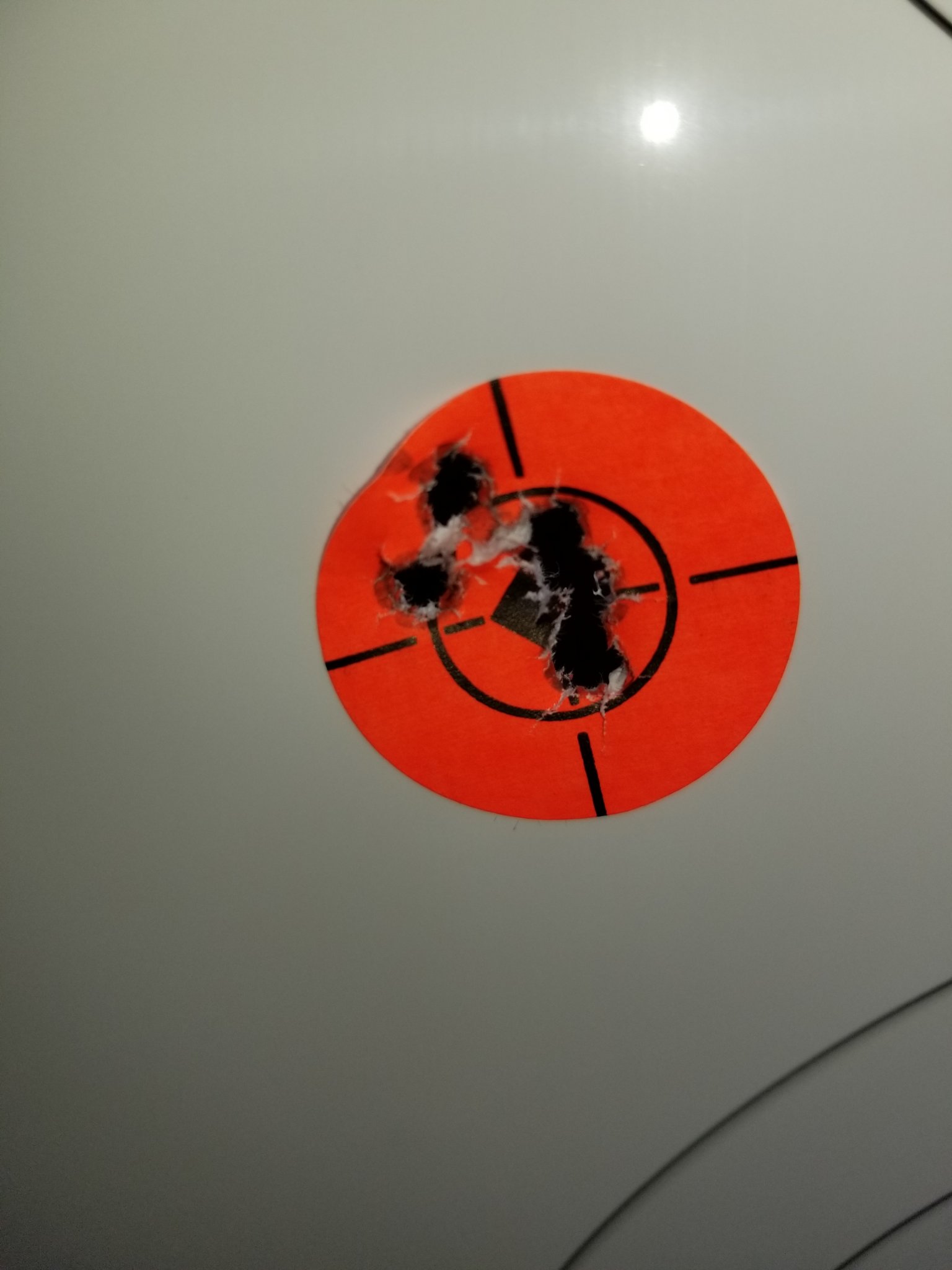

My .17HMR RAR Target is a great gun, functions flawlessly and shoots .3" 5 shot groups at 50 yds. Though it is the replacement they shipped me for the first one. :ROFLMAO:

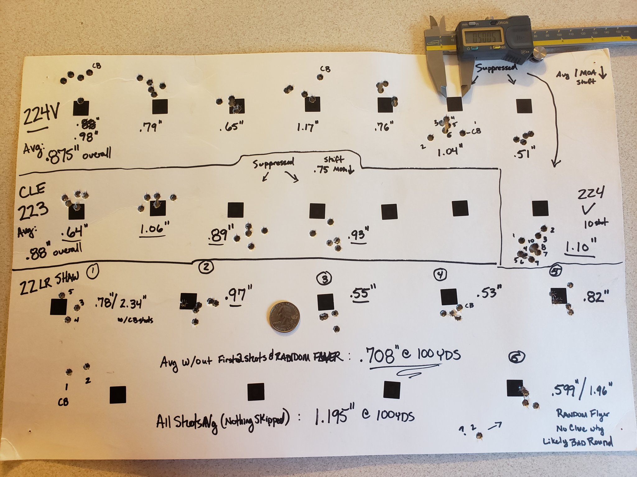

Have put well over 1400rounds through Shaw barrel now and had a chance to shoot on calm evening just before dark. Shot at 100yds 70deg I was sheltered from wind. Also shot 2 other ARs and RPRF was my practice while letting others cool down.
Ammo used was SK Rifle Match and barrel was scrubbed clean about 50 rounds prior to this Target. (The 50 round fouling Target also pictured below but was shot over weekend under different conditions).
22LR groups are bottom two rows; First two cold bore shots when wayyy low but I have sort of come to expect that as wax/lube in barrel is cold and grippy.
Fouling Target at 50yds:
Bottom line: depending on how you measure, my 22lr is more precise than my 2 precision ARs! And it's getting better. At least for my rifle, precision is not an issue.

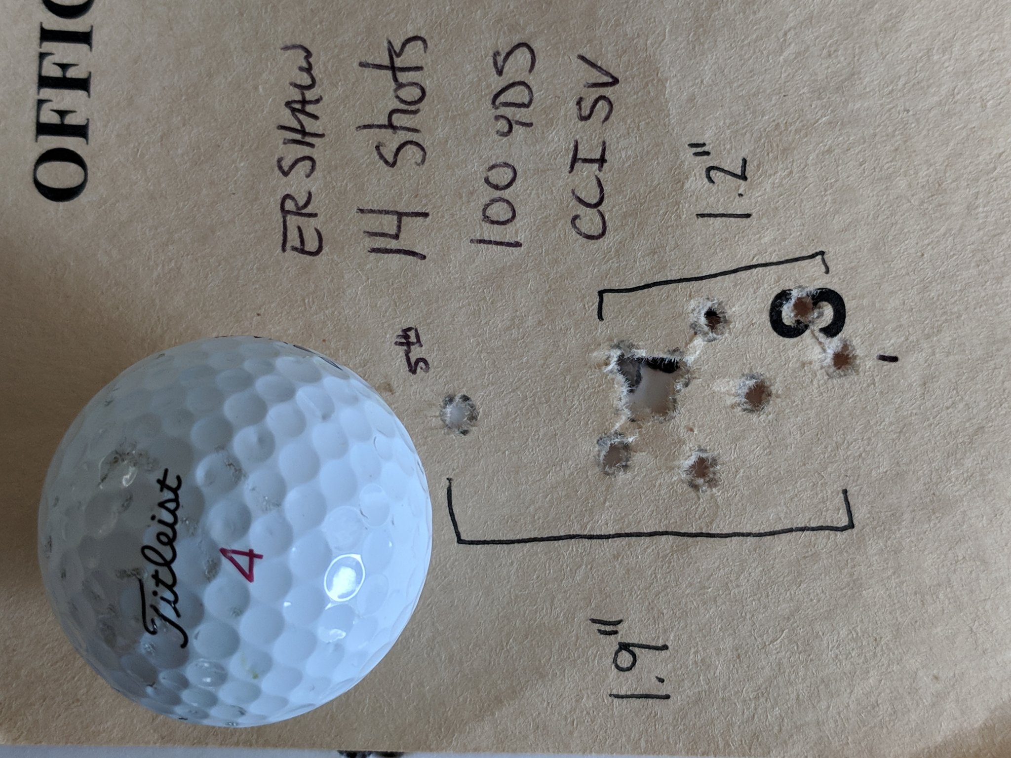

Does it shoot well at 50? With my factory barrel, I ended up scrubbing/*lapping* (if you can call it that) with Kroil, JB Bore paste and JB Bore Bright and VFG pellets. It did tighten up pretty significantly after that.
If it doesn't start shooting though, I'd call Shaw and get a replacement. I'm sure they would help out; they told me to keep in touch if I had any issues with accuracy.
Ya it shoots really well at 50 but so did the factory.

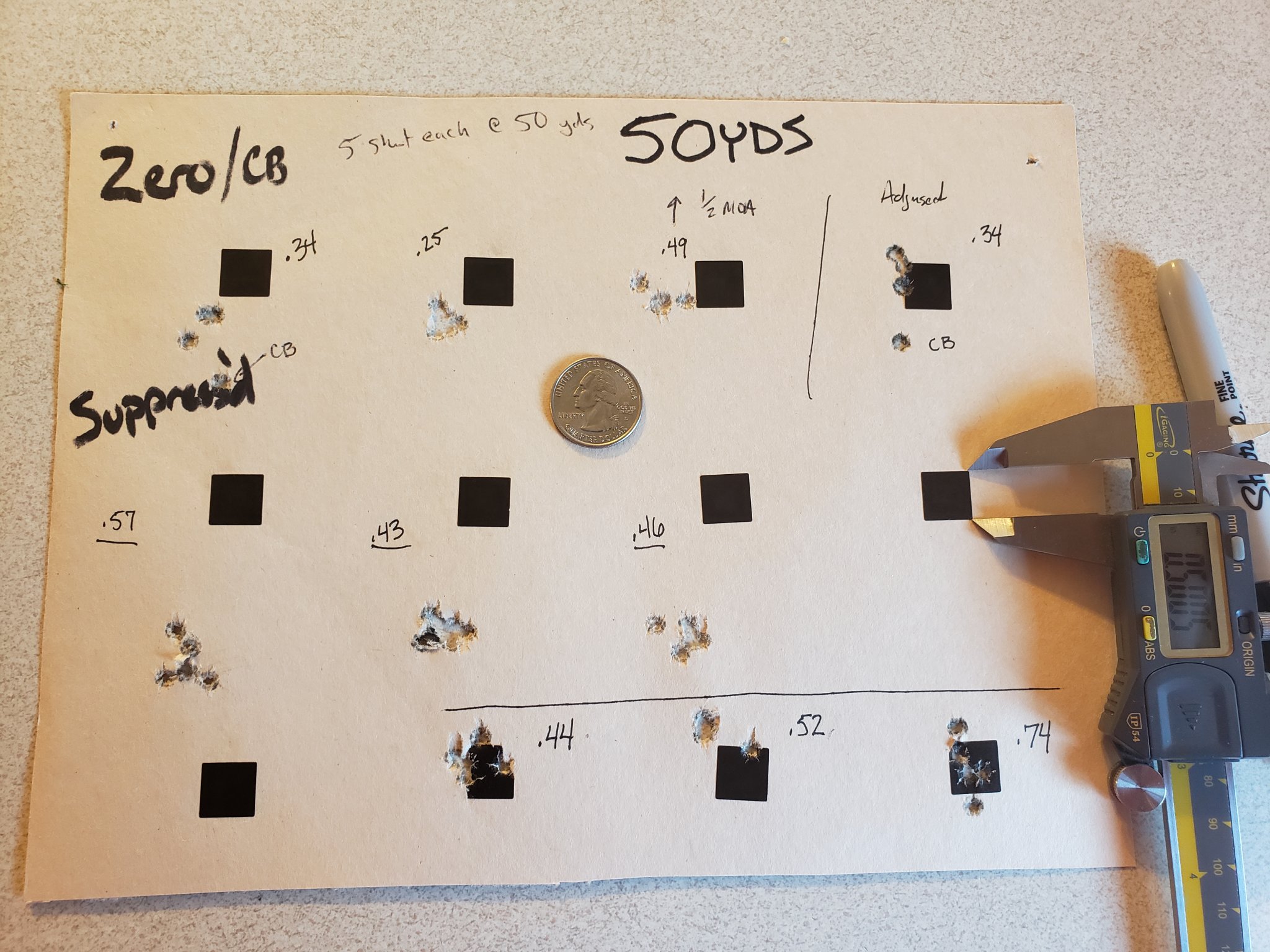

50 yard 10 shot group of eley subsonic hp
I have around 1300-1400 rounds down the pipe now
That .46 inch group won’t translate to less than 2 inches at 100 yards... Same ammo after this grouping

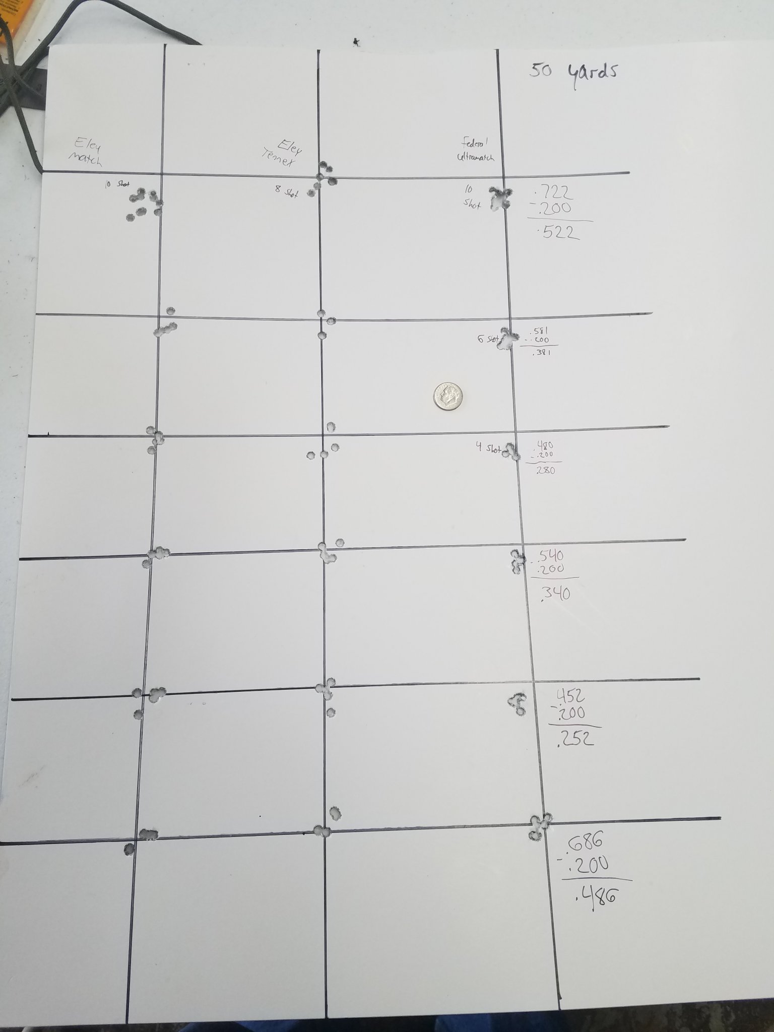

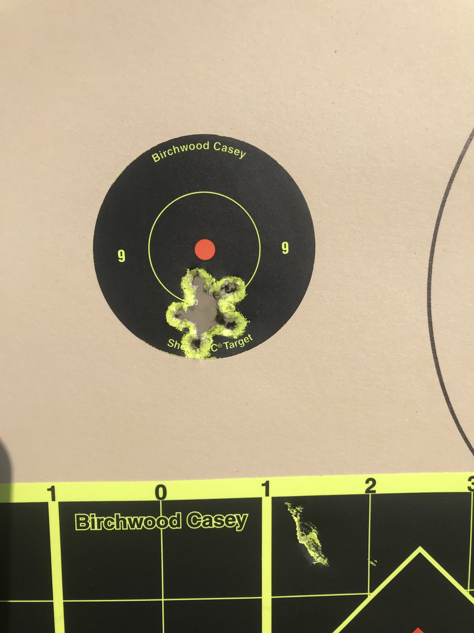

Went out for some quick accuracy testing. Bipod with a rear bag. 50 yards. Moderate wind. 20" stainless shaw barrel. Federal ultramatch proved to be the best. Barrel was clean from the beginning and I didn't clean between ammo. Just shot a quick 10 round group and then 5 round groups unless noted. I'd say the potential is there.
Looks like you need to get ahold of a few bricks of that lot of Ultra Match. :sneaky:
It'd be interesting to know what kind of velocity you're getting out of that 20" barrel. Though I suspect there's really very little difference from what we get with the 18" barrels. I think once the barrel's get out to 24"+ is where we'd see a significant difference (slower).
I think there is an inherent issue with the magazine and how the round is stripped from the mag and loaded into the chamber. I noticed a measurable accuracy difference going from the magazine that came with my rifle and a flush 10round mag that very little front and rear wobble. Going to try and epoxy and file down a magazine to get a better fit that has zero wobble & should have a video of it all with bullets on paper if I can ever find the time
