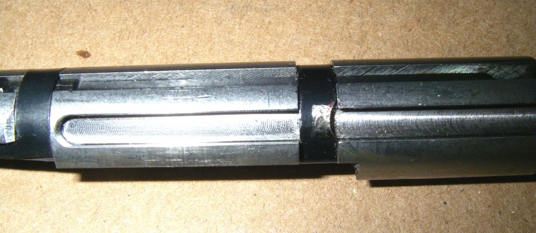

Dremeled the bolt stop spring clip a tad and no more ejection issues.View attachment 7058618View attachment 7058619

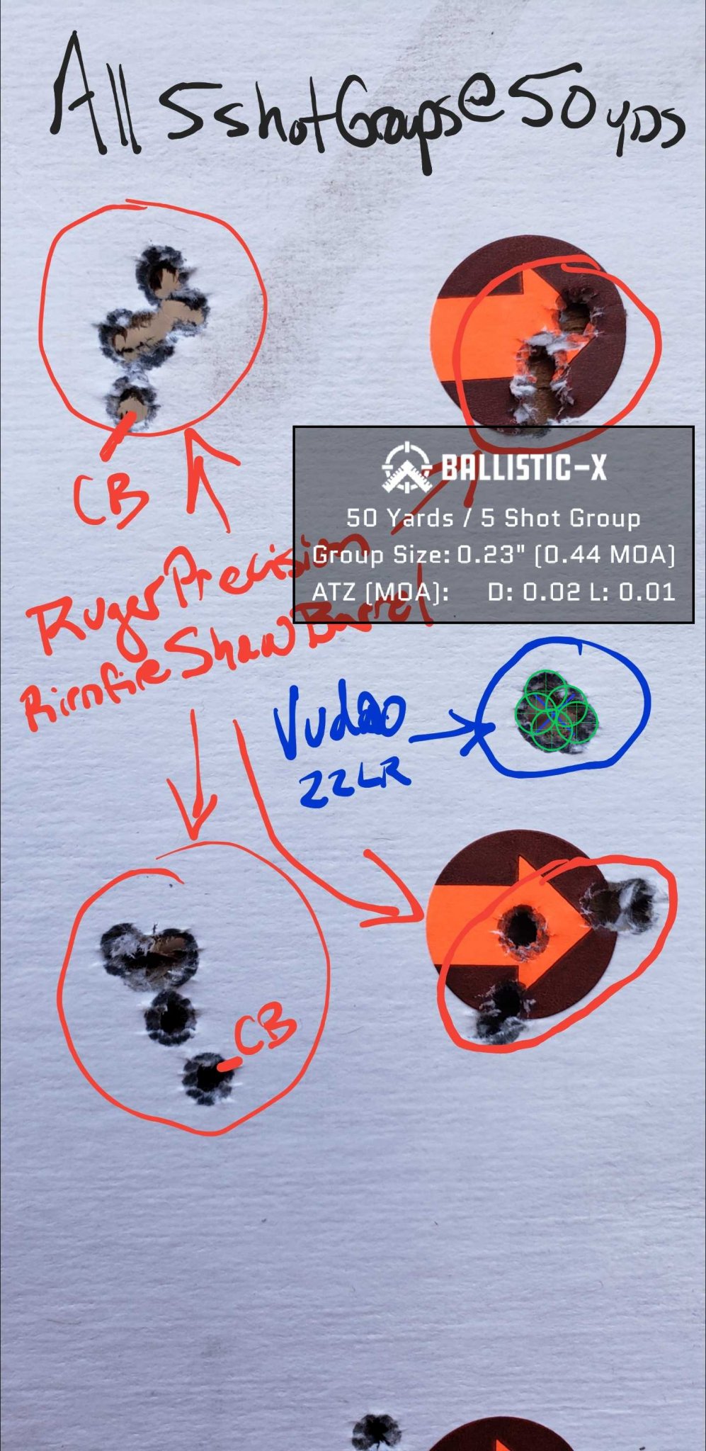

Tried a few more ammo types today... basically what I listed above... CCI SV, FGGM, FGGT, Aguila SP, Aquila Eley Prime...
To be honest, none were horrible. Aquila "Eley Prime" was a ragged hole at 50yards, but CCI SV was pretty close to that as well. Both Gold Medal rounds (the older White box style, not the newer stuff) did great as well. The Aguila Super Prime was the worst of the bunch, but still not terrible by any means. I grabbed a brick of CCI SV at the range shop on the way out though :). (Limit 10 boxes, or I would have probably grabbed more). I also picked up some Eley Target that they had to try also, but really if I can group CCI SV like I did today at longer distances I prob won't bother with anything else, esp for the money.
Got home, tore the rifle back down - no issues, just wanted to do the foil bedding deal. Also torqued the screws to 20 in lbs, which is not very much at all. I am kinda dissapointed in the trigger though, low as I can get it is 2-6. I keep reading about all these 1lb + stock triggers but mine isn't having any of that. Still may need some more break in maybe. I also stopped by the Sporting Goods store again and grabbed 3 more 10rd mags - for $32 I figure might as well have a few more.
Here's the Aquila "Eley Prime" on the left - not sure exactly what it is - I assume Aquila branded Eley or they licensed the name maybe? Anyway it shot great, but I think it's discontinued - now they only list Aquila Prime. I can get more of the older stuff, but it's kinda spendy compared to the CCI.

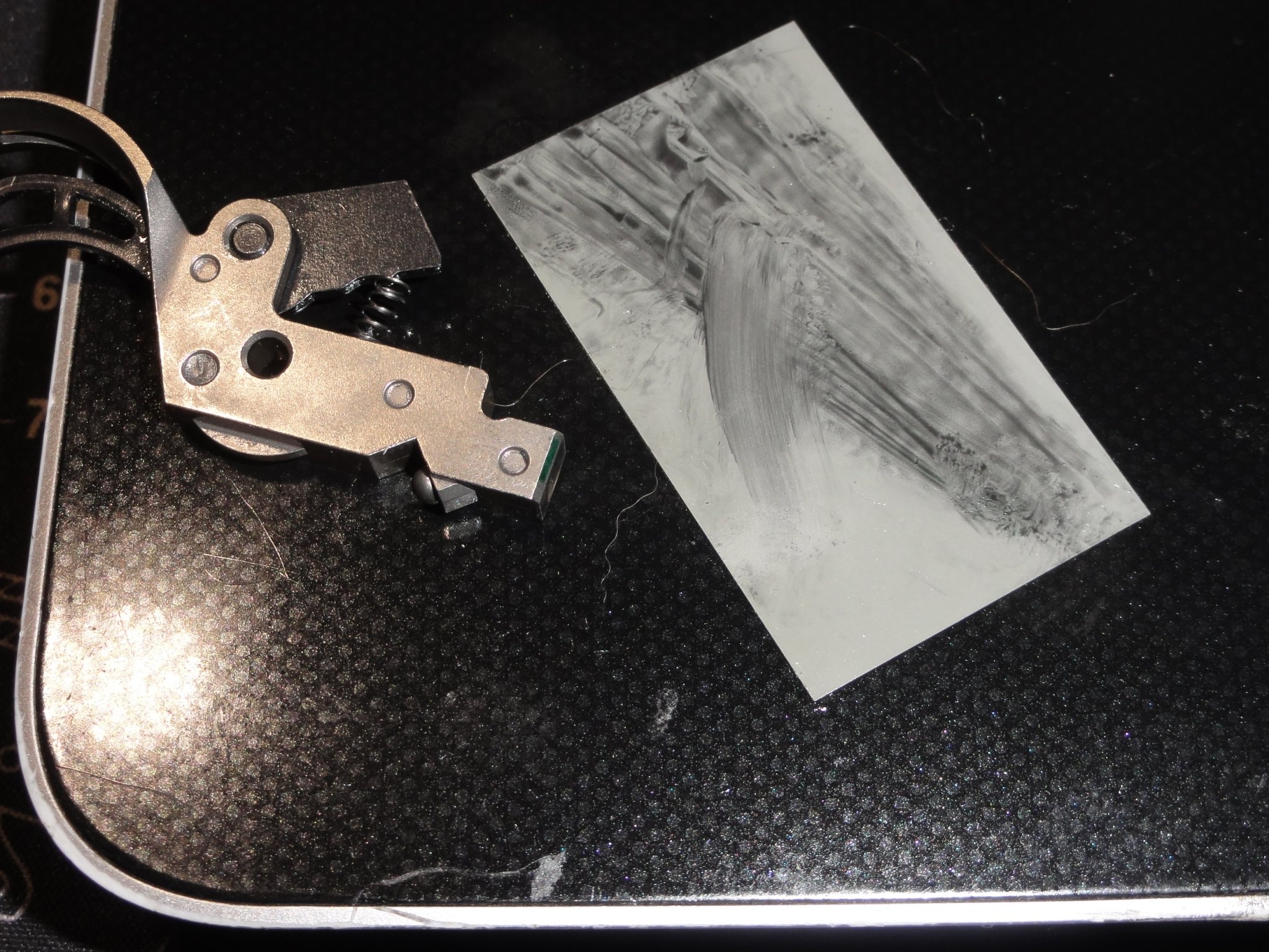

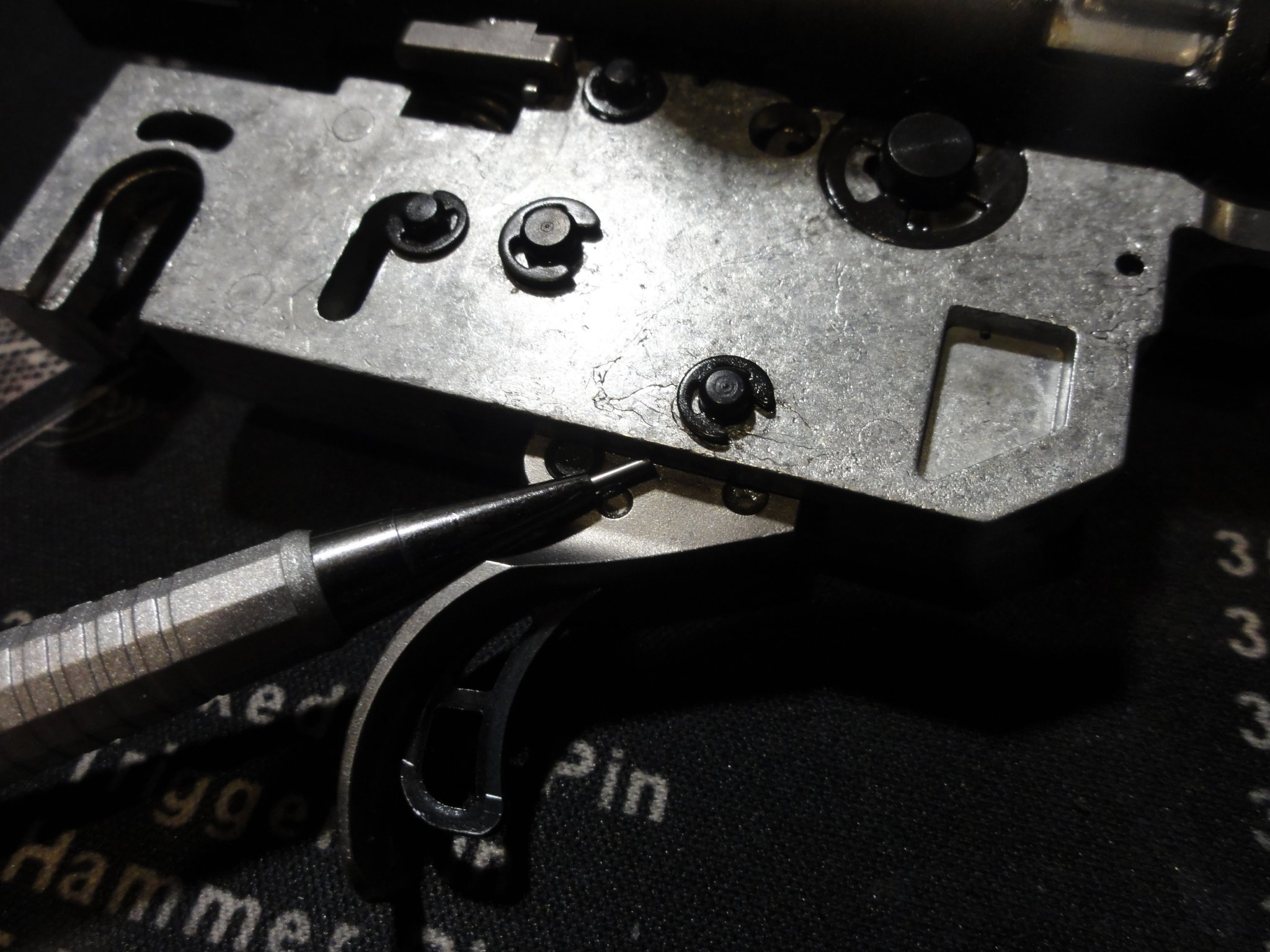

Did you ever get your trigger worked out? I posted a reply on 4/3 and described how I did mine. I also did it to my American 8348
In short, what I did was pull the tensioner set screw and it's small spring completely and put them in a bag. Then I lapped off the trigger on some 1 micron lapping film with PSA backing from e-bay. Lap it off in the direction of movement. 1 pound 1 once.
The trigger has about 1mm engagement. I only did the trigger sear as I don't feel that doing the other would do much.

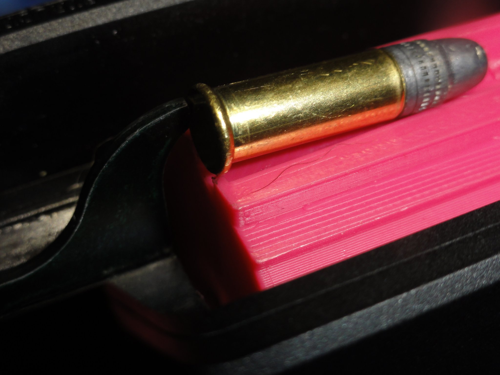

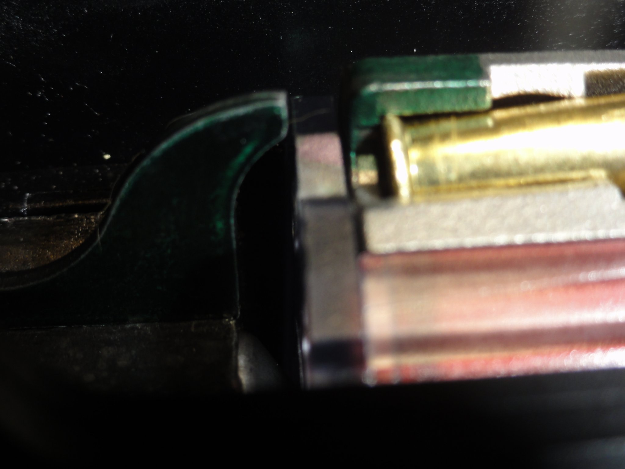

I looked at my rifle and it has an ejector arm. It is a flat piece of sheet steel coming up through the rear plunger block. The case or cartridge should hit that and eject. The bolt should have the spent case in it's claws for lack of the correct word and should hit the ejector about 1/4 inch before the bolt is in it's full back position. It is very similar to my Annie's and my CZ 457 MTR. It should not be ejecting from the magazine.
Now put the magazine in & take another look. You should see the magazine ejector square sitting DIRECTLY in front of the gun's ejector arm blade & blocking it. (just like the Ruger 10/22 with a magazine in place).
Don't guess, actually put a magazine in the gun & take a look. Or better yet remove the factory ejector blade then put a magazine in the gun, then put a spent brass in the chamber & work the bolt (watch it eject normally without the gun's ejector blade even there as long as a magazine is in the gun)

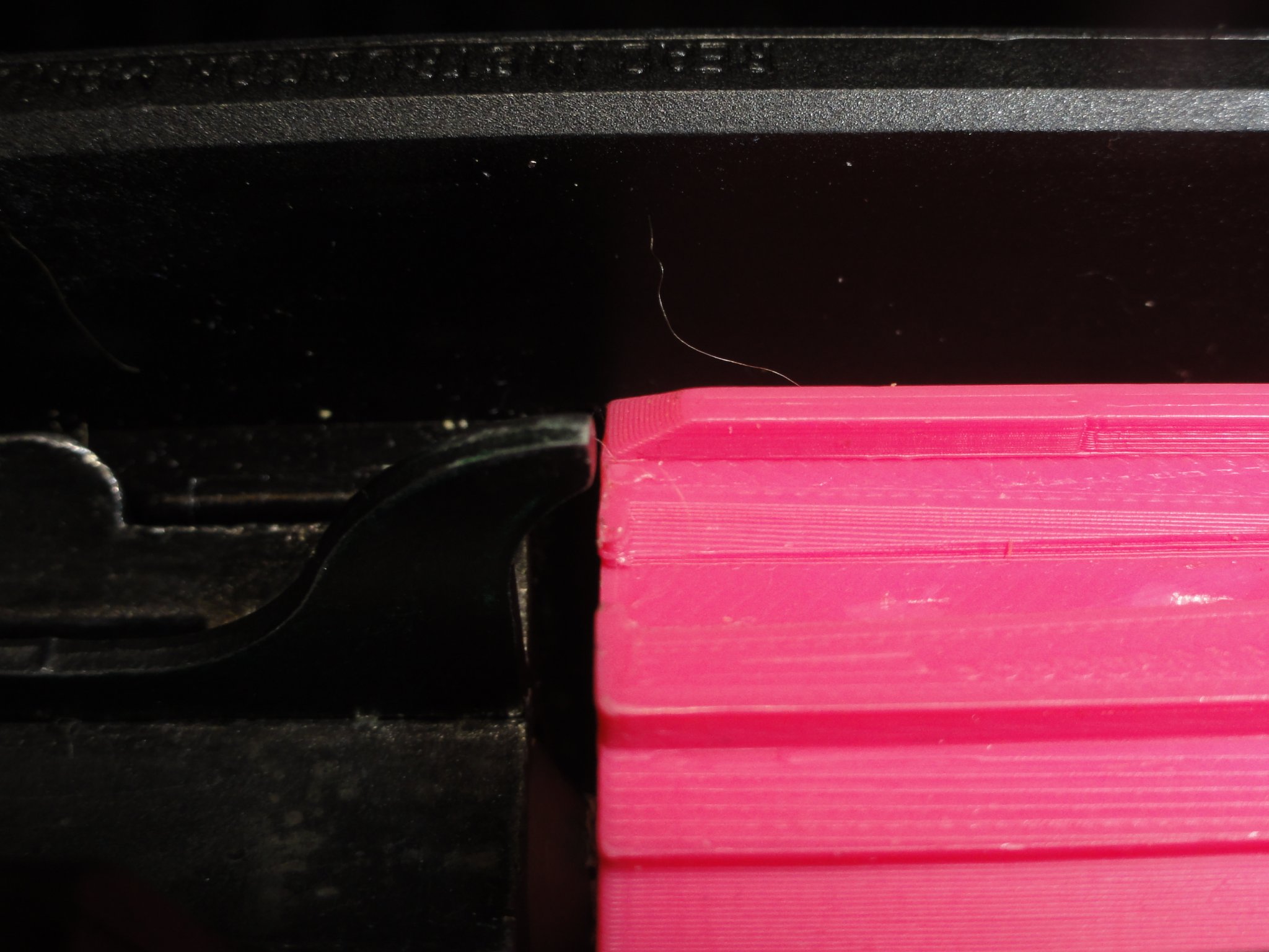

Apparently I have some modding to do. I pulled the spring clip off the bolt to give mine more travel. Spent cases weren’t ejecting and would sometimes fall in behind the mag. I bought some 10 round mags before I ever shot it and they fit terrible. I sometimes have to manipulate the mag or the bolt won’t even cycle.
When I was having ejection problems I was focusing on that "ejector arm" as it engaged the shell as you describe. I had made a small modification to that ejector so that it made better contact and that solved my ejection problem. But . . . as 800GS has pointed out, Ruger's design has the mag functioning as an ejector with it in place. In my case, the mag wasn't sitting high enough for it to do the job it was designed to do. When I checked the same function in a similar action that's in the Ruger American, I could see clearly how the mag was supposed to be working for ejection. Though I had solved my ejection problem with my little mod to the ejector, obviously, my mag in my RPRR was sitting lower that it was supposed to as both my Ruger American and 10/22 use the inserted mag for ejection. So, apparently it's designed with an ejector blade to only function when no mag is in place. Therefore, I inserted an additional layer of tape as bedding underneath the mag assembly to raise it up and in doing so my mags are now ejecting the cases and cartridges. And while I haven't had any issues with feeding, I feel having raised the assembly up a little improves the feeding some. Also, with the assembly raised, I found the mags to be much more firmly held in place.

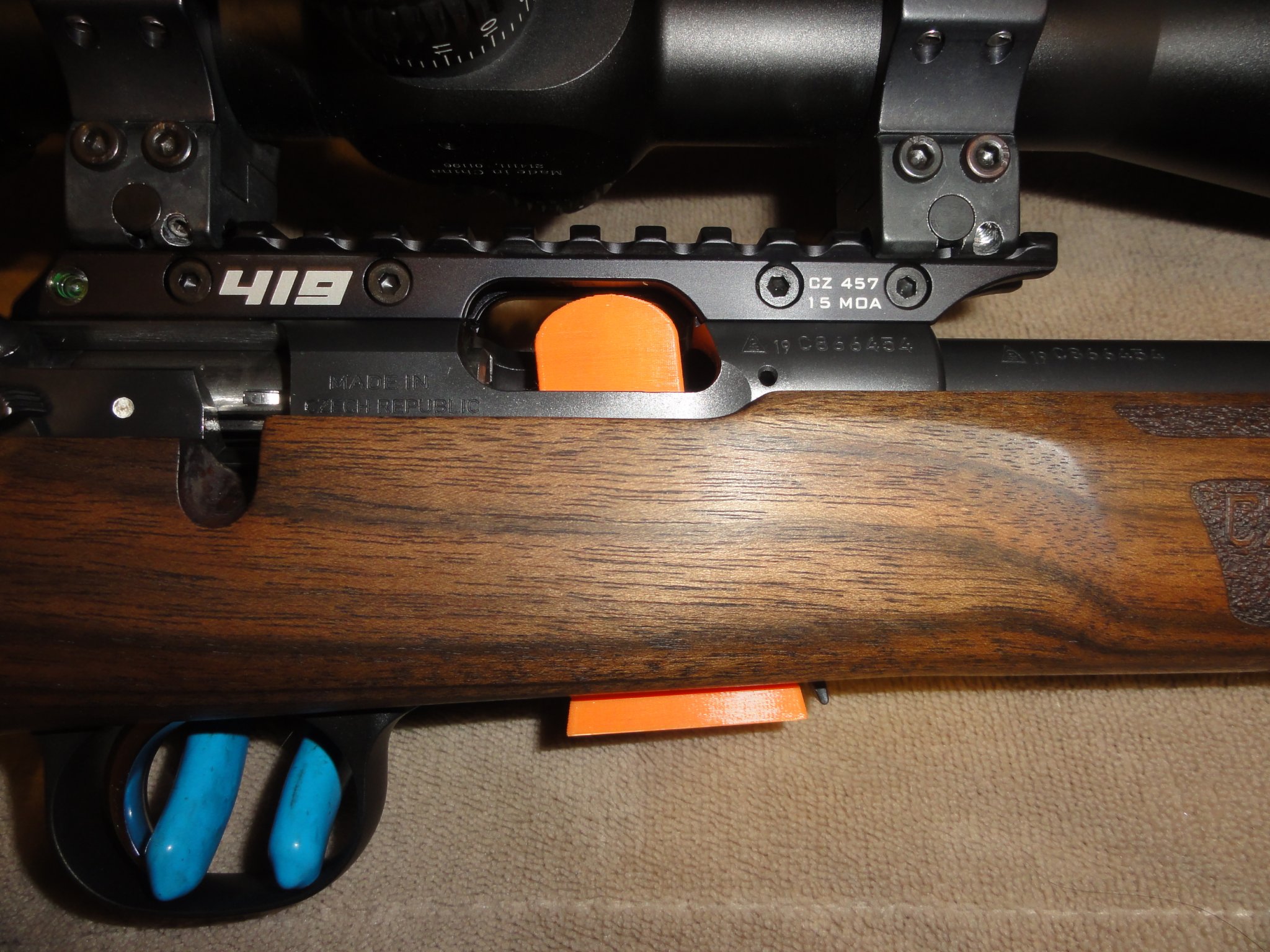

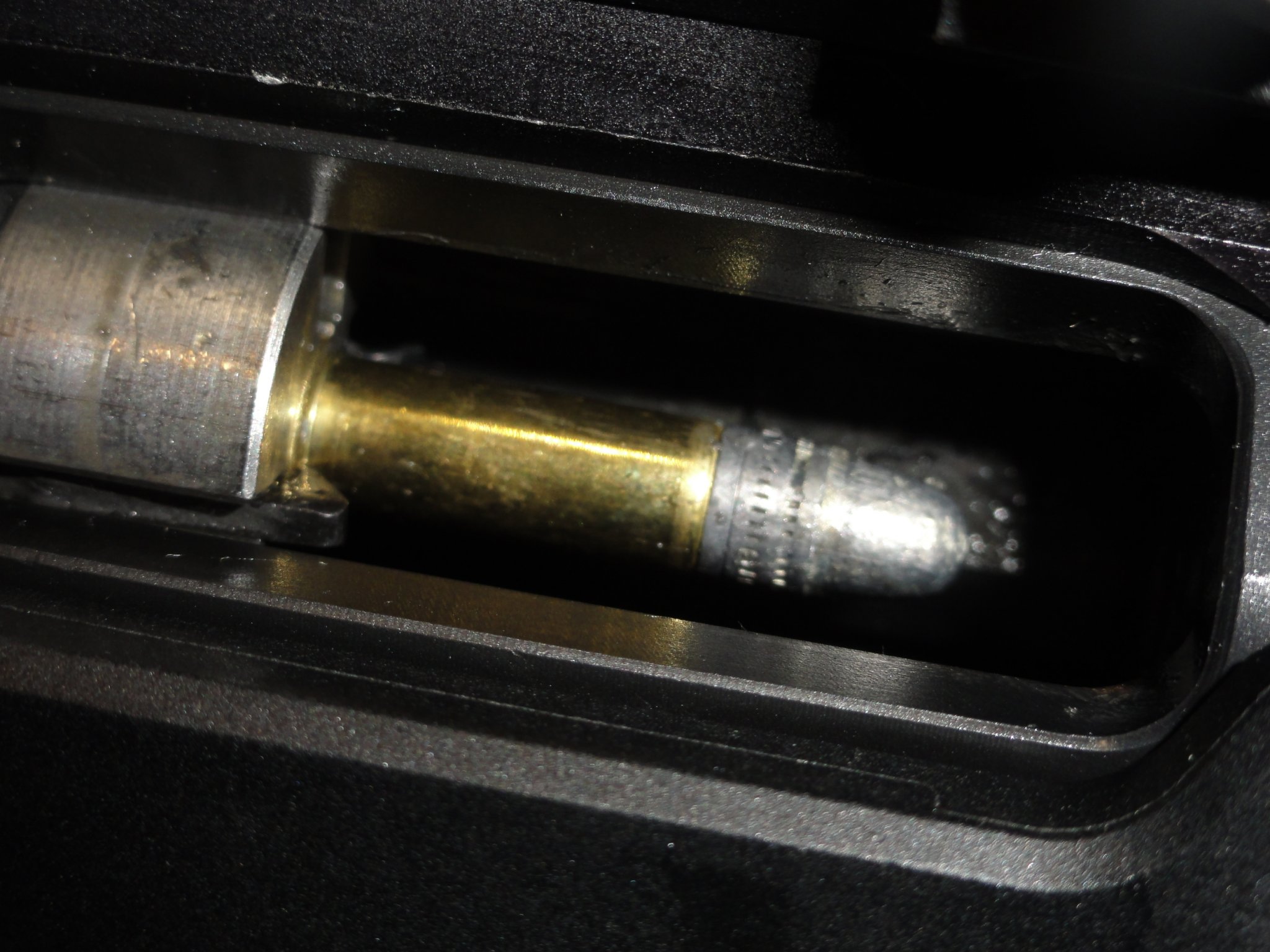

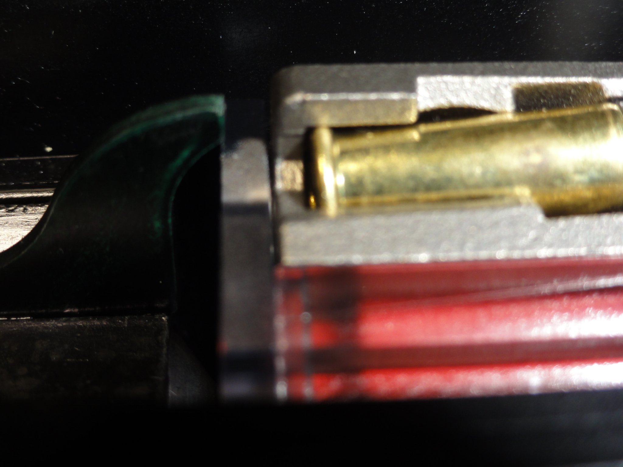

OK.... after a looked at it, I stand corrected. See photo's below. With the magazine in place, the case hits the mag on the green shaded area
at approximately .770 to go, meaning the bolt at full open. If you use a single shot sled, the case hits the "ejector arm" with .370 to go. If you pull the "ejector arm" out completely, and you use your single shot sled, nothing happens. The case or in this case the cartridge stay's on the bolt face as shown. The 8348 American is the same way. none of my other gun have this feature be it good or bad. I would advise against anybody grinding the green portion of the mag away trying to fix a problem. I'm almost positive it will cost you a mag.

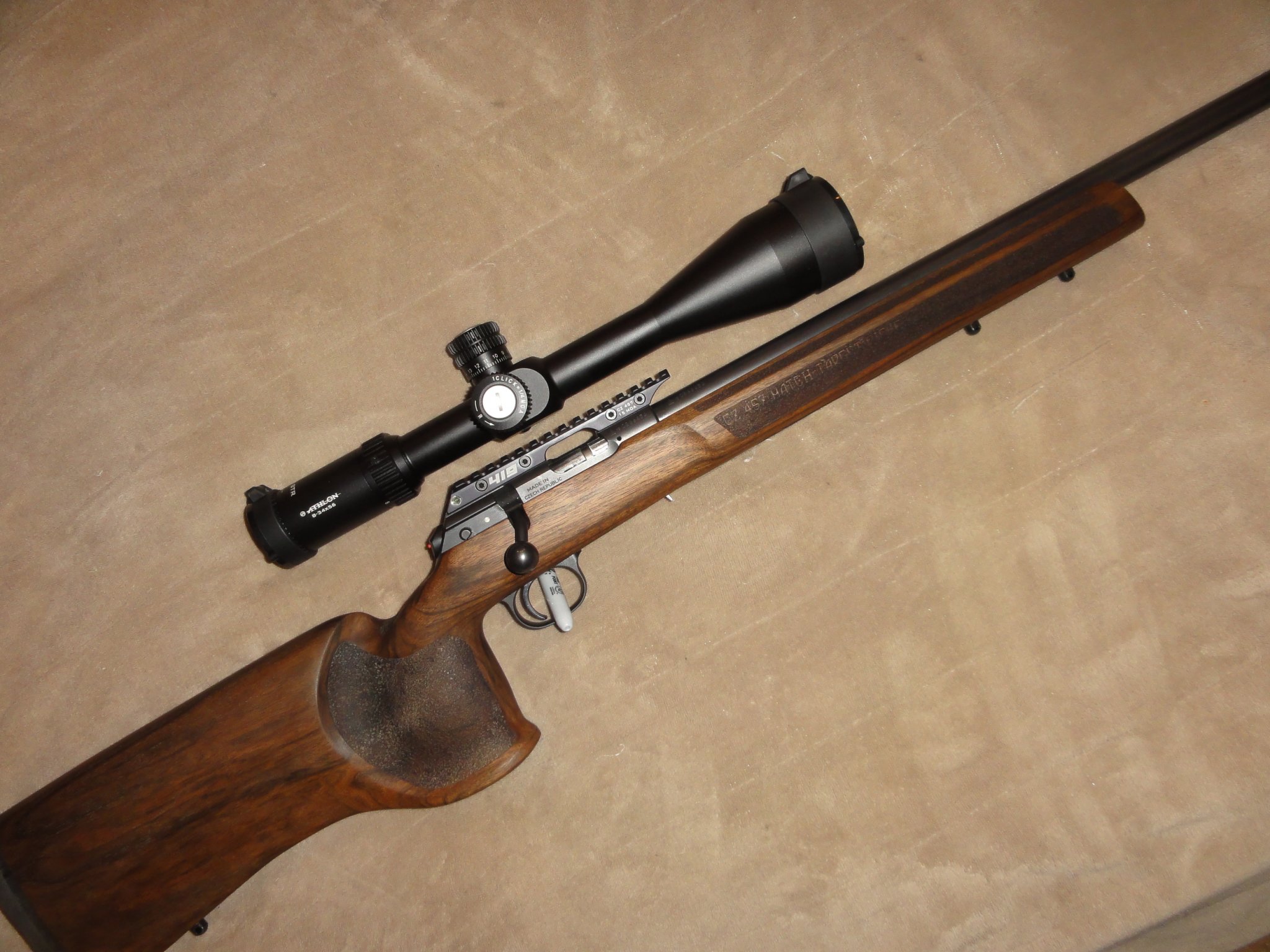

As a side bar.... I just got my scope rail from Area 419 for my CZ457MTR and it is really well done. Strangely, it wont go on my Annie's. The CZ has a barrel diameter of .860 and the Annie's have 1/2-28 threads so a guy on e-bay is making me a couple muzzle brakes with an O.D. of .860 so I can use the brake to affix a Harrell Rimfire Tuner to. That will allow me to buy one tuner for three rifles.

OK.... after a look it I stand corrected. See photo's below. With the magazine in place, the case hits the mag on the green shaded area

For giggles, i picked up one of these rifles.
The very first thing I’ve noticed is that the bolt is extremely tight. So much so that I though it was broken. I had to polish it to the point that I clearly took off a few hundreds.
Wow.
There were deep striations in the bolt handle and the receiver bolt handle face. It was ugly.
The one other biggie was the fully extended stock is pretty loose... and that’ll be a problem.

I have been playing with my CZ 457. The CZ has the biggest barrel diameter. I made certain that all of these muzzle brakes had the same diameter so that I could move the tuner from gun to gun. A minor change of say .125" changes the POI. I need to get back playing with my RPRR and I will try the ELey..... So thank you for helping me. Thus far mine liked a tight fitting Aguila at .2264" The last photo is of my RPRR trigger. I lap off all of my triggers this way. It is at 1lb. 1.6 oz.

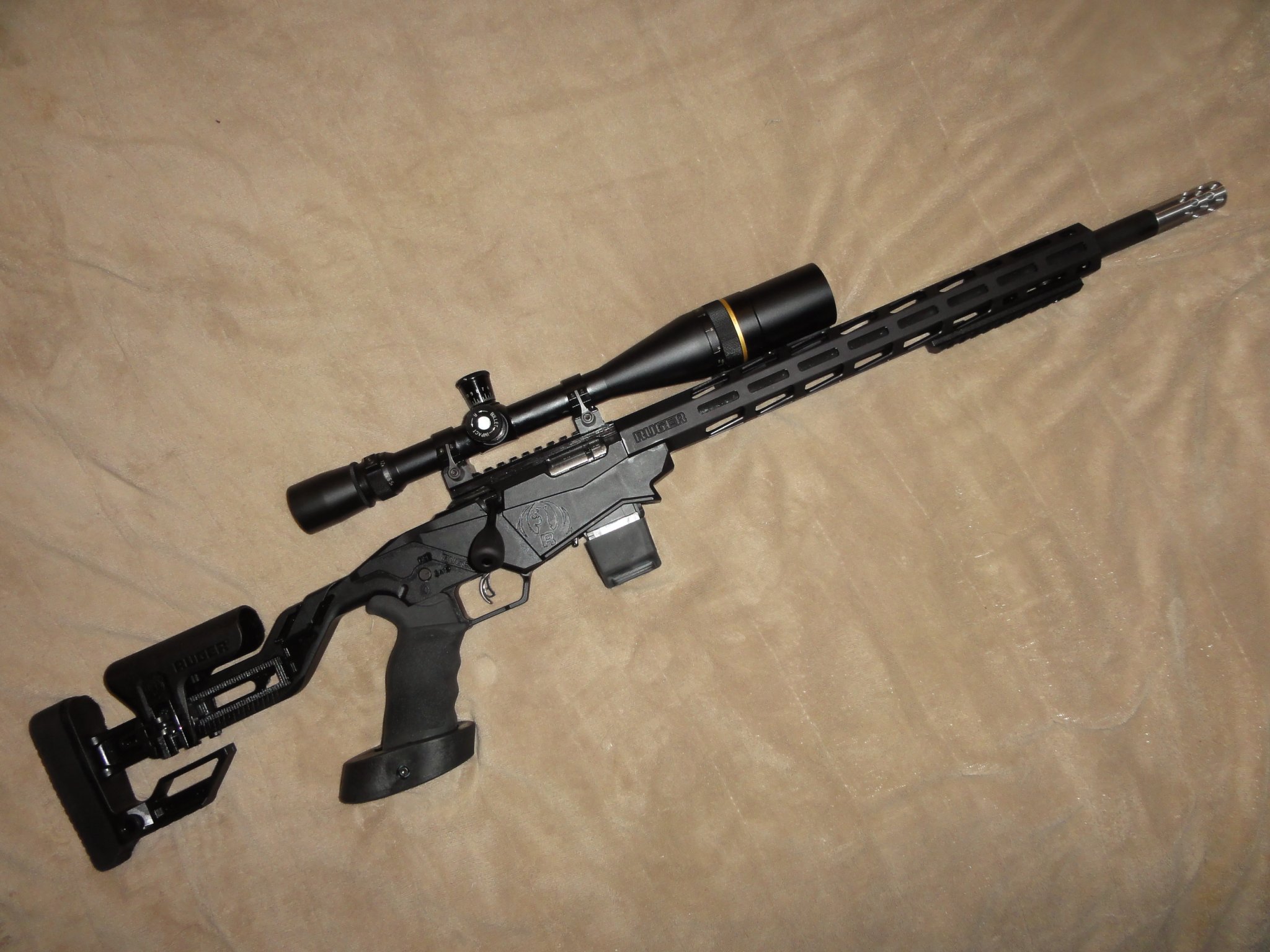

The more I shoot my Ruger, the more I wish it was a metal chassis (and slightly heavier). I think a the accuracy/consistentcy would improve a lot by having a metal chassis. The flex on the rear end is pretty noticable with any amount of pressure into bipod (basically anything over free recoil).
But it still shoots pretty well other than the CB. Got to shoot it alongside a Vudoo and it held in there but jeez. The Vudoos are scary tight at closer ranges. For reference, the dots are .75"
Not sure it's worth 2000+ more but still unbelievable with good ammo. Still a bit jealous though...

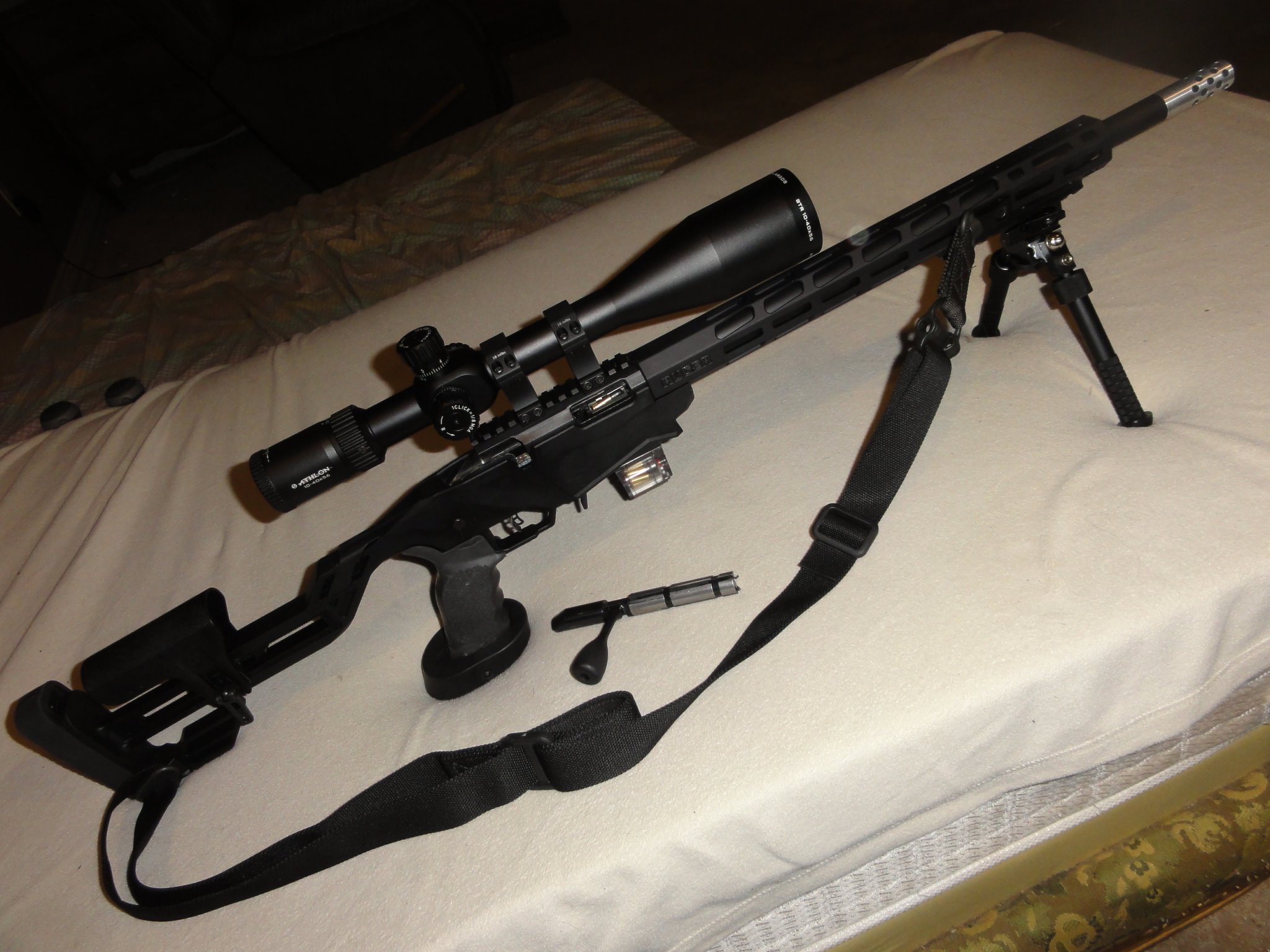

RPRR with Lilja Barrel, S&B Short, and an old YHM wire EDM / K baffle can.... -smile- The anti-squirrel rifle...
7066293
Now... let's go see if all of those mods you guys mentioned make a huge difference... ;)
