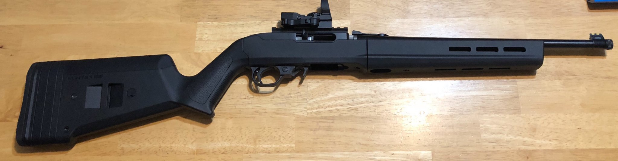

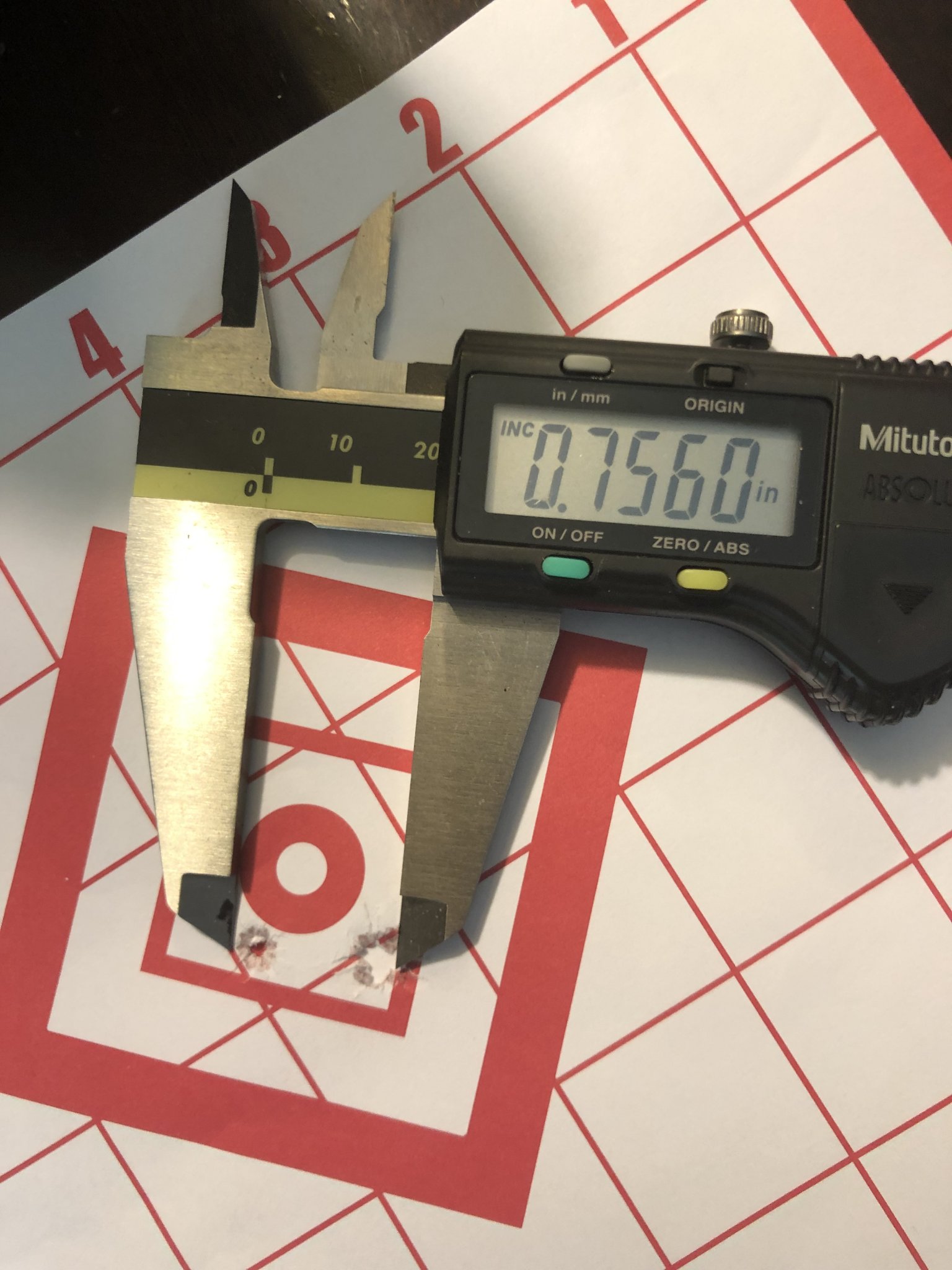

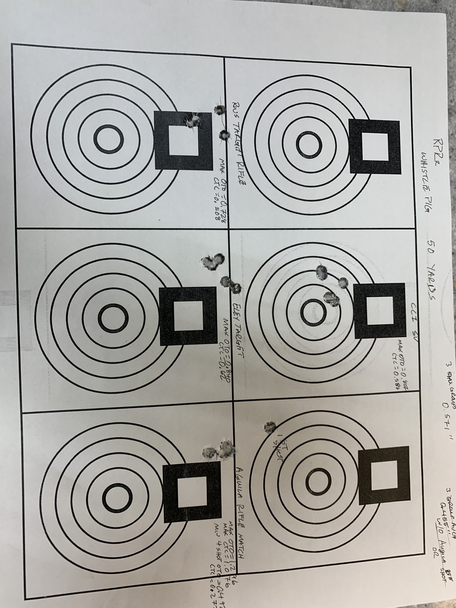

See the contestWell I got the Whistlepig barrel installed and went to the range to zero the scope with the new barrel. I started out with about 50 rounds of CCI SV to get a little fouling in the barrel. After that I shot Eley Edge, Wolf ME, Lapua Center X and SK Rifle Match. Nothing I shot would shoot less than 1” at 50 yards. In contrast every one of these ammos shot around .5” with the stock barrel. I also tried all of them in my Tikka and Savage MKii. With my Tikka two of the ammos were shooting very close to .25” five shot groups at 50 yards and all shot around .5 in the savage. It would shoot a few nice and tight then I wouldn’t get a flyer way outside of the group. The scope and rail are tight so that isn’t an issue. I sent an email to whistepig asking if they could give me torque specs to make sure I did everything correct but as of right now I am afraid I may have got a lemon. Maybe I just need to put more ammo through it but I already put close to 200 rounds through it trying different ammo so that doesn’t seem likely.
Yeah, I got one with a Bentz chamber. 16 1/2” long 1:16 twist. I’m waiting to hear back from Whistlepig before I cash it in though. My hope is it’s something I did wrong though I don’t know what tcould be. I’m going to go over the rifle one more time really well tonight just to make sure I didn’t miss something. At this point my other sons dead stock 10/22 shoots better though which obviously isn’t right. I’m sure the maker will take care of me though. Usually small companies like that have good customer service. The thing that really stinks is we have a match on Sunday and my son was really looking forward to using the lighter rifle. We may just have to switch back to the factory barrel tomorrow.

The rifle has actually been almost perfect for him. The barrel is just too heavy for off hand shooting for him. If we can get this barrel to shoot we will be set. I’m about to go over the rifle one more time to make sure I didn’t miss something and hopefully I will hear from WhistlePig.

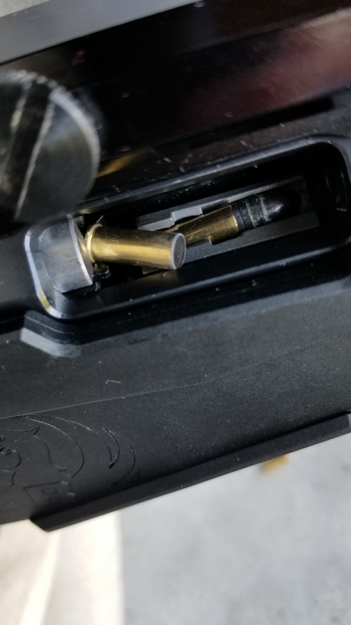

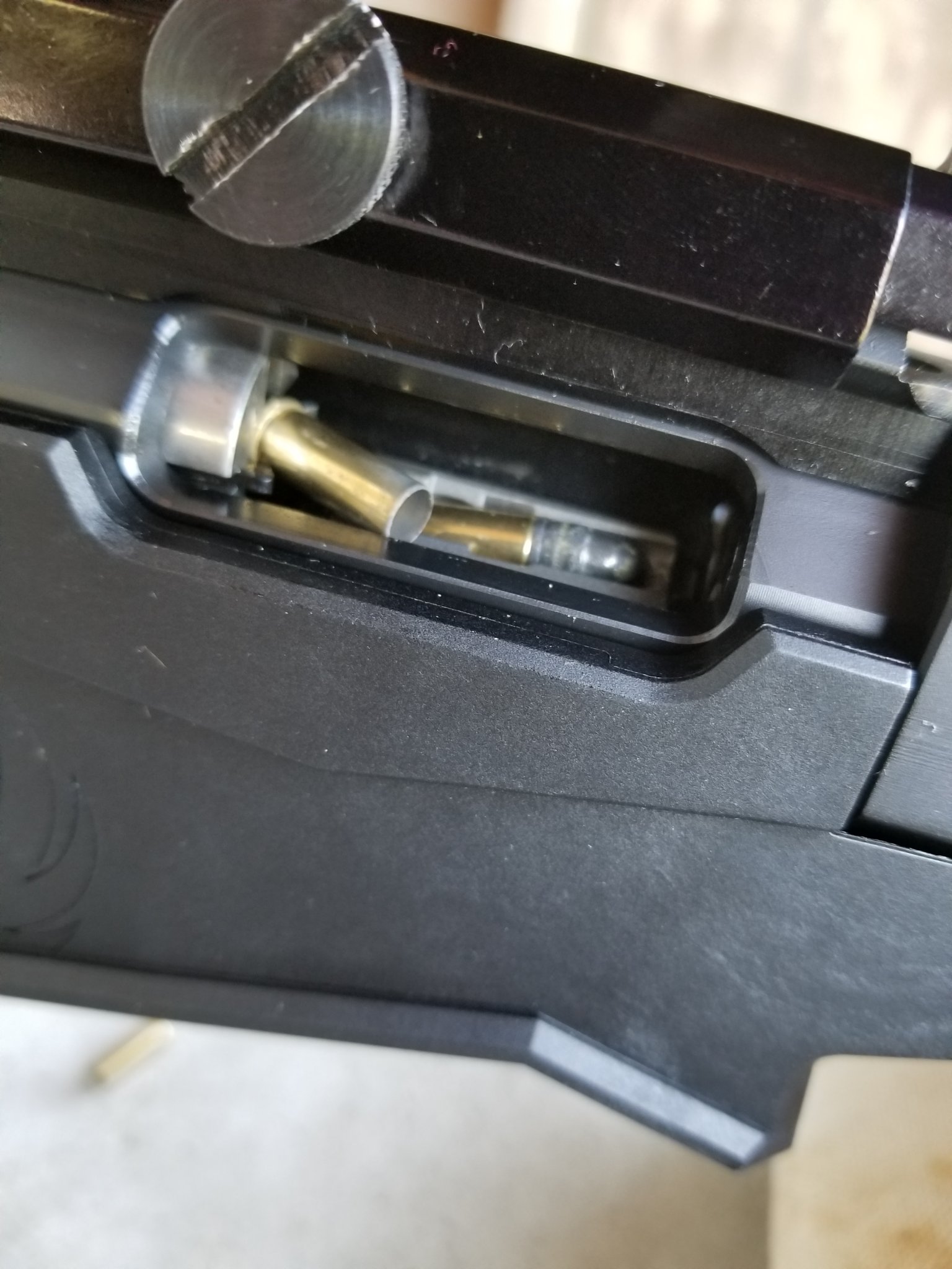

So my 16 year old son saved and saved and finally had enough to buy his new RPRR. Shot it 15 times, every single one ended with a FTE. Calling Ruger Monday. Not happy at all. No matter how fast/slow I worked the bolt... nothing. Seems to get hung up. Have a video but can post it
Wanted to give an update on my Whistlepig barrel. Louis at Whistlepig has been great. He offered to take the barrel back and send me a new one right away. I decided I would pull the barrel and clean everything throughly then reinstall it. I mounted the barrel with green Loctite and tried different torque settings on the action bolts. I just want to make absolutely sure that I didn’t do something wrong and send back a perfectly good barrel. I will not be able to get back out to the range until the end of the week but hopefully it was something small I missed that is fixed now.

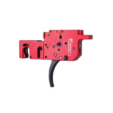

Two-Stage Replacement Trigger for the Ruger Precision®
Two-stage replacement trigger for Ruger® Precision Rifles (RPR). Made in the USA by Timney Triggers.timneytriggers.com
Timney trigger is out...263.00

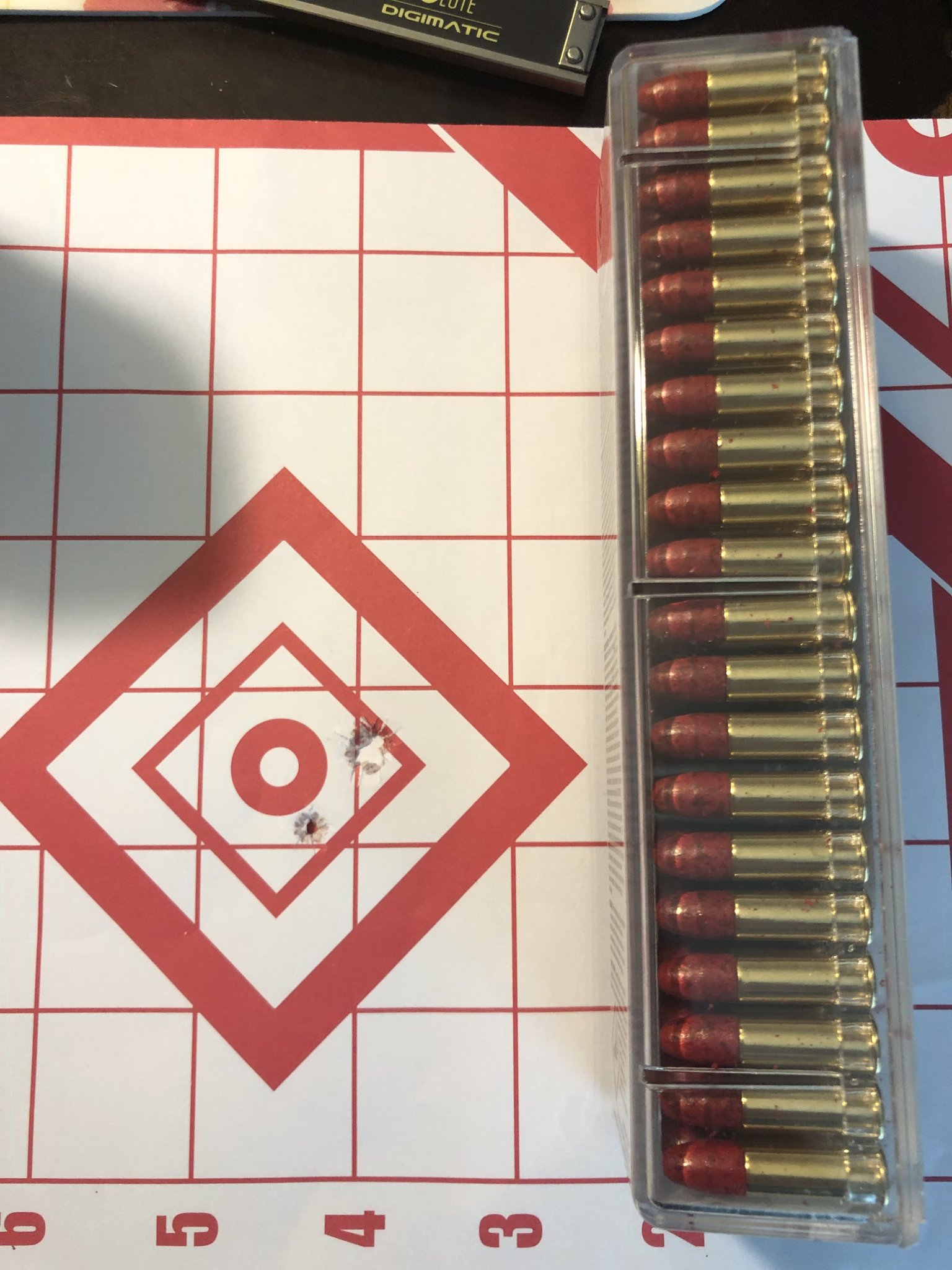

Update on the Whistlepig barrel. After taking the rifle completely apart and cleaning everything the barrel shot much better. It was pretty consistently shooting groups around 1/2” at 50 yards with Eley Edge and Wolf ME. I still would like to get some more ammo through it to see what it is capable of. I am hoping once I get a few hundred rounds through it the groups will tighten up some more.
Received the rifle back in about 12-14 days. Taking it out this weekend for a go round. Included documentation states that they fixed it and test fired successfully 15 times. That is yet to be determined. I wish I would have taken a picture of it but on the boltface there was a thin piece of metal that appears to have not been completely taken off. It looked totally out of place. I'm sure that had a lot to do with it.Called Ruger today. On it's way back to be fixed

Frankr, I went out today and shot my sons Ruger PR with the WP barrel and the ammo we plan to use for a match this weekend. The funny thing was his rifle was shooting WAY faster than any 22 I own with the same ammo. My normal elevation at 100 yards with Eley Edge is 1.9 mils. His was 1.5. Same thing all the way out to 300 yards. His elevation at 300 was a full 1mil less than mine. I checked the velocity out of two other rimfires I own with the same ammo and I was getting 1065FPS - 1080fps average. When I cronographed the WP barrel I was getting 1150FPS which matched up perfect with my dope. Does your barrel seem to run really fast? I may need to switch to a different ammo that will shoot a little slower. I think I was getting some bad grouping at 100 yards because the ammo is coming out of the barrel right at the cusp of being supersonic.
I think once you get some more ammo through it those groups will tighten up some even more. The one I have pretty much leaves a ragged hole at 50 yards with most of the better ammos but I would guess I have close to 500 rounds through it now. It seems like all the rimfire barrels I have shot seem to have a magic number where they settle in and really start to shoot. I know the first 100-150 out of mine were not impressive at all. I almost sent the barrel back but I think it just needed broken in now. It shooting gas is a problem though since most ammo is designed to shoot around 1080fps. I believe this is where my problems at 100 yards are coming from. I shot some Wolf Match and it seemed to be a bit slower so that may be the answer.
