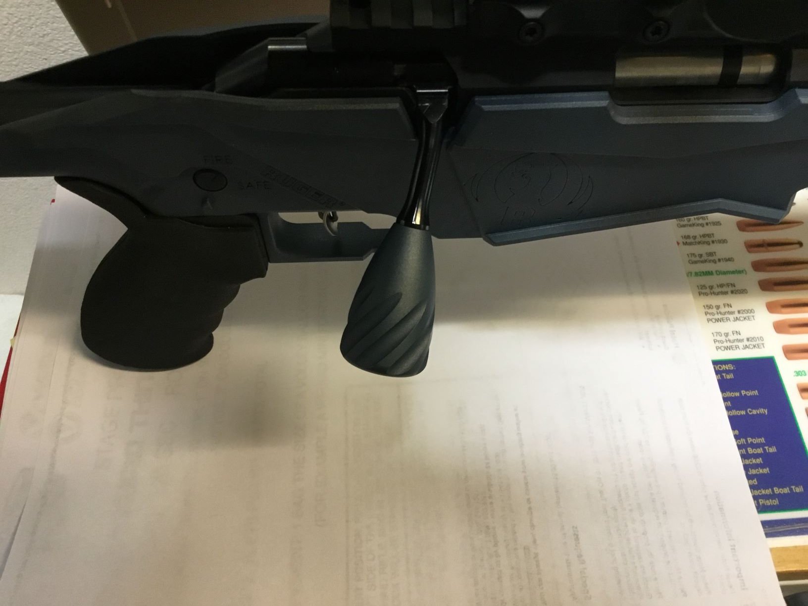

Oh also, my bolt knob keeps loosening - trying to decide whether to stick with it or swap out for a nicer piece - what's everyone upgrading too these days? I've got an Anarchy Grenade on my 6.5 but really don't care for it - only reason I haven't replaced it is it's cerekoted to match the rifle :rolleyes:

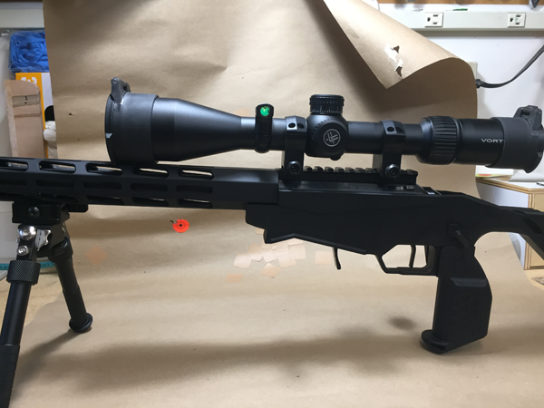

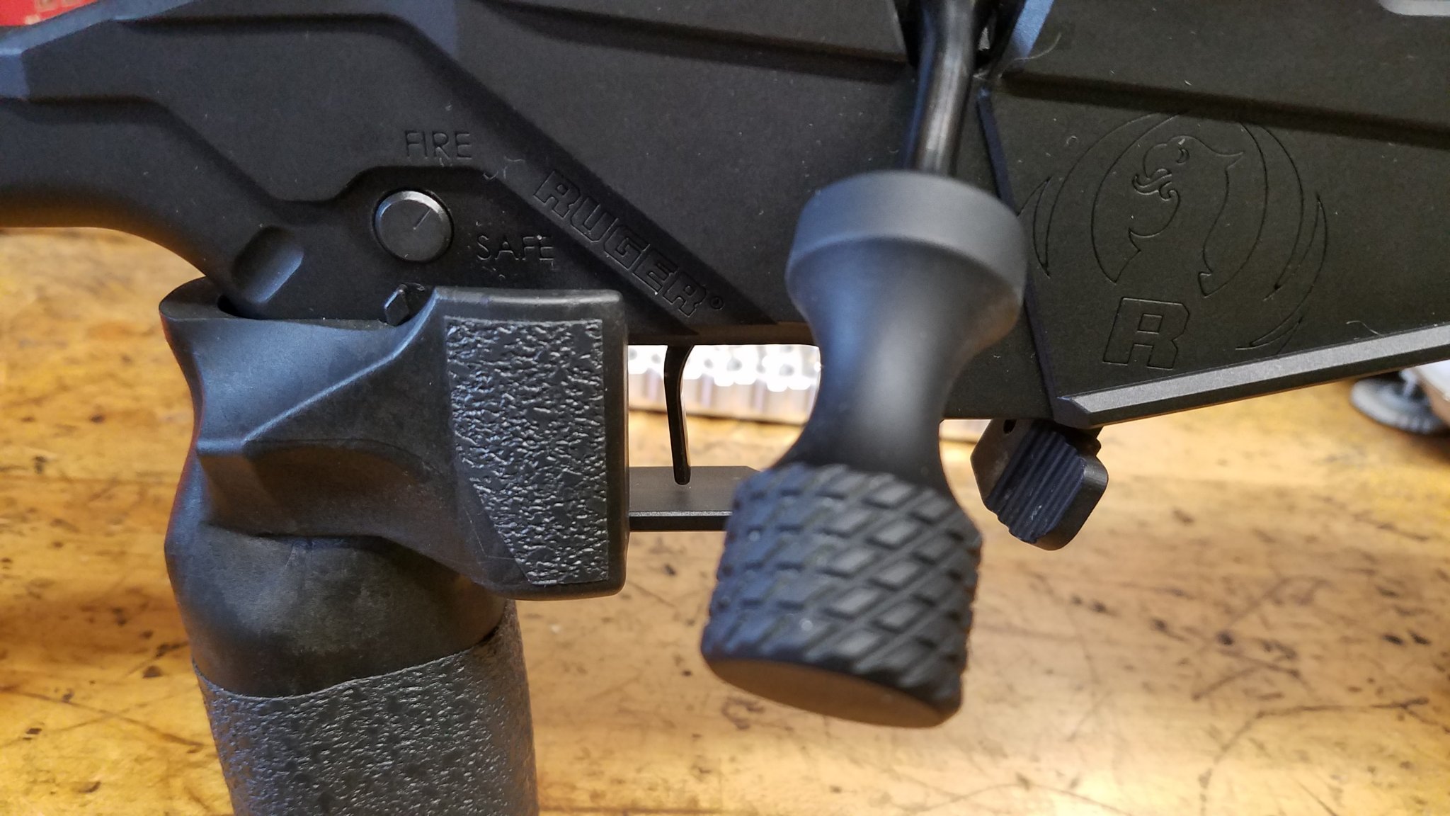

I have my RPRimfire set up to mimic my 6.5 RPR. Catalyst arms bolt knob and mag release button on a modified TSW extended mag release lever, MPA EVG and Timney trigger (2018 Beta version)
I also replaced my knob, and used blue lock tight, and so far hasn't loosen up after thousand of rounds fired.
Reactions: theaoguy
I got mine off Ebay. I think it was called Pure-Precision. I used a bit of blue loctite and it has been solid.

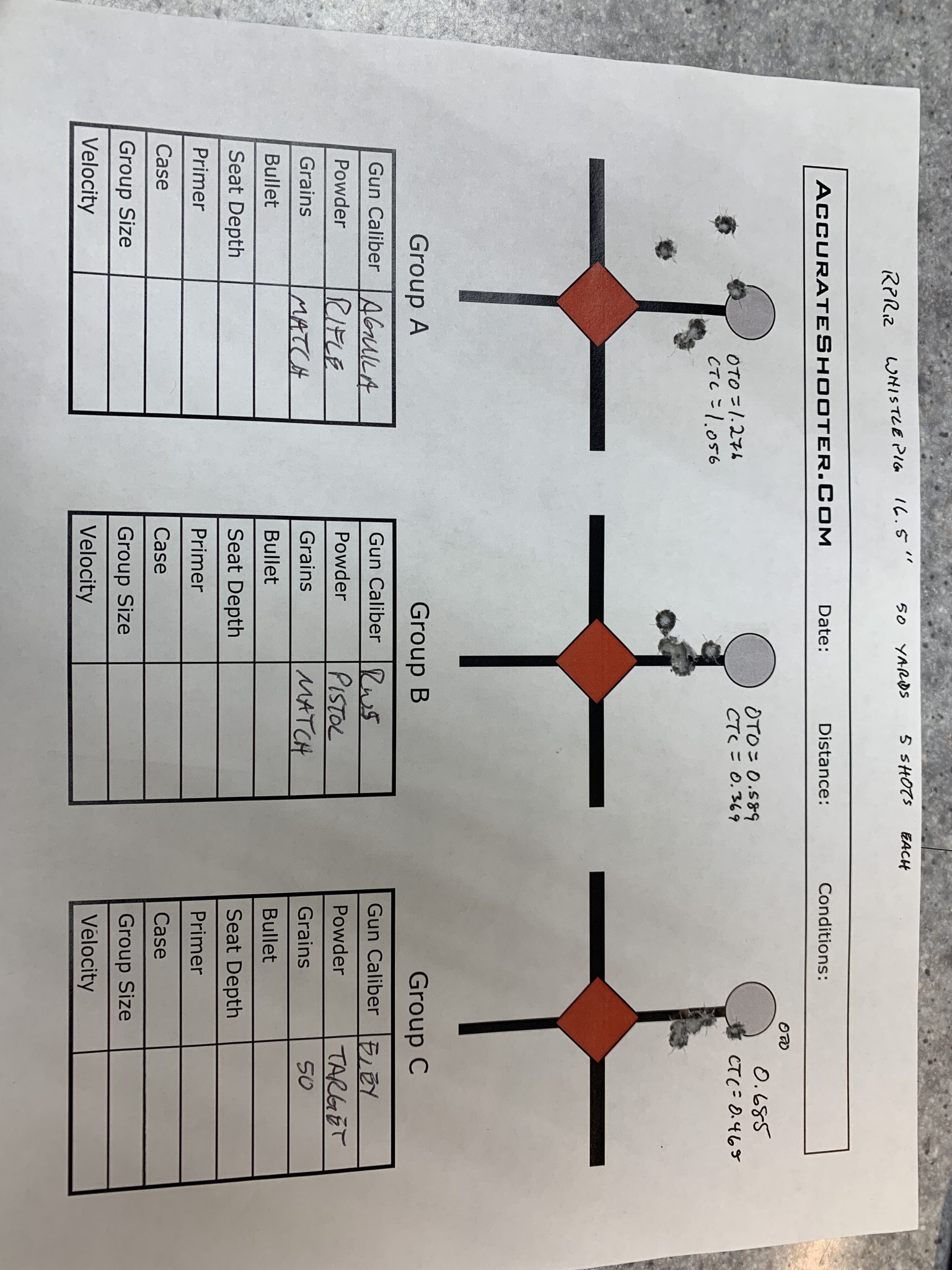

Took my boys RPRr out shooting yesterday to test ammo and the first few groups were frustrating and I finally figured out it was me preloading the bipod that was causing flex in the rear of the chassis. When I let the chassis more or less free recoil then the groups looked better.
Side note: my match chamber on the groups below was getting sticky and needs to be cleaned. Had to get in there with my fingers to remove a few fired shells.

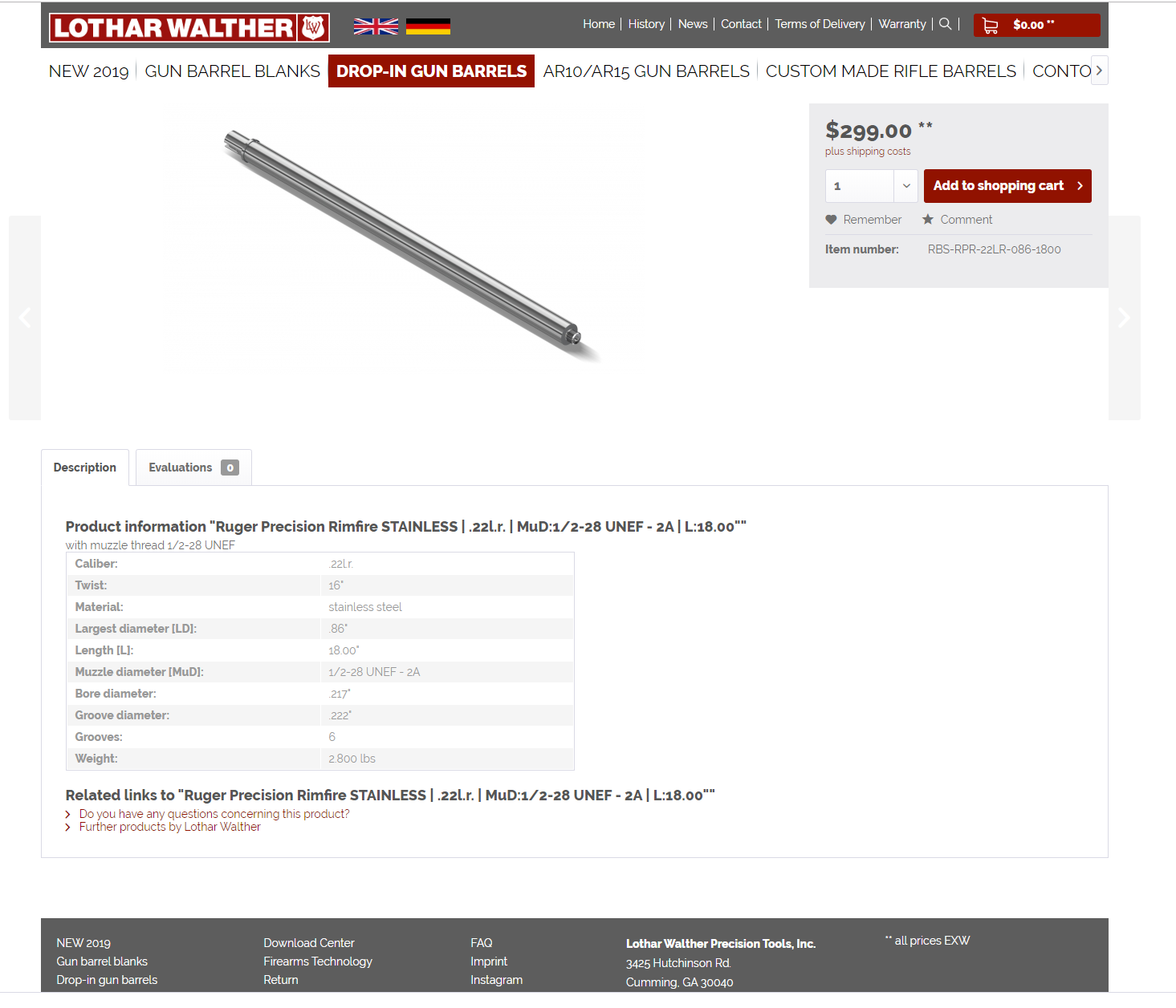

I'm interested in the 22 LR. They also have barrels for the the 17HMR, 17HM2 and 22 mag. All are listed at $299. I got an email awhile ago saying the 22 LR was in stock and could ship in 48 hours. I'd much rather have a Lothar Walther SS barrel for $299 than the Lilja barrel for what...$400? I just wondered if anyone has one and what they thought of it. I'm still hesitant to spend money on it. I just found the Walther drop in barrel last night.
Sorry can't see spending that much money for fairly inexpensive rifle, if I had CZ or Vudoo I might consider, but right now I hit what I aim at 100 yards, with barrel it has, with no issues. I only had two issues with the rifle, trigger and mag. release, trigger done, mag, looking for something I might like to install.
If I was going to spend that much money I would buy pistol or another rifle to have fun.
Good find!
Wonder what chamber the 22lr is.
Also I have never read about barrels made by Lothar Walther in 17hmr or 17hm2.... would love to see some teal world results from them
At $299 for the 18 inch for the comparable ER Shaw at $250. I would be curious myself to know what spec chamber Lothar Walther are reaming and if they have increased dimensional tolerances like ER Shaw has for a better tighter fit in the receiver. I run a 20 inch 416SS ER Shaw.

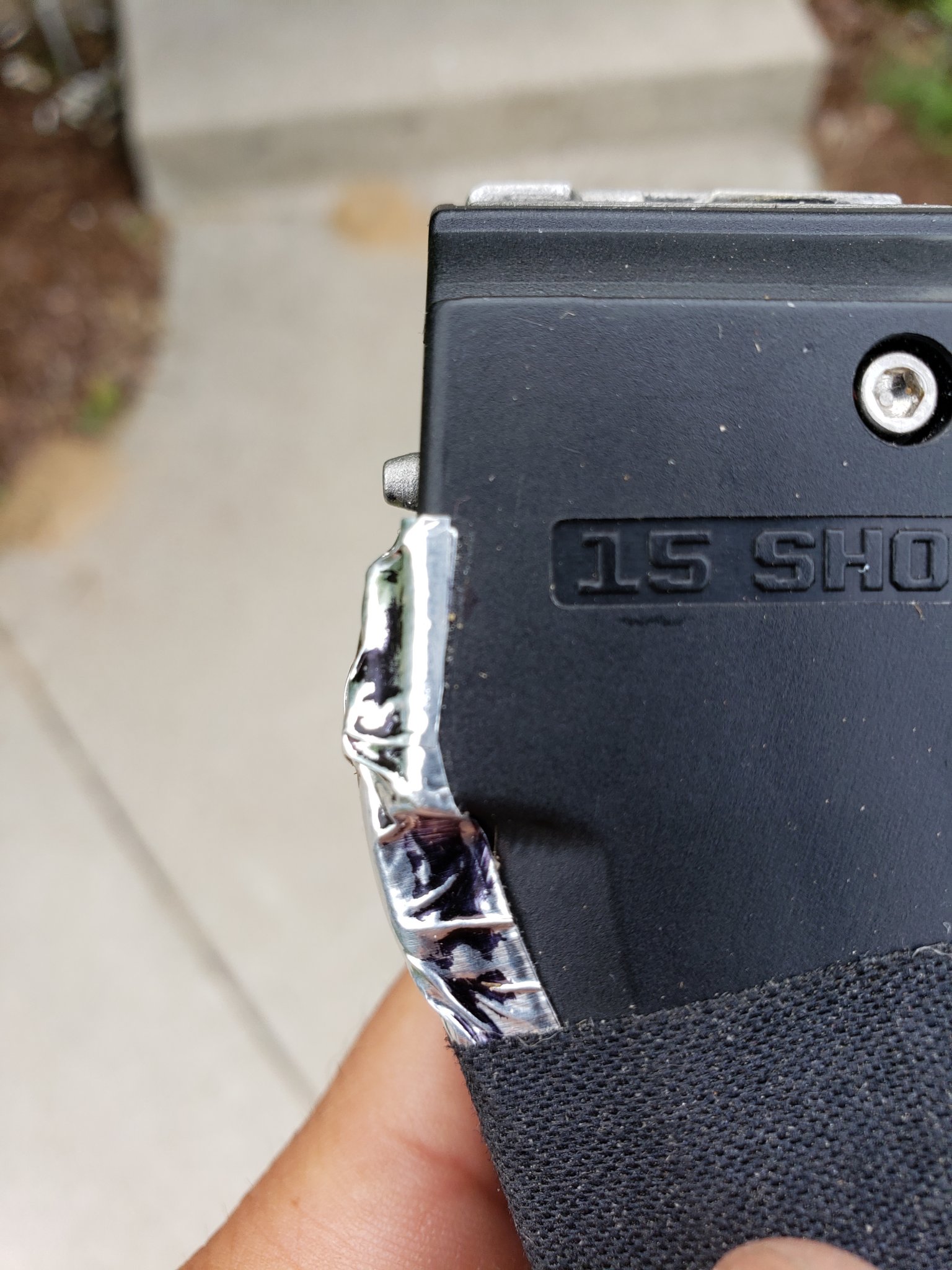

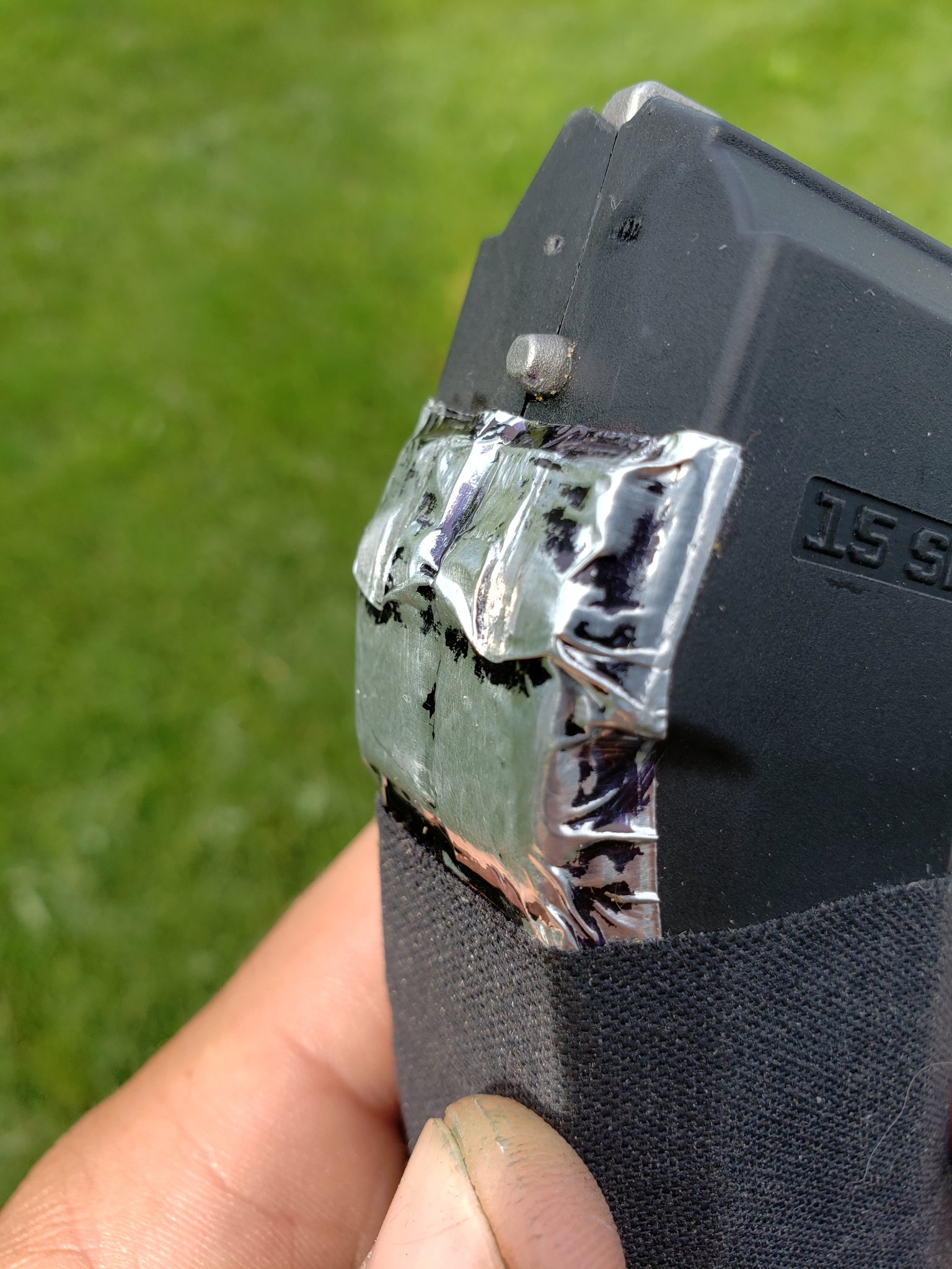

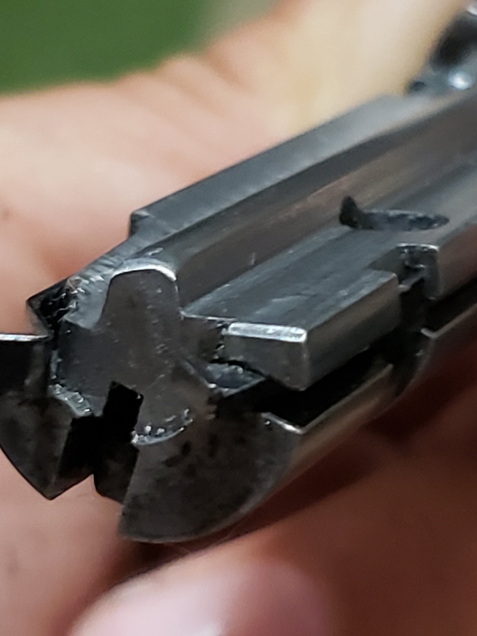

Just in case anyone else is having issues with first round or two acting as flyers (high, left, right, etc) I had the chance to work on my buddies rifle (and mine previously) and solved his issue.
The 15 round mags that come with the rifle fit about as well as a hotdog in a hallway. But I noticed that it's usually only the first 1-3 rounds (regardless of number of rounds loaded in mag) that have consistent flyers. That means it almost certainly has to do with orientation of the mag/feeding the first few rounds.
I did added enough foil tape to the back of the mag to add some tension when mag is fully locked in position and bingo! Flyers disappeared.
Also, I sanded/rounded the bottom of the bolt significantly so that the bolt doesn't leave marks on the round under the bolt. These two mods alone improved my friends rifle from 1.5" -2" at 100yds down to 1" or a hair over.
Hope this helps and I can post pics if anyone needs them.

I would like to see the pics you have. Both of the foil on the mag and the bolt before and after sanding.
What is the thinking as to how the stock mag orients itself after 1-3 rounds?
Exactly. I think the mag sits differently after running bolt a few times and it affects how the bullets get "marked/damaged" while being chambered. It seems they correct themselves and become consistent after 1st or 2nd shot.
I know I can get pics of the mag before/after, but I didn't take any before pics of the bolt, just after. But you should be able to compare the photo to your bolt and see an obvious difference.
Thanks I'd appreciate anything you can show.

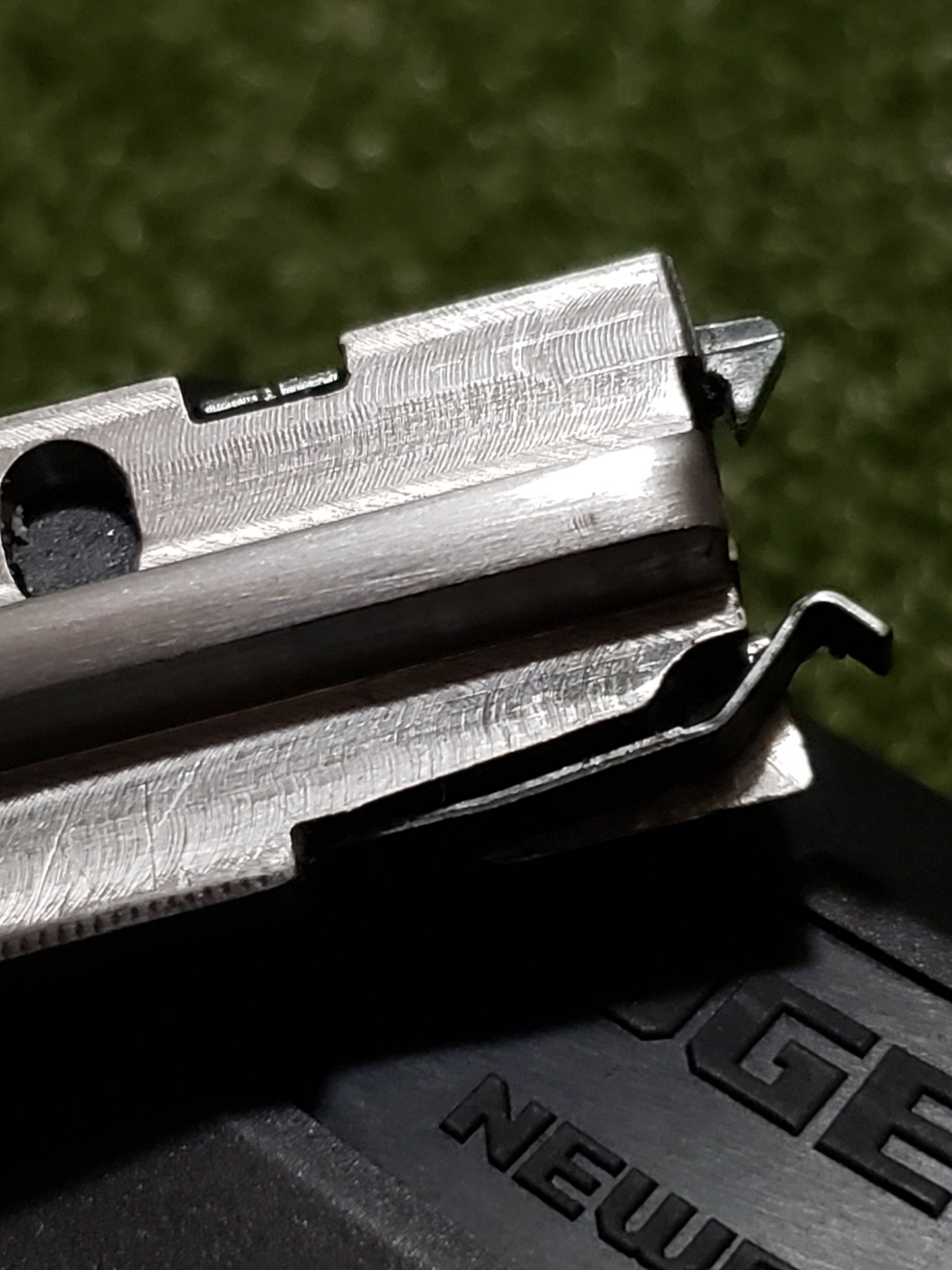

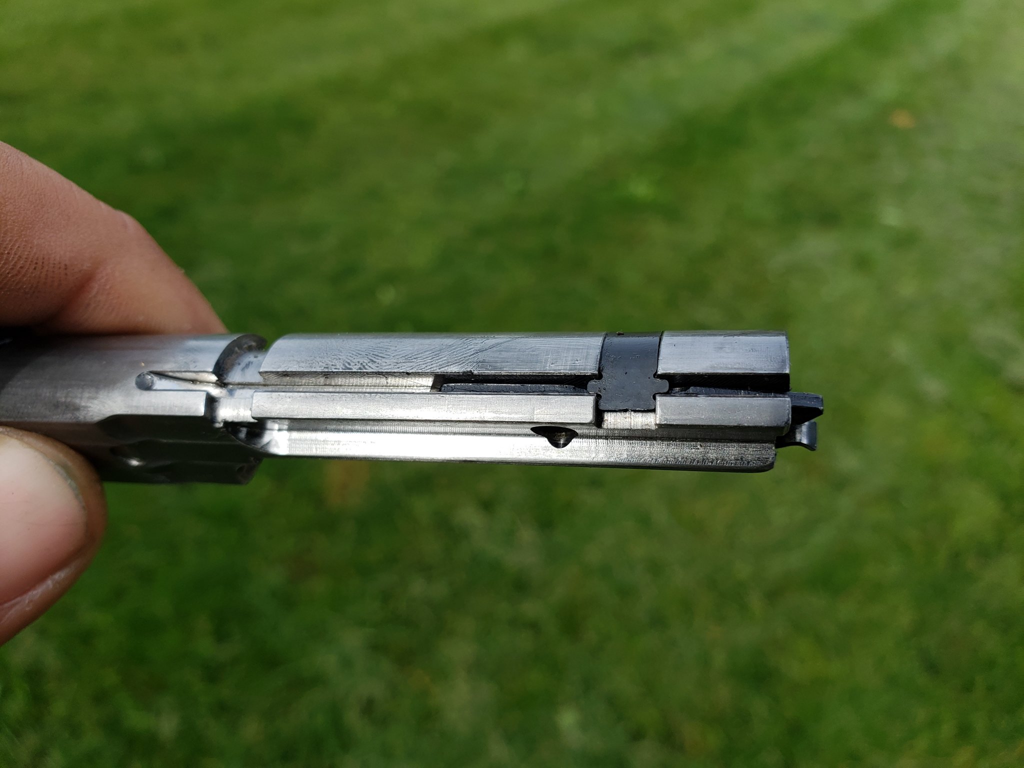

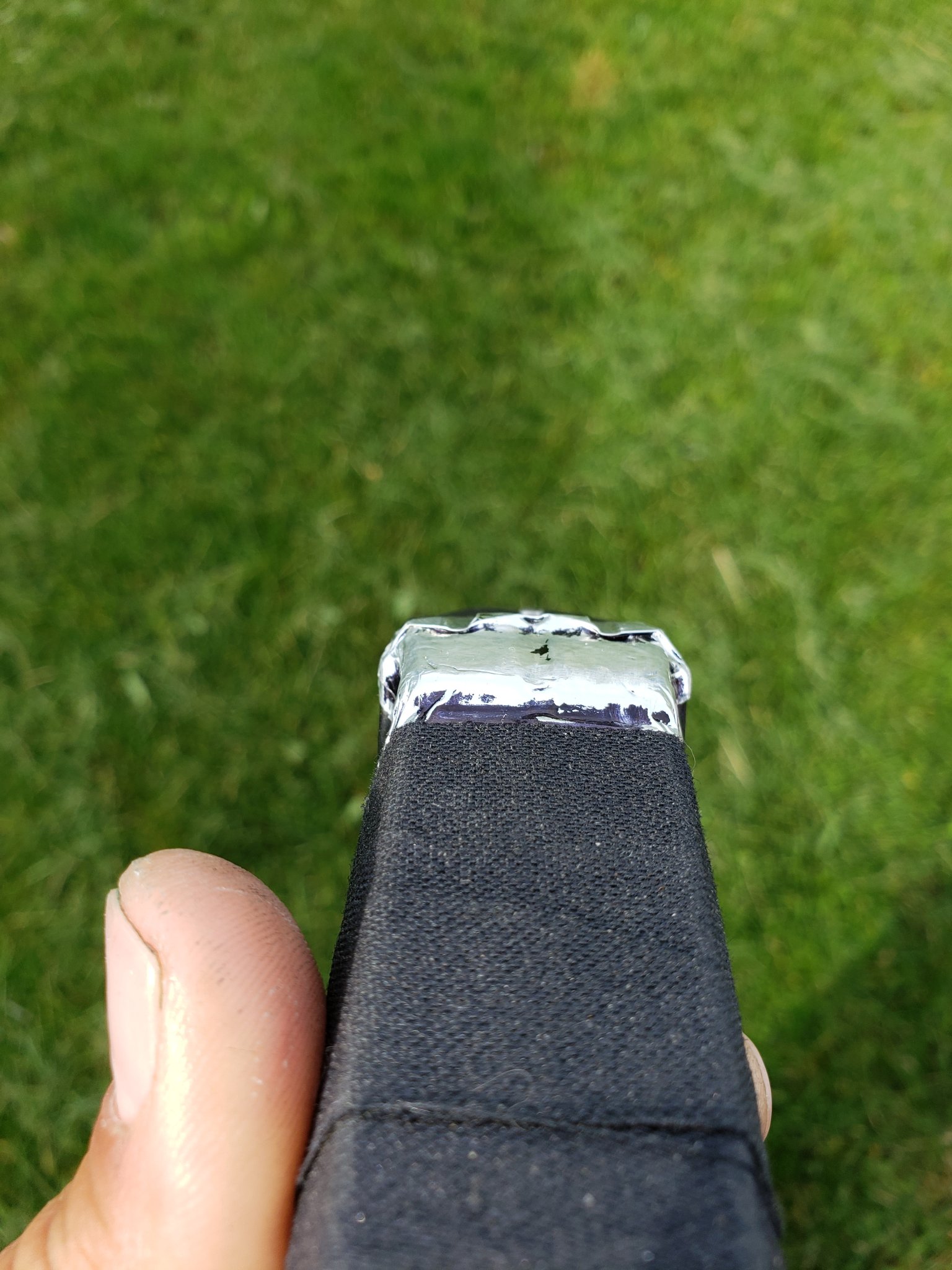

Pictures of mods to bolt and magazine. Bolt nose is rounded and tapered back. It's hard to see, but I've put a slight taper in the bolt for the first 1.5" or so. Also sanded/polished all edges to smooth bolt stroke and feeding.
I could definitely go further with this and I think it would improve it further, but you need to be sure it catches the next round solidly. Remove too much (like an 1/8") and you will have a single shot 22lr. So go slow.
7094949
7094950
7094951
7094952
Magazine: I added strips of electrical tape as initial build up material and then several layers of foil tape over top to get to final thickness. It should go in snugly/firmly and stay that way regardless of pressure front/back on bottom of mag.
Goal is to keep the mag at the same height (all way to the top) and have nearly zero pivot for and aft. If you wiggle magle front to back, you will see the front edge near chamber move up/down which is what you are trying to prevent.
Tape wears in after a few removals so once you get close add a layer or two as it confirms to your rifle.
7094953
7094954
7094955

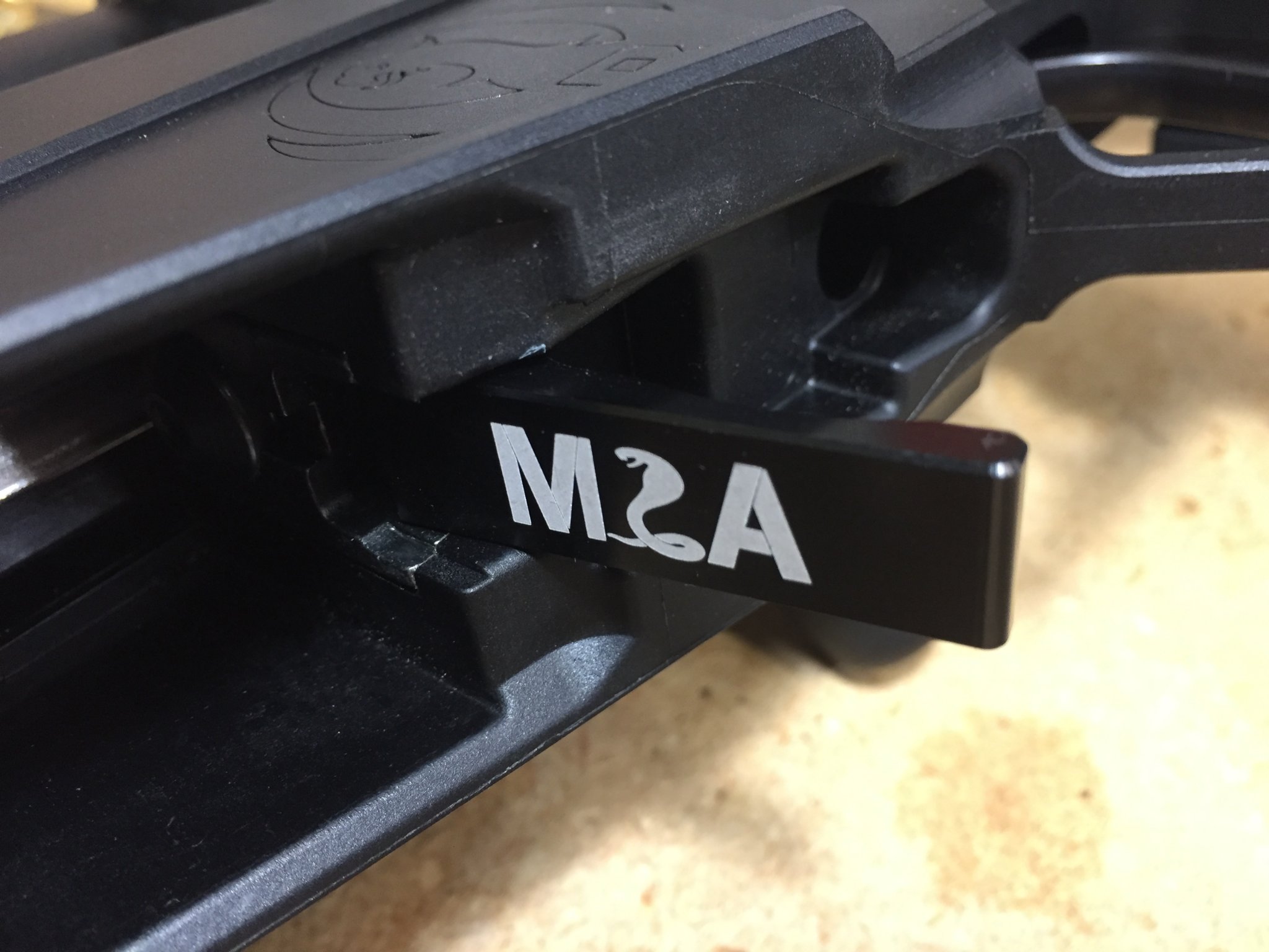

If you're looking for and Extended Magazine Release for your Ruger Precision Rimfire, try one of these;
7096251
I've had one for a couple of months and it works great. Installation is a snap.
7096252
7096253
I got mine at my LGS. They're also available at Anarchy Outdoors

@vaguru hit the nail on head:
  1. Add foil tape or even duct tape to mags to ensure they are firmly planted in receiver (no for/aft wobble or play). The first round or two will feed at different angle than the rest causing change in bullet shape/damage to driving band.
  2. Use 320 or 400grit sand paper to polish and smooth the bottom side of bolt (specifically, the ridge that picks up next round). This is typically very sharp edges and will damage the bullet that is on deck in the magazine as bolt closes, scoring the round. Easy to check: put in full mag, chamber round, eject round unfired and leave bolt open. Drop magazine and look at the bullet in magazine. If it looks like pic below, polish the bolt more.
  3. If all of that fails, either contact Ruger or buy an ER SHAW barrel ($250). The Shaw's run well (sample of one in my case but others have posted similar results).

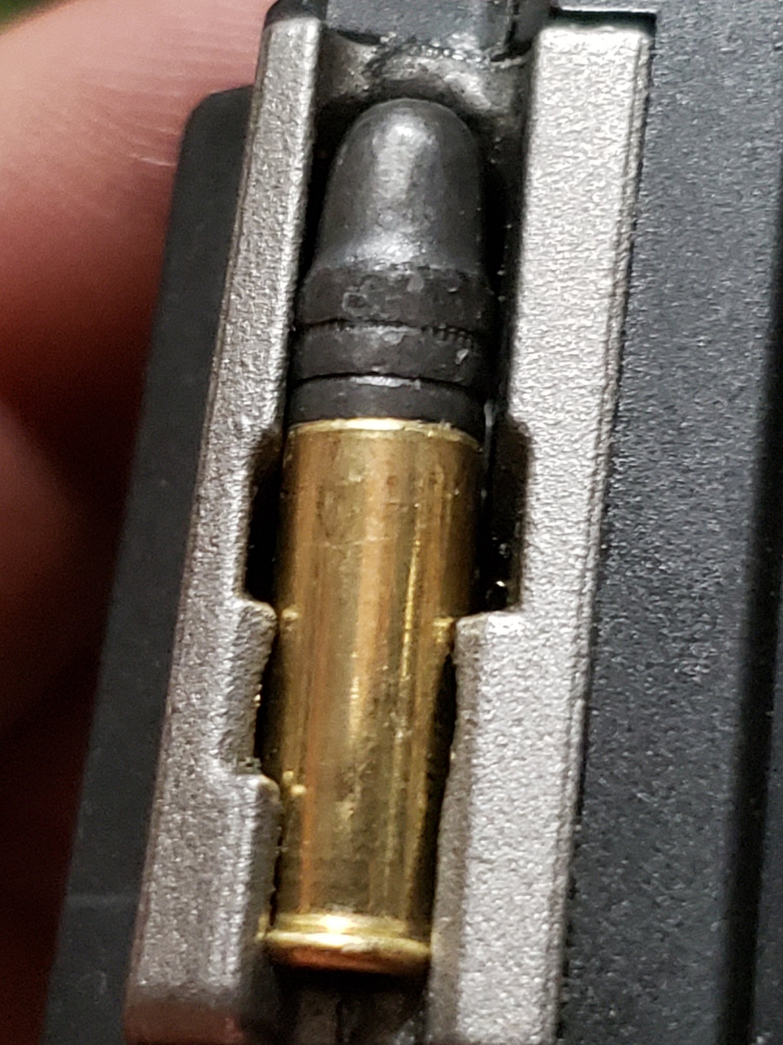

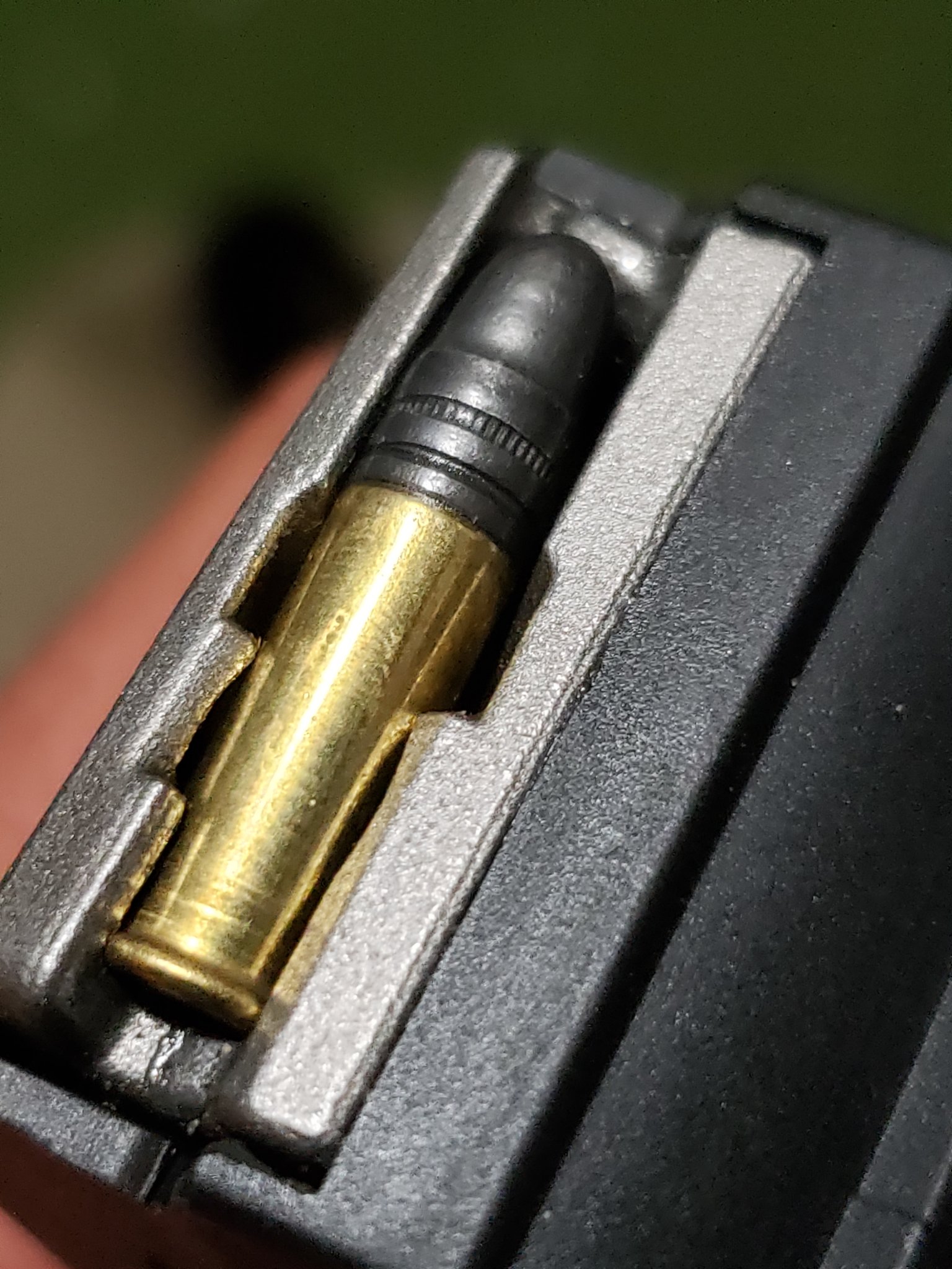

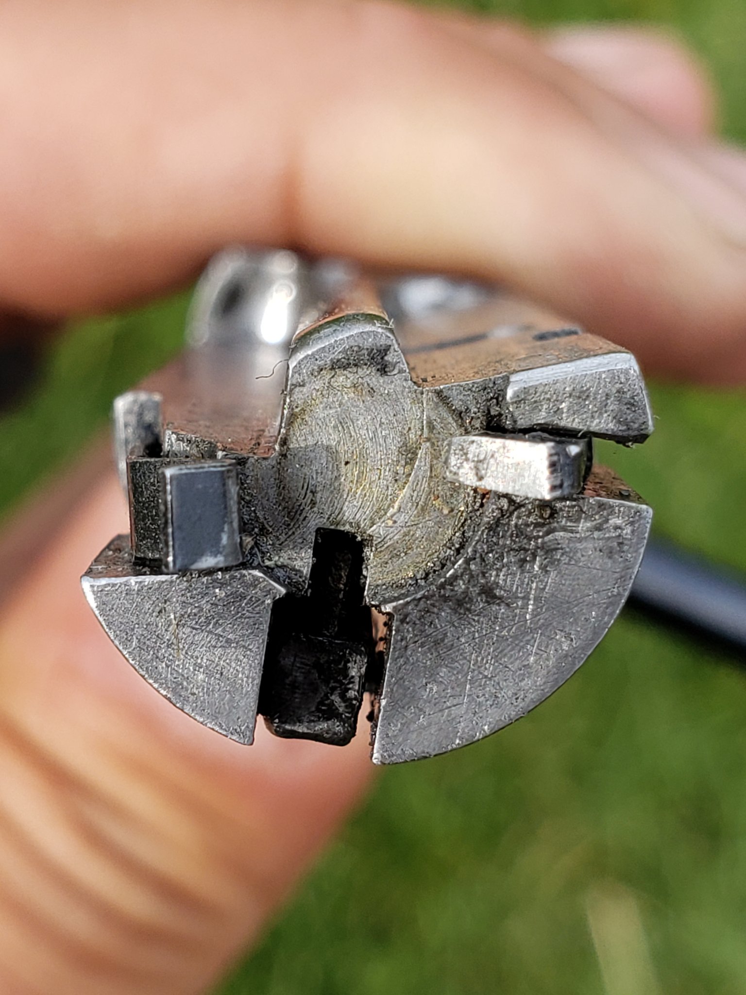

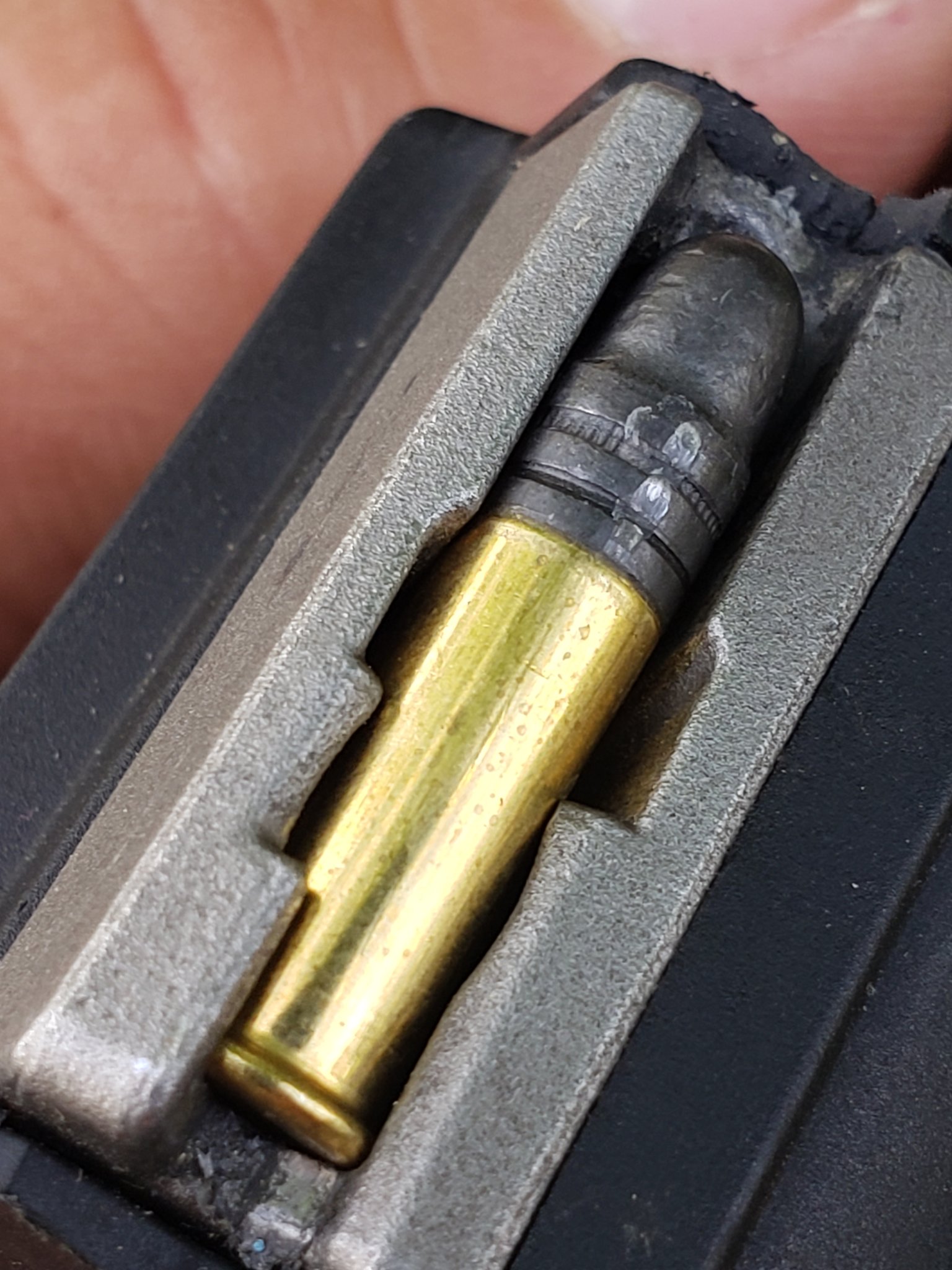

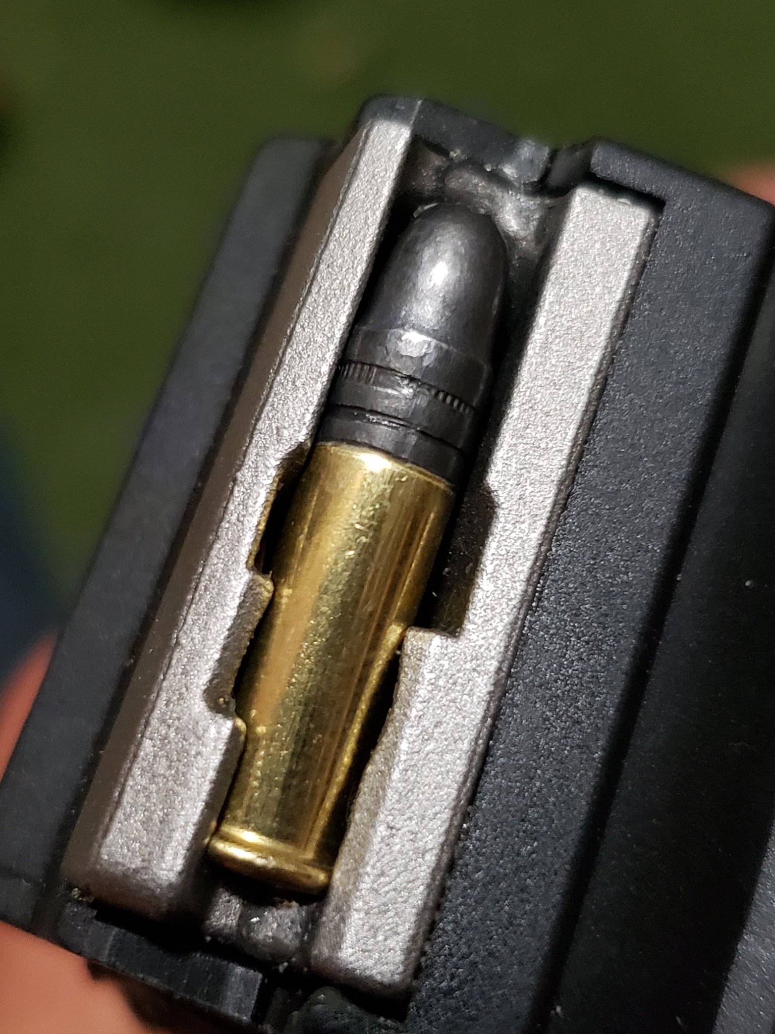

Photos of Unmodified magazine/bolt:
New round (not chambered):
7098840

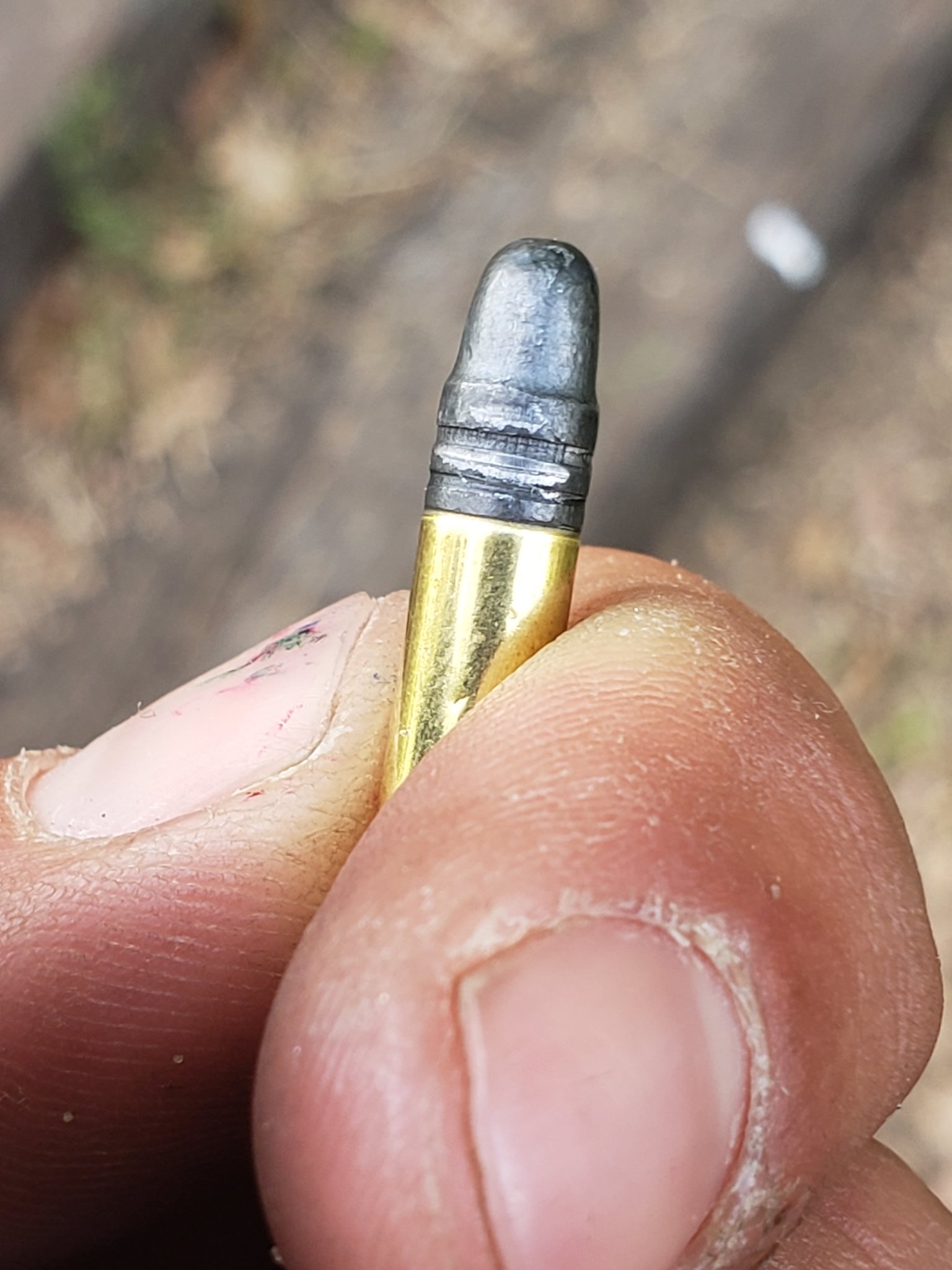

Damage on first round chambered.
7098835

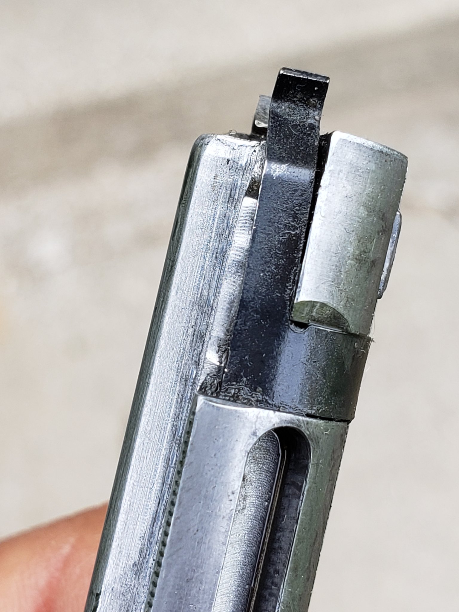

Unmodified bolt bottom: Damage on round under the bolt.
7098836
After bolt smoothing (I still have a bit more to do but it was good enough at the time) and magazine tape modification:
7098842
Section of the bolt that needs smoothing front edge back to the hole behind the retaining clip (or further if you want. )
7098843
7098844
