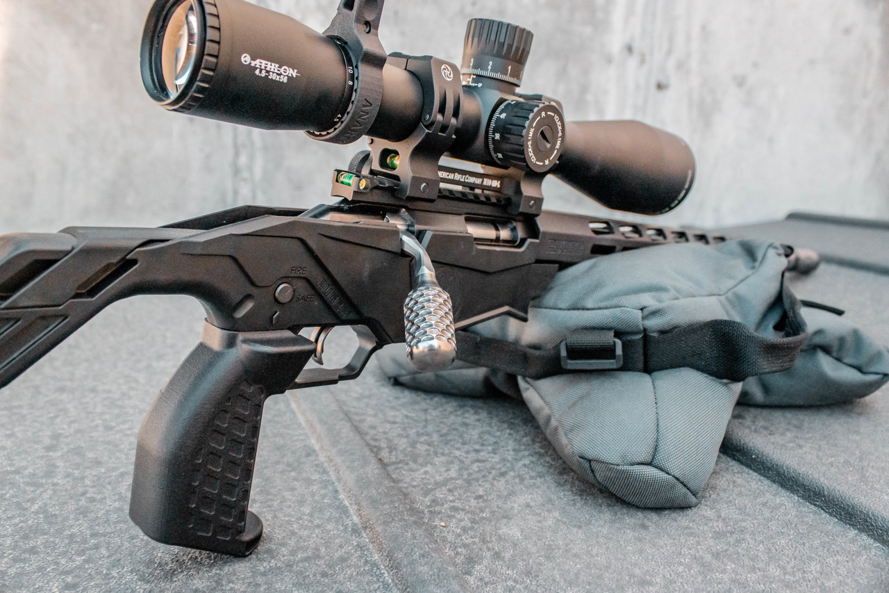

I also replaced my knob, and used blue lock tight, and so far hasn't loosen up after thousand of rounds fired.
Nice Bolt Knob, our handles is coming soon as well.

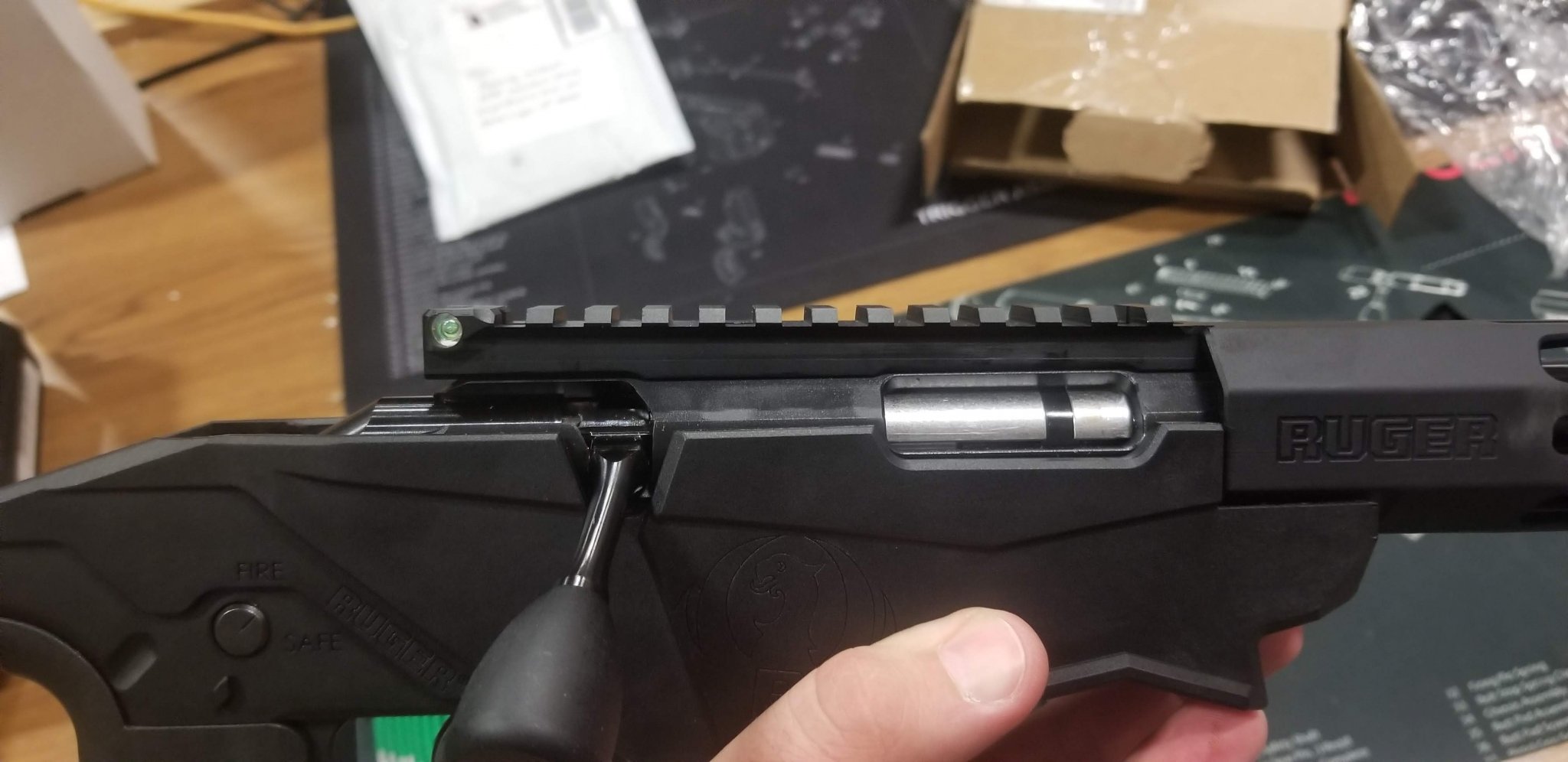

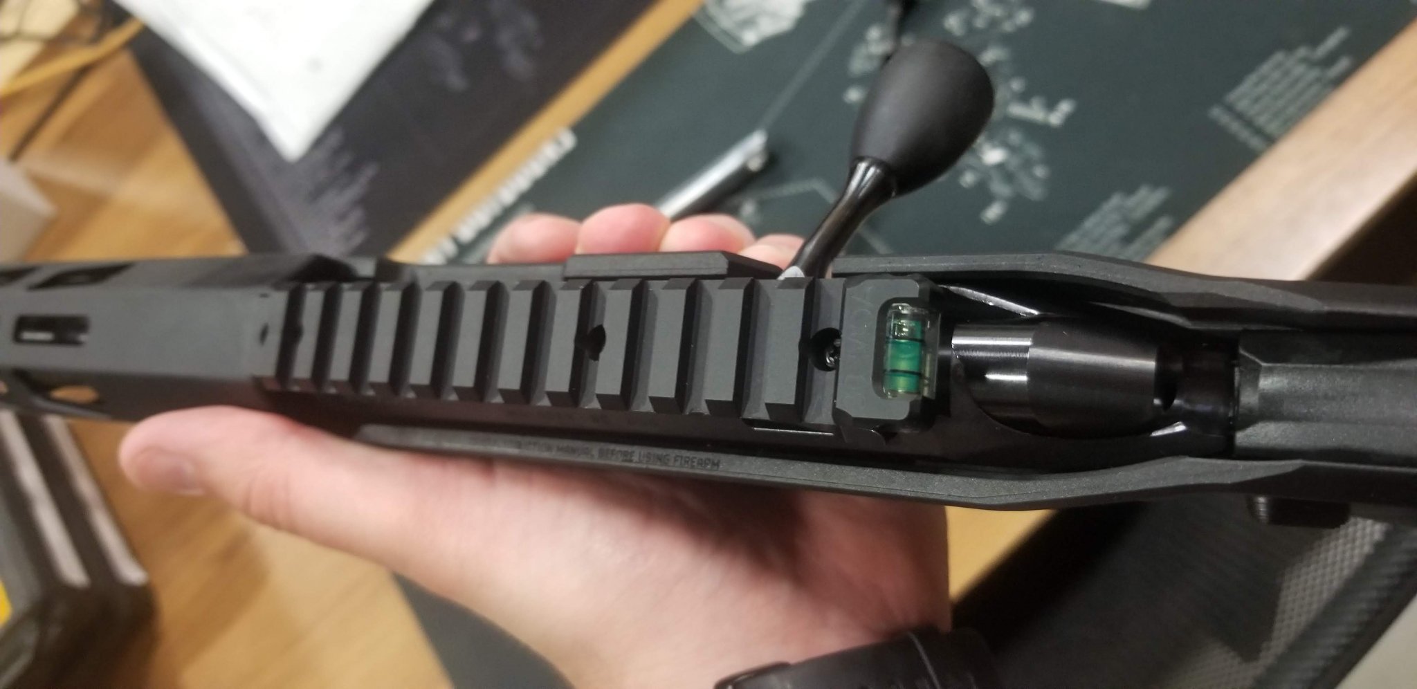

Looked at a new RPR RF in Gold today. Slick color.
Checked the bolt bottom to see if there were any burrs on it that rides over the round in the magazine. Interesting to note that this bolt was now chamfered about 1/16" at that point.
The one I bought in black last May was not, so it appears Ruger has made a mod to prevent scraping the bullets as the bolt rides over the magazine. Still needs to be polished and I also noted that the chamfer was not even side to side, but deeper on one side.
One other thing I noticed was that the bolt handle hit the top of the receiver when operated. This of course will wear in with some use or a little polishing.
Just an FYI.

Very interesting.
Wonder if they read the forums and watch the mods being done.

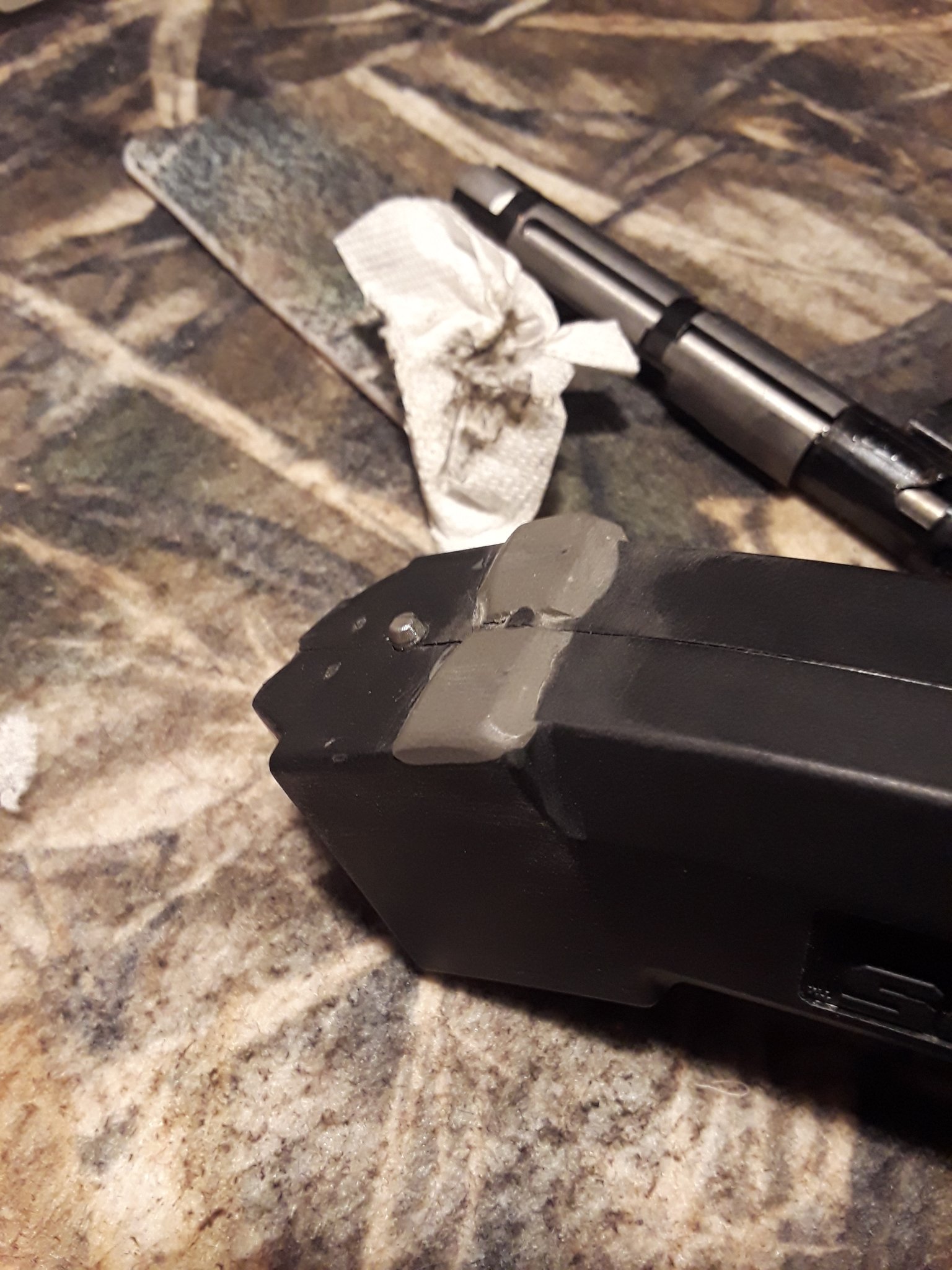

Just joined and thought I would contribute a little. JB weld kwik works on the 15 and 25 round magazines. This has been on for a couple of years.....

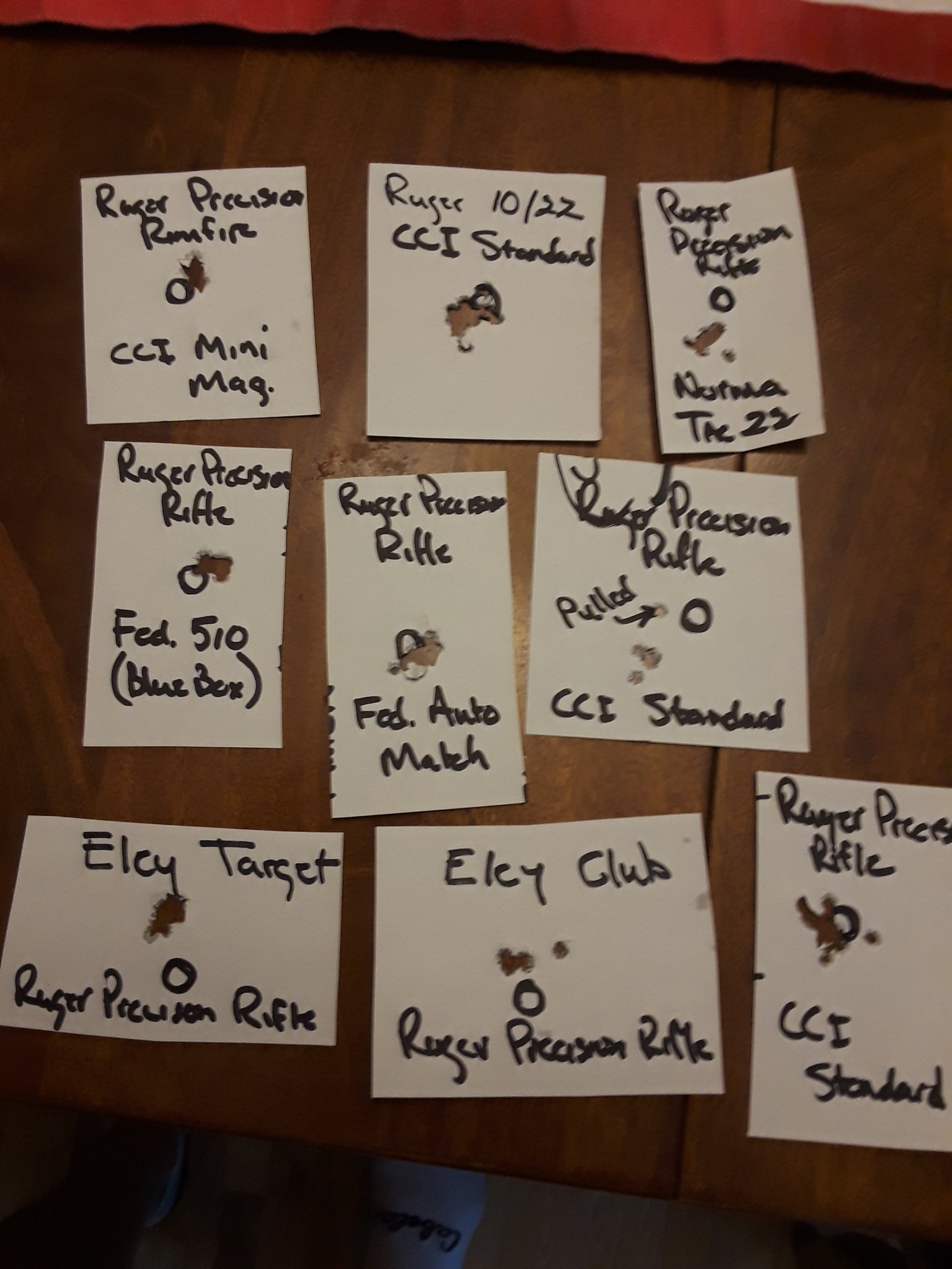

I also just got a RPR in 22lr. Here are a few pics of 5 shot or better groups i got when testing ammo at 50 yds. I shot three, five shot groups and these are the best of the three for each type of ammo. I tested quite a few types and there were only a few that I would completely reject.
I did take a good look at my bolt after reading some of this thread and it seems to be very well machined. A few marks but on the whole nice and smooth. I did have a few problems with failure to eject and loading but they seemed to be with the unmodified 15 round mag. Even after mods, smoothing , and cleaning, the large capacity mags have never been as reliable for me as the 10 rounders whether it was in my American Rimfire, 10/22, or now the RPR.

It appears that you got a real good one! Congrats!

Those are fantastic groups. I wish mine would do that.

Those are some remarkable groups!

Again, congratulations on your group's.

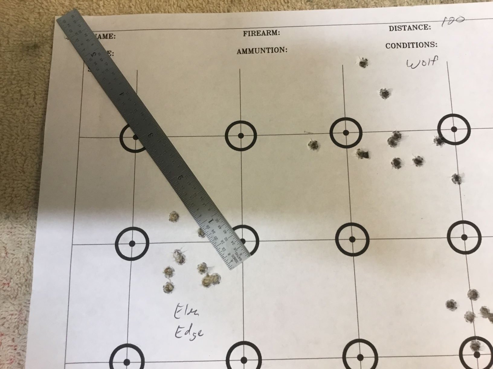

So after hearing about some folks getting good groups with CCI standard I gave it a try. No go in my rifle as the Wolf match target was still better. I did have a buddy suggest Eley Edge as it is what worked good in his. Here's the results at 100yds. 10 rd groups with both the Eley and the Wolf. The Eley is a bit pricier than the Wolf but not as bad as some of their higher end ammo. I'm thinking that shooting under 1 & 1/2 inches with a stock trigger is pretty decent given my abilities. I still want to do the bolt & mag tuning that has been posted which might help even more.
Also, I had read somewhere on here that removing the thread protector might change group sizes. I shot two 10rd groups of Wolf & Eley with the TP on and then off. No difference as far as I could see.

I used to get a difference in groups size, with the smaller size being with the thread protector off. Then I purchased a brass crown lap from Brownell's and lapped the crown on both the barrel and thread protector. Now I get the same size groups with or without the TP in place. It doesn't re-crown the barrel, but it along with the valve grinding compound does take off the machinery marks, so the crown is smooth. I've since used it on a number of other rifles with no ill effects.
I had to have my gunsmith recut the crown on my barrel. It looked like it was cut with a chamfer tool that was vibrating.

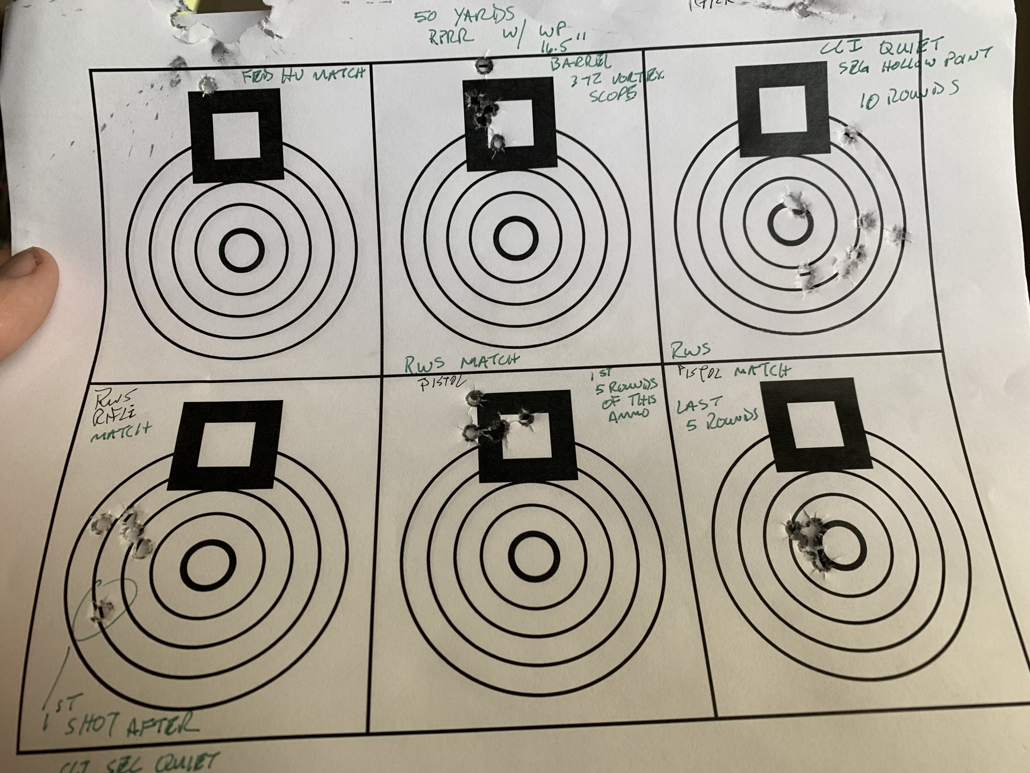

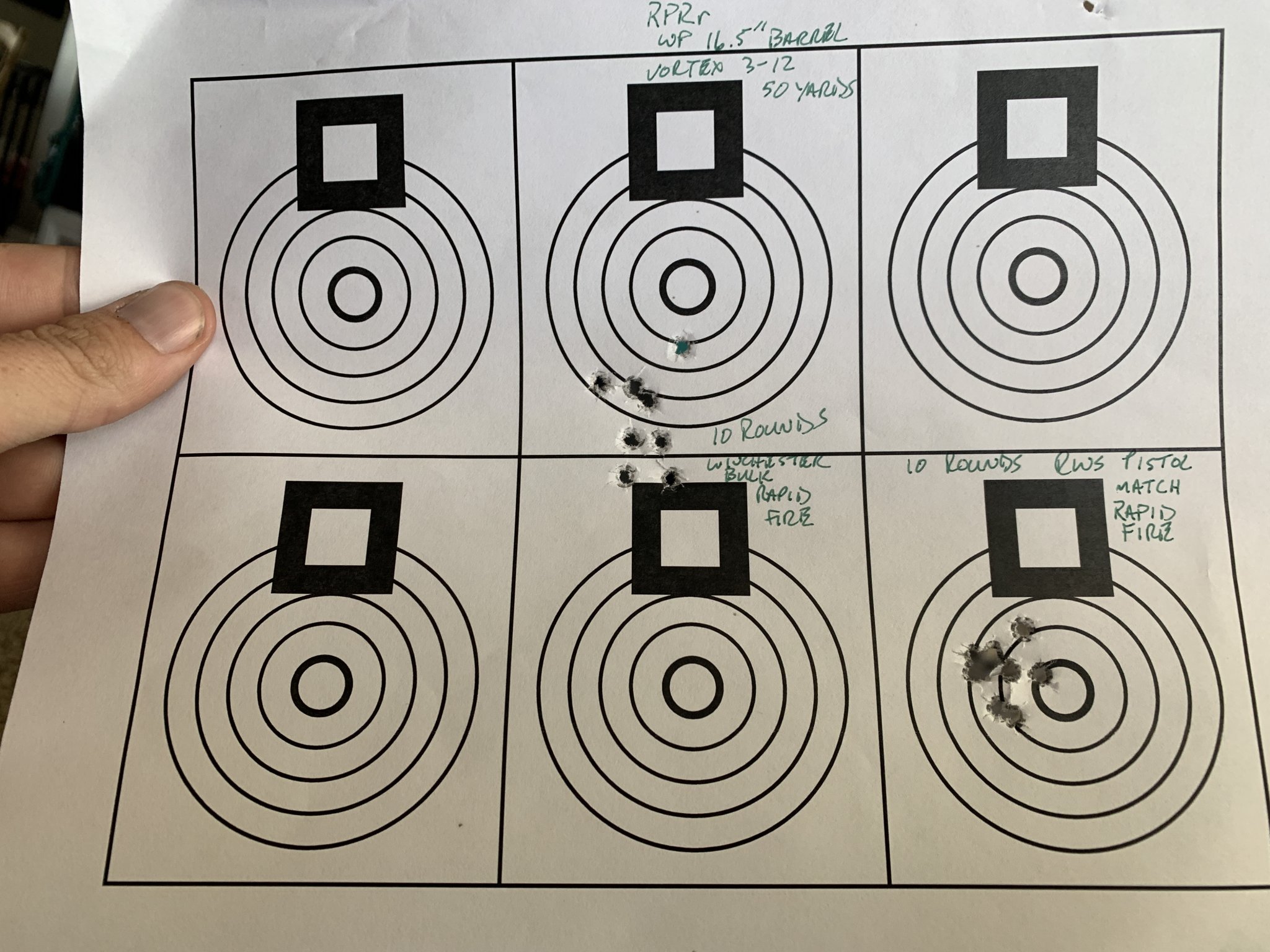

Went to the indoor range today for an hour or so.
Barrel on my RPRr seems to be getting better (whistlepig 16.5” barrel with match chamber)
I will say the barrel doesn’t like jumping between ammo types. If you stick with a good ammo or season the next with a few shots then it does better.
This barrel hates cci quiet segmented hollow points. It shot like crap at 50 yards
Pictures below were at 50 yards off a bipod and bags with a 3-12 power scope.
Second photo was “rapid” fire as fast as I could get back on the target and get steady. Probably 1-2 seconds between shots. I am not the greatest shot and someone else probably could ring more out of it than me but I am happy.
Right now RWS pistol match will be my boys go to ammo for mid grade ammo.
