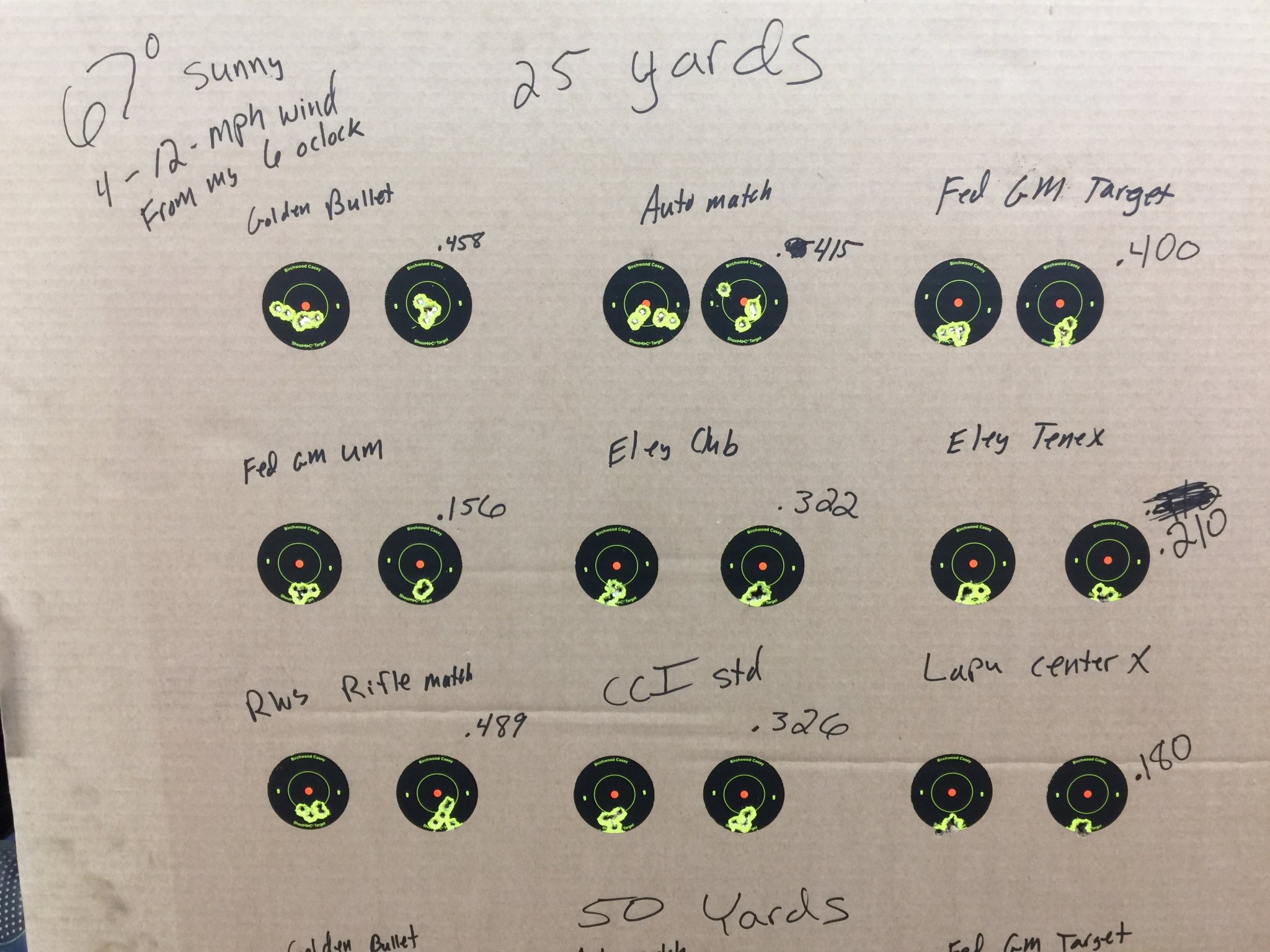

So I finall got my RPR out to the range today to do some ammo testing. It was sunny, 68 degrees, 4-12 mph wind from my 6 o’clock so it was blowing the target around a little.
Shot these from the bench with a bipod and rear bag at 25 yards. No surprises but Federal Gold Medal Ultra March was the winner with Lapua Center X a close second and Eley Tenex third. I may get out and get my 50 yard testing done tomorrow depending on work schedules.
The gun is stock no mods, Athlon Midas BTR scope. I ran 120 rounds of Golden Bullet through it to get the barrel broken in. I cleaned the barrel before I started shooting and did not clean it before I shot the tests. All test were shot consecutively no cool down time between each different brand of ammo. The target on the left is 5 fouling shots for each brand the right target is a 5 shot group for record. My zero is based upon the Remington Golden Bullet.

I totally understand that and that's why 50 yards is next and then next I will do 100 yards, but even here at 25 you can see the cream rising to the top with the group size differences. So even though this wasn't a definitive test you can still get some data out of it, and that data will only be more firmed up as I do the 50 and 100 yard tests.

I've been doing the same testing with my RPR and have found almost the same results you have. FGMUM and Center X were definitely the winners. Even out to 150 yards they continued to outperform everything else I tried(CCI green tag and Wolf Extra Match were the two different brands I used)

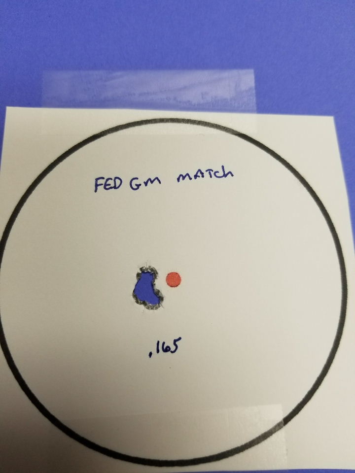

Went and tried some more ammo , Gemtech Suppressor and some different Aguilla.
All .50 and up groups, the best in my gun is still Federal Gold Medal MATCH.
At one point the wind went absolutely dead and produced this 5 shot group at 50

very nice. I need to pickup some FGGM and some Midas to test. With groups like this I wonder why anyone would want a Lija barrel for more than the rifle costs?
There is at least 6 guys I shoot with that have RPR's and we've all tested at least 6-8 different types of match ammo. Every rifle is in the 1.25 to 1.5moa area for accuracy at best. On average I'd say 1.5moa is about it. If any shot sub-moa then there would not be an interest in after market barrels. Accuracy and especially consistency is what makes the precision rifle world go round.
