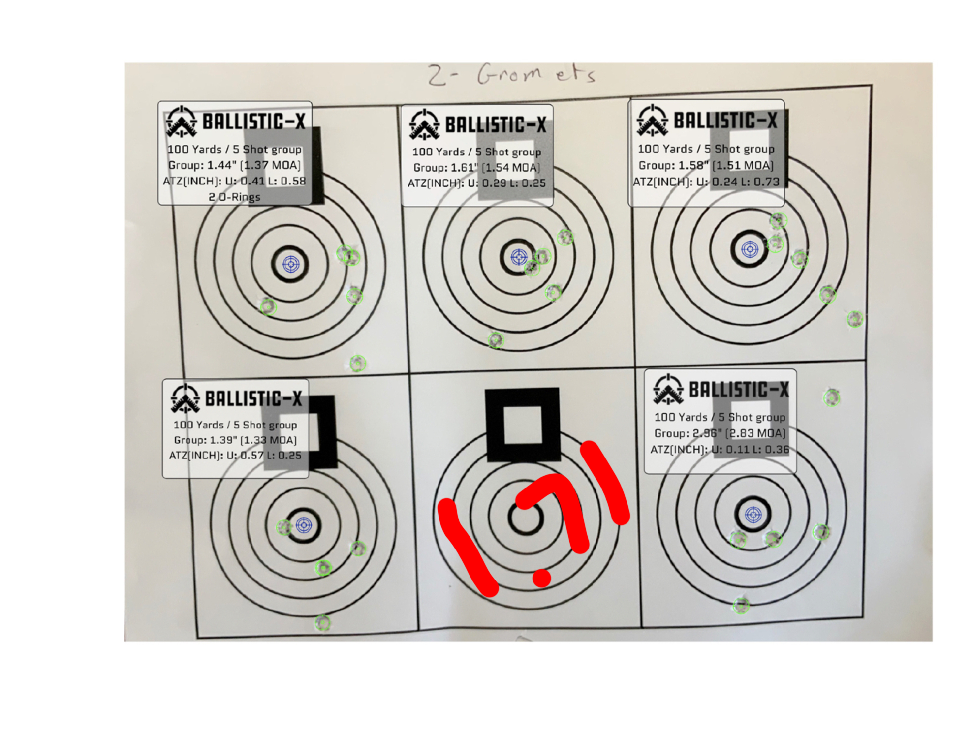

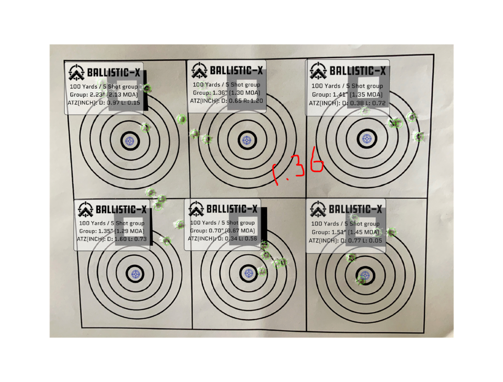

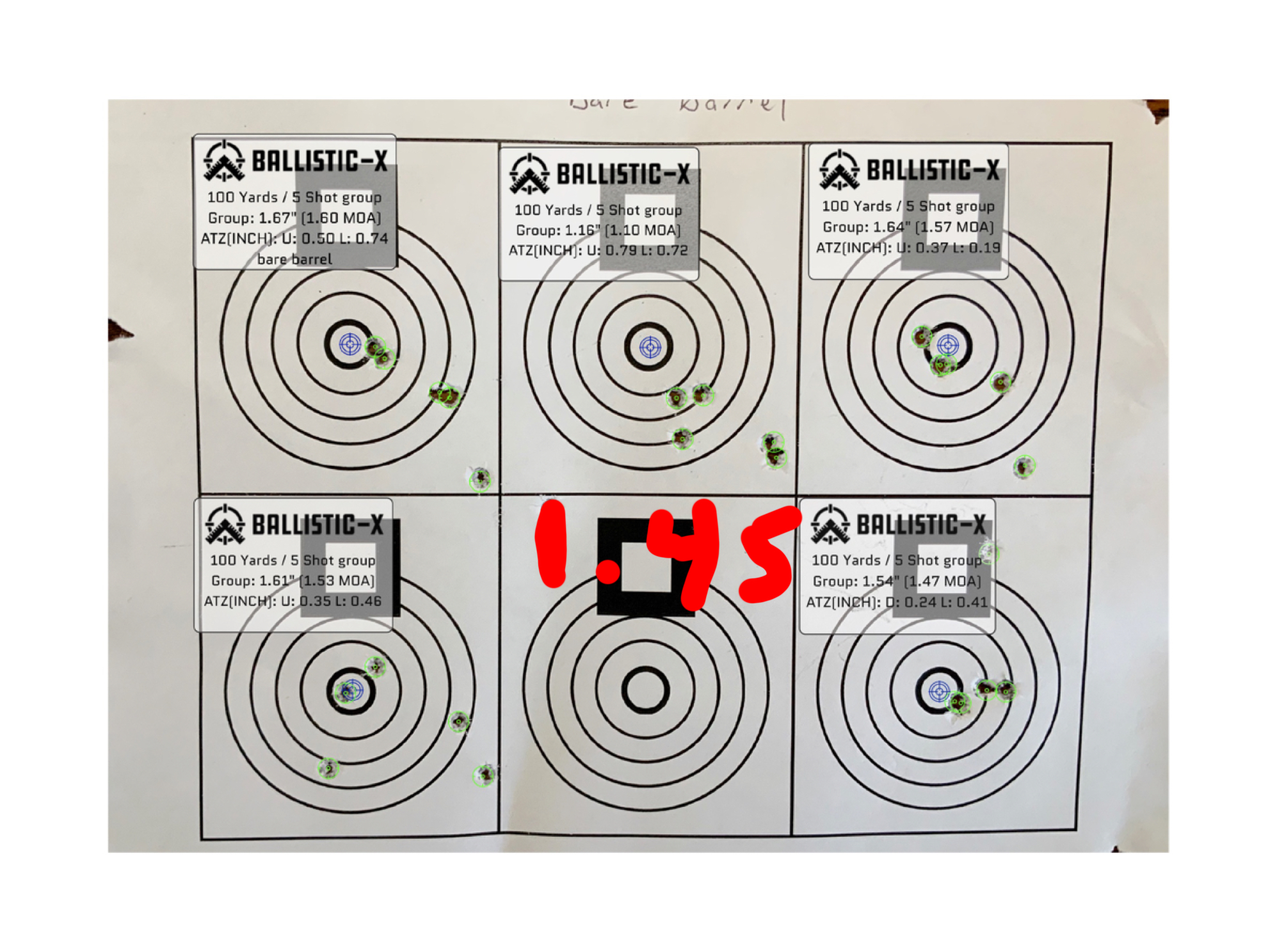

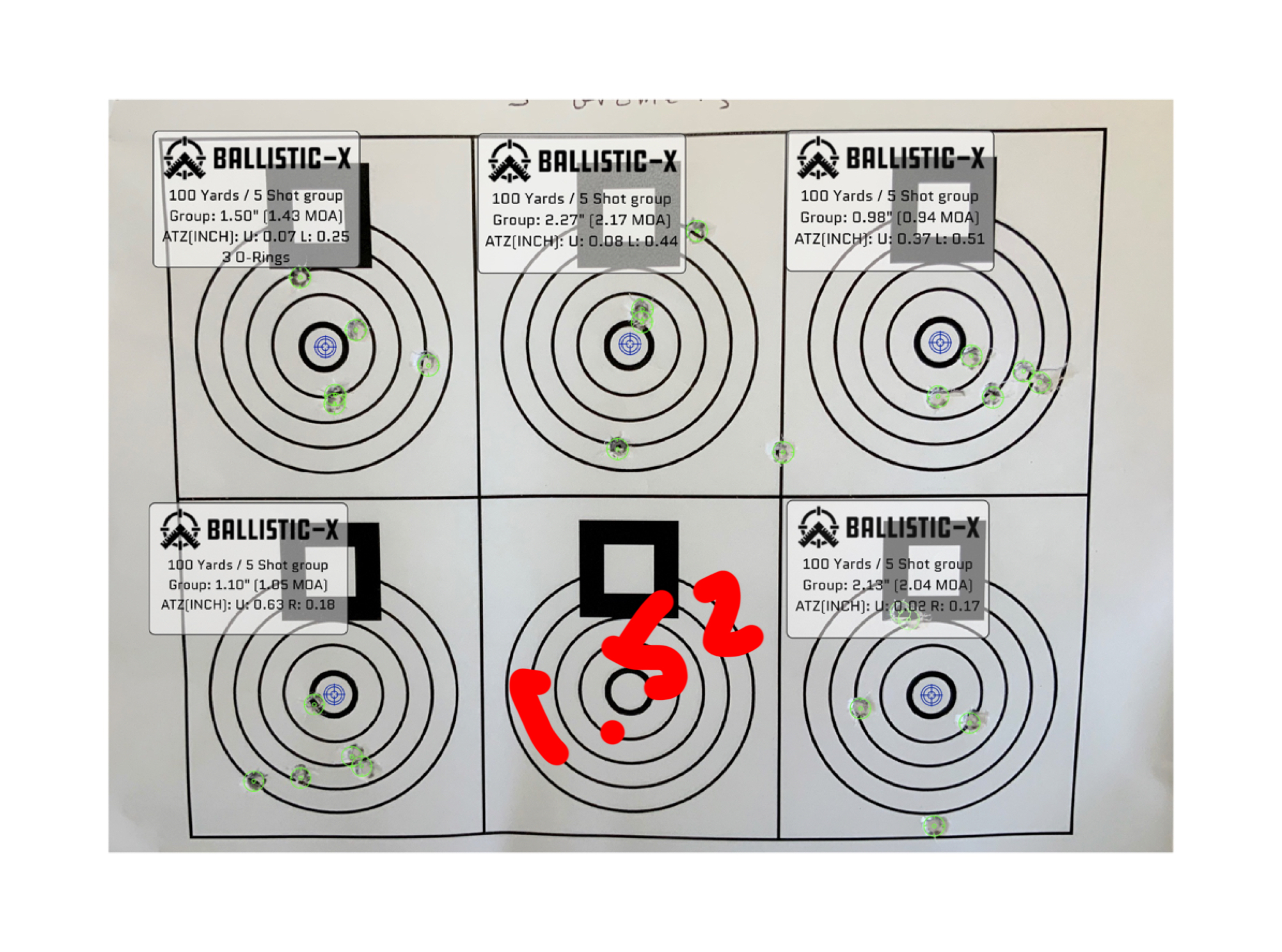

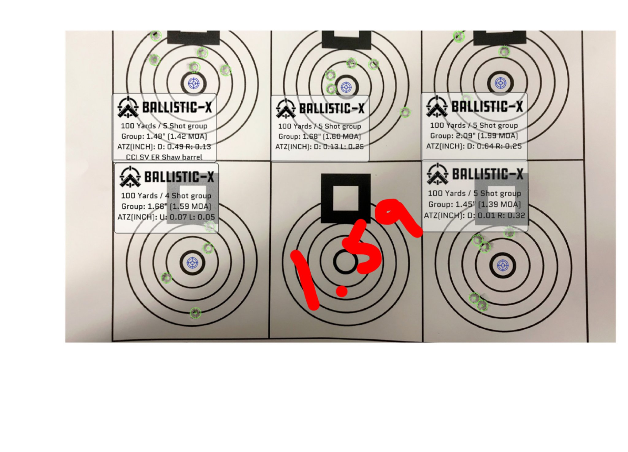

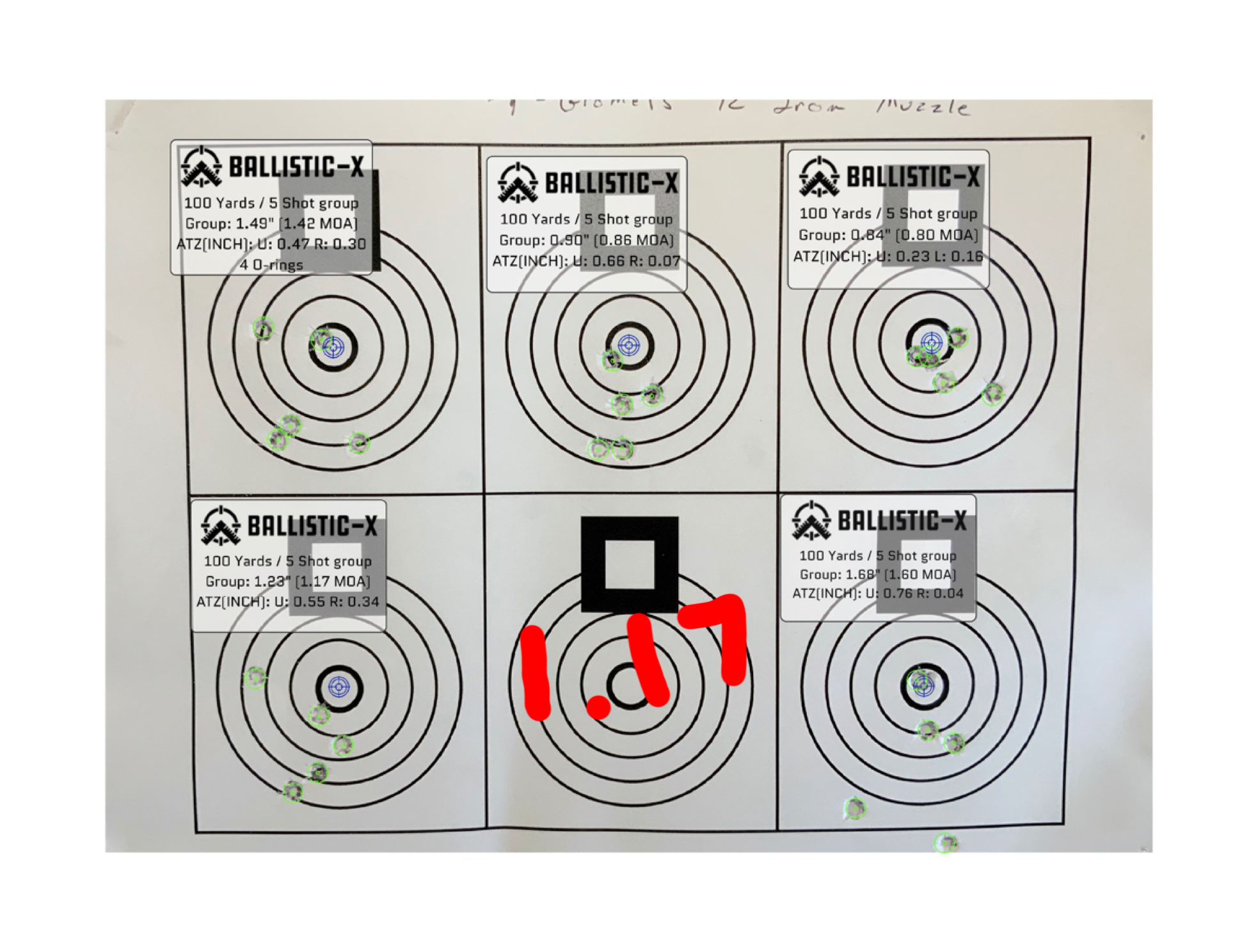

Interesting test results on barrel tuning! I used 3/4” ID grommets weighing .22 oz all the ammo is from the same lot CCI Standard Velocity, I used this because I have 1,000 RDS from the same lot. Temp 38 degrees with a NNE 4 mph wind. Once I had the scope set it was never adjusted so you can see the pattern change. All on a 5x5
0778742F-DC7E-4DB9-91F7-4F31EDD4D166.jpegA9F71305-7DDD-42CA-852F-312D51B1A2E1.jpeg529E9EC5-D9ED-42A8-9720-06CDAD989DBB.jpegCBAE7B48-356F-406E-88A8-40729DA7F84A.jpeg
the stock barrel being bare had a 1.45 MOA
Grommets installed at the end of the thread protect going down the barrel
2 Grommets 1.71 MOA
3 Grommets 1.52 MOA
4 Grommets 1.17 MOA
the ER Shaw barrel came in today, if I have time I’ll run a couple hundred rounds threw it and shoot the same 5 x 5

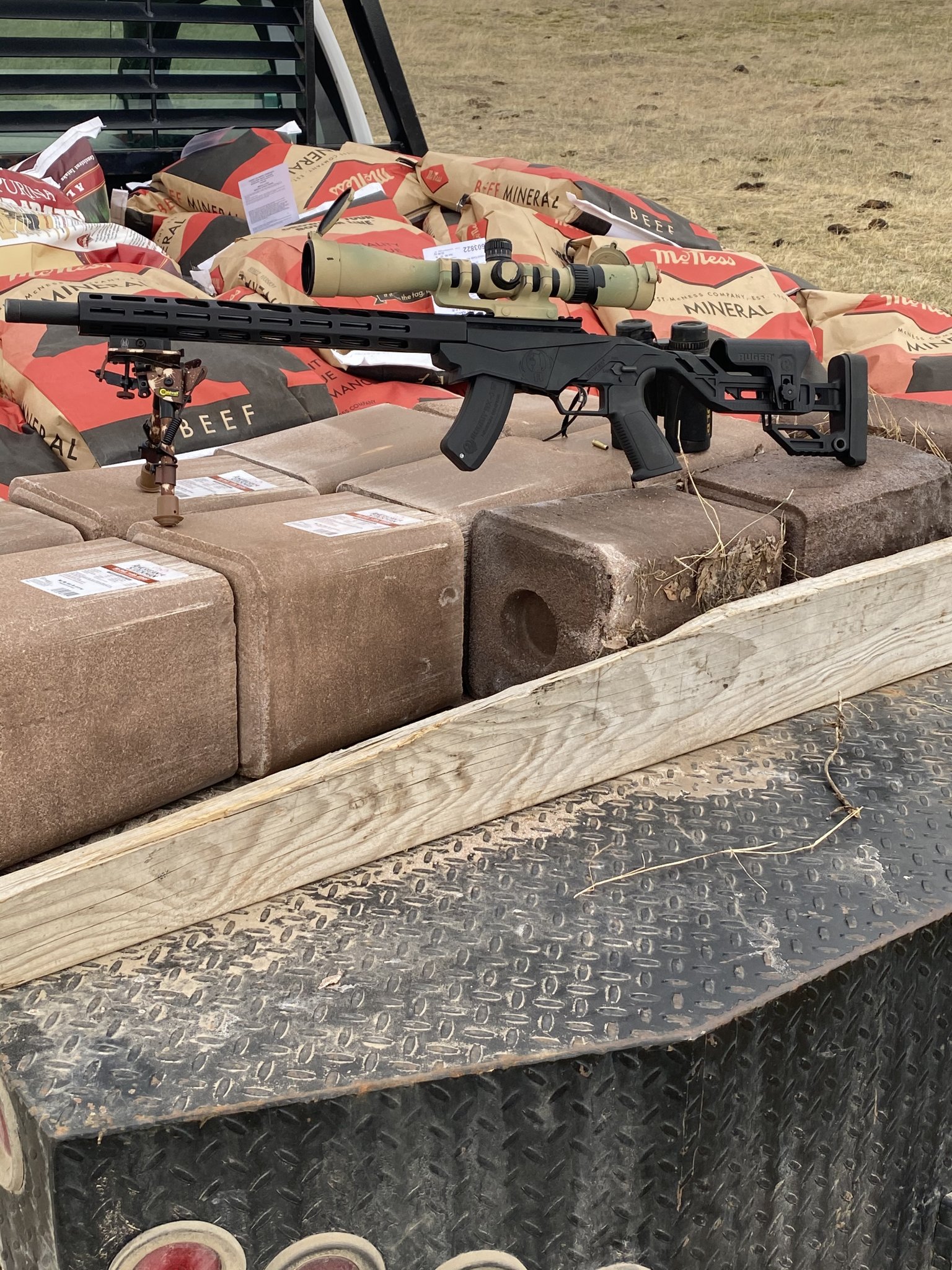

I’m loving my 17 hmr! Got a few extra minutes to break it in today!

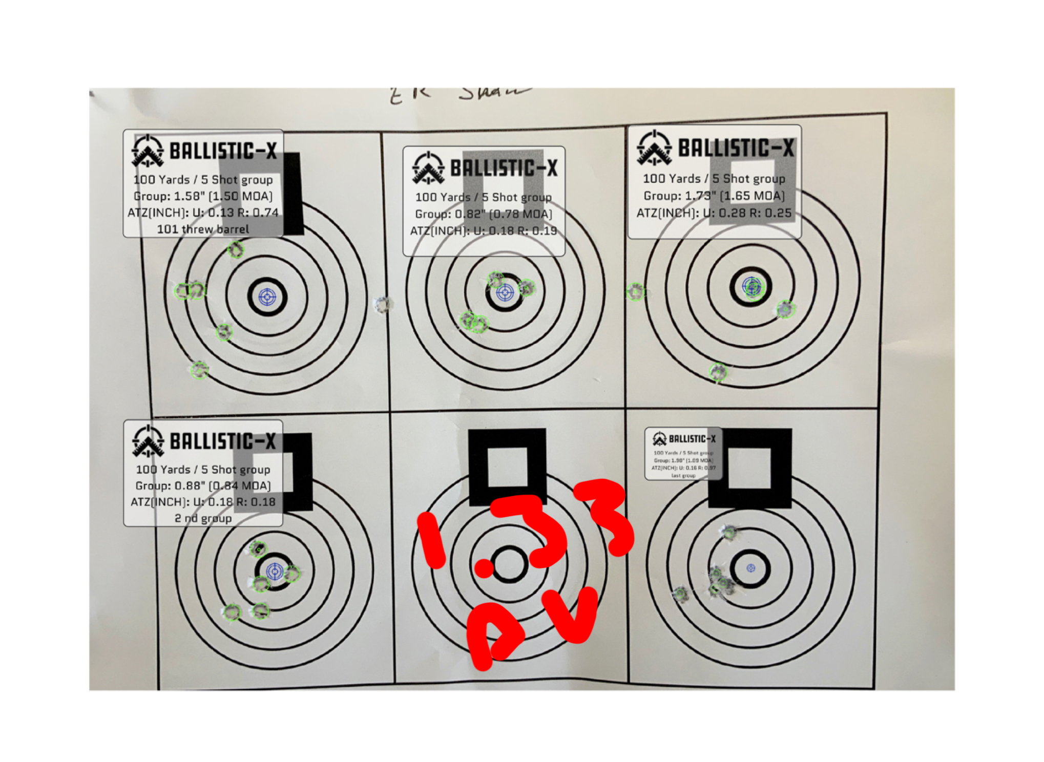

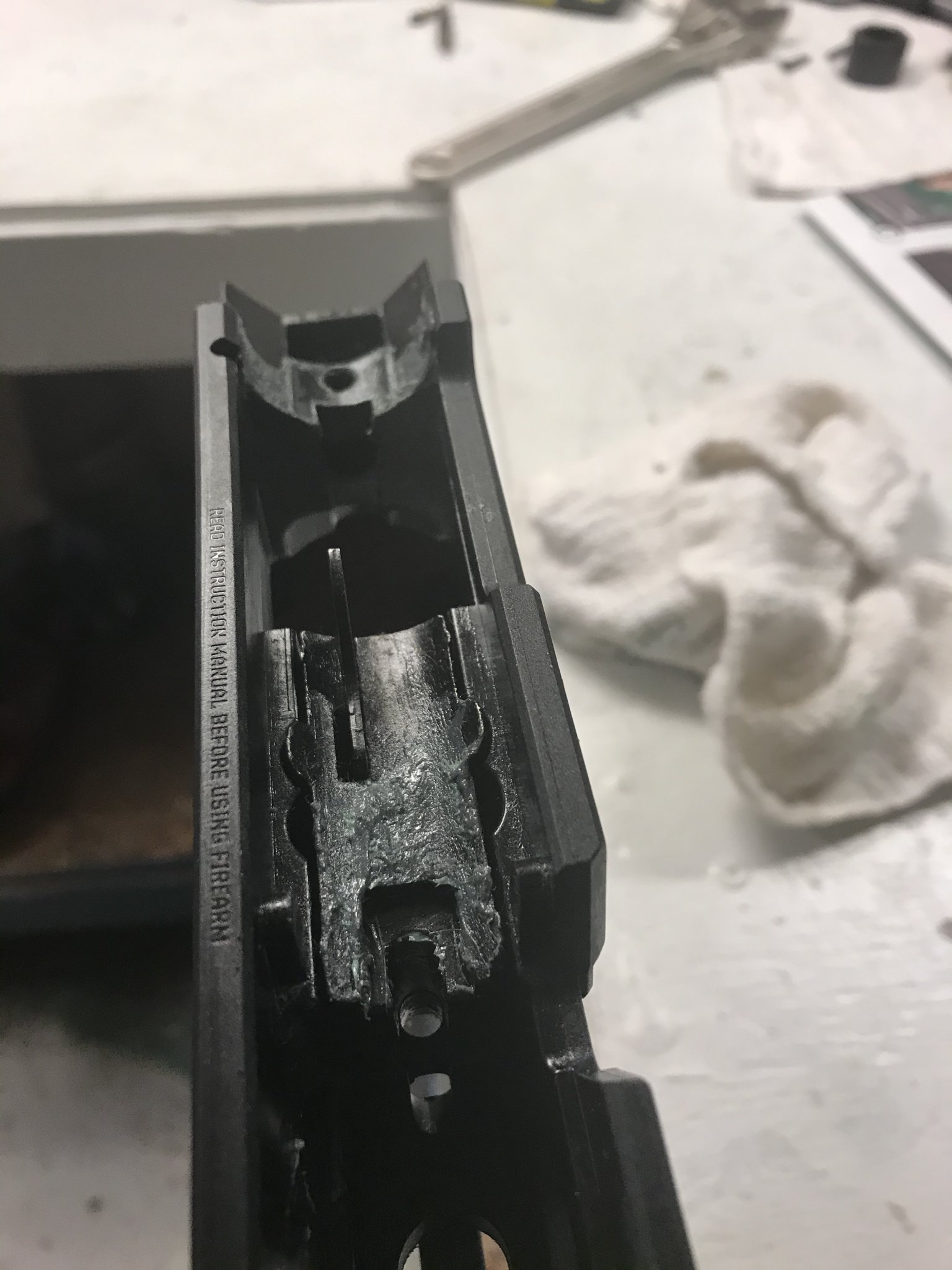

ER Shaw barrel installed about 100 RDS through it, when closing the bolt it takes a lot of force I had noticed every time it was extreme I had a flier. I ordered a finishing chamber reamer and will establish a .04 bullet jump which will ensure bolt closing easy, when I got back to the shop I checked the action torque and it had loosened up my guess from cranking on the bolt. But I shot two groups one with a average of 1.33 MOA and the second with a 1.59 MOA
After first installing my Shaw barrel, it too required a lot of force to close and it loosened up after a going through a couple hundred rounds. I decided to reinstall the barrel, but with a couple of shims (made from my kitchen heavy duty aluminum foil) between the barrel an action. It turned out just right. The bolt still has some resistance but has a nice feel to it (still not as loose as with the factory barrel) and rounds chamber and eject very nicely.

Hmmmm??? Good luck with that using CCI SV's. CCI V's are really great for ammo at their price point, but they're not match grade. :eek: It doesn't seem reasonable to me to expect or even try to get under MOA with them??? o_O Seems to me that's even a big challenge even for the best rifles made.

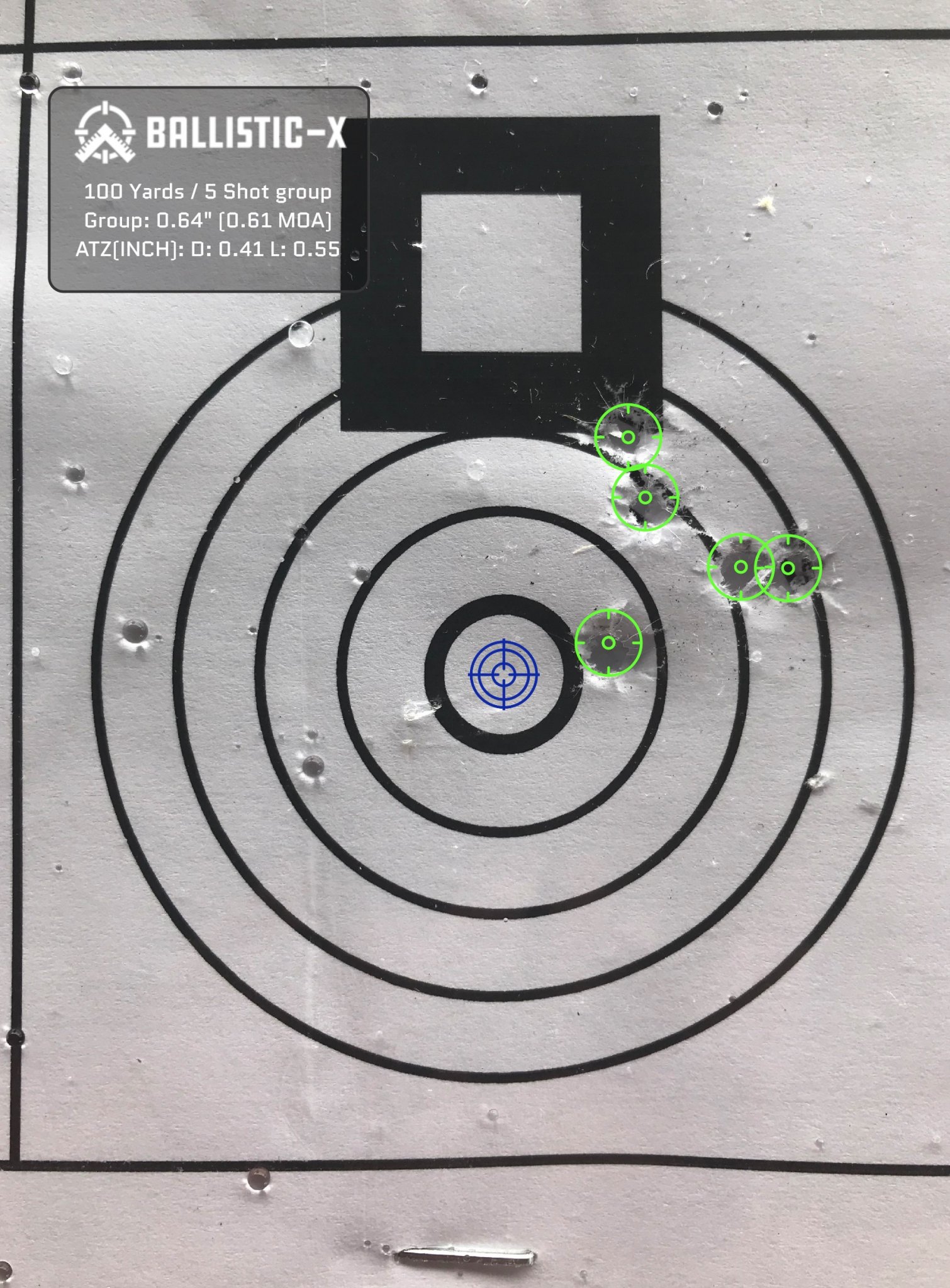

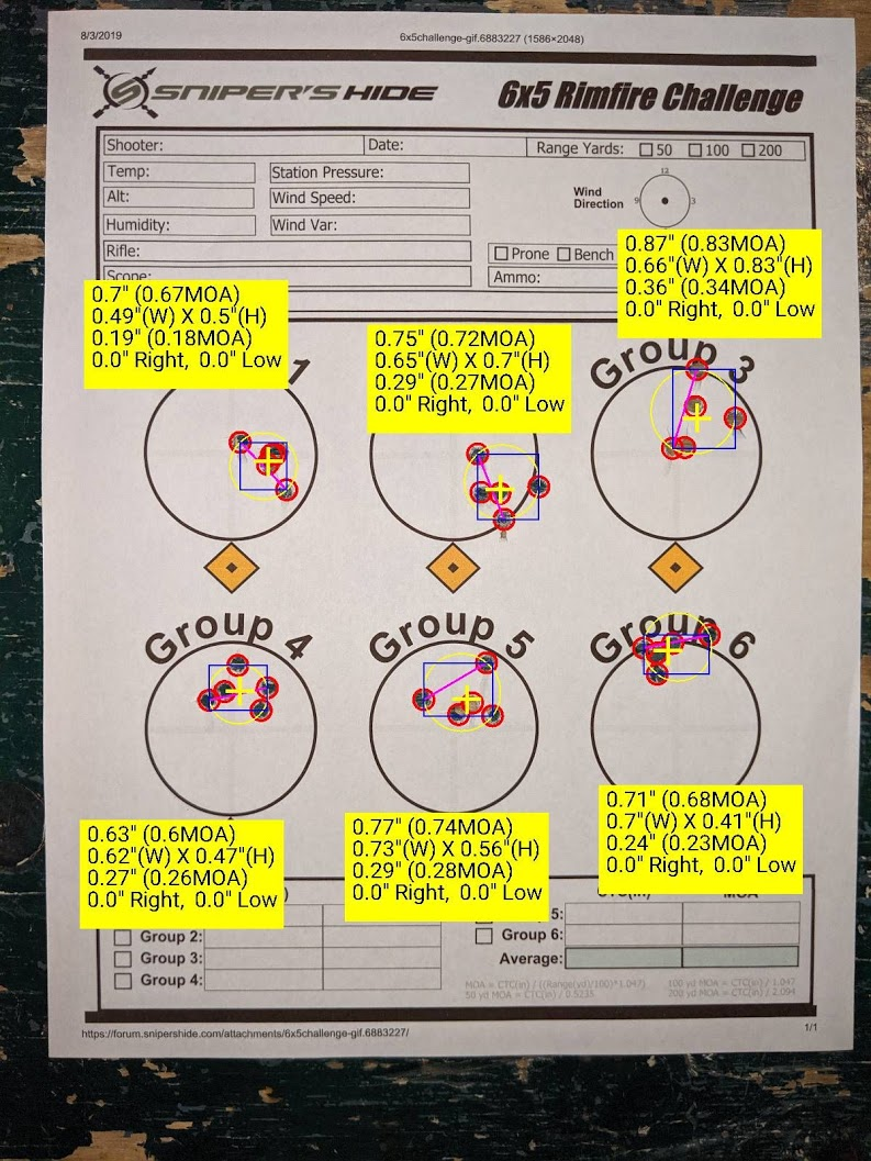

Well the jury is in! You can shoot a semi MOA with many modifications final result .61 MOA with CCI SV at 100 yards! It is not a constant out of a 6x5 my ave is 1.36 with fliers next I will get testing higher grade ammo such as Green Tag, precision, center-x

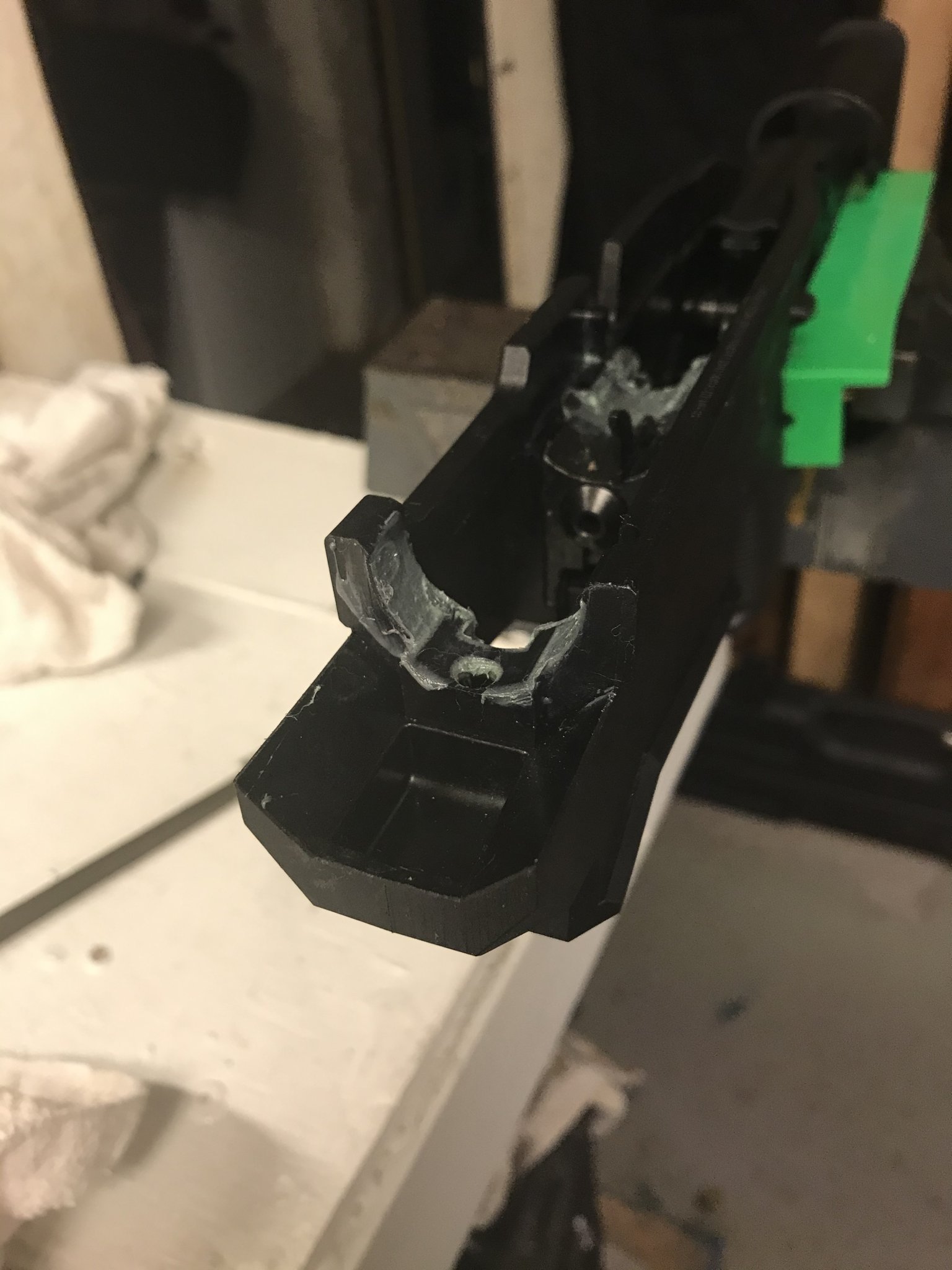

most important improvements: trigger job, I used JB weld and bedded the action “ make sure you use a very good release agent”
ER Shaw barrel and recut the chamber so rifling lands go to the first knurl this allowed the bolt to close relatively smooth

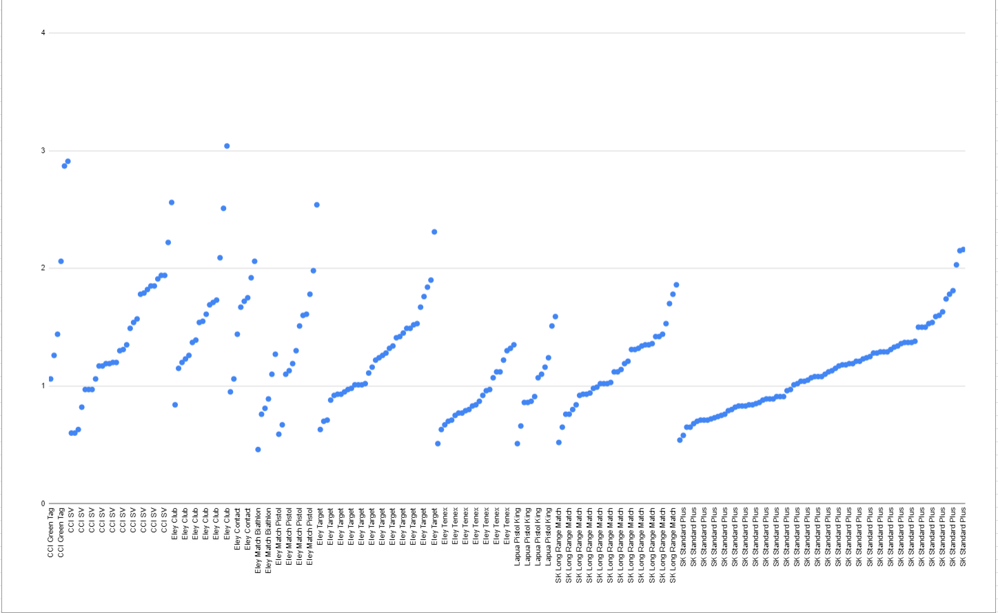

I think the 6x5 is really important. Anyone can get a sub moa group regardless of how bad your rifle is over time. I shot green tag and got a 1/2" group and thought it was fantastic, and then my averages for 6x5's always were 1.3-1.5" which which means there were some 2" groups, and also means flyers = dropped shots in matches.
Take it for what it’s worth I started this project using CCI SV ammo because I had 1,000 rounds of the same lot my average was 2 .75 at 100 yards with a stock rifle, using the same ammo and several trials and errors I found the modifications that did the most I brought the average down to 1.36 with better ammo I am sure it will get tighter yet.

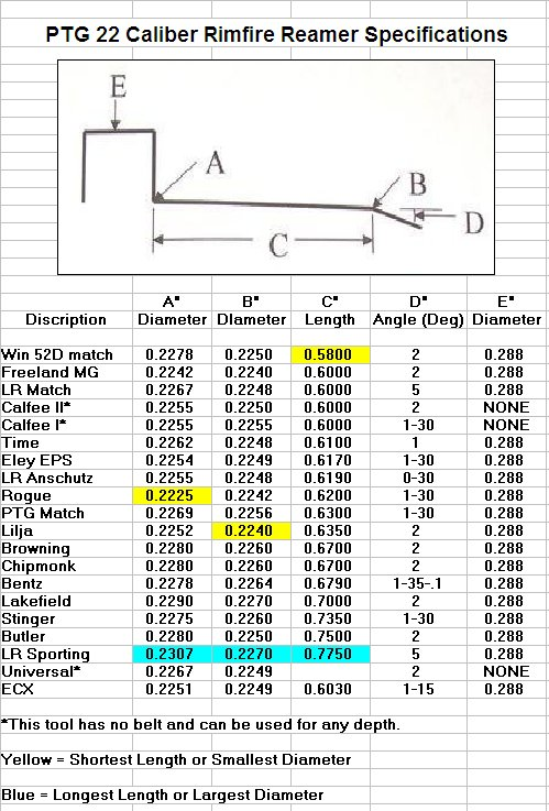

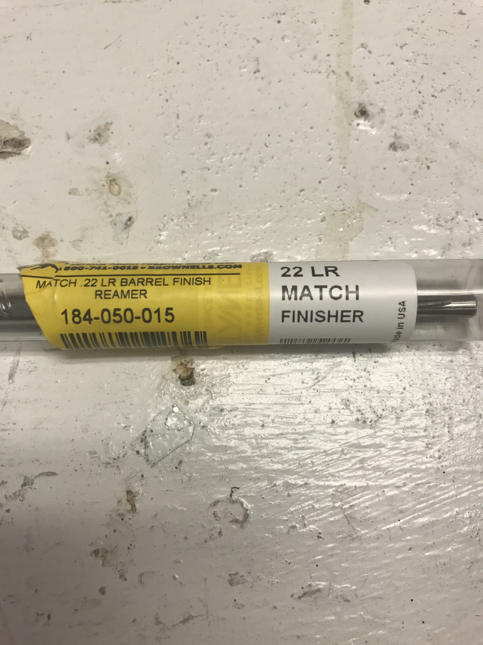

im glad to see your making progress! i agree a larger sample size w cci std and other ammo would be helpful. may i ask what reamer you used on the shaw barrel? do i understand correctly you cut the chamber a bit deeper? how do you think your chamber compares to a bentz chamber? im curious as mcgowen makes a bentz chambered barrel for the rpr, and ive had real nice results with their cf barrels.
also, could you share more details and pix sometime of how you bedded w JB? i thought about trying it but got scared lol.

I tried the alum beading and realized that’s f’ed up, so I took everything apart used grease on the chassis and barrel leaving the front action bolt area and rear open to apply JB weld. Once apply and you do not need much torque your action in I did it to 25# let sit for 6 hours take apart and trim up everything while it’s soft see pictures attached.
The barrel I used reamer # 184-050-015 finish reamer and it cut the chamber length to 6.65 which happens to press your 1 st band into the rifling without wrenching on the bolt and the best part is it will eject a un shot round also picture attached.

The chamber depth is .8 and the new reamer will cut it to .665 you will need a new barrel, I just completed my sons rprf with Shaw barrel reamed chamber shooting it friday

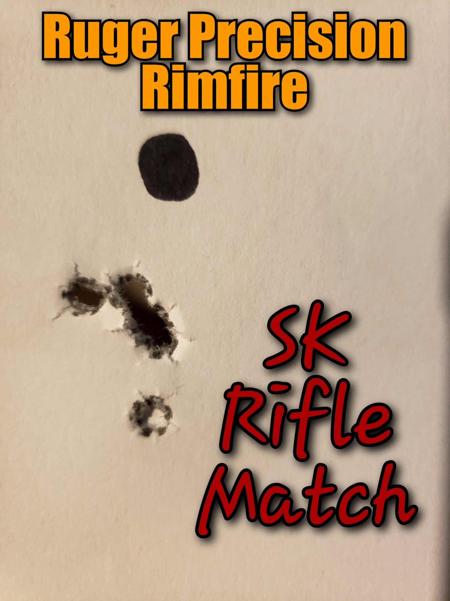

I had all but decided to change my bbl out on my RPRR, and then I noticed how well the SK shot out of another rifle.
Tried the SK in my Ruger and , wow... it was easily 1/2in 5 shot group at 50yds.
22s are notoriously picky, and it's worth trying the go to brands before giving up on it.

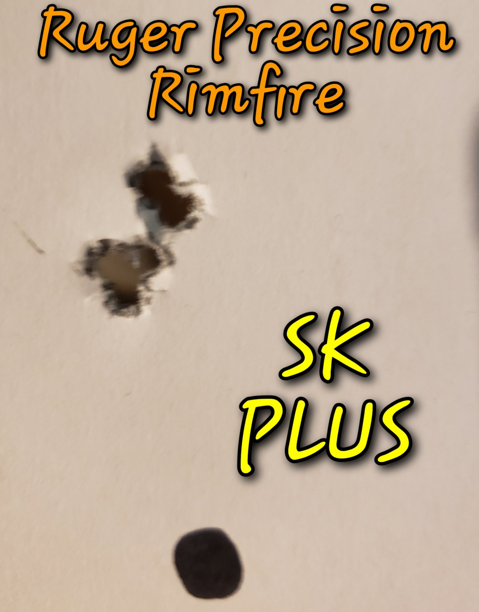

Here are the 5 Shot groups at 50yds.
Both are easily under .5 inch and performed flawlessly with the RPRR.
