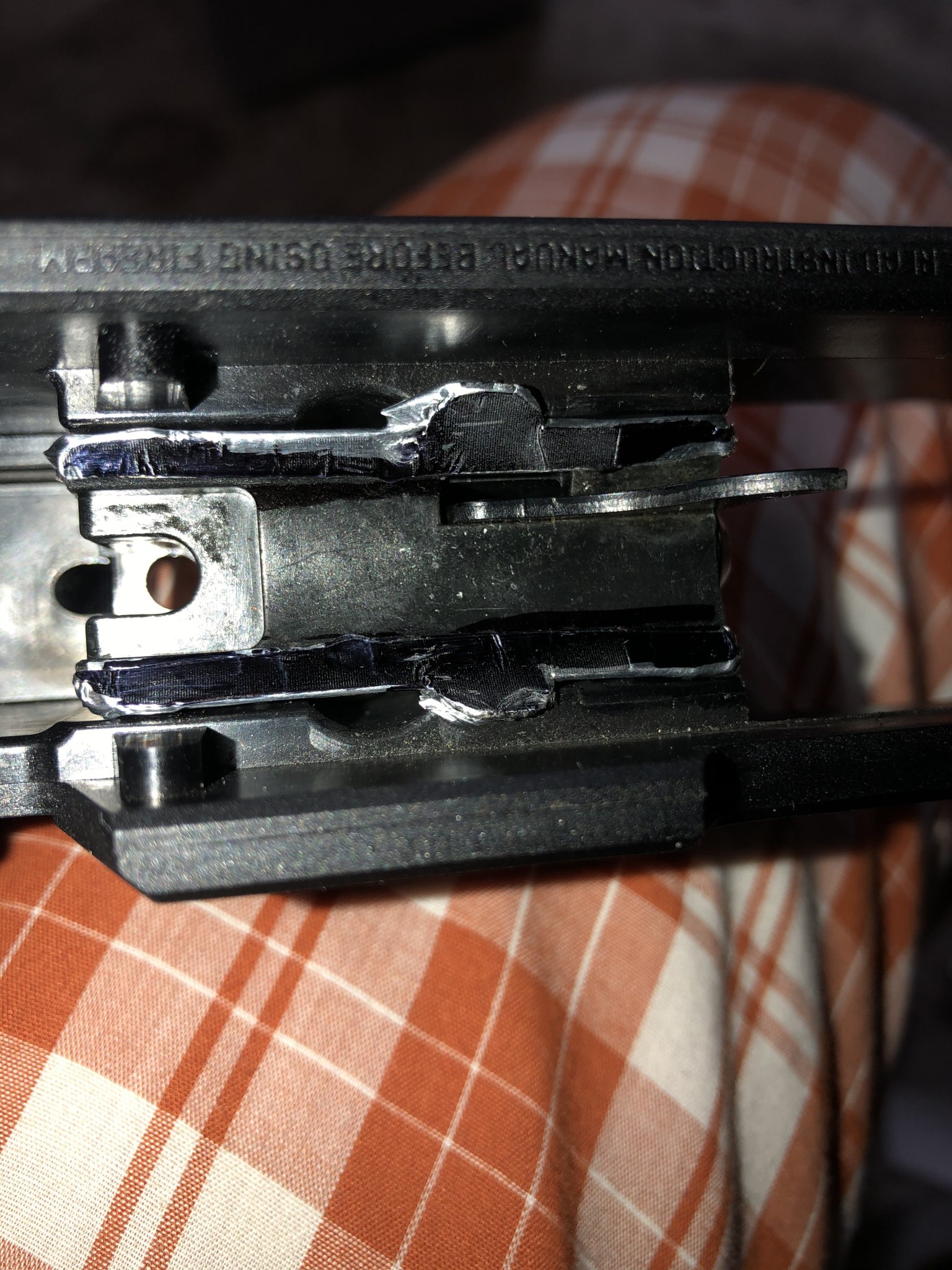

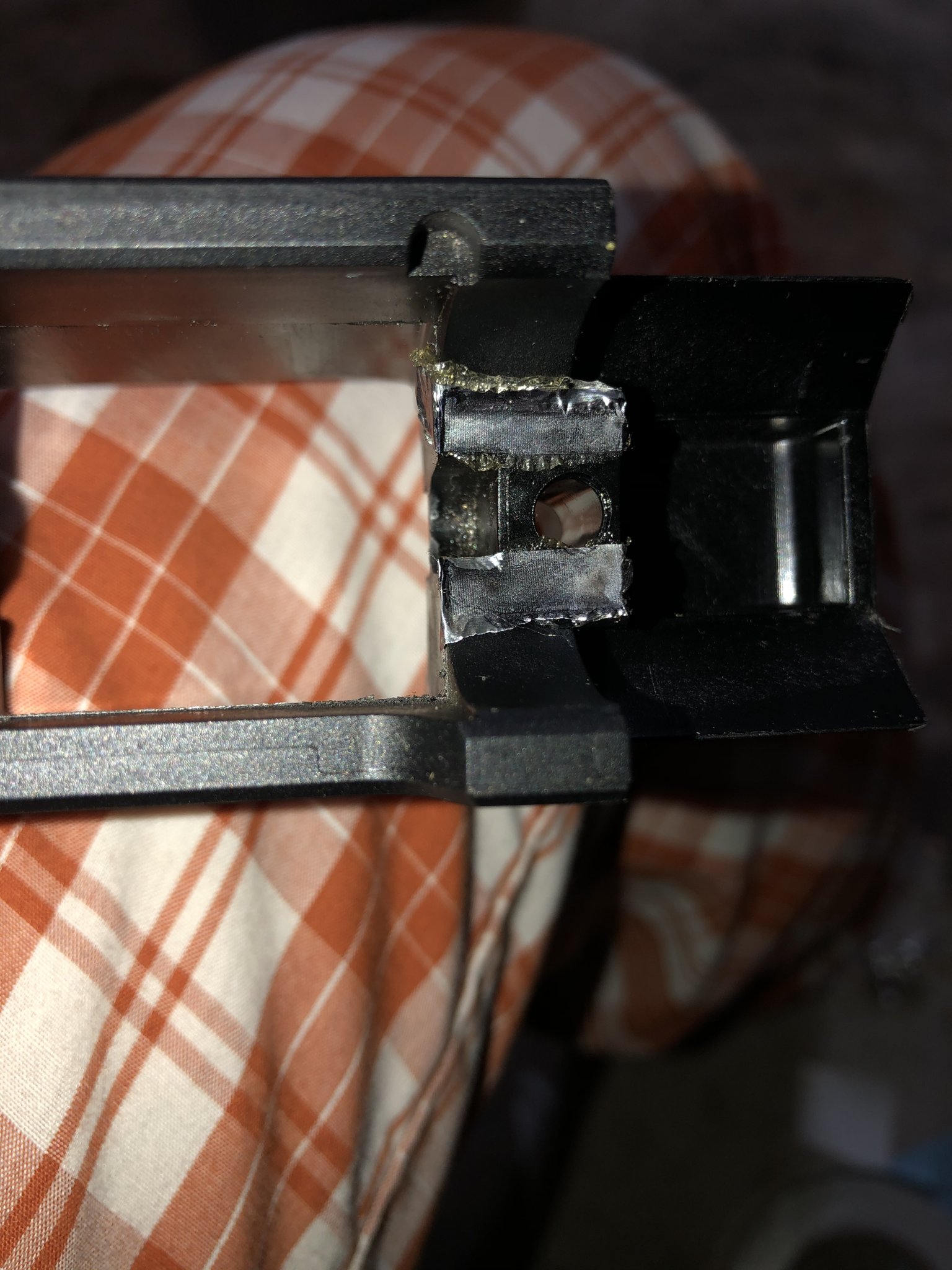

Did a simple contact check this evening on the barrel to receiver block. I have two strips of aluminum tape on top one of each side and one strip on the front contact screw. Here's what I got on the contact. Not as good as I was hoping for. Only making good contact on one side and only for a small area.
Anyone else run into this. Is it even fixable??!!
I assume you used aluminum tape; two layers on the rear of the action but only one layer on the front. Why did you not use two layers on the front? You may have introduce a bit of stress by not keeping them even. Also, how tight was the action in the chassis? 35 inch pounds maximum or something less? And what is the black color on the tape; in-letter's black or a sharpie to show where the barrel was contacting the action?
In your left picture, you have tape on the lips of part #54; the Magazine Latch Assembly. Part #54 has caused a lot of problems for some. This part serves two functions at least; it secures the rear of the magazine into the magazine well, and it also secures the ejector, (it may serve a third function, that of supplying some bedding to the action into the chassis). I have read accounts where part #54 came from the factory so loose that it rattled in the action and provided poor support to the magazine when it was settled into the magazine well.
The fix: (or at least what I would do).
1. Assuming that one side of part # 54 is higher on one side, you need to add enough bedding so the barrel rest evenly in the action. I would add some tape to the sides of part # 54 so it fits tighter in the action, as well as tape to the top of this part, ( as it appears you have done), so when the barrel is tightened into the action, it applies a little force to the top of part #54 to keep it firm in the action, thereby providing a bed for the barrel/part #54 interface, and taking the "slop" out of the Magazine Latch Assembly so the magazine is more firmly held in the magazine well.
2. If you add two layers of tape to Part #54, add the same to the chassis where the barrel rests where the front action screw is located.
3. Where the rear action screw enters the chassis, you'll notice two "pillars" on each side of the chassis. These "pillars" corresponds with two cutouts on each side of the barrel. I'm assuming that these pillars and cutouts serve as an alignment guide when putting the barrel into the action. If they are not aligned, the barrel will not go into the action. I'm thinking that they may also serve as a recoil lug. I would also but some tape to fit over the top and sides of the pillars to tighten up the fitment between these pillars and the cutouts in the barrel. If you have a micrometer, you can get an idea of how much tape to add in this area by measuring the pillar width and the cutouts in the barrel.
4. When you place the barrel back into the action, thread the action screws into the action only far enough to hold them, then place the rifle on it's butt, perhaps lightly bumping the rifle on its butt, (mimicking recoil), to seat the barrel rearward into the action, then tighten the actions screws per the owners manual.
The above is what I've done when I bedded my rifle, and it helped to tighten the groups. I also shot just about every type of .22 ammo I could find to see what the rifle liked. Better quality ammo gave me better results, up to a point.

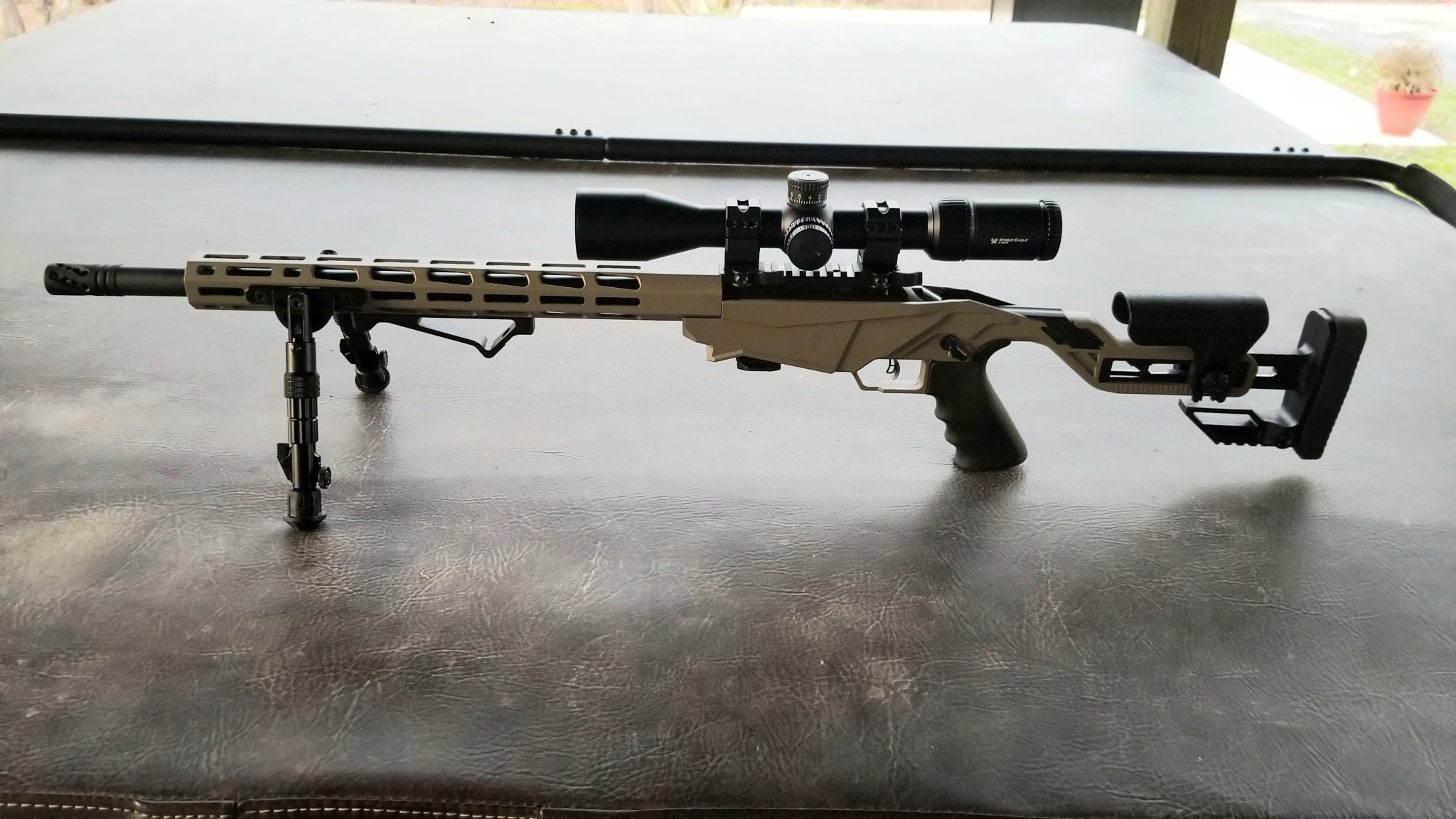

Finished the build for my 9 year old daughter....we should have some good fun with it!
have an older Leupold 4-14x on it, with some high Steiner rings.
A few observations out of the box...
-action was pretty rough, cycling has helped a bit
-hand guard is a tad off center, pointing upwards
Brief test fire last weekend went well, tried CCI standard velocity and CCI AR...from the small sample of groups it seemed to like the CCI standard slightly better.

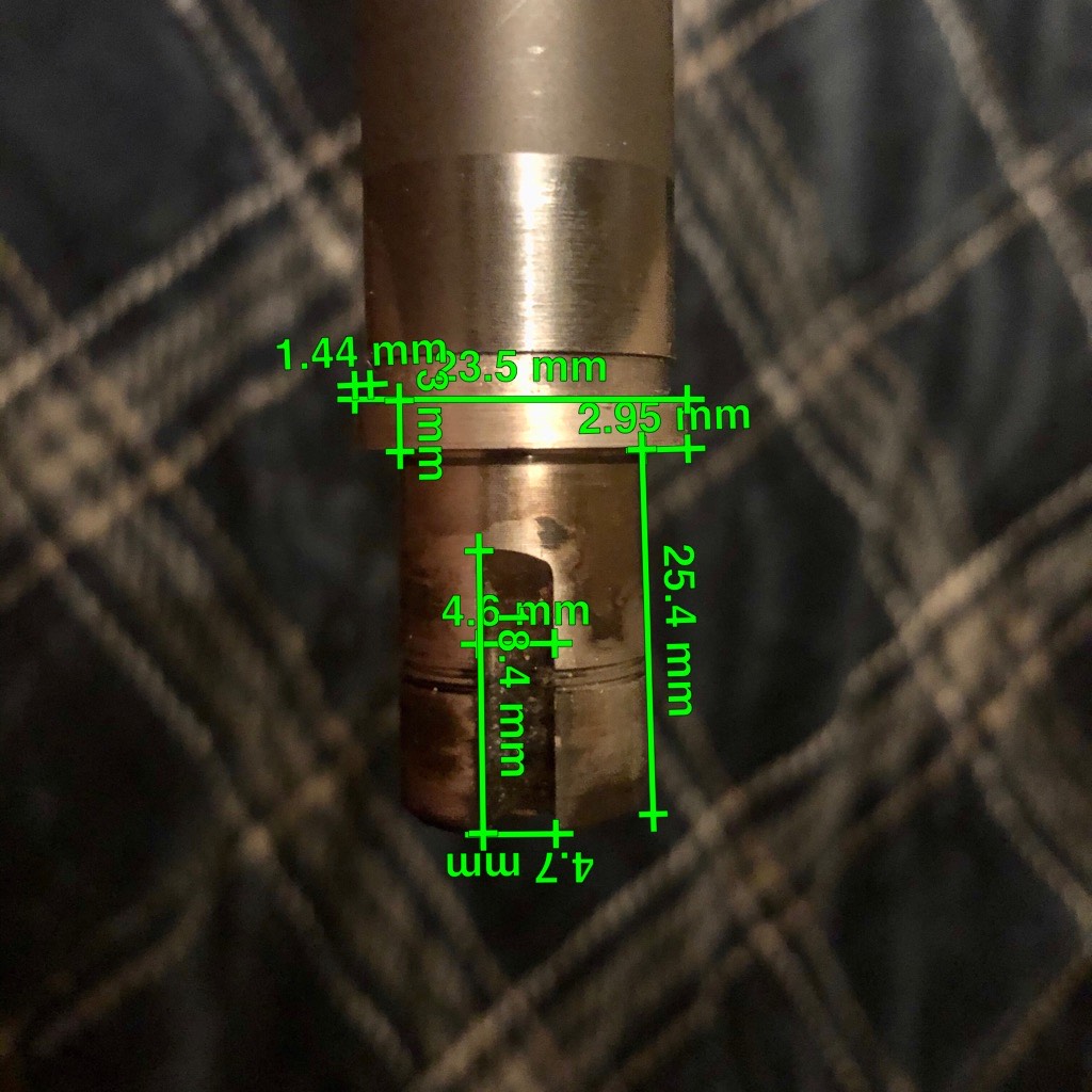

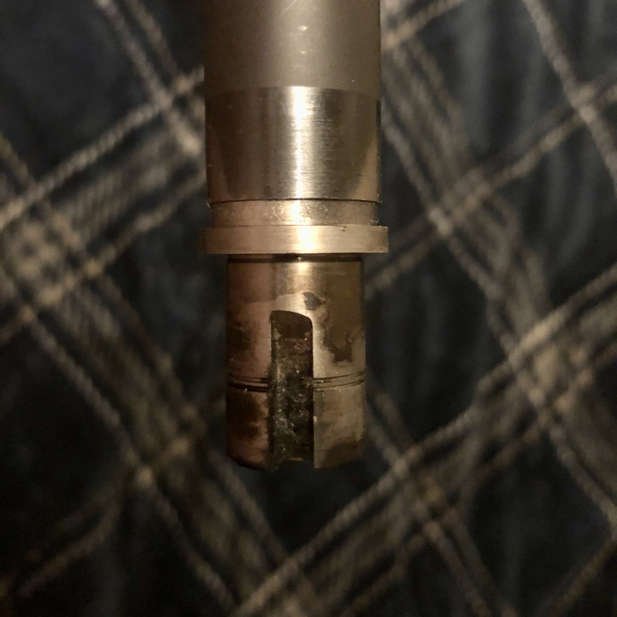

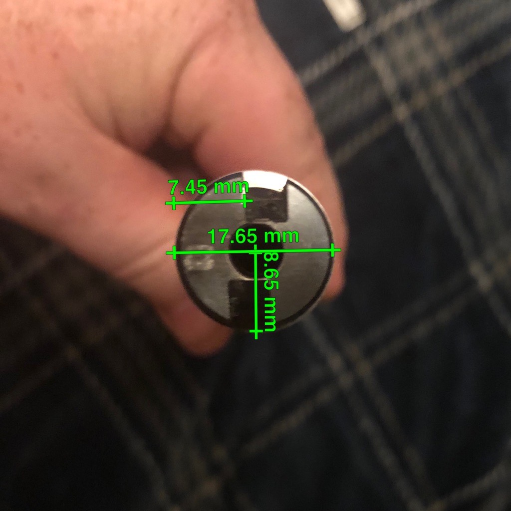

Anyone have a good picture of the breech end of an RPR Rimfire barrel? How about measurements of the breech end, tang diameter, tang length, shoulder diameter and length?
I have an idea and don't want to tear down my rifle (shooting too good), to get this info.
Thanks

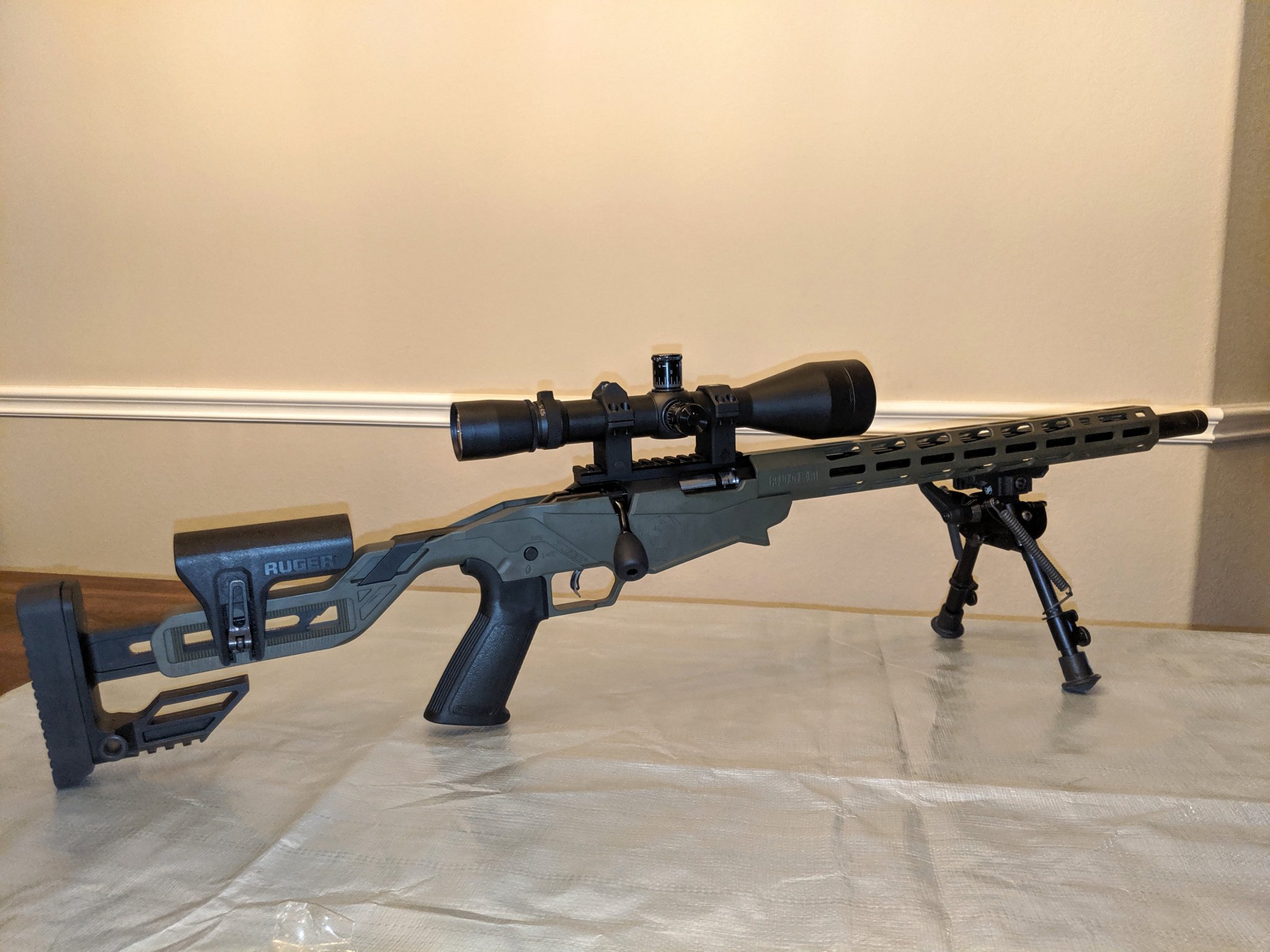

Picked up a new RPR 22 the last week of December 2019 and I LOVE IT!
Read here about the brown gunk in the barrel so after one pass with some Bore Tech rimfire solvent on a bore brush and a clean patch to dry it, went straight to my Bore Brite. Hit the chamber and leade about 30 strokes and the whole barrel about 25-borescope showed nice, shiny clean barrel. Other than the cleaning, the only thing I did was back out the trigger spring until I felt no spring tension. I found a scope base screw loose so I pulled all of them and applied blue Loctite. I also found the rear receiver screw completely loose and the front screw torqued to 35 inch pounds-go figure......
Installed a Bushnell Forge 3X18 30mm scope and I think it's a perfect match for the rifle. The parralex goes down to 25 yards, has an 84 MOA adjustment range, zero stop and great glass. I was shooting steel at 325 yds with it on my first trip to the range.
Shot some groups with a variety of ammo ranging from fairly inexpensive to stupid expensive and fortunately it did really well with the "real world" stuff.

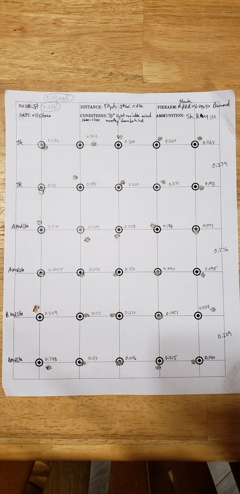

I have the two target sheets that make up the test but I'll just list the results right now. Some of the ammo have multiple measured groups.
All groups are 5 shot groups except for the 10 shot Eley Match group. All groups fired at 50 yards unless otherwise noted.
CCI SV .619, second group 4shots into .369 with 5 shots into .553
SK LONG RANGE .452, .433 and .394.
Center-X .429
Midas + .565 and .486
Eley Tenex .506 and .469
Eley Match 10 rounds into .425 and 5 rounds on a separate bull into .253!!!!!

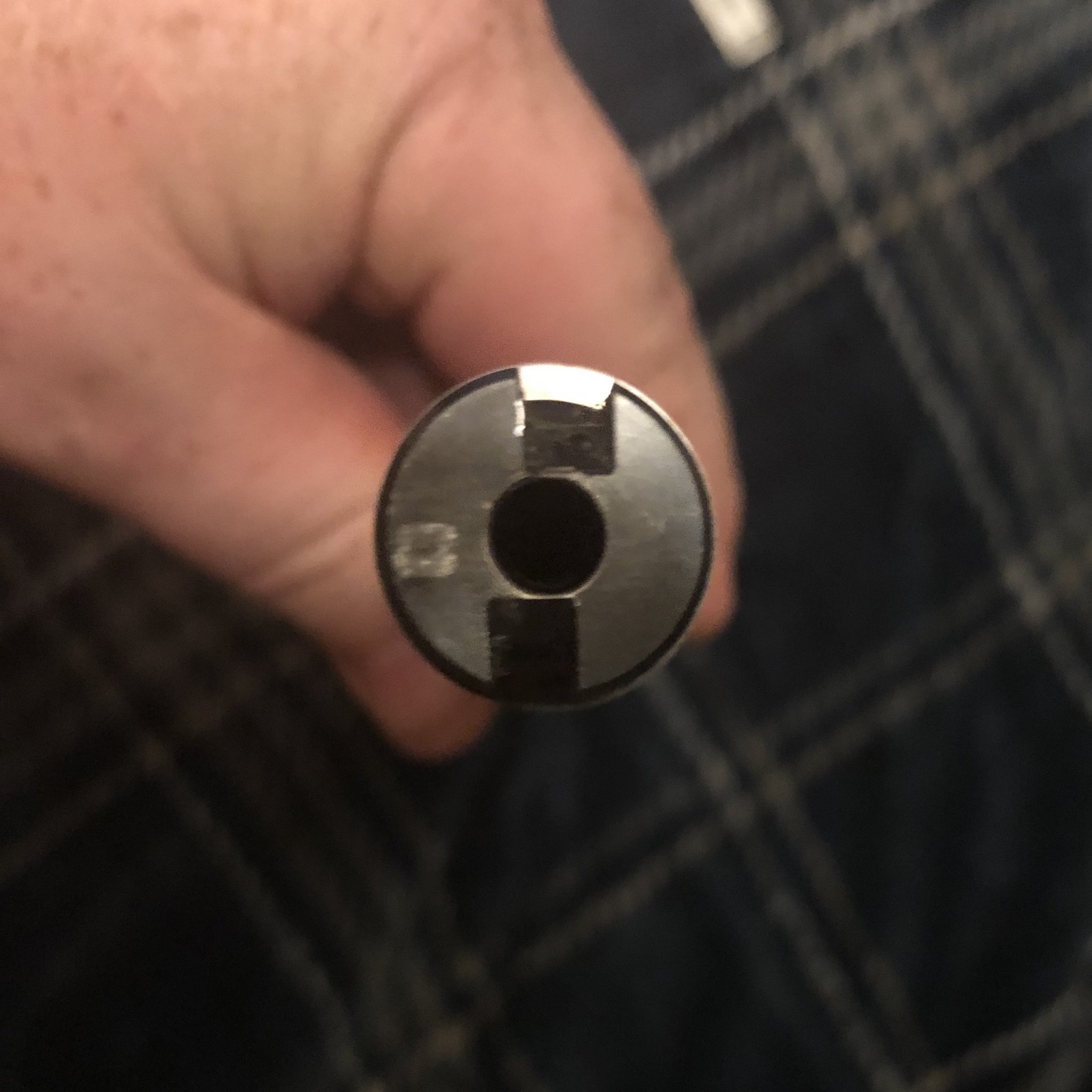

Thanks
This should do ya. If not, feel free to ask, I've got my old barrel sitting loose.
The only thing I gouldn't see a way to put on the photos was the angle of the exctractor cut face. Its at 75 degrees relative to the bore, and the depth is 2.25mm.
All measurements are taken with a digital caliper, and are as accurate as I can make them, but probably aren't perfection incarnate.
Good Luck,
Josh
Good Luck,
Josh
Thanks that will get me going.

I am getting 0.3x and 0.4x moa at 50yds with a few different brands and levels of ammo from mine and it is straight out of the box also. I plan to push out to 300yds methodically so I can track performance of the basic rifle (and my own improvement). I would also like to see what another rifle with modifications would do in comparison (as well as my skill) side by side. Hobby? No! It's a science experiment. Therefore worthy of extra funding.
Reactions: Booner1334
Then you have a really, really, really good lucky RPRR. .3x / .4x moa at 50 yards means your groups are less than a 1/4". If you can do a .3x moa ~ .15" average groups, then you'd be one of the top 6x5 shooters ever in the history of SH's 6x5.
Or did you mean .3x / .4x inch groups?
Maybe I am measuring wrong. Let me get a pic up.
I am measuring center to center with a dial caliper. Then adding two lines and getting the average. Then adding the three averages for an overall average. It's been a stretch since I spent time in the machine shop and even longer since I had a math class. This is also my first go at a 6x5 so I could be happily and totally screwed up. Point me in the right direction.

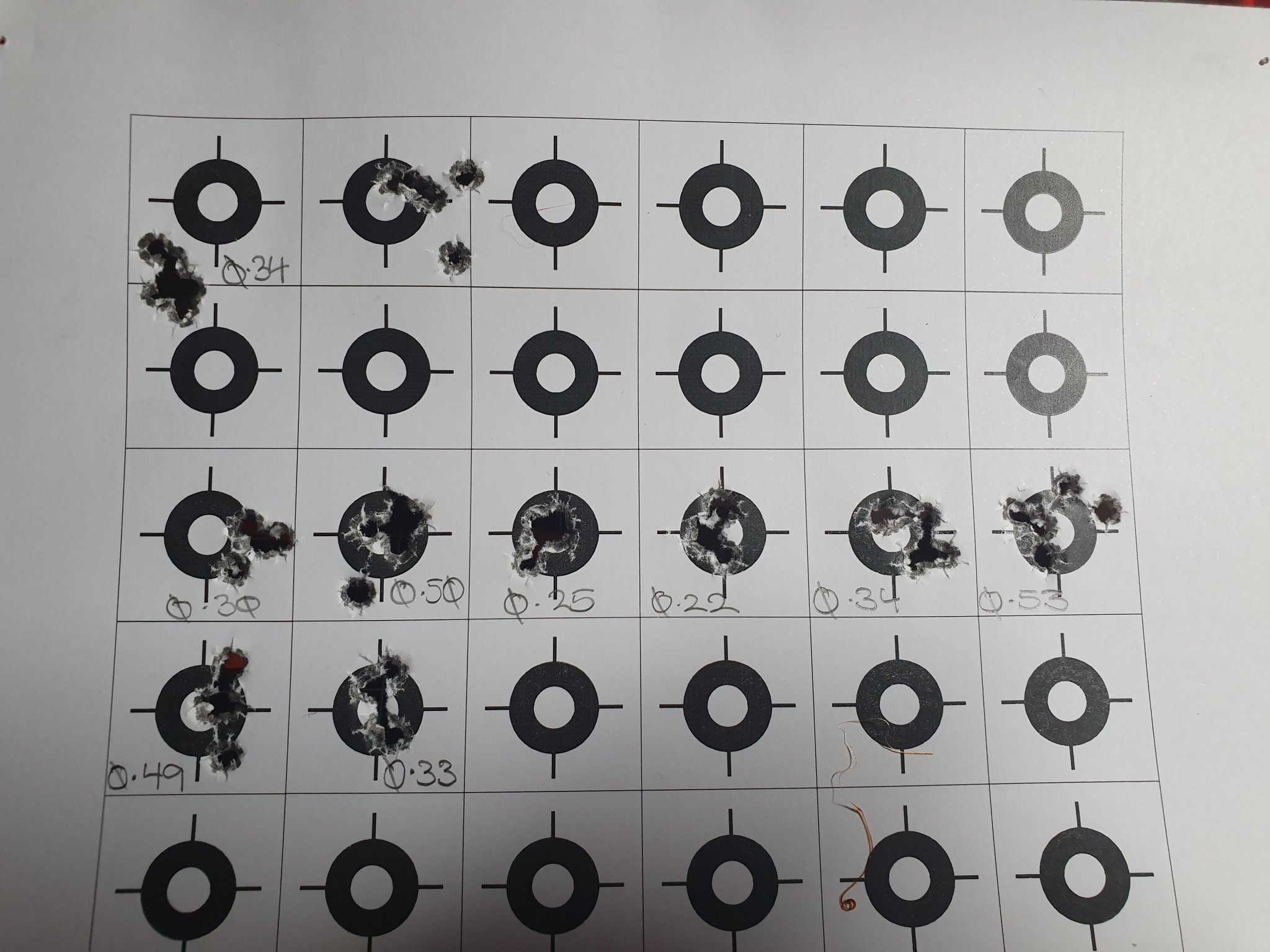

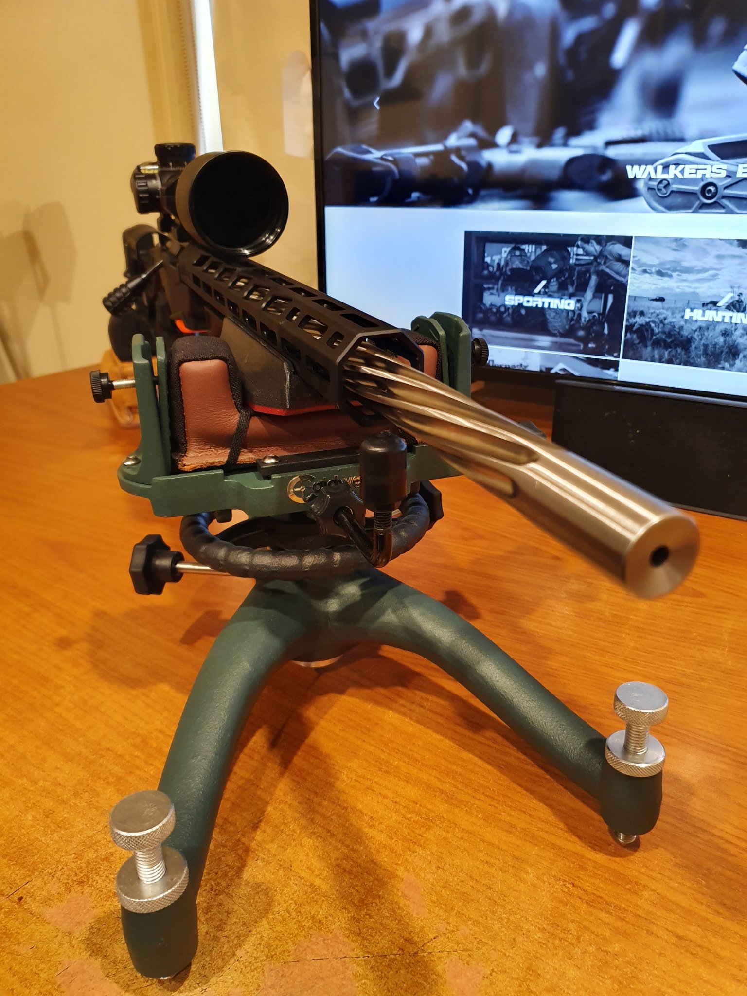

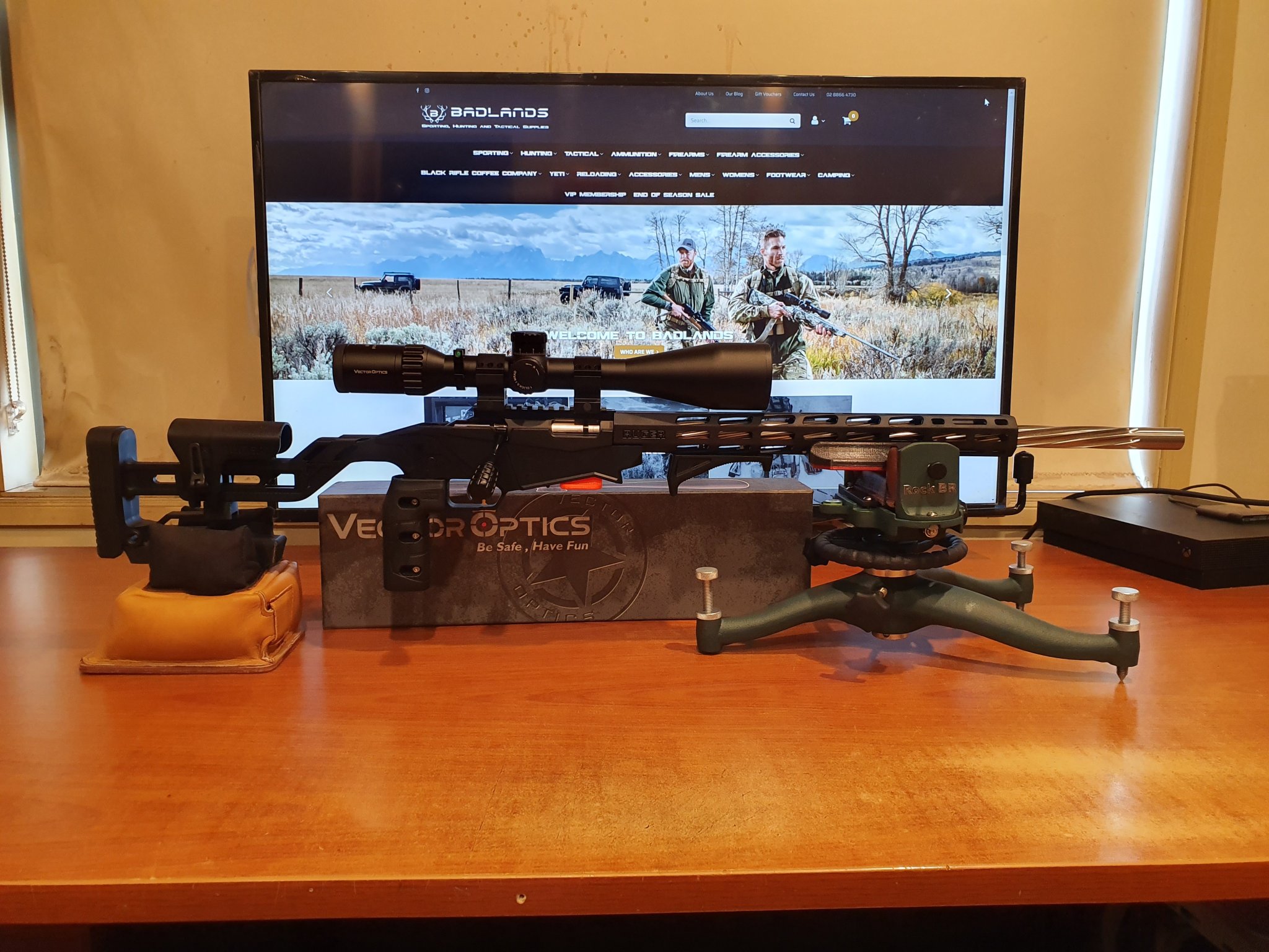

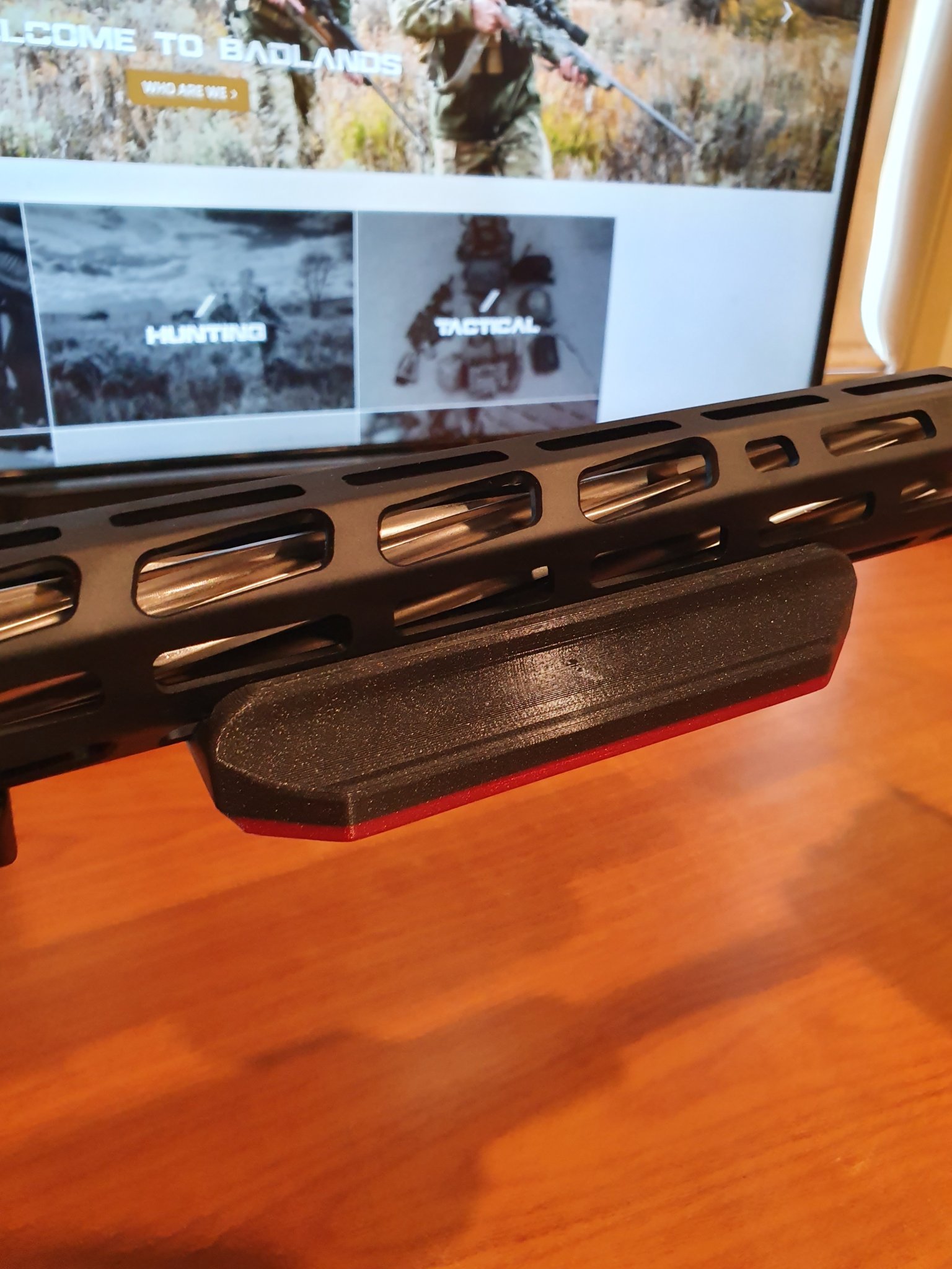

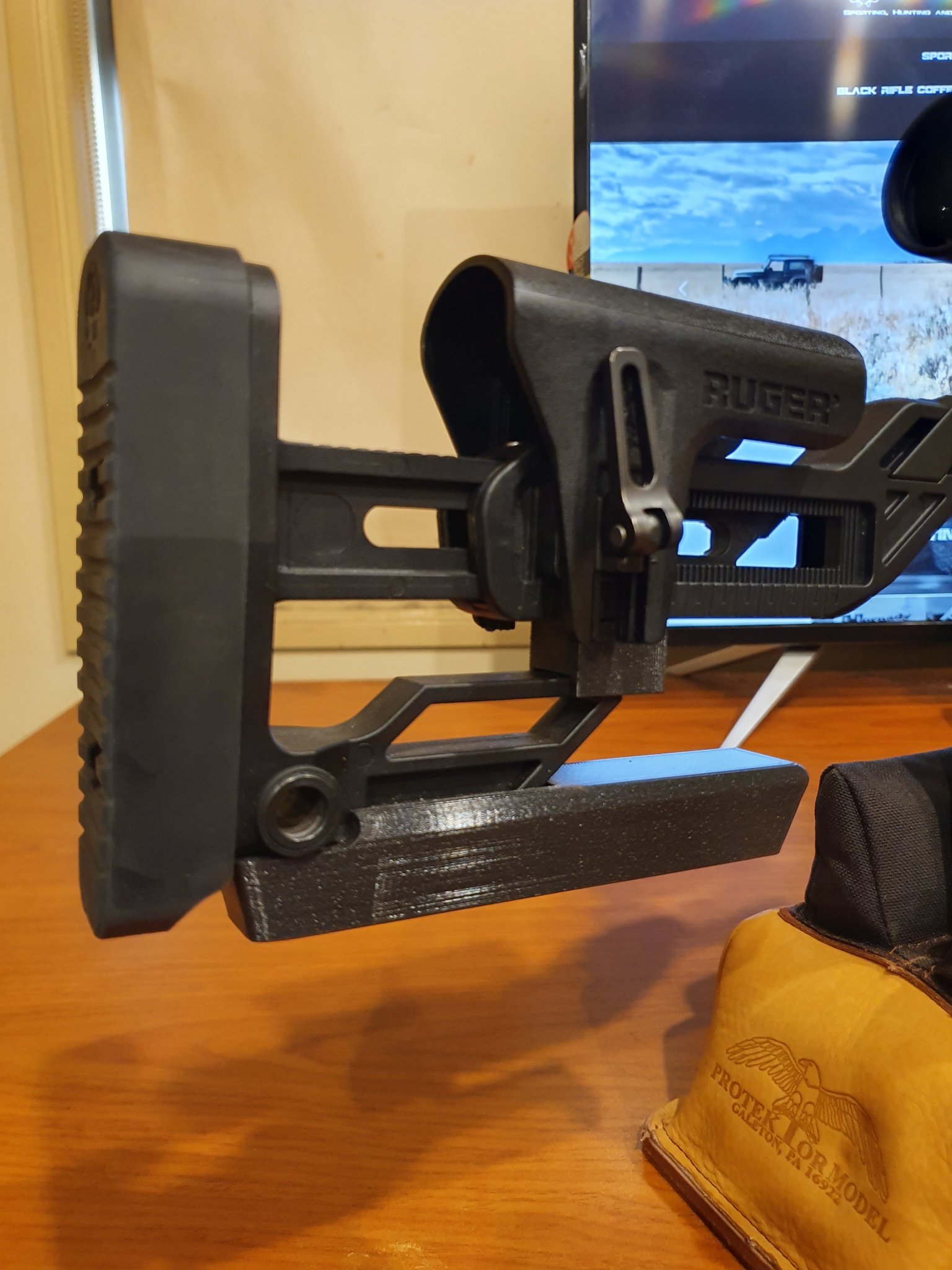

Thought I would share my setup and range results with a new barrel . This is from range session # 2 with a new IBI drop in barrel ( still trying to find the best accuracy for money ammo). The ammo used for this target is Lapua centre X out at 55 yeards (50 meters here in oz).
Upgrades:
IBI flutted barrel. Original barrel was still inaccurate after 1000+ rounds and different ammo
3D printed bag rider.
3inch 3D printed forend rest.
MDT Grip.
Vector Optics Continental scope on a 0 moa rail.
Waiting to see if I can get access to a timney trigger ( hard to get and exy in Australia)
The rifle shoots, I just now need to get better at using it :). Only started shooting a few months ago
