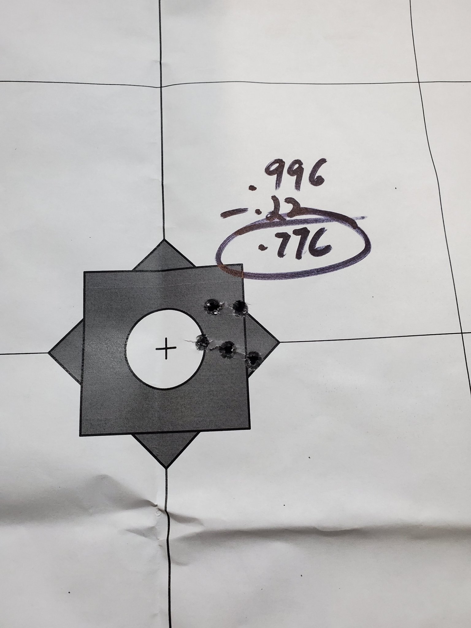

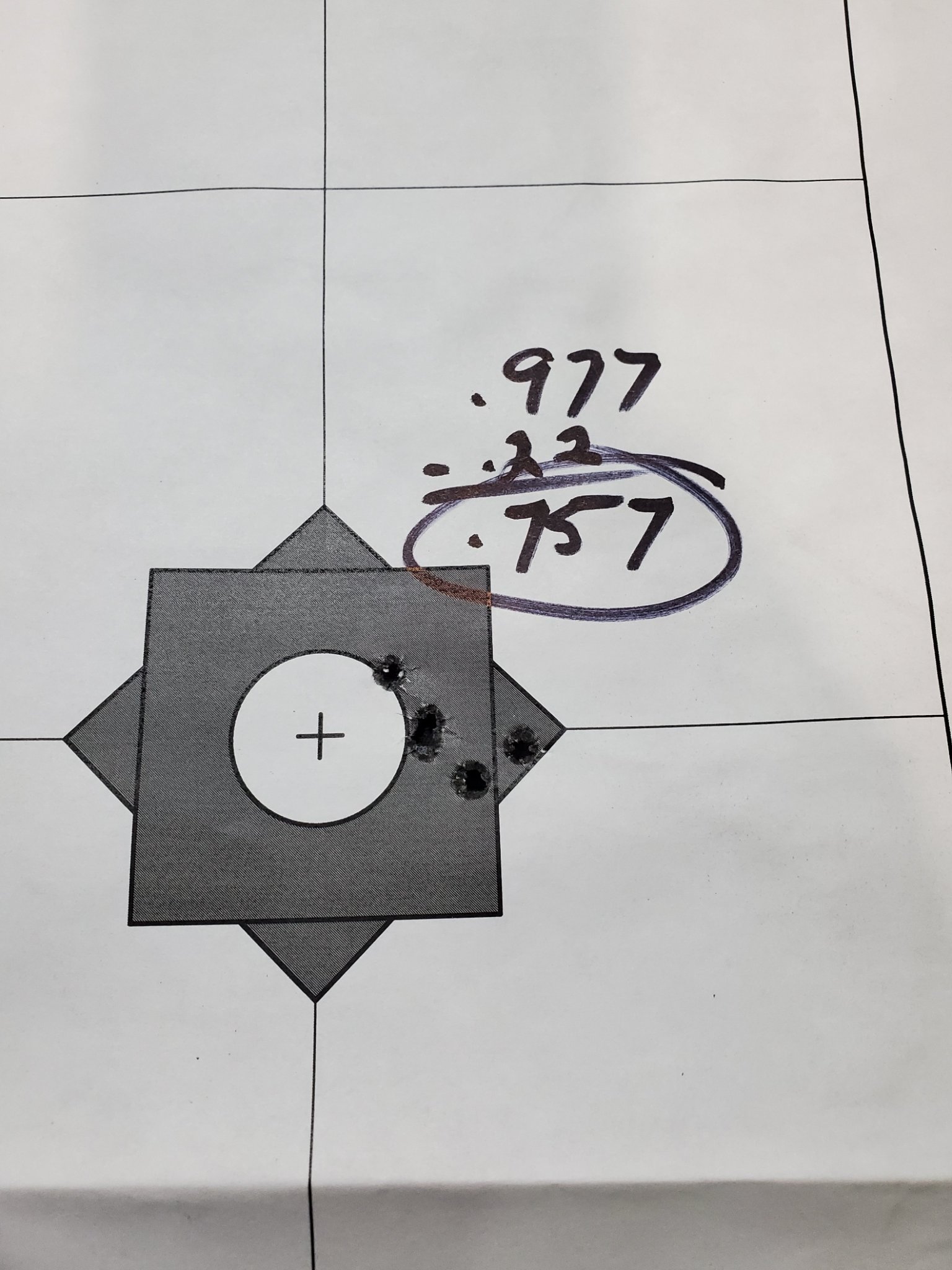

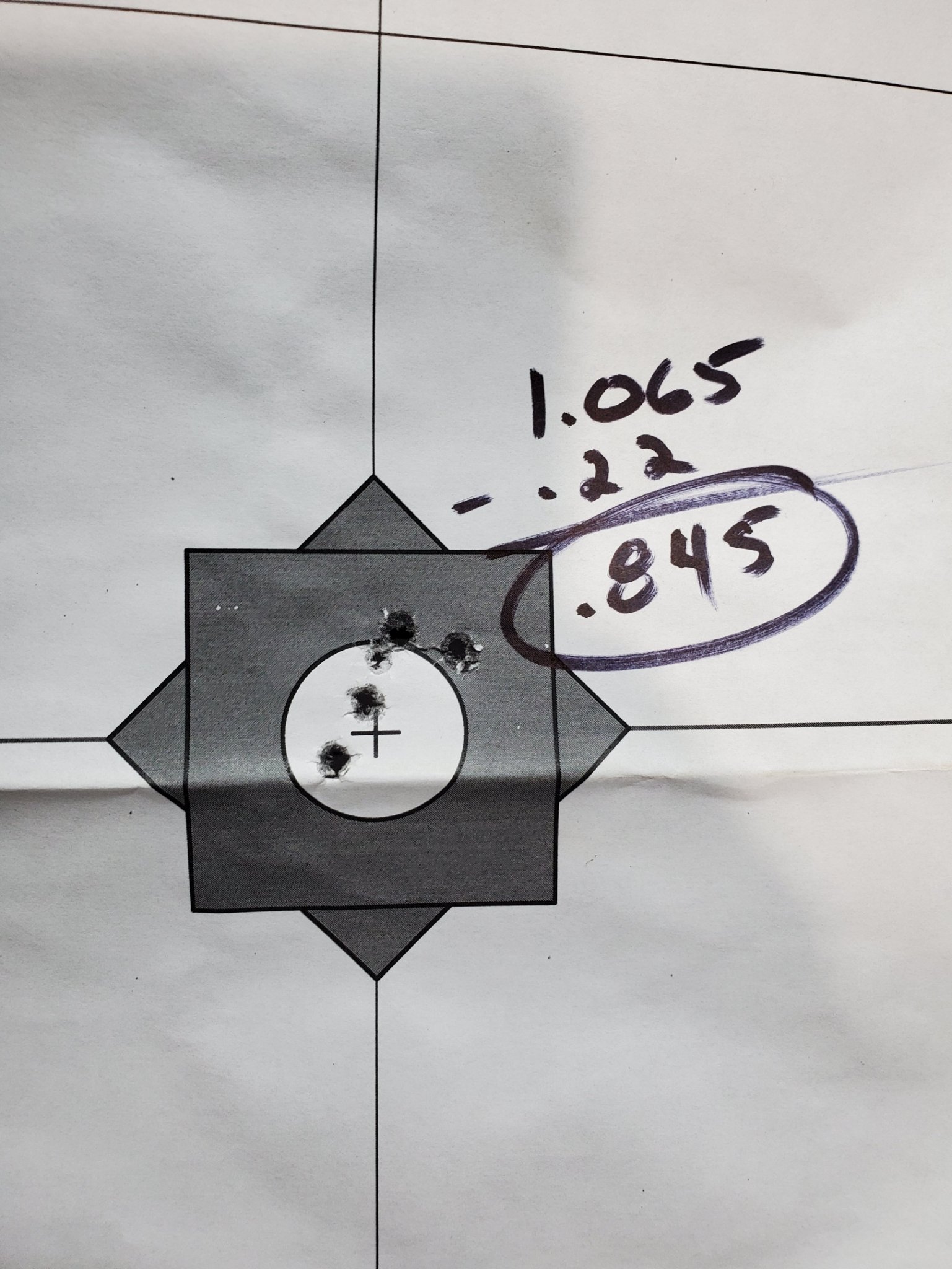

These are about as good of groups as I have been able to put together with my STOCK RPRR. These groups were at 50 yards with CCI Green Tag. I have to test standard velocity again, but last time I tried SV, it didnt shoot well. These groups were done at an outdoor range with roughly a 10-15mph wind too, so I am pretty sure I could tighten them up a little more with no wind. I also tried at 100 yards and my group of 10 rounds was about 5.5" low and maybe a 6" spread. That is obviously nowhere near MOA, but keep in mind, that 10-15mph wind probably moved those little .22 rounds quite a bit. I think this gun in stock format is OK for plinking, but my other 2 .22lr rifles shoot much better, at least at 50 yards.
View attachment 7252868View attachment 7252869View attachment 7252870
the vertical spread is probably due to MV variation as well as jump. L-R may be wind.
i'd be interested in 10 shot or 20 shot groups; a five shot group can deceive you.... Will post pics of my next outing.

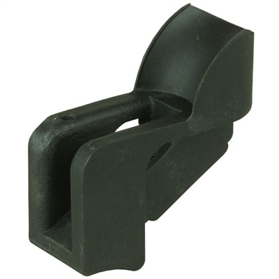

I've recently acquired a RPRF rifle. In reading through the mass of data here and on other sites I've decided to simply clean and shoot it first before making changes. I have made one exception to this rule, the magazine. Numerous people have reported problems with the supplied 15 shot magazine so I decided to set it aside and use 10 shot mags. Others have talked about reducing the spring tension on the magazine to reduce bullet deformation when chambering rounds.
I grabbed one of my 10 rounders and cycled a few rounds through the chamber. Sure enough there were scratches on the rounds. Now my inspection of the bolt looked decent so I figured I would modify a magazine by reducing the spring tension.
I painted a white line as indicated in the above picture before disassembly. Before tensioning the spring and reassembling the line on the hex lined up with the red line on the left. Instead of doing the 1 and 1/4 turns as suggested I decide to start as low as possible and see how things went. That simply meant turning the hex 90 degrees (1/4 turn) to the right which lined up the white line again.
This resulted in very light spring tension. With 10 rounds loaded in the magazine tension was light enough that you could hear the rounds rattle inside, unlike an unmodified magazine. Would there be enough tension to feed the rounds? I inserted the magazine and then cycled the bolt until the magazine was empty. I then checked the rounds and to my surprise there were no marks, none! I ran the same rounds through the magazine and the rifle several more times the magazine fed every single time with zero fails to feed. There was also no damage to any of the bullets.
Now I know this was a clean rifle and mag and that once I get it to the range things could change. But at this point I know that the magazine is exerting the least amount of pressure on the round preventing damage during chambering. If I do get any failures to feed in the future I can simply advance the hex one position to the right to add a little more tension or a simple cleaning may resolve the issue.
I'll update range results once I have them.

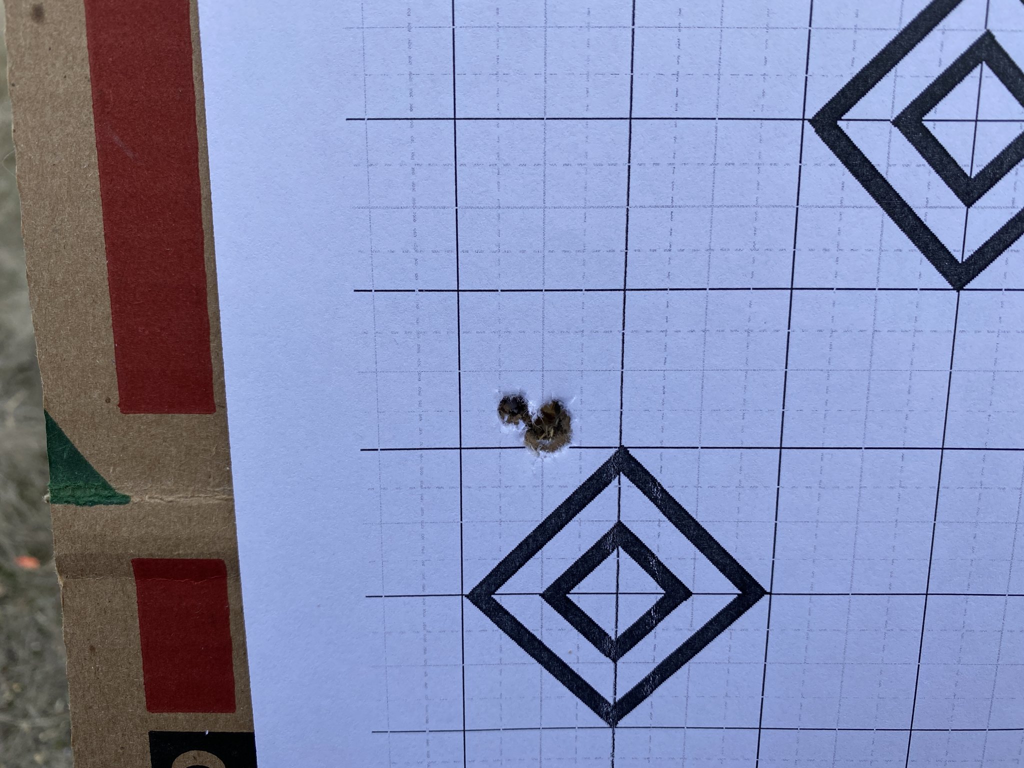

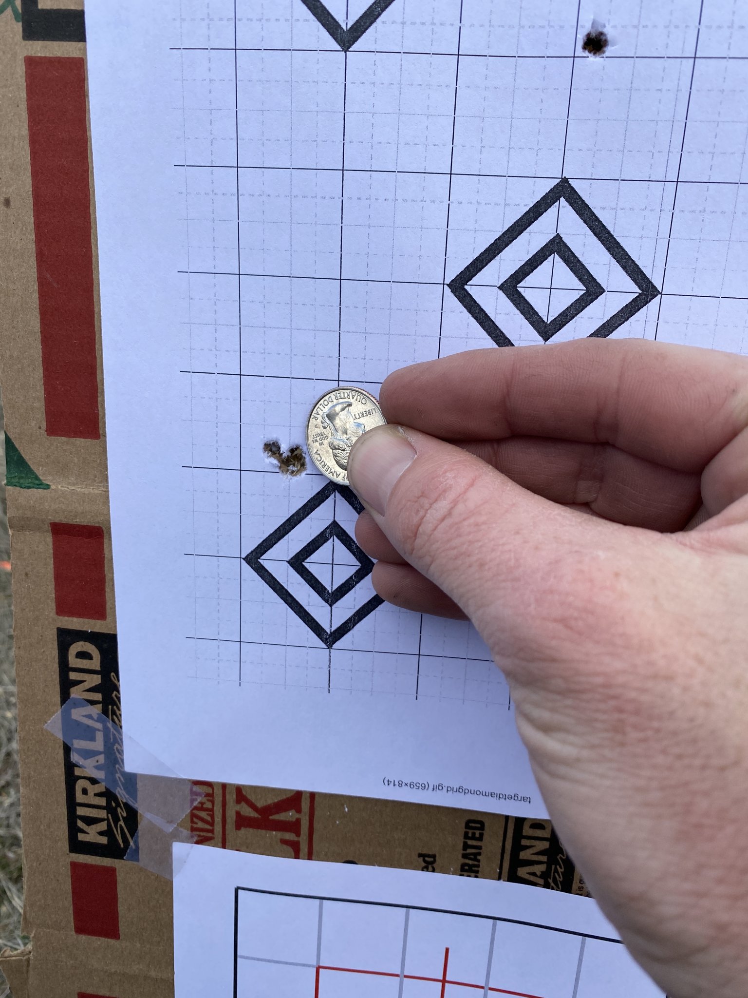

went out Saturday for a while. Wind stopped blowing for 30-45 minutes and had some lu
Bent the spring back and had some issues with extracting RWS match ammo and Geico Match (same company). Funny thing was I had a magazine of Winchester wildcat 333 round bulk stuff in a 15 round ruger mag and it shot the best and cycled the best.
Here is pictured 2 groups at 51 yards (lasered)
got out more ammo and cycled it just fine. Seems to hate cycling waxed bullets.
Still the bulk shocked the crap out of me.
