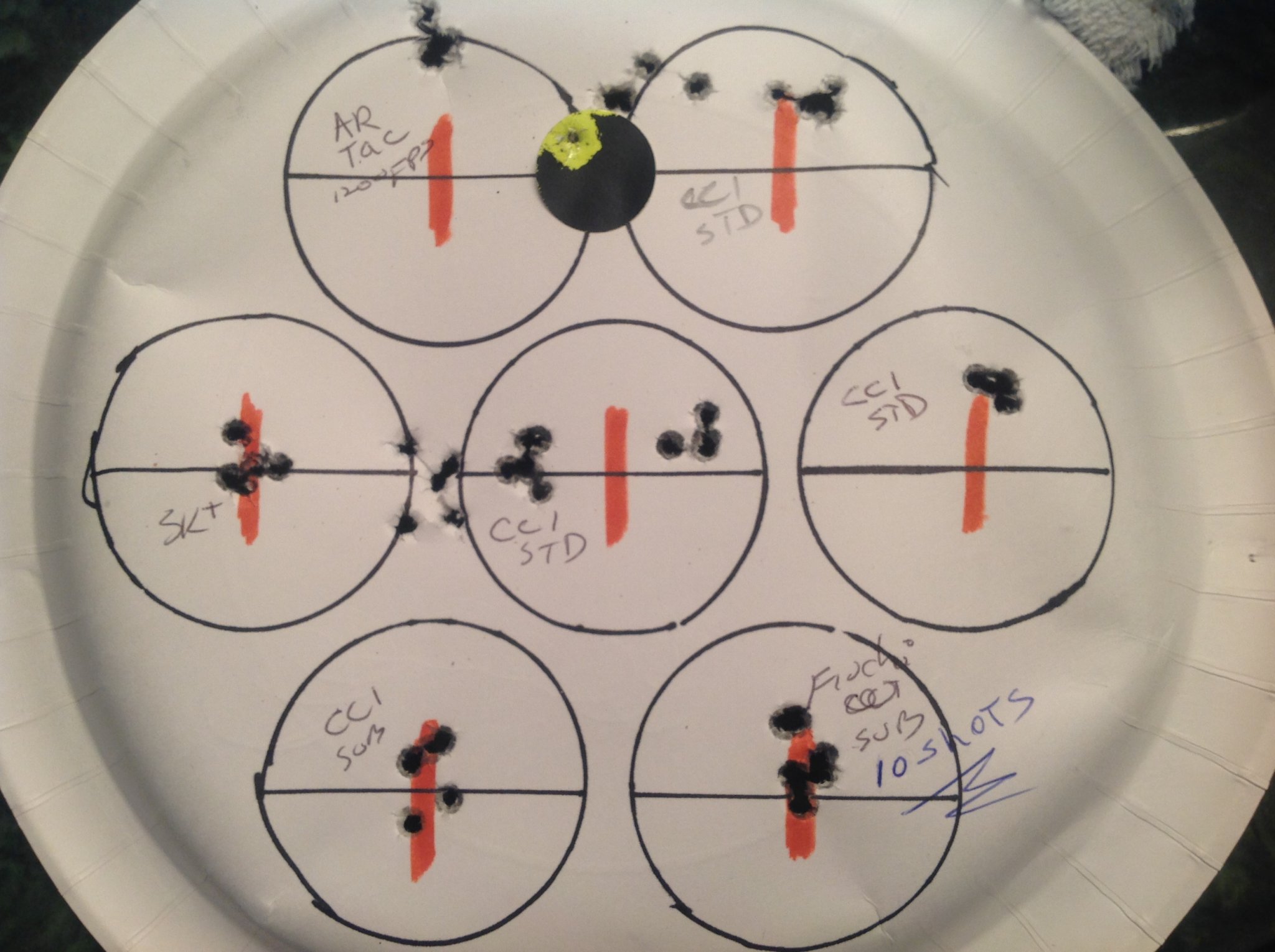

Got a rprimfire a few days ago. Been breaking it in and shot a few quick groups at 40 yards. Could cover them with a dime. Ammo was cci standard velocity. After all the bad comments about accuracy I was skeptical but I think this rifle has real potential.

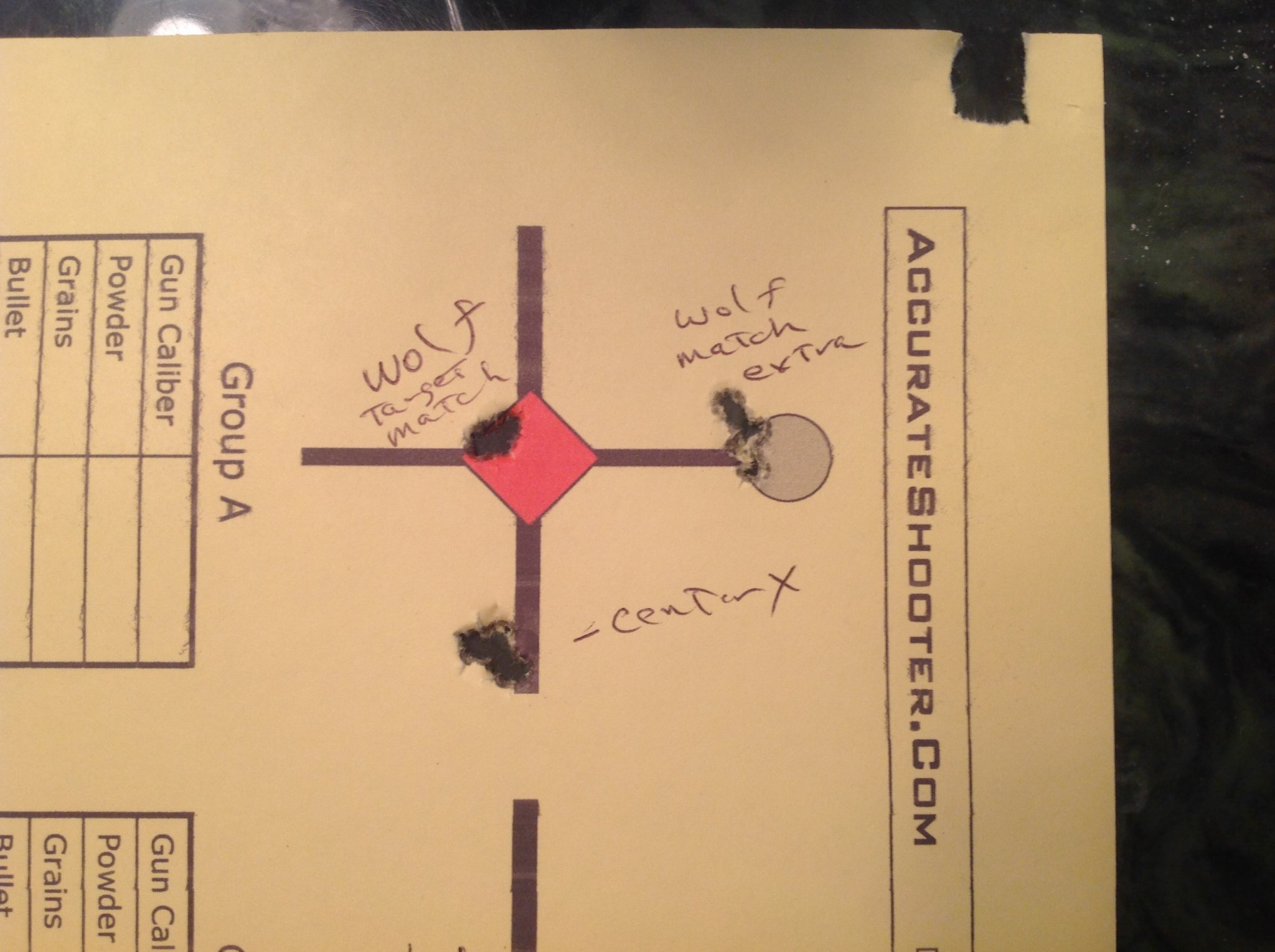

Think mine likes Wolf Target Match. Looks like it's now being produced in the U.K. Instead of Germany

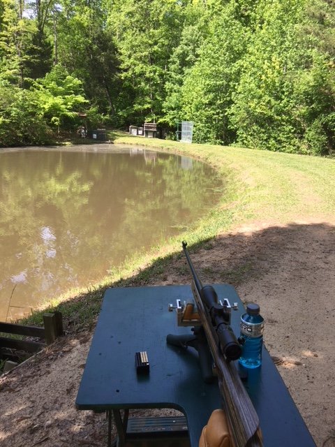

We were about 30yd didn't want to be in the sun. Hot here in SC. Feel pretty confident to expect the same groups at 50. My cz loves the wolf match target from the U.K. Better than the German loads. This Ruger appears to like it also. Think I will load up on it this weekend from grafs

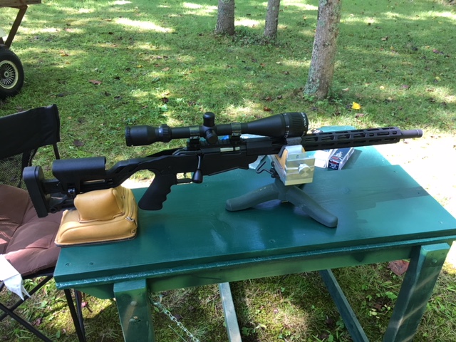

here's my setup as of now. it has the 30moa base with a backwards AI 45moa mount! lol
Also did a trigger job, I'm at 13oz
I'll post pics of groups in a few
CCI standard has proven to be an excellent value between accuracy and price lately. @ $25 a brick it cant be beat.The target is comprised a of four 1" squares making a box 2" x 2" shot at 30 yards
