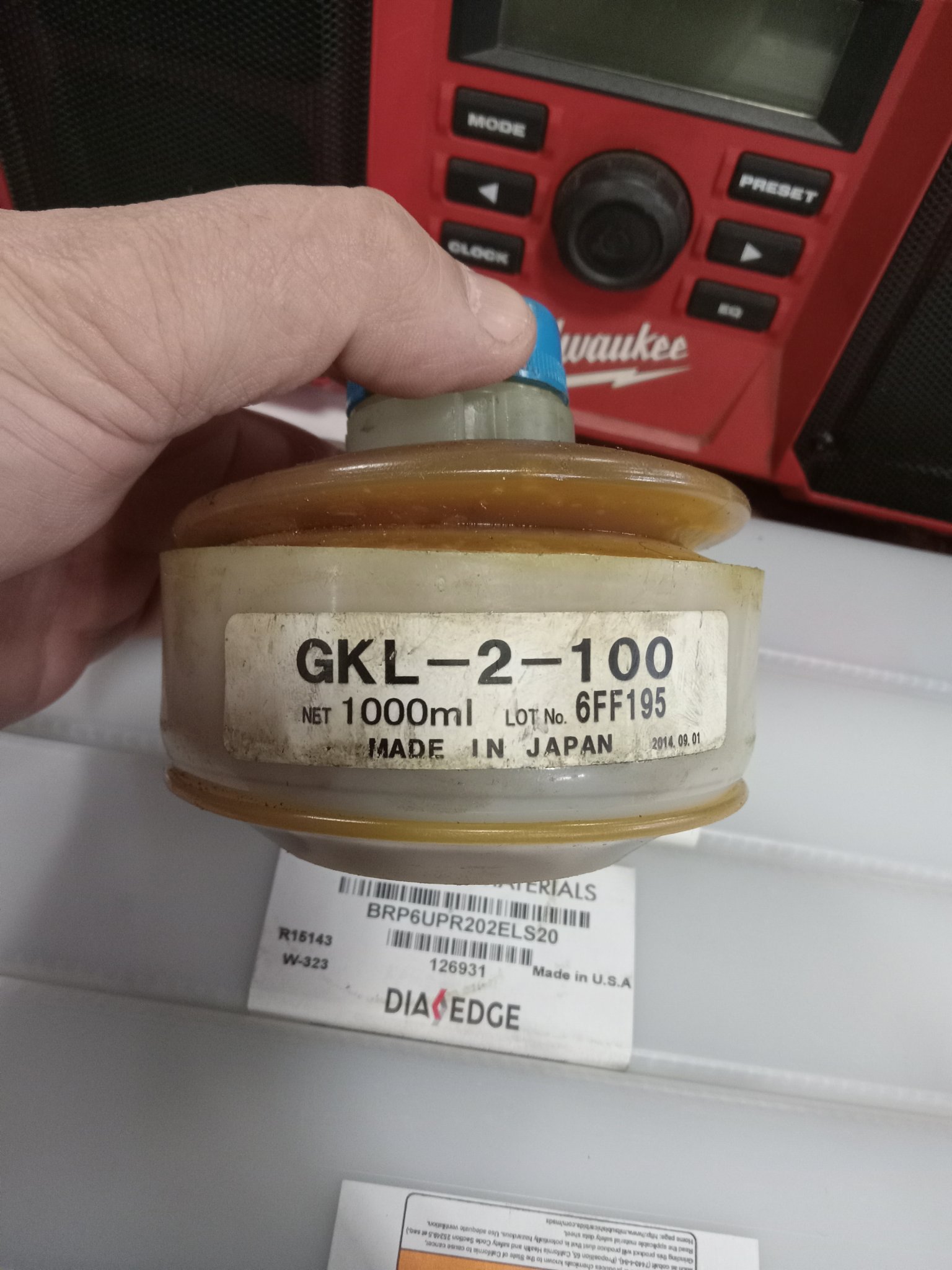

I was going to chime in about the matsuura grease. White grease in a green tube for the makino as well?
This is the stuff for Makinos. The tubes are probably 10" or so tall when full.
