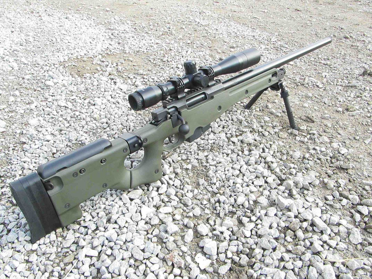

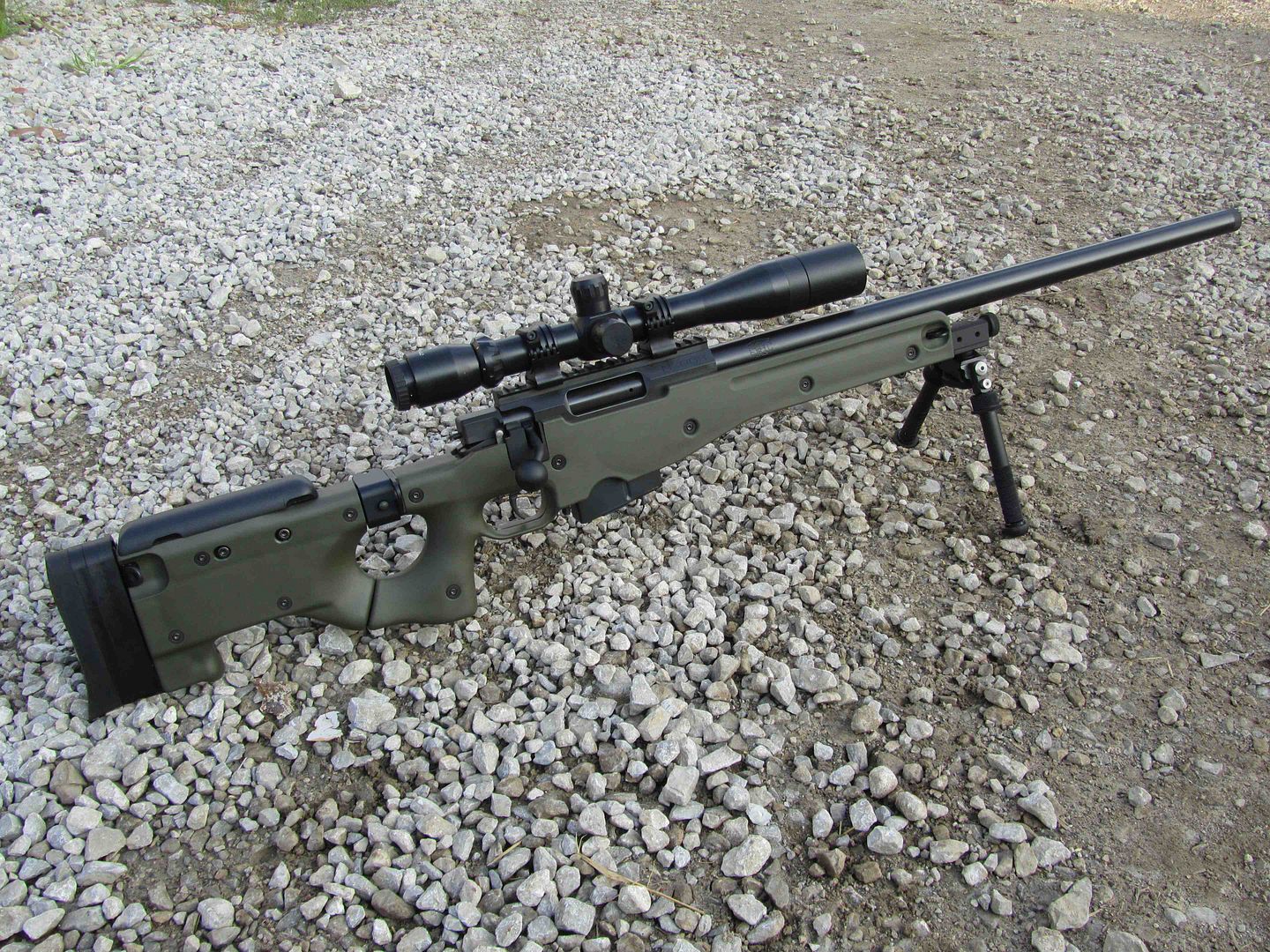

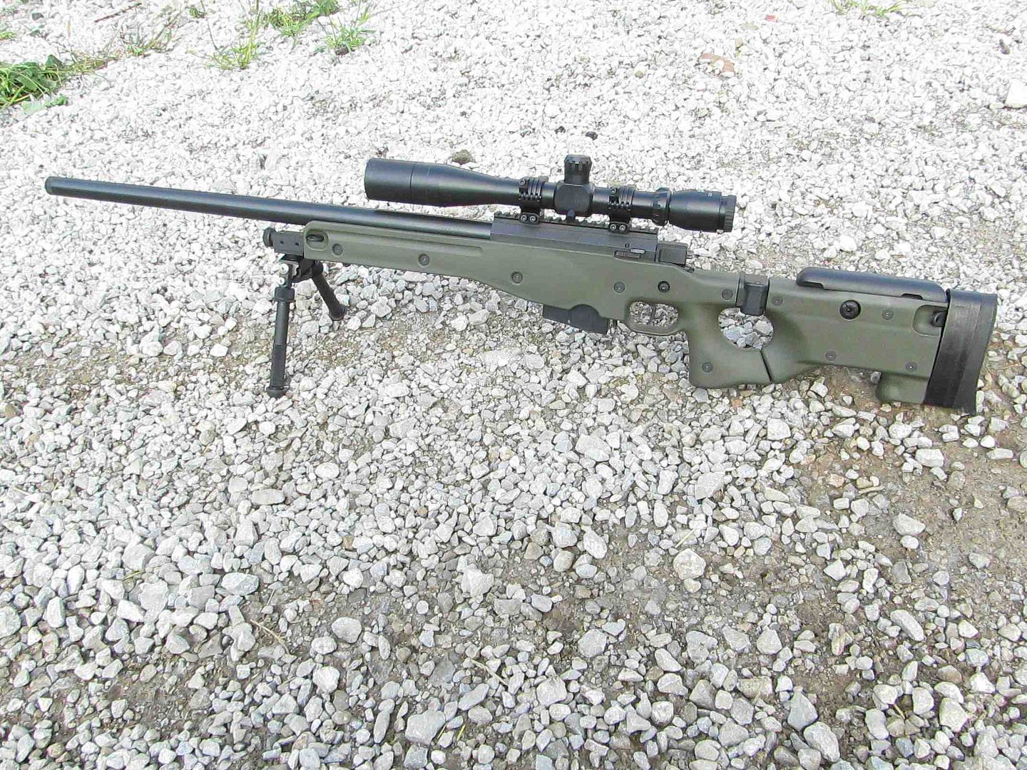

Just showing a few pictures of a recent build that we completed. This is a 6.5 Creedmoor on a Badger M2008. The M2008 was Ion Bonded and the barrel was Melonited. The Ion Bond is the slickest product I have used on actions to smooth them up, prevent corrosion and also darken. The problem is it is expensive. Melonite was chosen for the barrel to match up with the Ion Bond color wise, but also to add the benefits of the Melonite treatment.

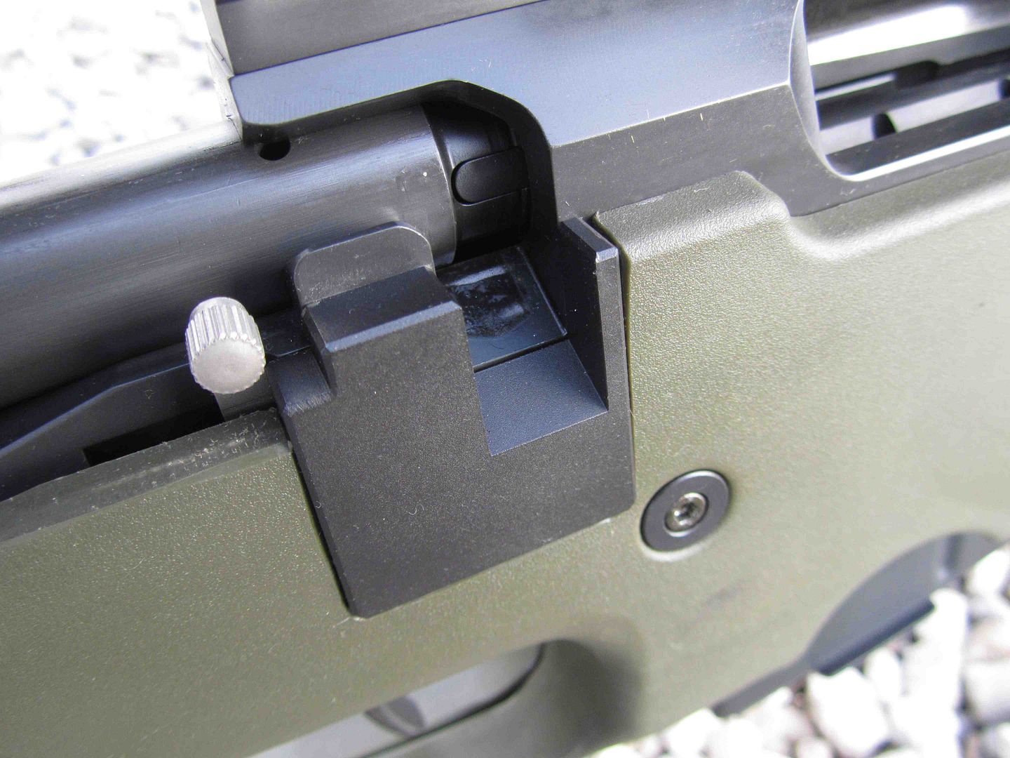

For this build, we had the AICS opened up for a M2008, then it was refinished. GA Precision helped out with the stockwork. Next, we fitted our custom bolt handle block to the stock. As you can see all the mounting hardware are blind. This looks cleaner and works the best in my opinion.
Here are the specs.

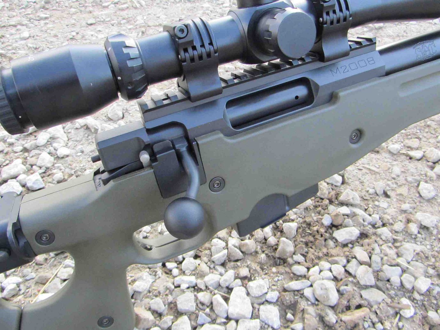

Badger M2008 Action.
Completely Ion Bonded
AICS, opened up for Badger M2008 action.
Custom bolt handle block machined to stock, fitted for action.
Rock Creek M40 5R 6.5 barrel
Chambered to 6.5 Creedmoor
Cut to 25", crowned, threaded and fitted custom thread protector.
Barrel Melonited
X-Treme Shooting Products Mod-22 trigger installed.
Mini 6.5 CM chamber for reloading reference supplied.

<div class="ubbcode-block"><div class="ubbcode-header">Originally Posted By: dukedurham</div><div class="ubbcode-body">What rings are those? Not seen them before. </div></div>
Gen 3 American Rifle Co rings.
I got a prototype set a couple months back, apparently they're starting to filter into dealers now.
