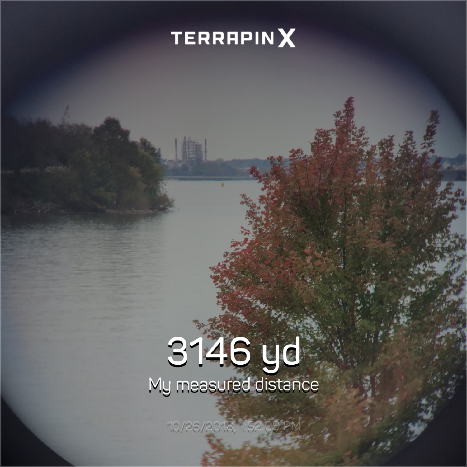

Took my T-X down to the river and was very pleased with the results. I started off ranging buildings across from me and most were around 2000 yards. I hit a street sign over the highway across the river at around 2600 yards. Most of the further points that i tried to range were to far. I later checked them on Google maps and found them to be well over two miles. What was most impressive was when I ranged the channel markers and buoys. I was able to range the farthest one that I could see at 3165 yards! I was able to hit this repeatedly and got the same results. I checked that distance on google maps and found that both were within a yard of each other at that distance. I was also able to range smaller things like markers for what appeared to be crab pots at 1500 yards. Also ranged a speed boat going by at around 500 yards and was able to track it the whole time. Im throughly impressed and very pleased with the T-X.

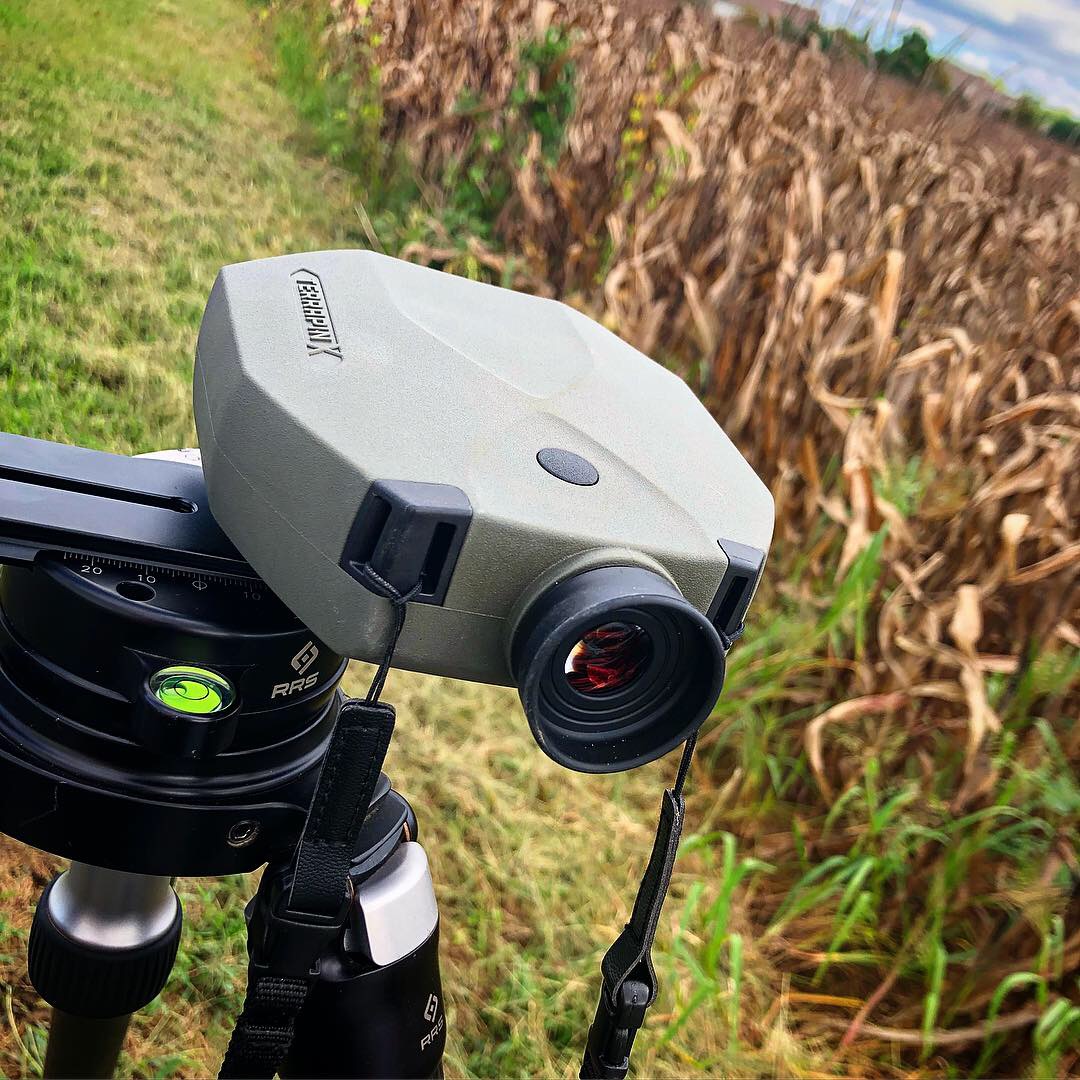

This isn't 100% exclusive to the Terrapin X, although it is the only LRF I'm considering when I upgrade, but how would a TX or any LRF for that matter work on a RRS tripod with a Anvil 3- ball head? I saw a few posts ago where they made an ARCA plate for the TX, but where the Anvil 30 is set up for much heavier equipment would it be smooth with something as small as the TX?
Both the Terrapin and the RRS tripod are on my list of gear to acquire, and I want to make sure they work well together. Ideally I'd love to have just the one tripod for the TX, Binos, and rifle of course.
I use the Terrapin X on a RRS tripod w/ the anvil 30 and I have zero issues with it.

Awesome. I know next to nothing about tripods so that probably seemed like a stupid question to most folks. In my head a ball head designed for a full sized tactical rifle would have to be pretty rigid and would be rough with a sub 1 lb. LRF.
You can adjust the tension on the anvil 30 if desired. The way it is setup at the factory works fine for me. Actually, regardless of the head used I rely on slight pressure applied to a CF tripod for perfect reticle alignment to target.

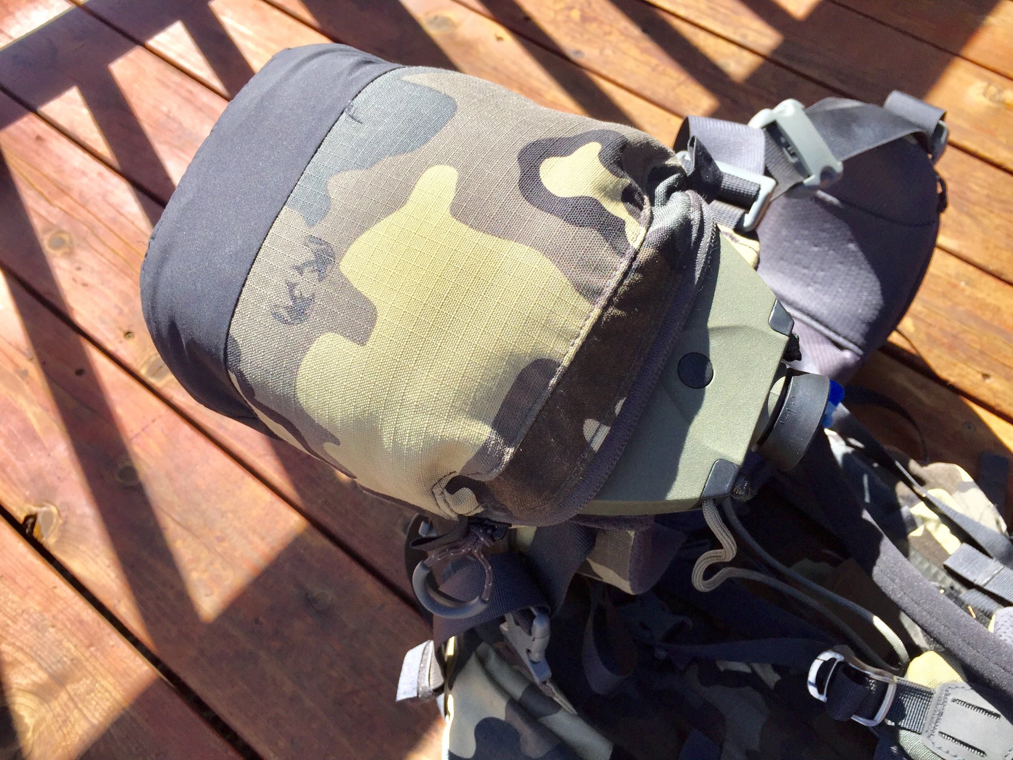

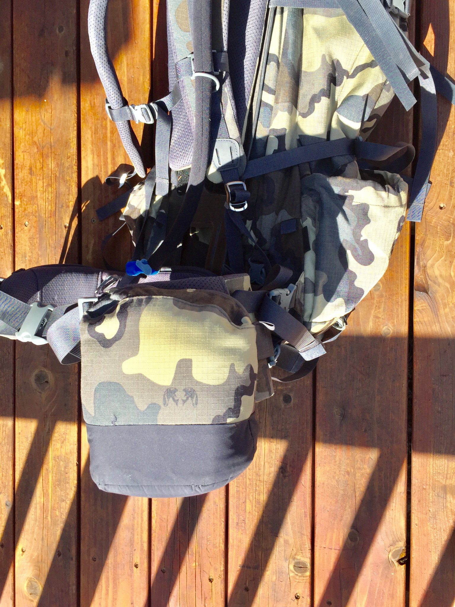

For safe protection or throwing it in a pack I use the small Larue padded scope case. Perfect fit, very durable and well padded.
Mystery Ranch as stated above great.
My talented wife built a nicely padded case using one of my KUIU pouches adding 1/2 foam between layers of the original KUIU and black gortex inside and out.

Took my T-X down to the river and tried my best to get a photo. I don't know how you guys do it with holding it steady and getting a good photo. I couldn't even get one with the red digital display. I was able to use the app and do it that way so it kinda worked. Any advice on how to take better pictures with it would be greatly appreciated. Heres the picture of a yellow buoy/channel marker at 3145 yards. I had to switch positions due to the last place being closed off.
Just hold your phone/camera behind it or is there some sort of mount i should try using? Also, how are you getting the red digital display to appear? i could not for the life on me get it to show up in any of the pictures I took, thats why I had to use the app.
It’s hard to get a pic of the terrapin x display. Im not sure what the proper term is, but it’s similar to taking a photo of your tv screen and seeing lines. The way the info displays digitally and the way your camera captures it don’t mesh very well. You might try taking a short video then doing a screen shot when the display is visible.

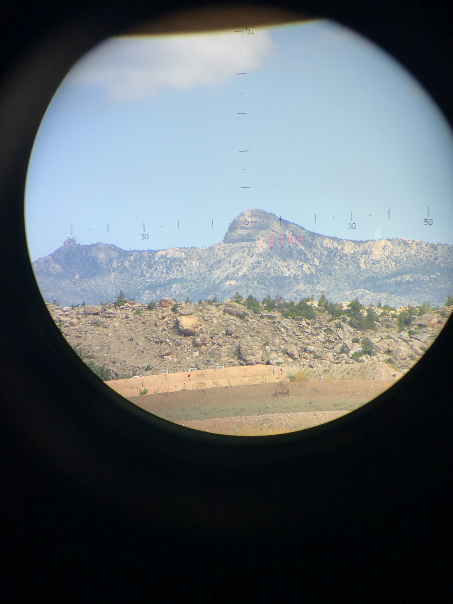

Anyone know for sure what orientation the laser box is? I know it's 1.2x.5 mil. But which is vertical vs horizontal? I'm trying to bracket the reticle & I think its long side is horizontal. Just not sure. This was my 2nd outing with it.
Thanks.
Never mind. I was able to get it worked out. It is definitely a horizontal rectangle. Mine is centered just a bit to the right of the reticle circle but centered perfectly vertically.

What is the maximum distance you have been able to detect with the Terrapin-X? Thanks
