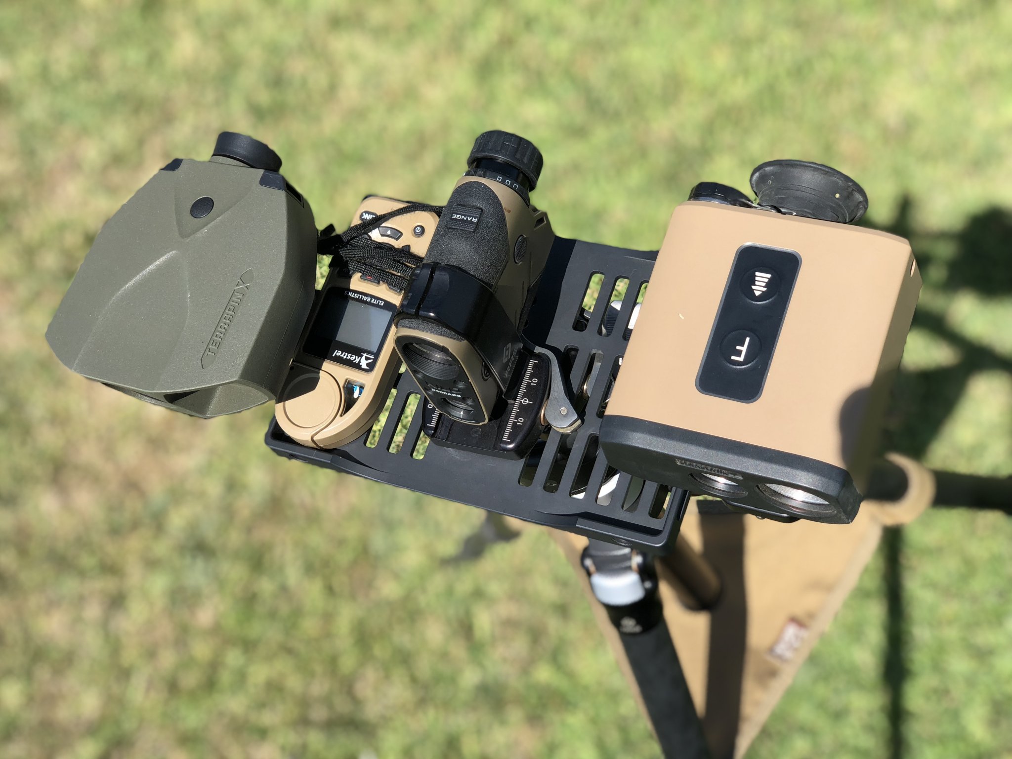

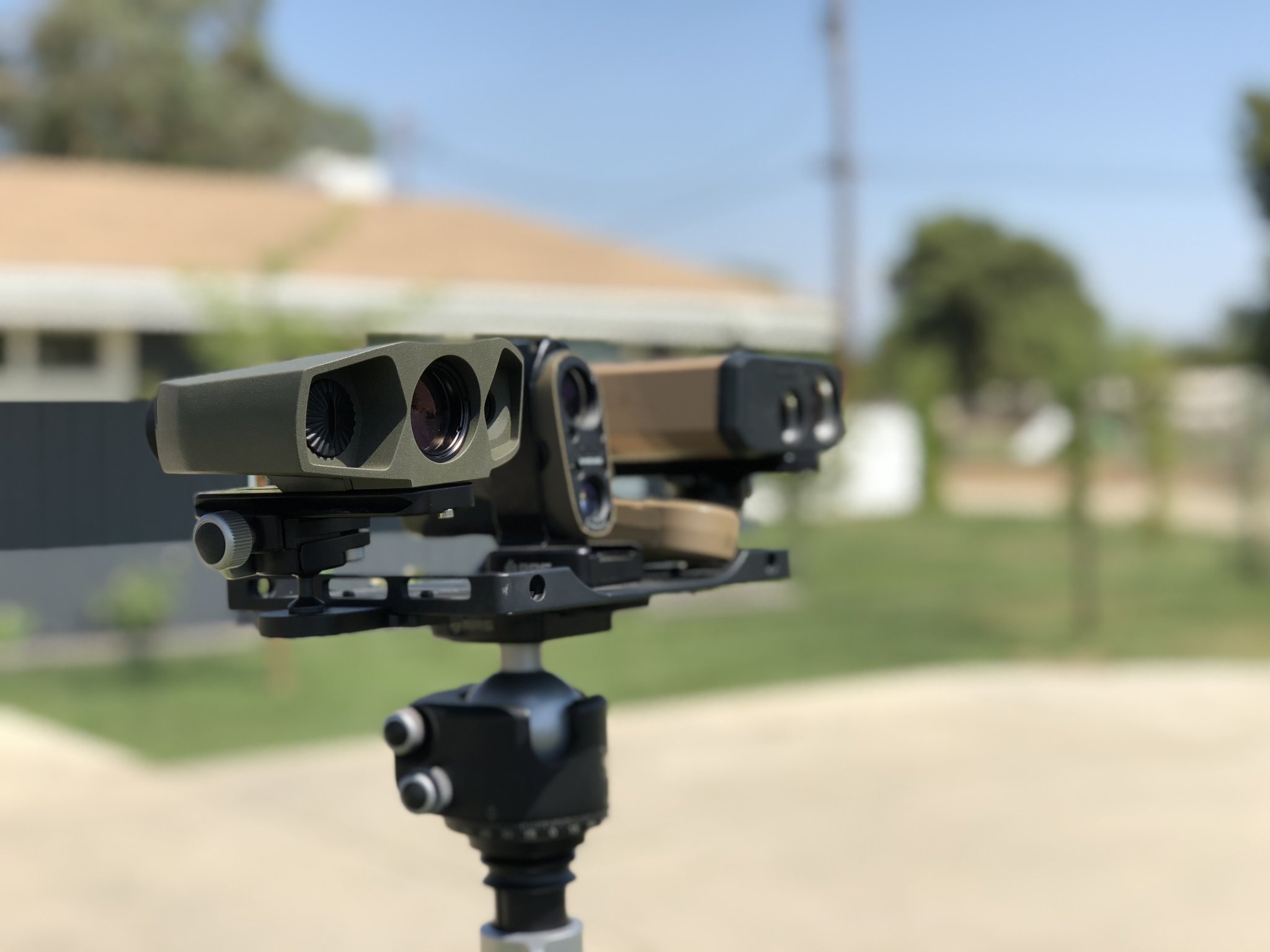

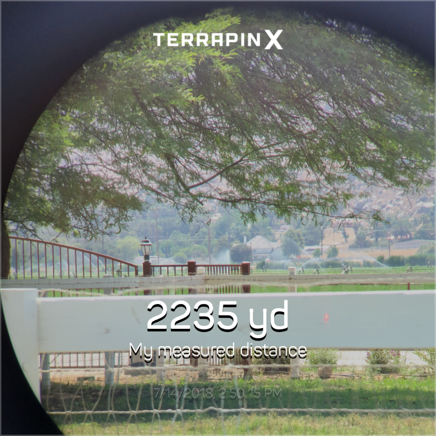

For those interested- been comparing Terrapin X, old Terrapin and Sig Kilo yesterday and today. Frank’s findings are spot on with my experience. Old terrapin slightly outranges the new one (that seemed to be amplified the darker it got for me), Terrapin X and old Terrapin both outrange the Sig Kilo every time, day or night (I have been a Sig Kilo fan since it came out). I’ll attach some pics. Here were my findings-
Bright Daylight-
Terrapin X- hit 2,235yds, couldn’t get it to go further
Old Terrapin- hit 2,537
Sig Kilo- could not hit 1,900ys, both Terrapin’s did every time
Dusk-
Terrapin X- hit 3,060 yds
Old Terrapin- hit a whopping 4,700 yds
Sig Kilo- wouldn’t range 1,900, both Terrapin’s hit it every time

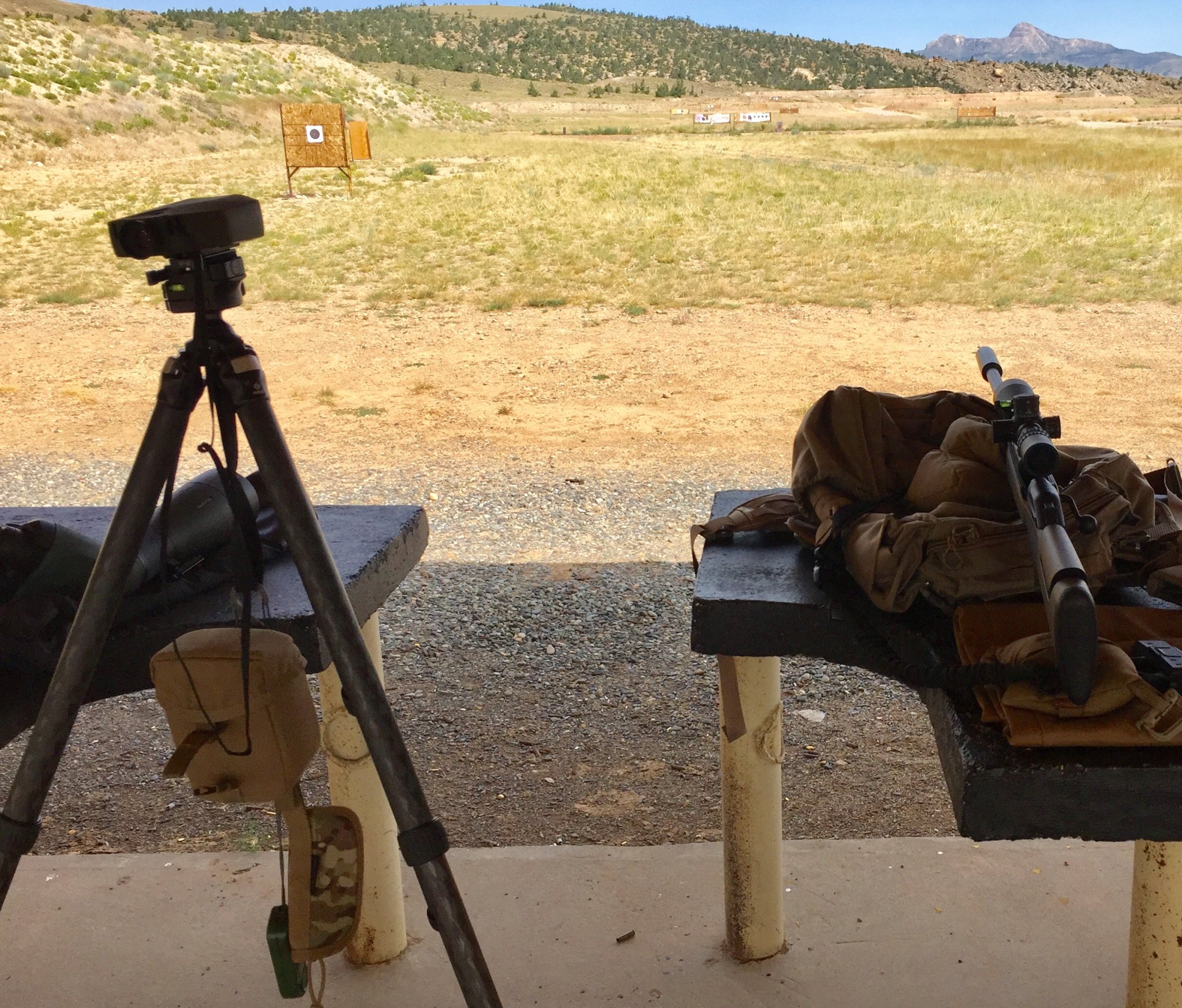

Had a few minutes today before an appointment in town, so went to the local range instead of my normal BLM playgrounds.
Threw my Blaser 300N on my pack, put the T-X on the tripod and confirmed to a 12” x 20 plate on our far hill @ 1147 yds. Typical goofy wind sweeping L-R across the rock face. Dialed a the 8.5 the K gave me and held off 1/2 mil. Bingo cold bore 1 shot centerpunch.

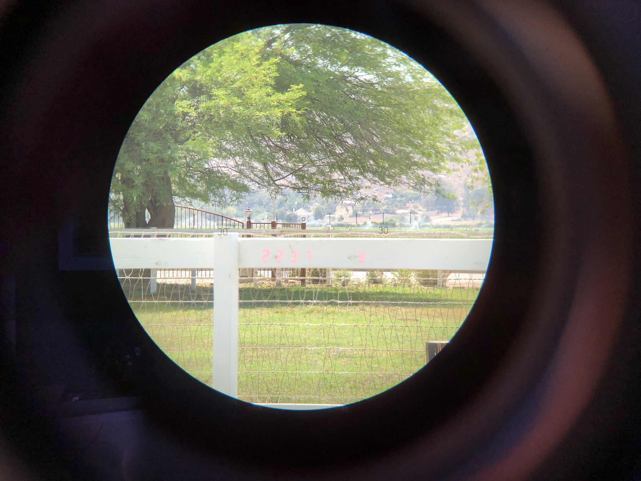

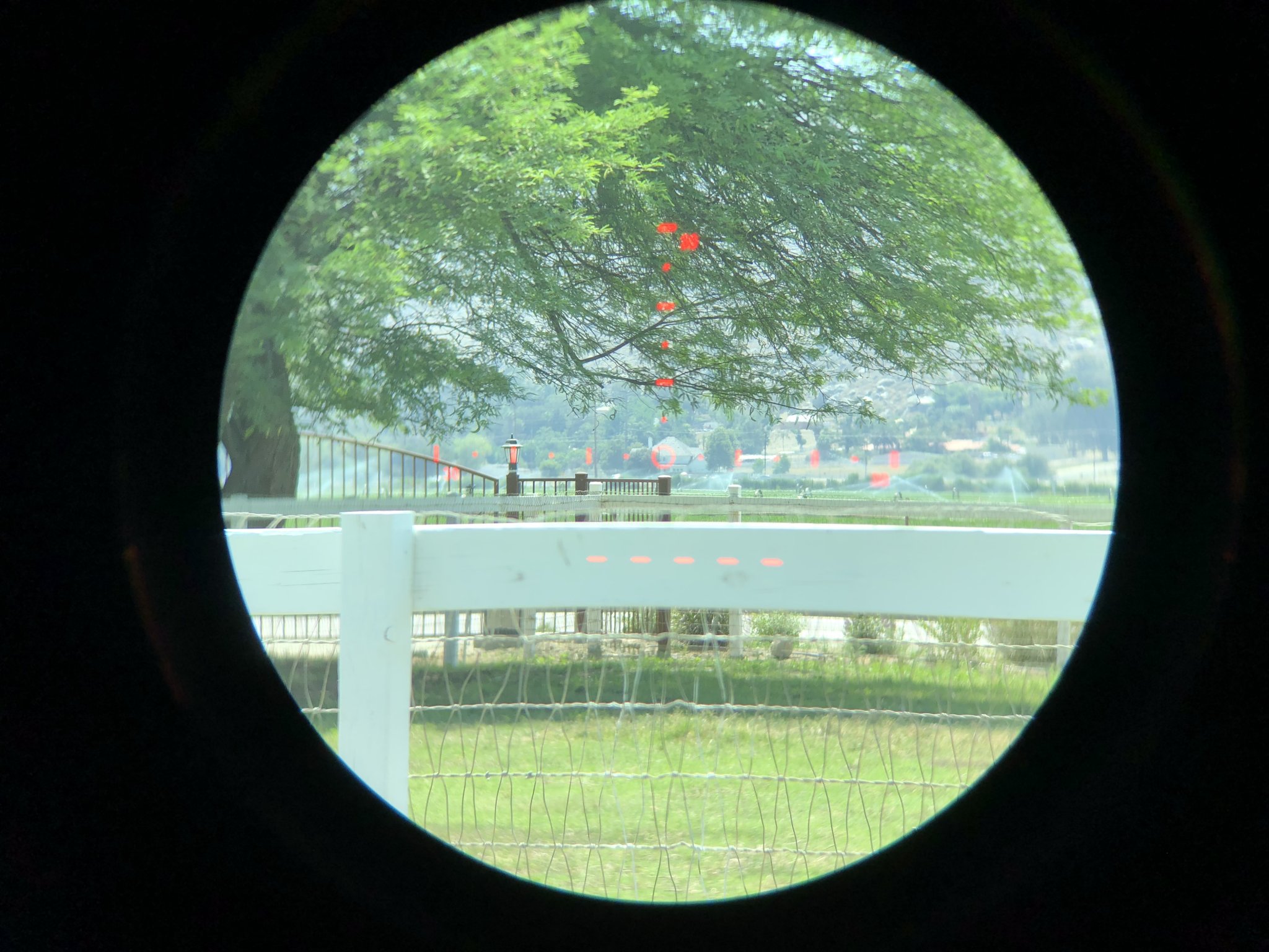

So I was able to get out and test the 2700B vs the Terrapin yesterday off a RRS tripod for both.
I have to say they are very similar. As previously stated it’s VERY Smoky in Nor Cal right now but first up was the 2700b off a tree at 2030 yards... was able to hit it reliably with every press of the button. Same goes for the terrapin.
Next I tried to hit some trees beyond that at 2200. The terrapin was able to hit it once out of 6 or 7 presses. I wasn’t able to tag it with the Leica. However I have hit trees to 2500 with the Leica on days where it was not so smoky.
Unfortunately there wasn’t any steel or animals out to try.
However I would have to say the terrapin is probably 200 yards or so better than the Leica as advertised.
Is it worth 900$? That’s up to you. The terrapin does have the cool ability to pair with your kestrel however I don’t really care about that myself. When I shoot a match there are 5 or 6 targets and I just need the distance.
Both have identical reticles and the glass is very similar. They are definitely both Leica products. The terrapin does have a 8x vs the 7x on the Leica and both are very good optically.
