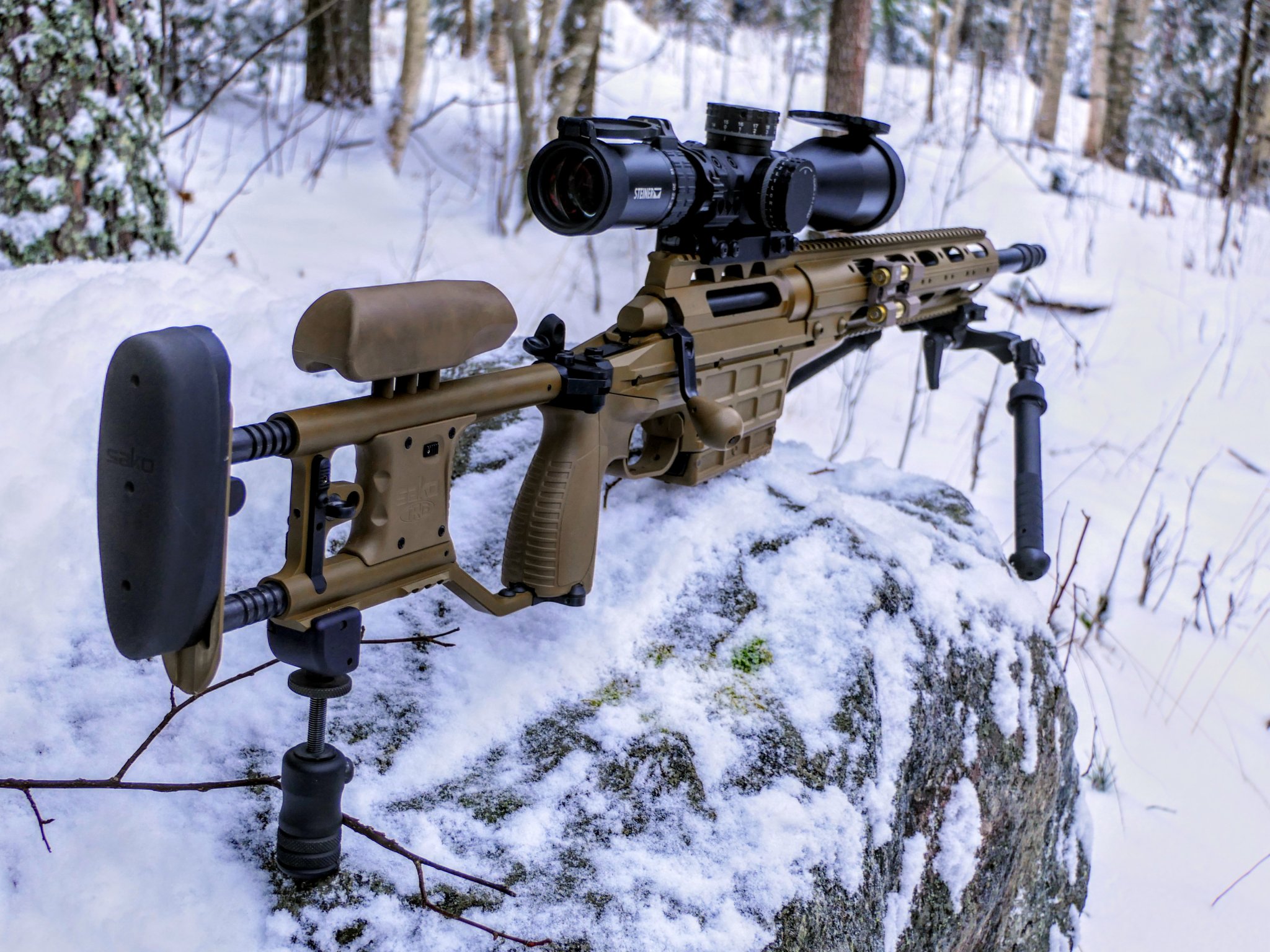

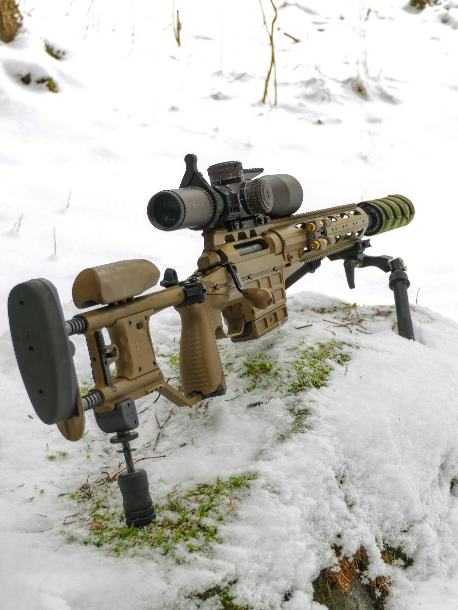

Received a JAKI titanium super suppressor.
Tomorrow taking test shots.
Vortex Razor HD II with Spuhr is too low, A4 paper did not fir between the bell and forend :D
Only some gunporn pictures manage to take.
Must go with Steiner M7Xi.

For those of you who have an M10, there is a guy that makes barrel bags and bolt pouches. He is starting to make magazine pouches as well. Everything has molle on the back so they can be hooked together. This makes it harder to forget to bring a bolt or magazine along with the barrel. His Hide alias is softcock. The quality and stitching is very good.
Reactions: Silvan and NiemiPT
