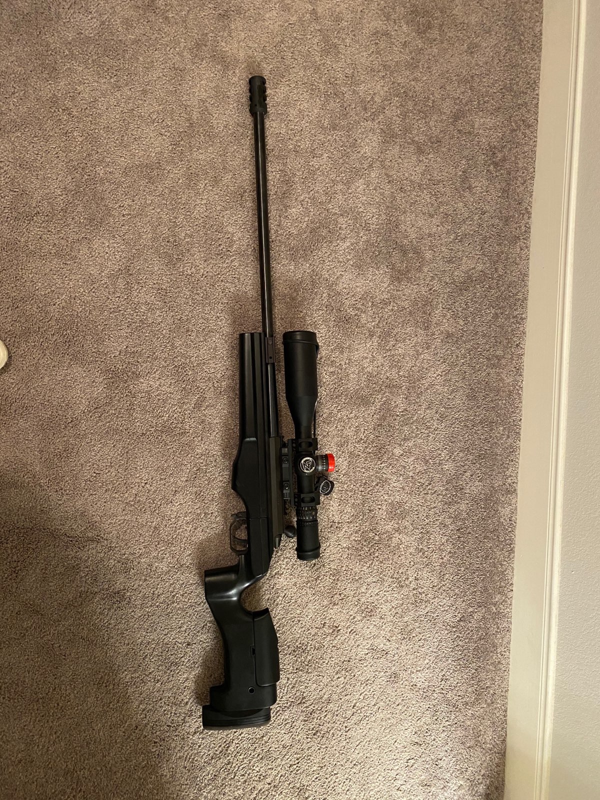

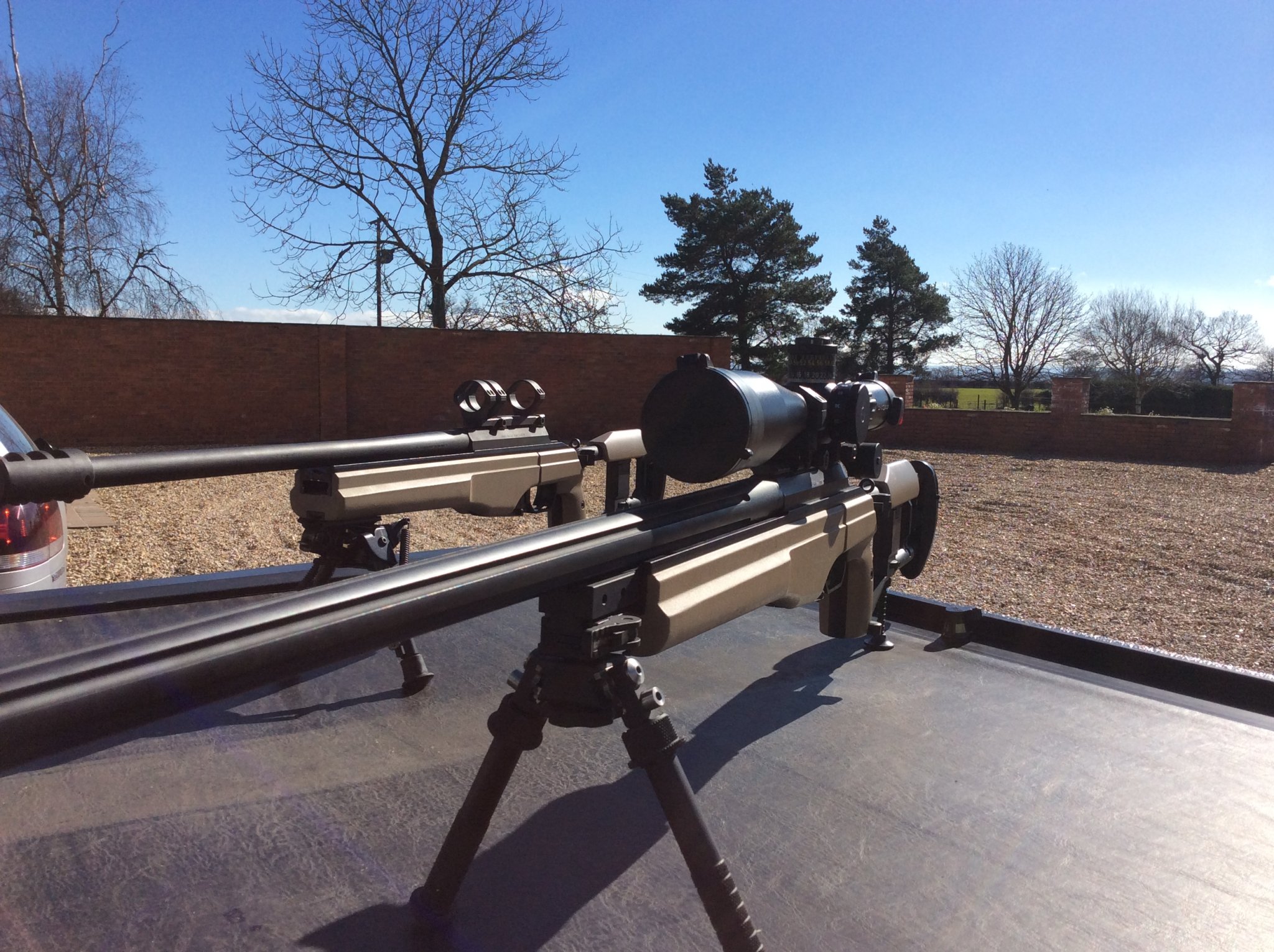

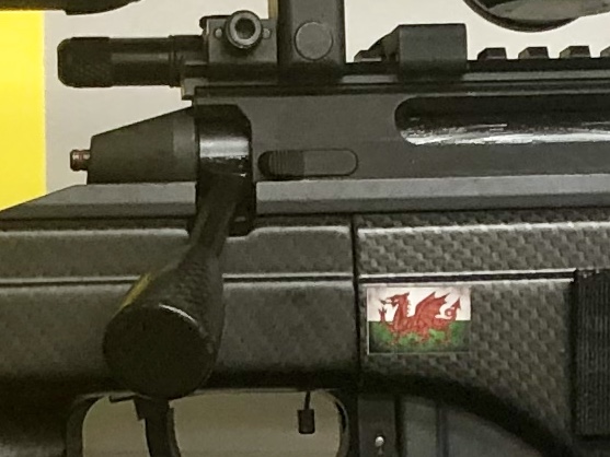

Only pic I have of it.
It's hard to tell from that pic. But the easiest way is by the safety lever. If it's thin and just a square tab on a flat metal piece that goes up into the trigger it's the original. If it's a wide wing that protrudes outside the trigger guard it's the second. You can also tell by the adjusting screws but that's a little more nuance.
It's probably a first as the second is made to be less likely to mess up with adjustments. You may be best off to call Beretta USA. I know of people who messed up the original trigger and said they had to send it out to be repaired.
I have owned and adjusted many of the original ones and never had a problem but it happens, hence the change.
From your description it's a gen1.
He hasn't shot this rifle much at all since he's had it. Previous owner reportedly shot less than three boxes through it. For those shooting factory barreled guns, do they seem to prefer the lighter bullets ? It shoots the 250's pretty good but it doesn't care for 300's.
So far he's used S&B 250gr, hornady precision hunter 285's I think, some flavor of berger elite hunter, can't recall what they were loaded with and prime 300gr.

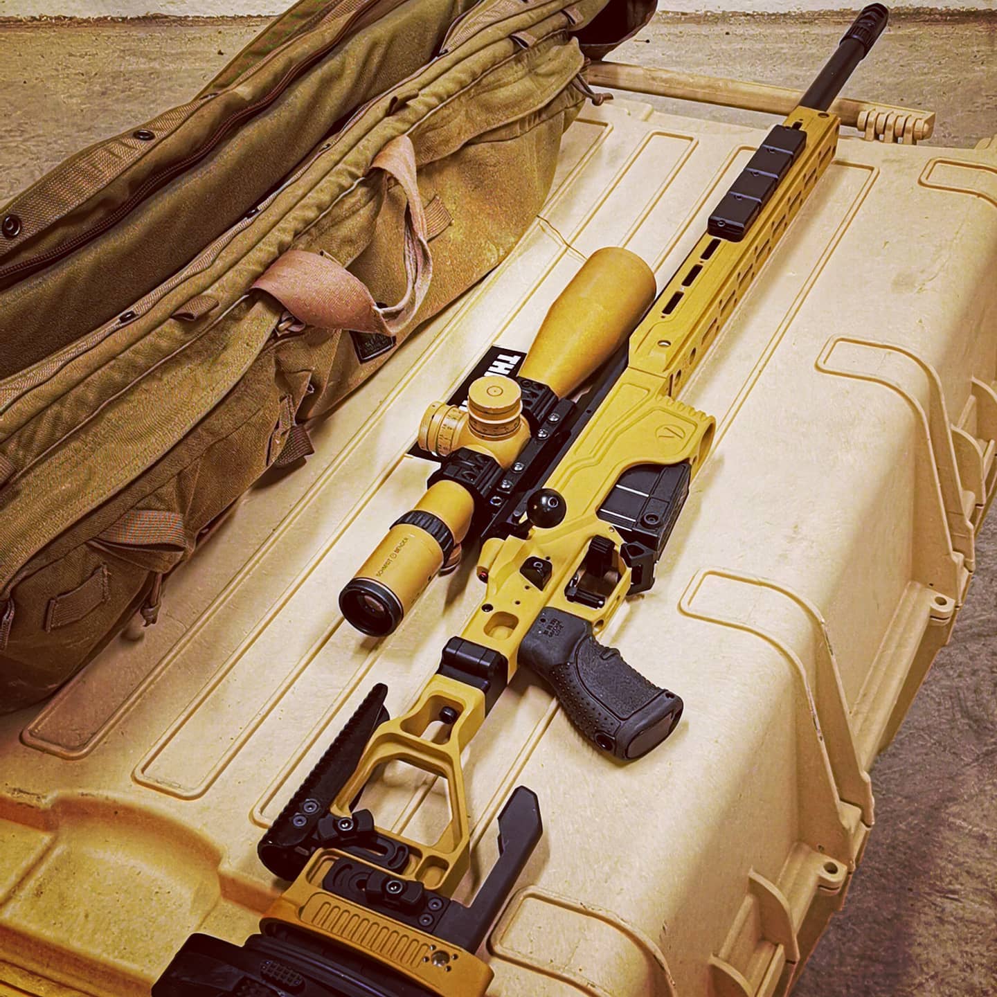

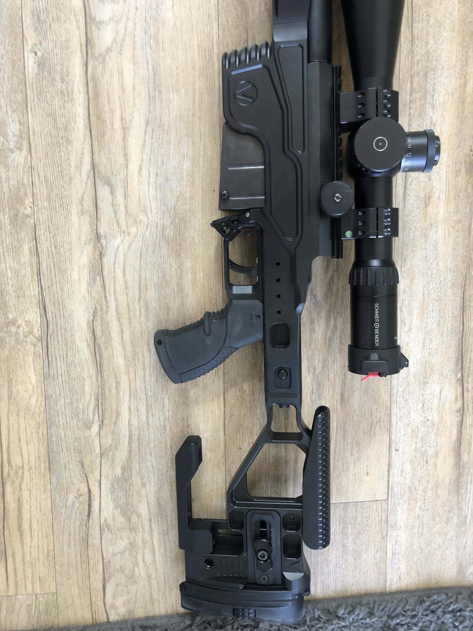

The Vision Chassis has some options for the TRG-22 and TRG-42, now stateside being sold through GCP Rifle Co in Florida!
The TRG-22 has the option for a full chassis replacement, and both the TRG-22 and TRG-42 have a replacement forend option.
Will the M995 TRG-S fit if you were able to swap out trigger and mags?
Unfortunately it will not work. Only the short action TRG-22 will work with the full Vision Chassis, there isn't a long action option for the full swap.

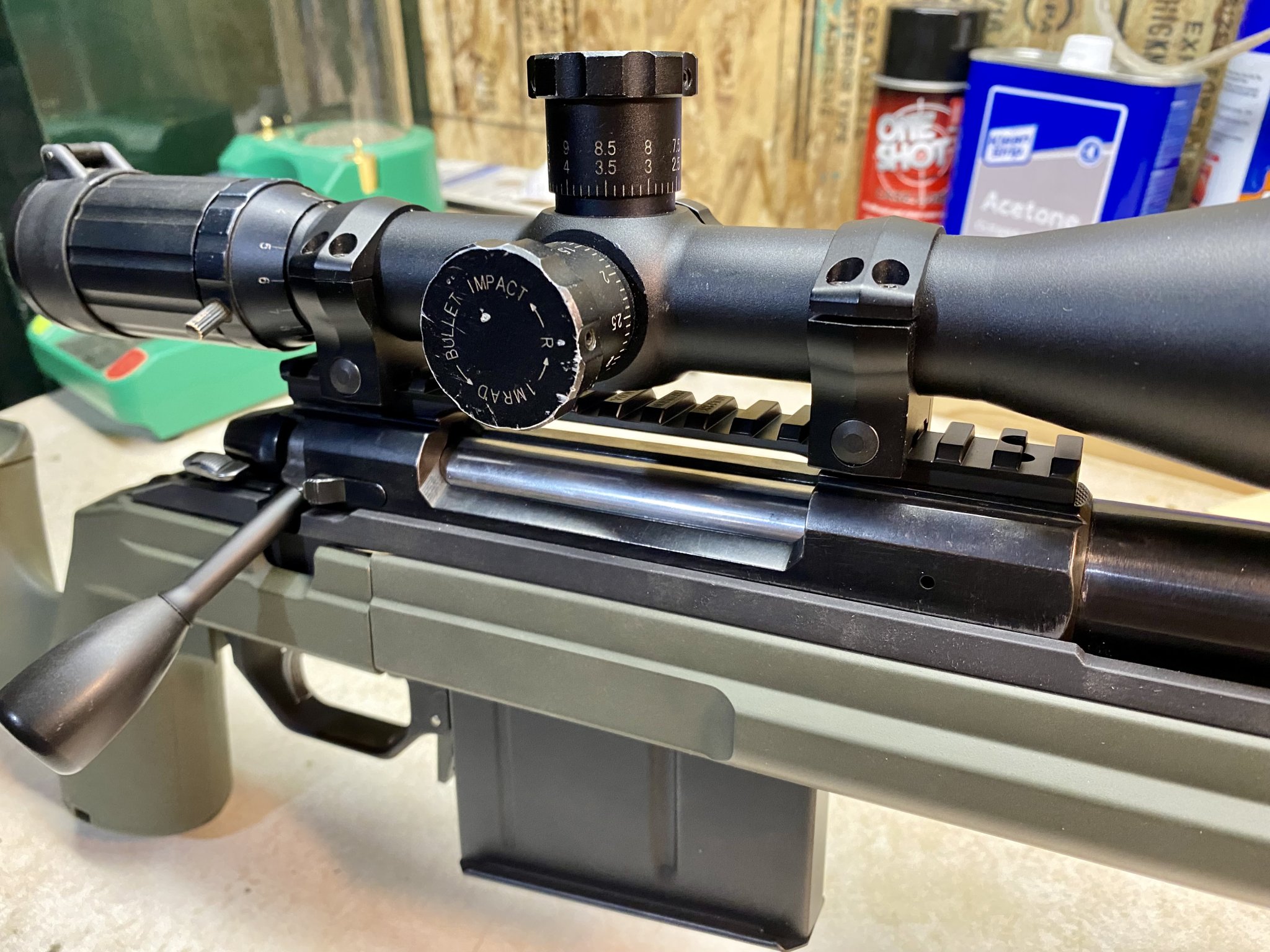

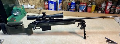

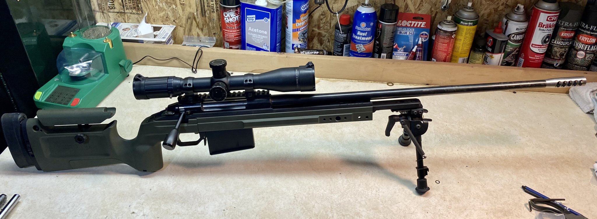

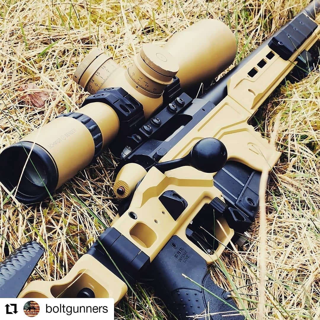

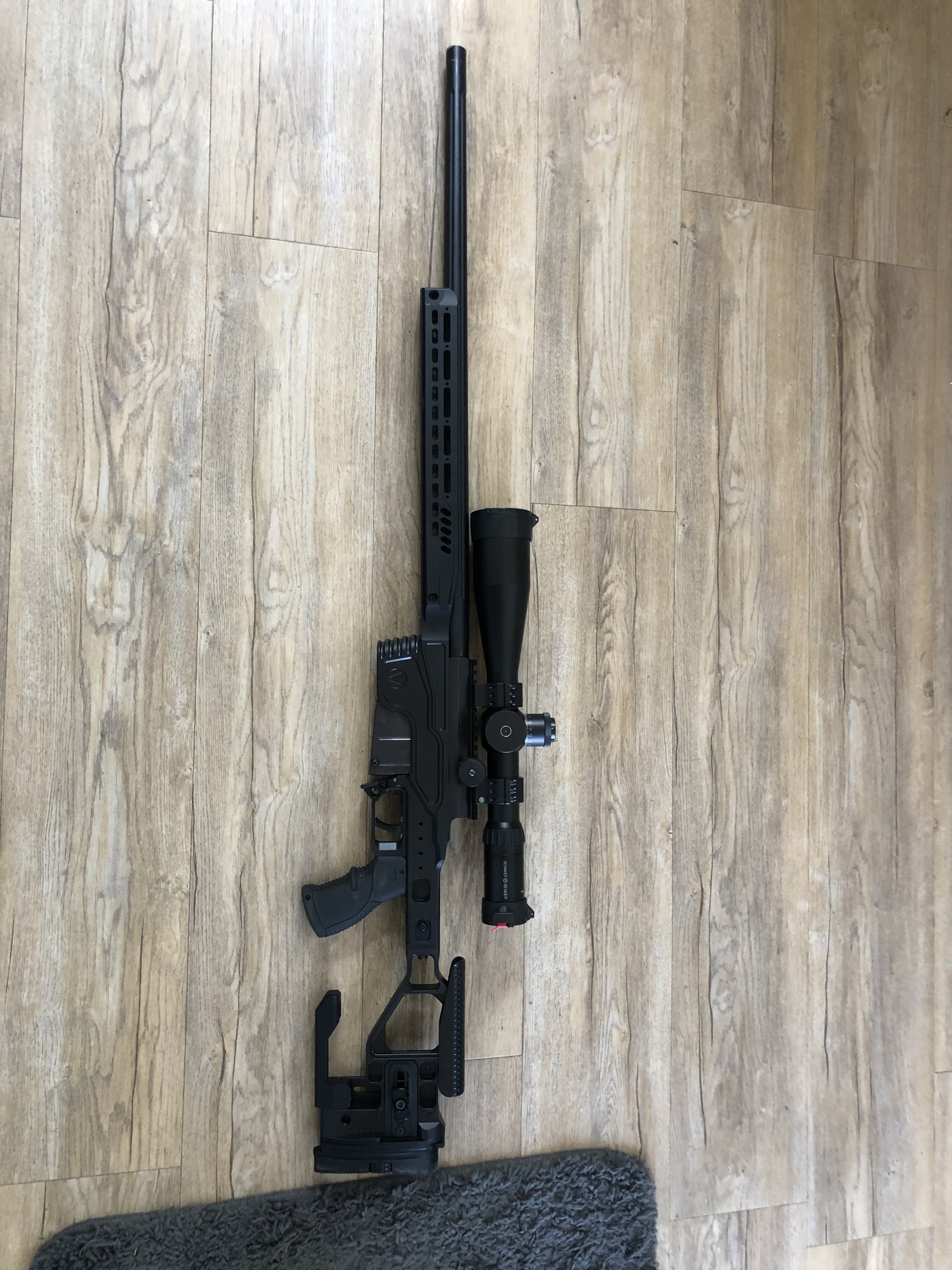

Finally put all of the pieces together for my poor man's TRG... I'm going to put a coat of Krylon on the factory barrel and brake for now, and then have the whole thing Cerakoted when I rebarrel to 338 NM. I just slapped the SWFA 3-15 on there to get a feel for the rifle, but not sure what I'll do long term for an optic.
The backstory: I got this M995 in the early spring for a pretty good deal with Redding Match dies and a pile of Lapua brass. Next, I picked up a KRG W3 and swapped rear ends +cash with a member on here to make it match my other Bravos. The rail was custom ordered from Murphy Precision, and I sent it along with an MBM brake that would blend with the factory taper to Long Rifles Inc to have the receiver drilled and tapped and the muzzle threaded and brake timed.
FWIW, it was my first time doing business with LRI (I sent along a Tikka barreled action for some work at the same time as this one), and they have one more loyal customer. Communication was top notch, prices were excellent, and the workmanship is outstanding.
Nice.
Did you simply swap out the rear for a Bravo rear?
I have the KRG W3 gen6 on mine, I like the look of yours much better.
Nice.
Yep, it's just a simple swap out. Takes 30 seconds or so.
I love the Bravo rear and the difference in value between it and the W3 folder helped offset some of my costs for this.
Reactions: buggz

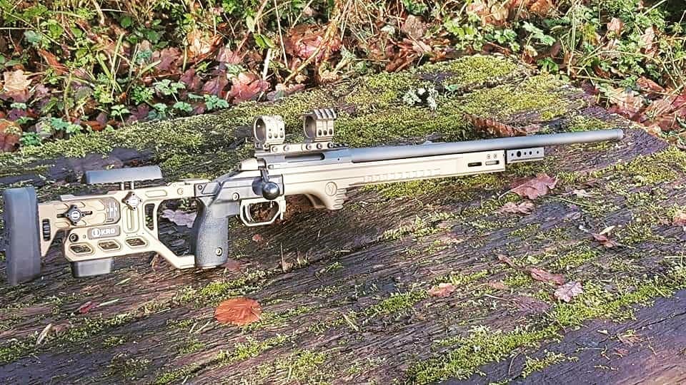

Thanks, I want to get a rail like you have, and a longer/heavier barrel.
Is the TRG-22, and TRG-42 stock mount the same as a TRG-S M995?
The KRG W3 instruction kind of elude to it when I put mine together.
But, doesn't come out and say it definitively.

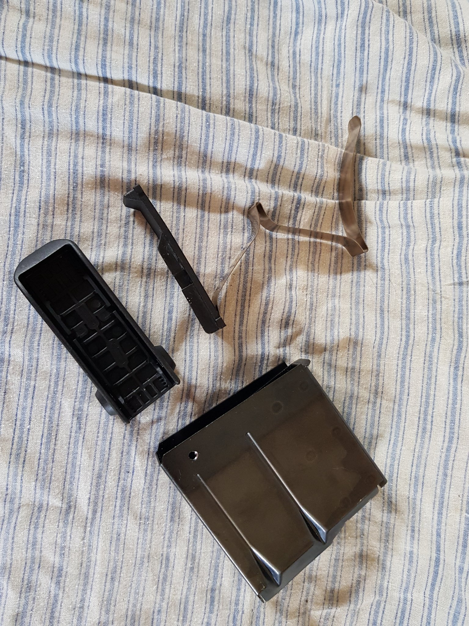

What are you asking?

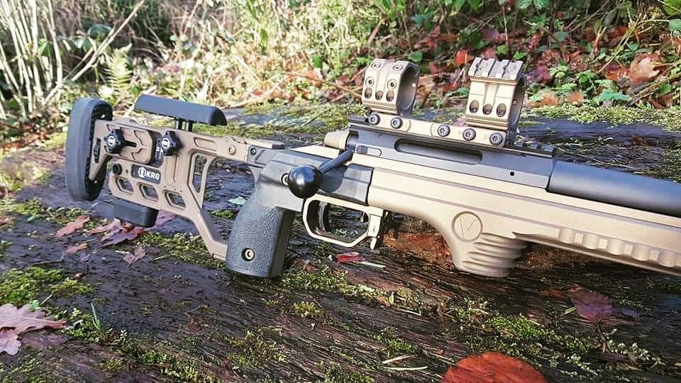

The trg-s is a 42 action with the top milled off.
The 22 is 20 mm shorter.
The trg-s fits in a 42 stock (as per pics posted above), but needs a trigger guard/mag release which KRG provides with the trg-s W3 chassis.
Reactions: buggz

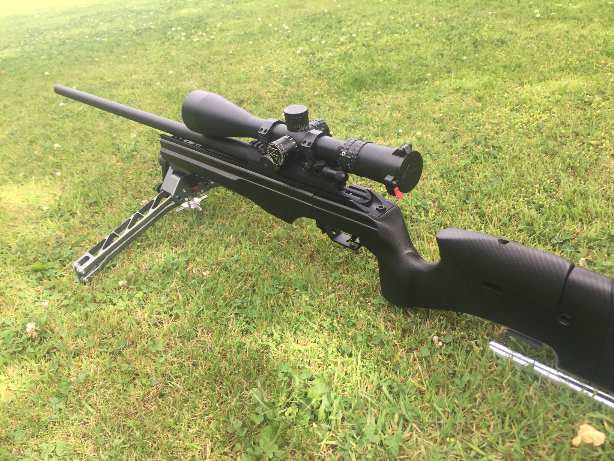

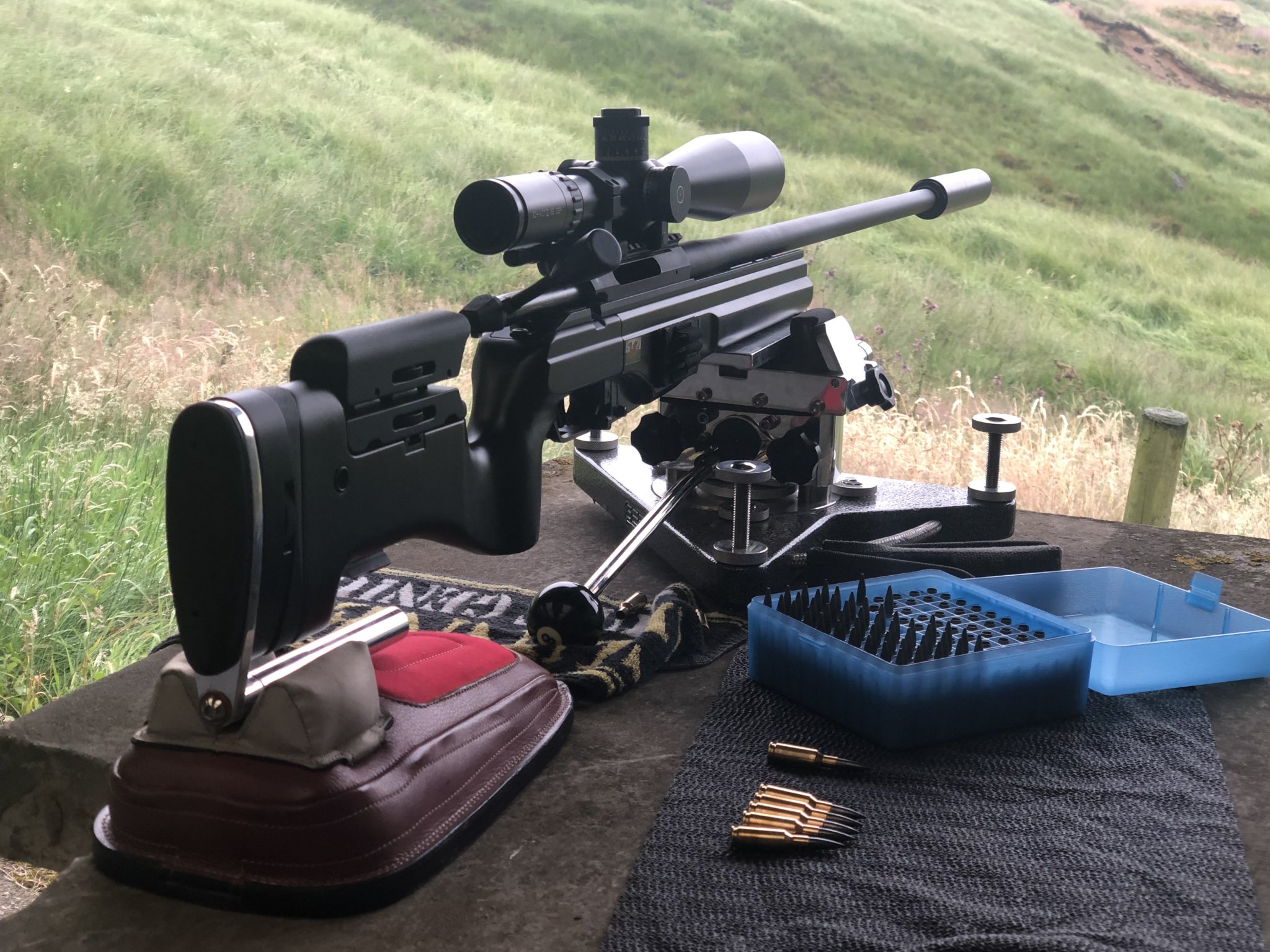

Trg 22, rebarrelled in 6.5x47 and 6br
Trying out a vision chassis on the br.
