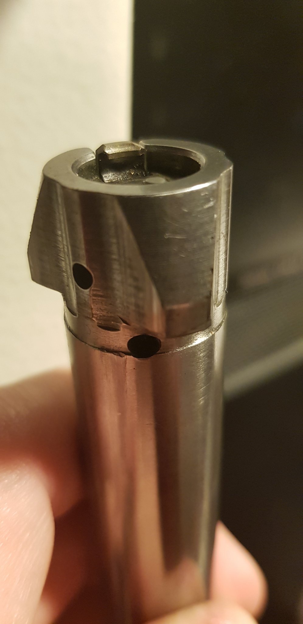

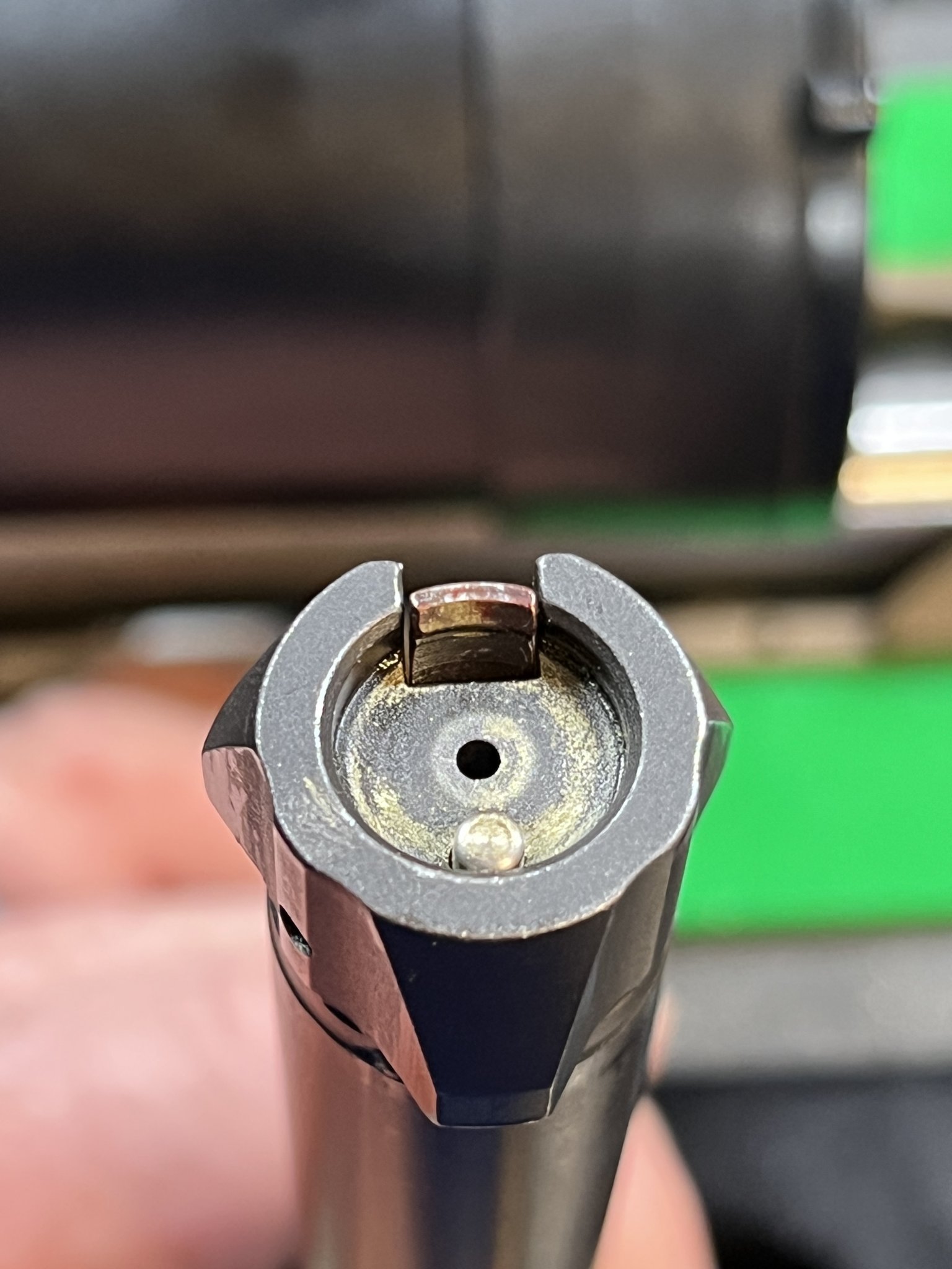

    Hard to tell but the extractor looks kind of rounded and worn? Like when it doesnt have much bite into the case rim and it can just roll off.
    By hand, can you slide a case under it, rock it back to depress the ejector (or remove it if you are feeling motivated today) and pull forward to put tension on the case rim with the extractor and not have it slip out from under the extractor? If its wornand rolled over I can see how speed is the only thing that keeps the case moving backwards before falling out.

    That doesn't look like a brand new extractor to me, but your camera might be what causes it?

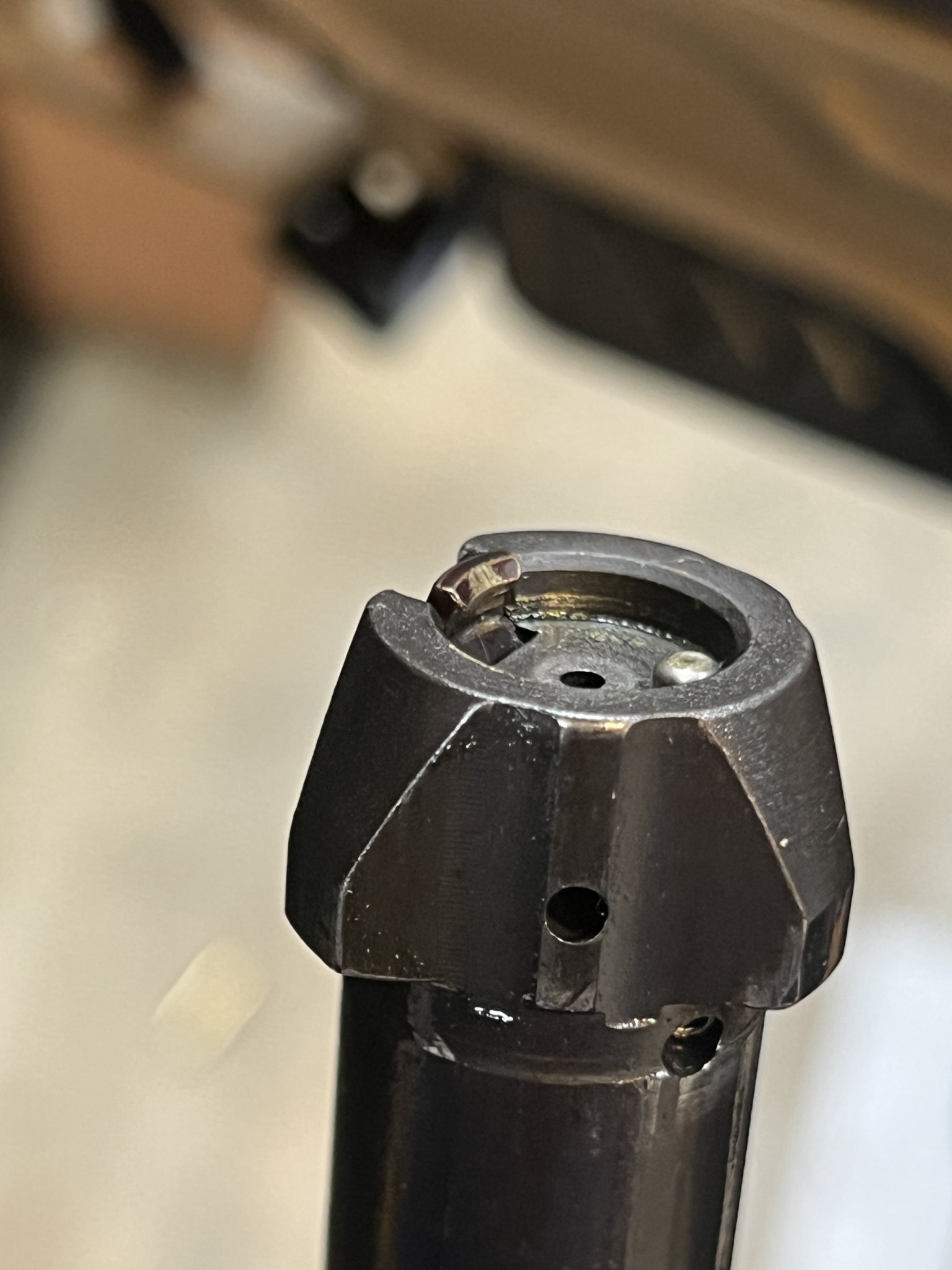

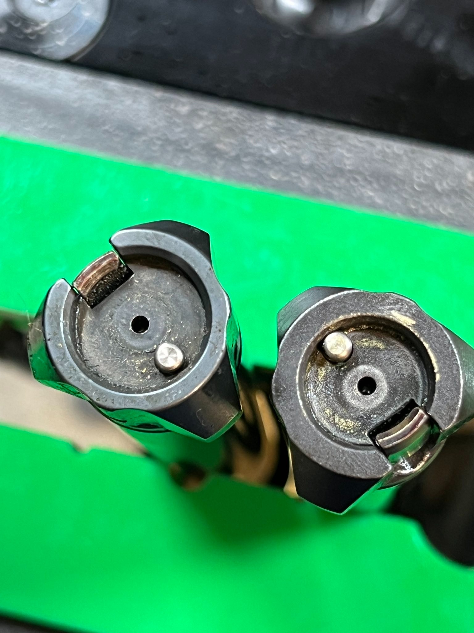

    This is my <500 rounds 22
    This is my >5000 rounds M995
    They are certainly different extractors. Humph. You keep yours cleaner than I do. (I actually haven't cleaned it since the last shoot.)
    Mine is not stainless either... heh.
    I'm not so sure they are different...
    Not as clean as they could be.
    No, not stainless (nor spotless). The M995 is a Sporter and came with a polished bolt from the factory.
    But your bolt faces seem a bit too grimy?
    I was thinking the smaller neck of the CM was the culprit letting the case angle a bit more than a 308 case would, but the 22 was sold in 260 Rem so.
    Try to clean your bolt face on the 22 and make sure all dirt is gone (it looks a bit concave too, but again your camera). Especially around the edge. With enough build up the extractor won't get a firm grip and might slip...

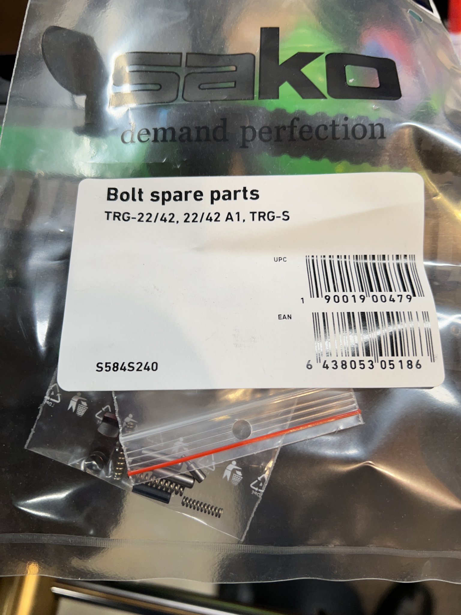

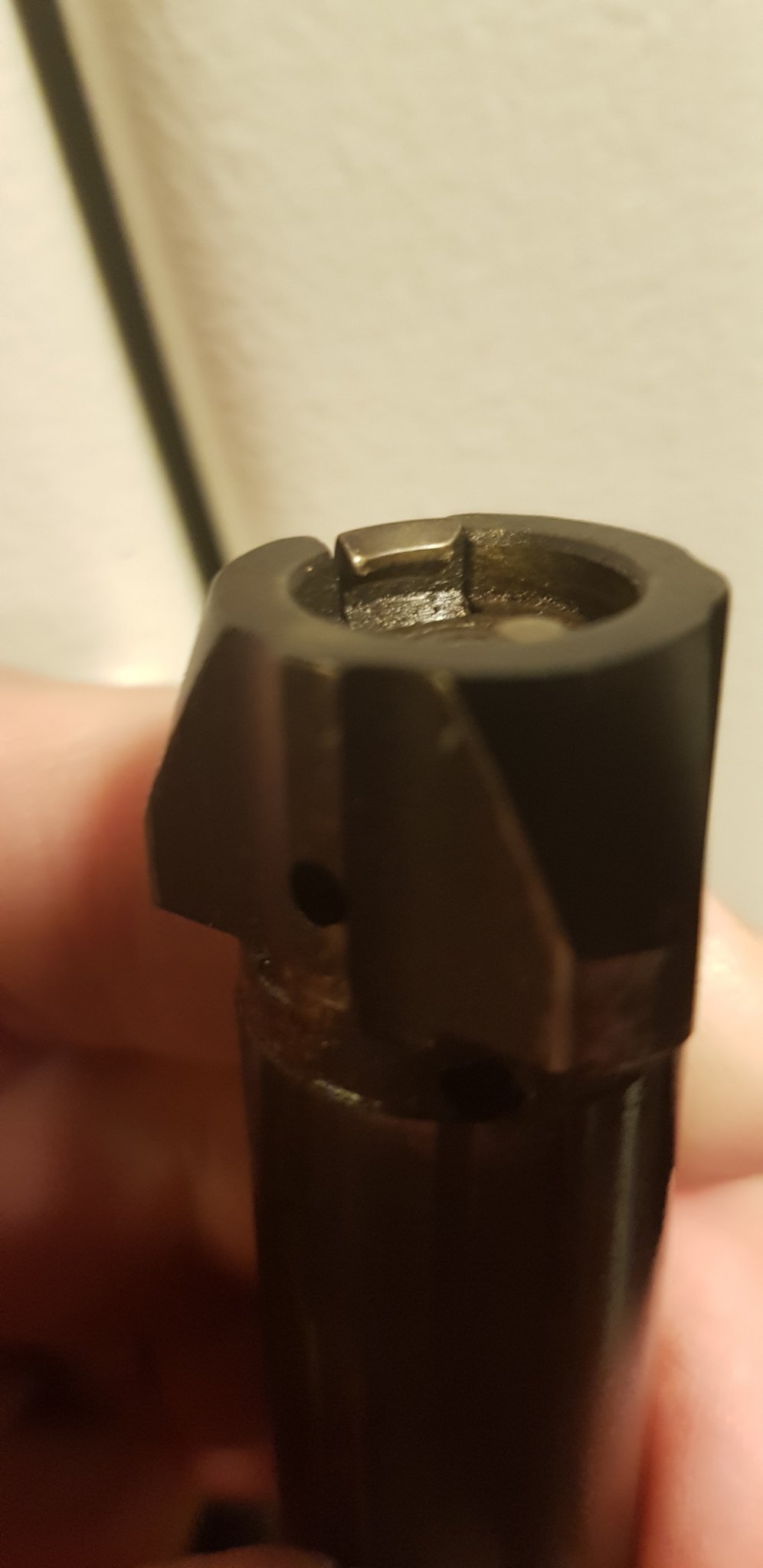

    I went in the parts bin and took a look to see if I had a parts kit for the bolt…
    Broke a two screw drivers trying to get that bastard of a extractor out…
    Decided that, as far as I’m concerned, Putin can have Finland, or at least nuke the shit out of it.

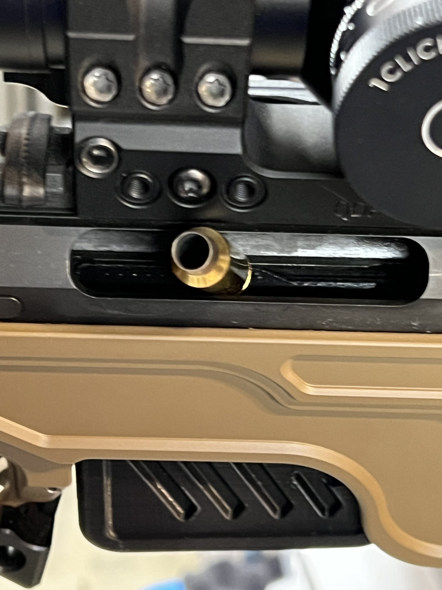

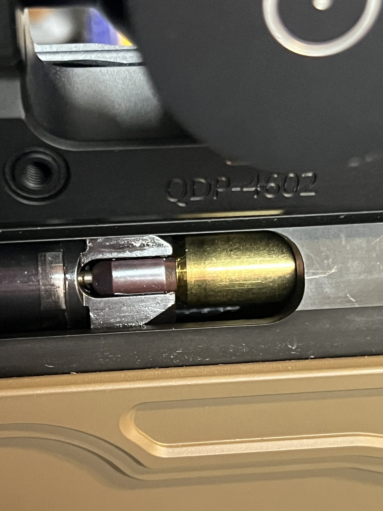

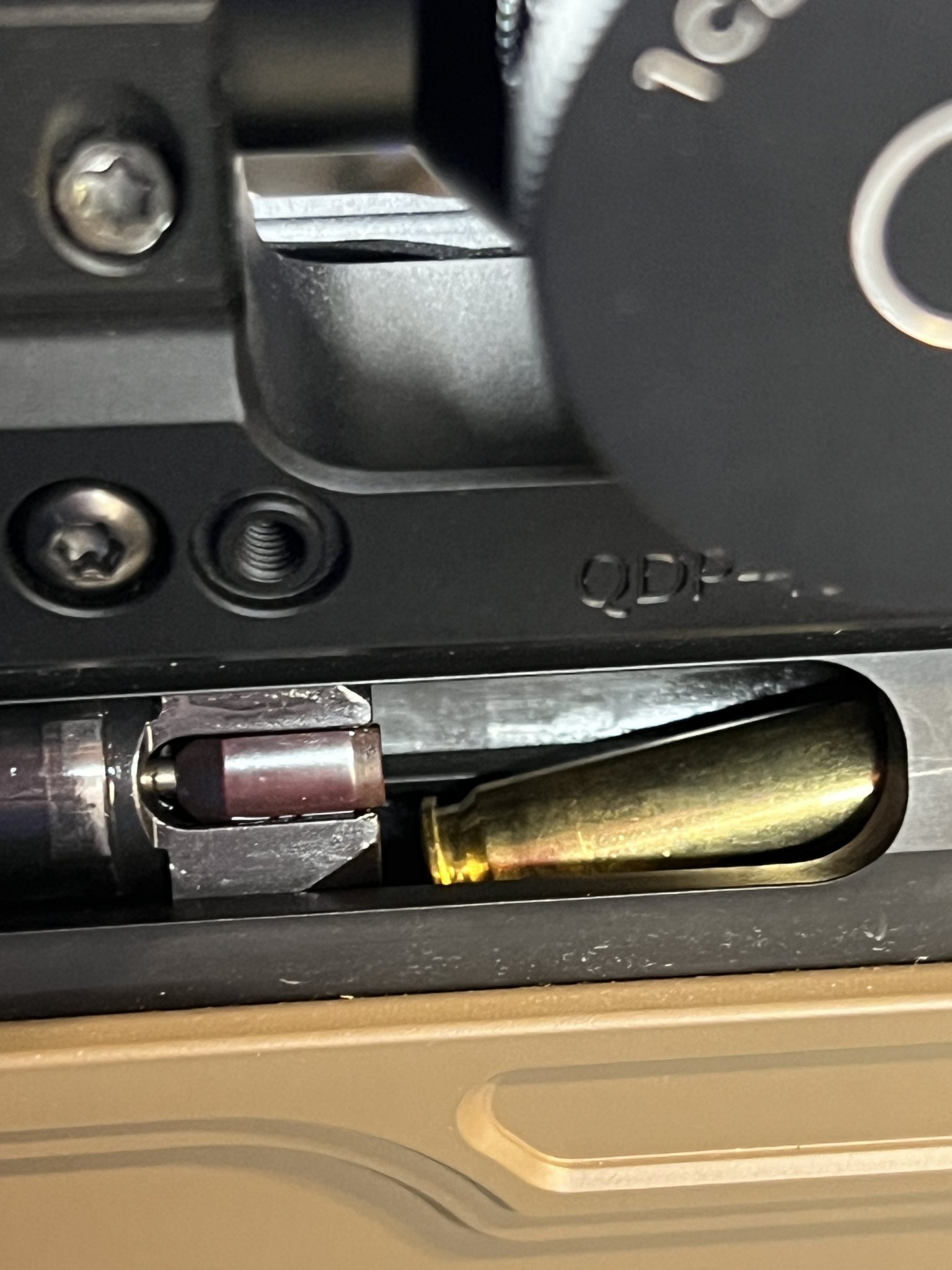

    ….And eventually got everything put back together:
    Basically, now if I pull the bolt back in any sort of a slow manner, it’s stove pipes. (which is much better than leaving the cartridge in the actual action.)
    And it absolutely ejects with medium force and serious force every time you cycle it…
    Even though I had previously replaced the ejector spring, the new one is significantly harder to push in… And the new extractor has sharper edges. (I’m positive I replaced it before, so I’m confused as to why it wore so quickly with only a few hundred rounds.)
    One of the interesting thing with the kit is that it comes with two ejectors...
    That’s cuz the new TRG42 has twin ejectors. I think what’s causing the poor ejection is the small ejection port. The case drags on it and loses its momentum. If you pull the bolt back too slow the ejection port will suck the case back in, lol.
    View attachment 7970740View attachment 7970741View attachment 7970742
    So all is well then?
    Stovepipes? Stays in the ejection port?
    Two ejectors are for the 338LM.
    How many springs comes wit the kit Maybe you took a wrong one last time?

    @CerebralDistortion All is a lot better; need to take the rifle to the range and run it through its paces. Nope, right spring for sure, they are obviously difference sizes. Though I had hoped it was something like that. Yeah, slow pulls now result in stove pipes… which is desirable compared to staying in the action.

    Size yes. Spring tension?
    Two springs can have same external but different "internal" dimensions. Wire gauge and number of coils are easy to miss at a glance. Both affect tension.
    Not really doubting you, just checking.
    Somewhere in the recesses of my mind I seem to recollect something about adding a second spring to the 338LM, the second spring being weaker as to not create a "friendly fire" situation when ejecting an empty cartridge.
    There is definitely a difference in spring tension with the ejector… The other ejector spring was absolutely weaker. I would say that maybe they put two different springs in the kit but that wouldn’t make any sense given the fact that they give you two ejectors.
    On the other hand the extractor Steve basically the same with the exception of slightly cleaner edges on the extractor part itself.
