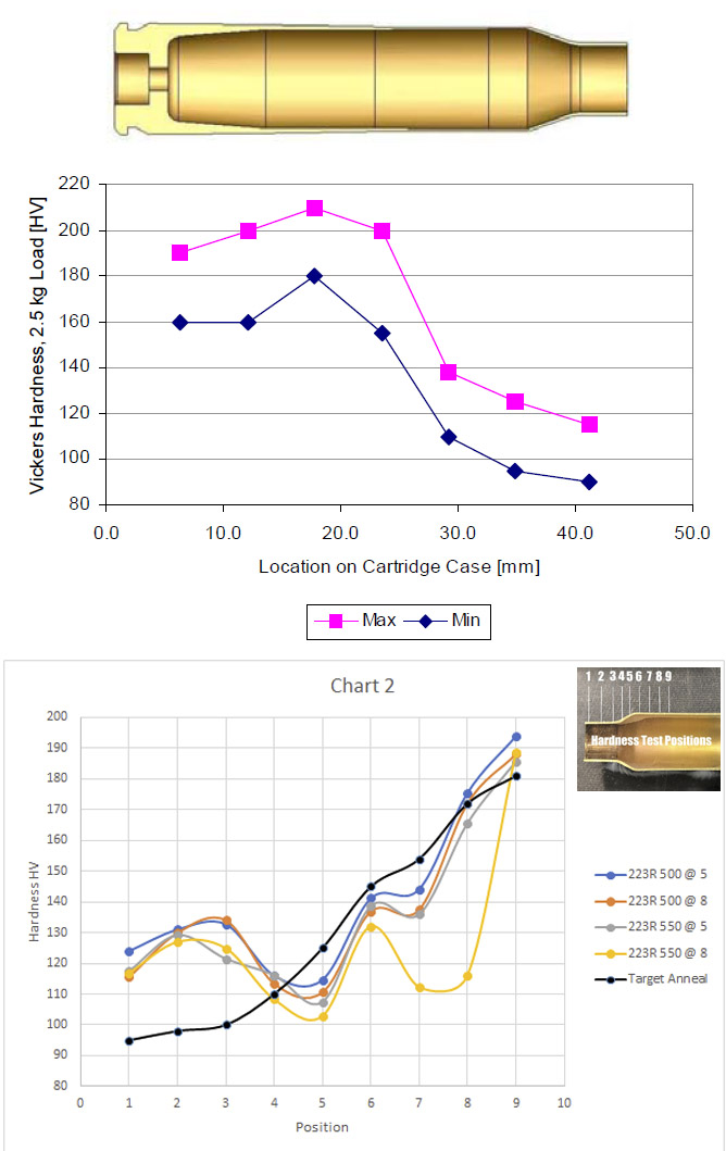

I read the write up and it says they used a Hornady die and the neck hardness went from 95HV to 140 HV if I read it correctly?
Further along it said anything above 120 HV is useless again if I read it correctly?

The link below is the armys hardness testing of M855 case base. Figure 1 shows the minimum and
maximum allowable Vickers hardness at various case locations.
Not sure enough people caught this.....
If you compare the army's specifications for min/max hardness, to the results produced on 223 brass by SBA you see that SBA essentially cannot get below the maximum hardness standard for the neck of the case, while simultaneously producing case body softness that gets dangerously close to the minimum standard for brass softness.
So even if you ingore what AMP says the desired brass standard should be, it would appear that SBA cannot produce results that conform to the US Army standard for brass.

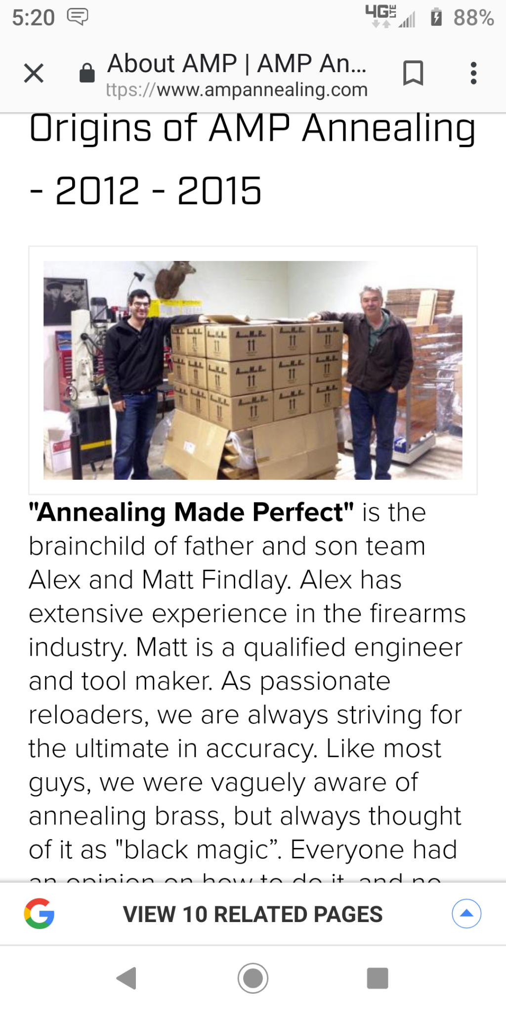

Do you know the credentials for the guys at AMP? I don’t.
I know the credentials for Al Harrell so it truly doesn't matter about the guy from AMP.
But since you asked here it is.
The tests are not the same AMP used a 500 gram load to test and the military used a 2.5 kg load.
Not sure how the load difference affects the results.
Credentials for AMP.
