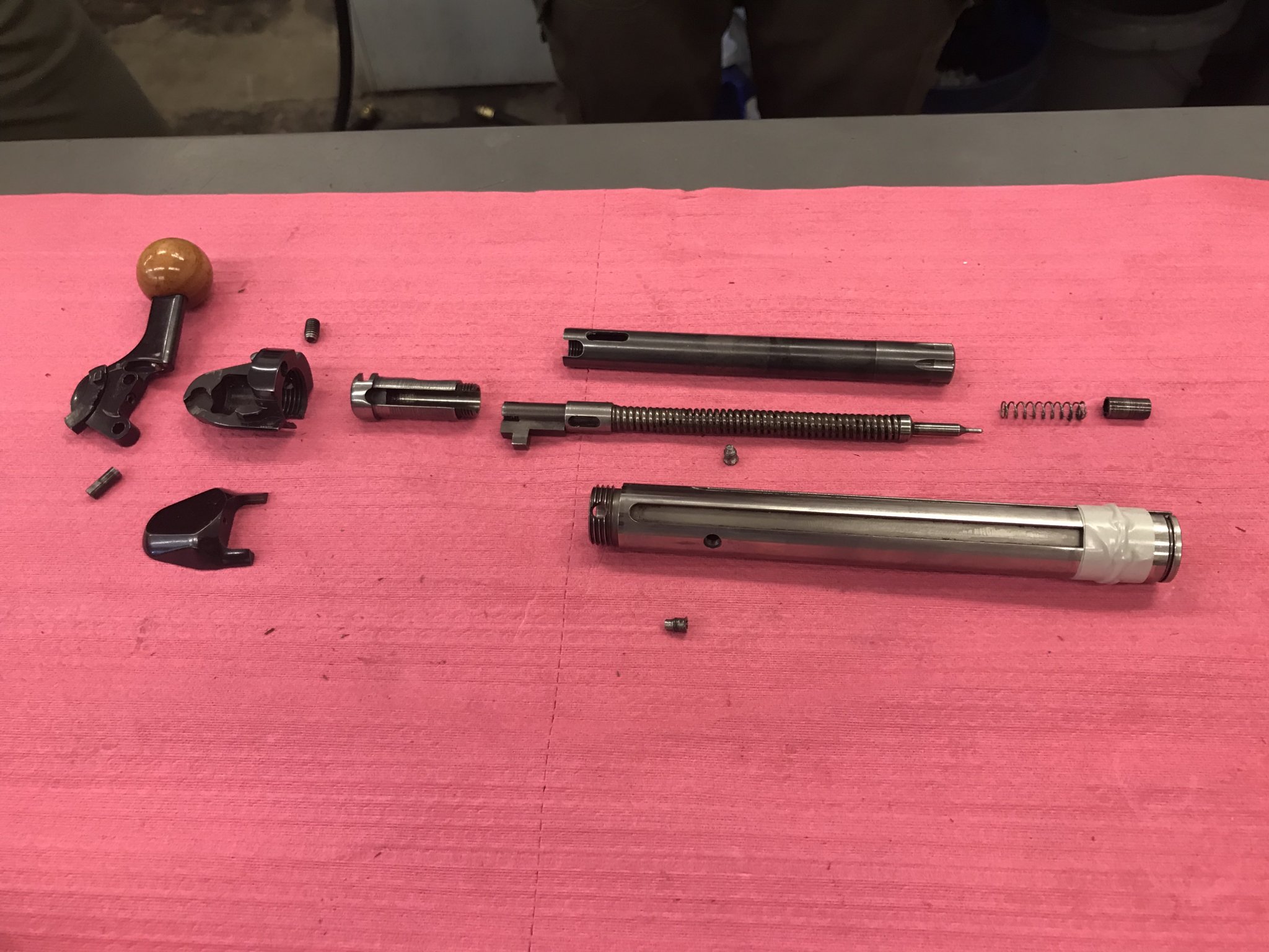

It's been a long time since I took my K31 bolt apart but I don't remember any ball bearings? Just a non rotating bolt face surrounded by the sleeve with the lugs, turned by the helical cam groove. It's possible I forgot something though..
I only took apart the bolt once on the two I have. Once. 😂 Never again. But I recall the ball bearings, in a turned groove, and sliding sleeve, that forced the ball bearings into the groove, so the bolt could unlock. The "straight pull" handle/rod, just unlocked the sleeve.
It's been a few years, but I remember taking it apart, getting a call that had me flying out of the country on short notice, and coming back home two weeks later, staring at a zip lock bag of bolt parts thinking "How TF did this thing go together?".
Like I said, never again. 😂

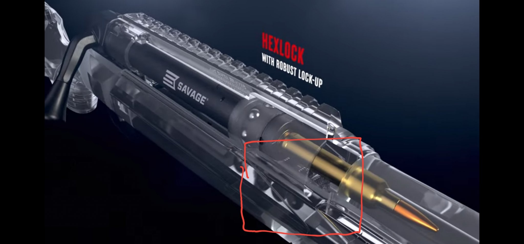

One video says the 20MOA rail is machined into the aluminum receiver. Aluminum receiver? So do the hex lock bearings engage in a steel ring or barrel extension? Just trying to wrap my head around this. At that price might be worth at least playing around with one. I don’t mind accutriggers so ok with that part and looks like it actually throws brass out of the side with some force
Reactions: Davo308 and 346ci
What is going on here in red? I know nothing about straight pull, but looking at this, looks like three screws going through the barrel tenon.
I just watched the video again for like the 5th time. I know it's hard to tell, but the barrel/action doesn't look like any other size than what they typically offer.

I wouldn't worry. K-31's have been around over a hundred dred years, and I haven't heard of one of those wearing out.
Not quite, but getting close, K 31 was first fielded I think in 1933, design standardized in 1931, So really around for only 87 years. One of my favorite milsurp rifles, I have six, along with an earlier 1911 Schmit RUbin
I have six of these, plus a 1911 Schmit Rubin and have never seen any ball bearings. You described it pretty well, functions much like a M1, or AR15 for that matter, just manually operated instead of gas powered.
