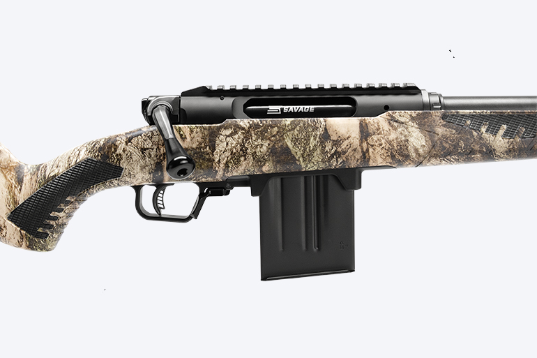

I had no illusions about this design fitting an existing inlet. There's more space between trigger and magazine, and the barrel extension adds bulk to the front end. If the extension design accepts current prefit barrels, that's a big enough compatibility win for me.
It shouldn't be too big a trick for someone like MDT/Oryx to accommodate the new inlet.

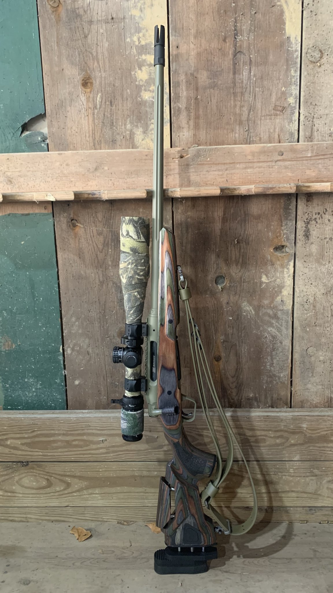

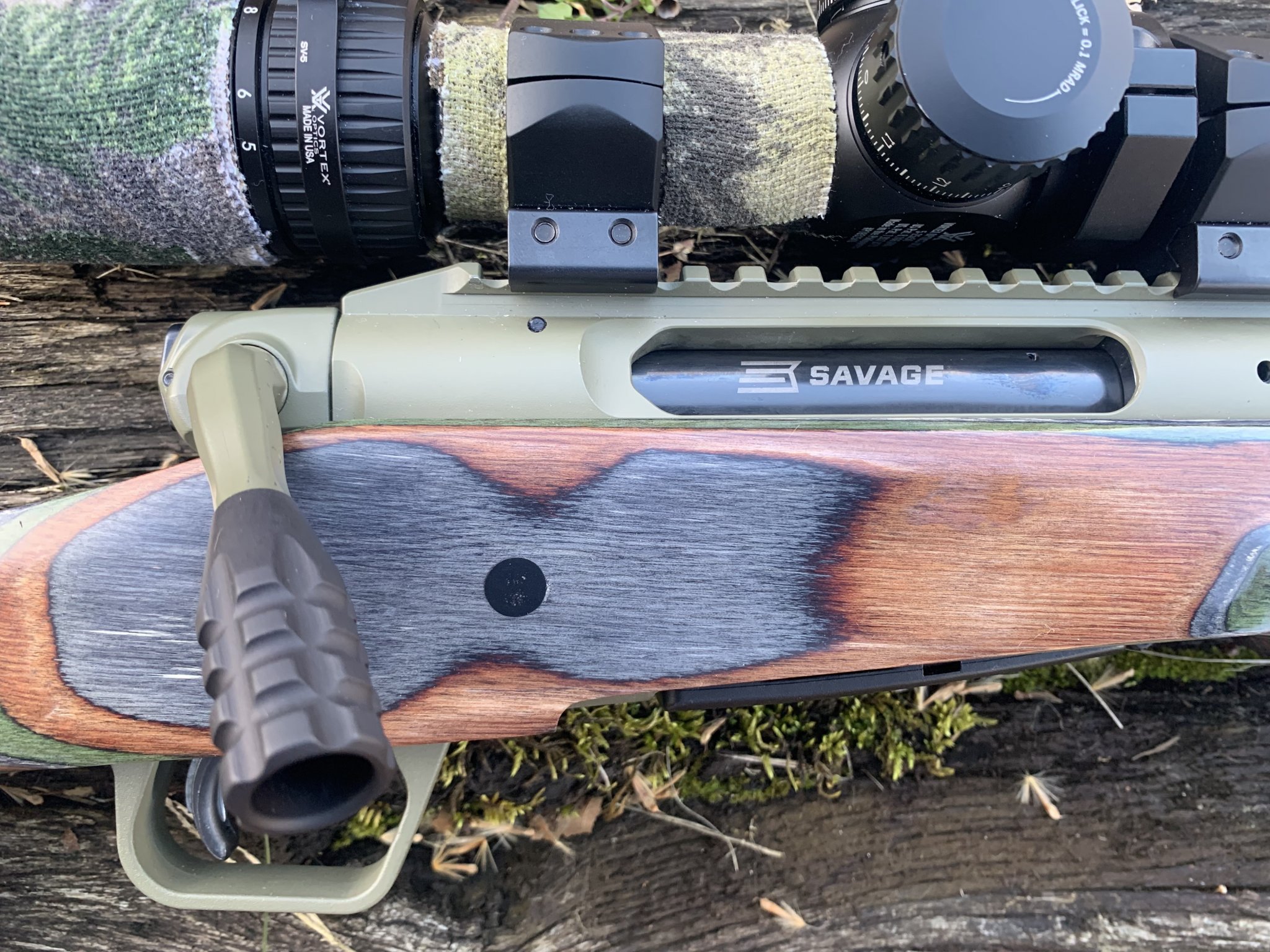

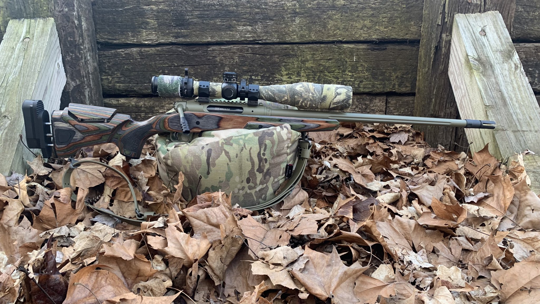

I posted these photos elsewhere on the Hide. So forgive me if this is repeat information for some of you.
Savage Impulse Big Game rifle.
6.5 Creedmoor Hornady 147 ELDM / Avg MV 2700 FPS
Vortex Viper PST 5-25X
Burris Signature rings
Boyd's Agility rifle stock
Boyd's Agility vertical adjustment butt plate with 1" rubber butt pad

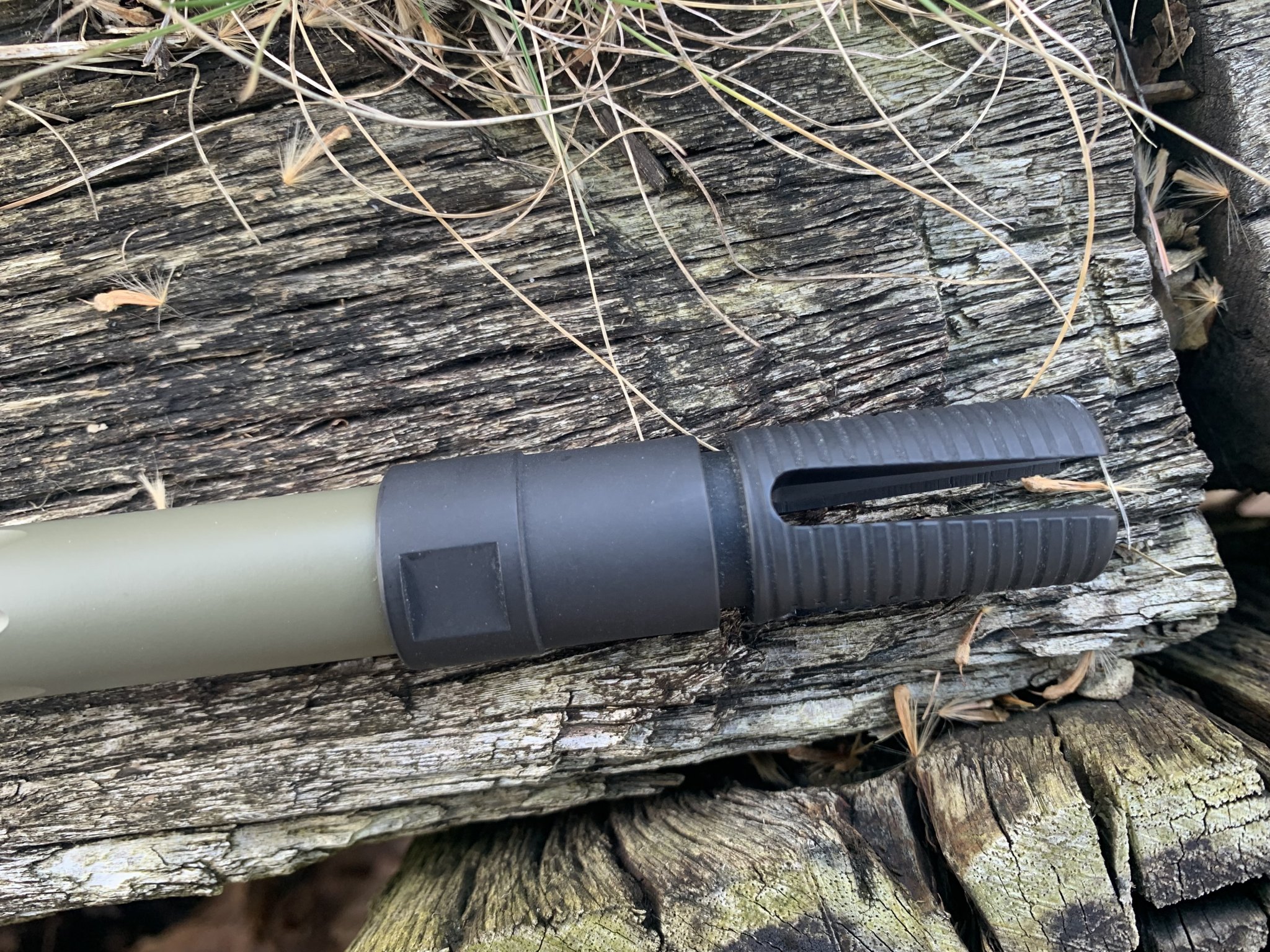

Smith Enterprises flash hider
Turner Biothane sling
I forgot where I got the after-market bold handle knob.

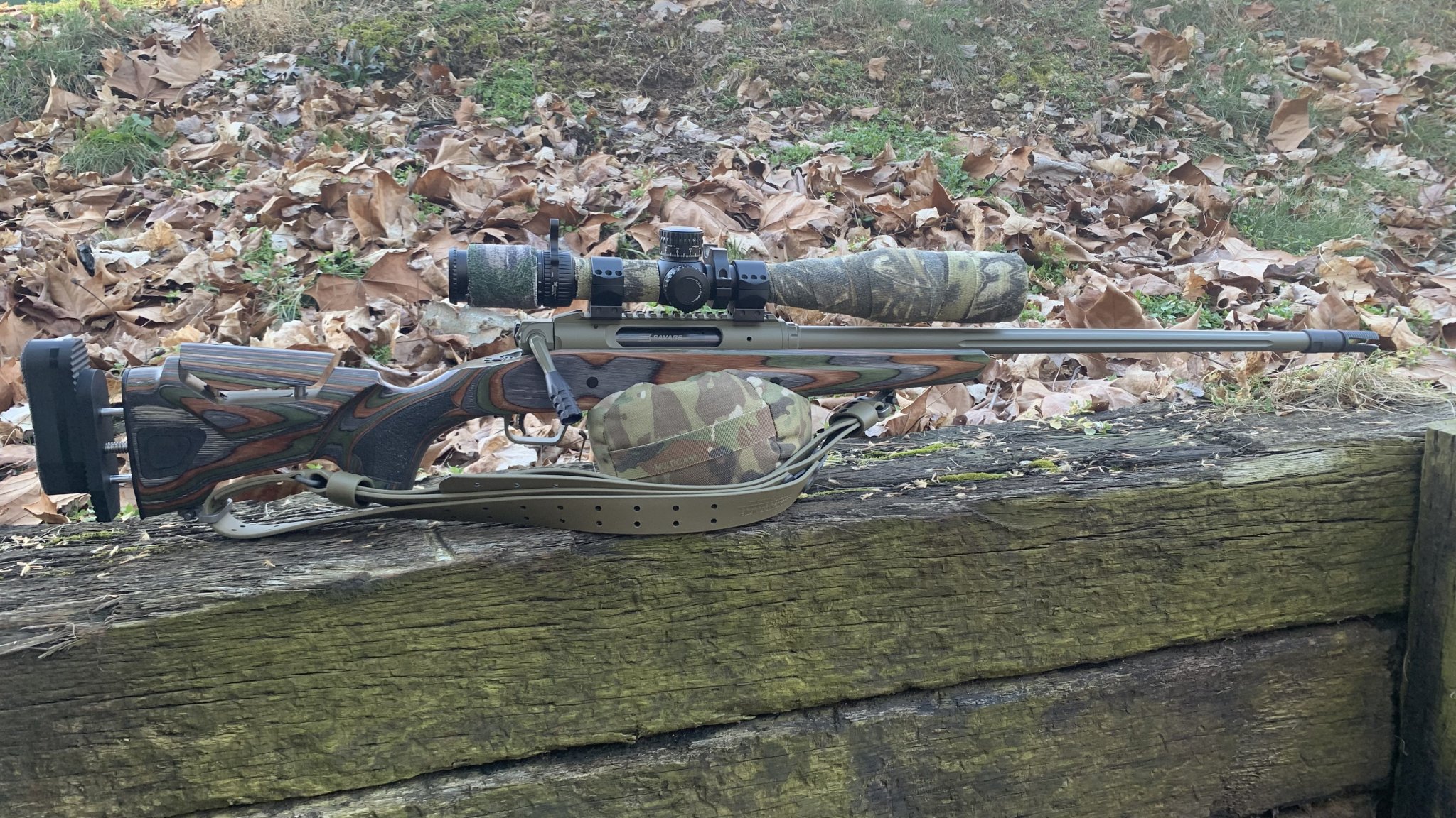

How is that bedded? Is it pillar bedded or what?
There is a pillar bedding for the rear action screw only. The wood at the front action screw is too thin to accommodate any pillar bedding.
I did have to add a piece of metal shim stock between the bottom metal and the wood at the front action screw. Otherwise, the magazine catch would not go over the lip of the magazine to hold it in place.
I needed to remove some wood in the magazine well with a file to permit easy insertion and the dropping of the magazine.
I've installed several Boyd's stocks and minor fitting is to be expected.

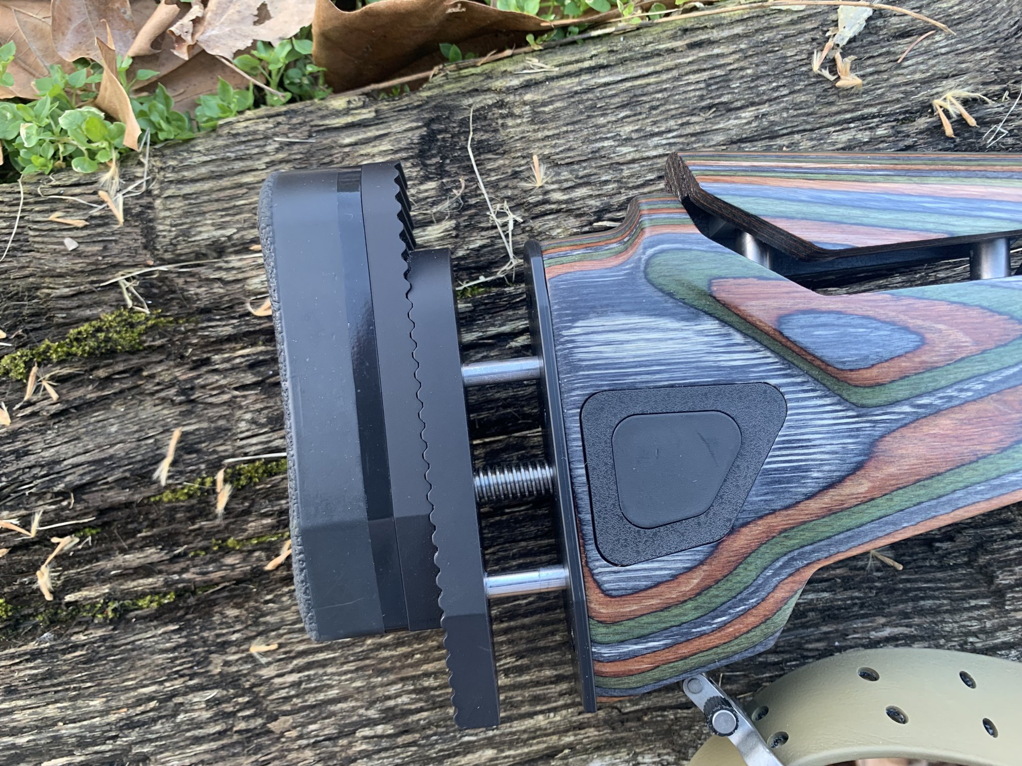

I wish I could get the cheek piece up higher but that's probably me. Some other guys that have looked at it, don't have a problem with the cheek piece.
The rifle is very muzzle heavy with the OEM stock. This stock, although heavier, balances the rifle comfortably. If someone wanted to keep the OEM stock and needed to keep it balanced they would have to add weight to the rear of the stock.
I tried putting a suppressor on it but with the low rings it gets in the field of view of the scope. Extra high rings did help with keeping the suppressor out of the field of view. However, I could not get a good cheek weld like a typical chassis equipped rifle with an adjustable cheek piece.
Oh well, I've hunted without suppressed rifles before, I can do it again. Besides having a can with nothing to mount it on gives me an excuse to buy another rifle.
PS: The torque on the rear action screw is 55 in-lbs. The front action screw is torqued at 35 in-lbs.

Why the different torques on the action screws?
I use the higher torque setting for metal-to-metal contact. The rear action screw is the only one that is pillar bedded. So the bottom metal is pressing against the pillar, which in turn, is pressing against the receiver.
The front action screw doesn't have any pillar bedding because it's a metal-to-wood-to-metal contact. In other words the wood is sandwiched between the bottom metal and the metal of the receiver.
Torqued too high and the wood ends up getting compressed.
For a wood only stock the normal torque setting would be about 25 in-lbs on the low side. Because the wood is laminated, I can use the higher torque setting of 35 in-lbs.
