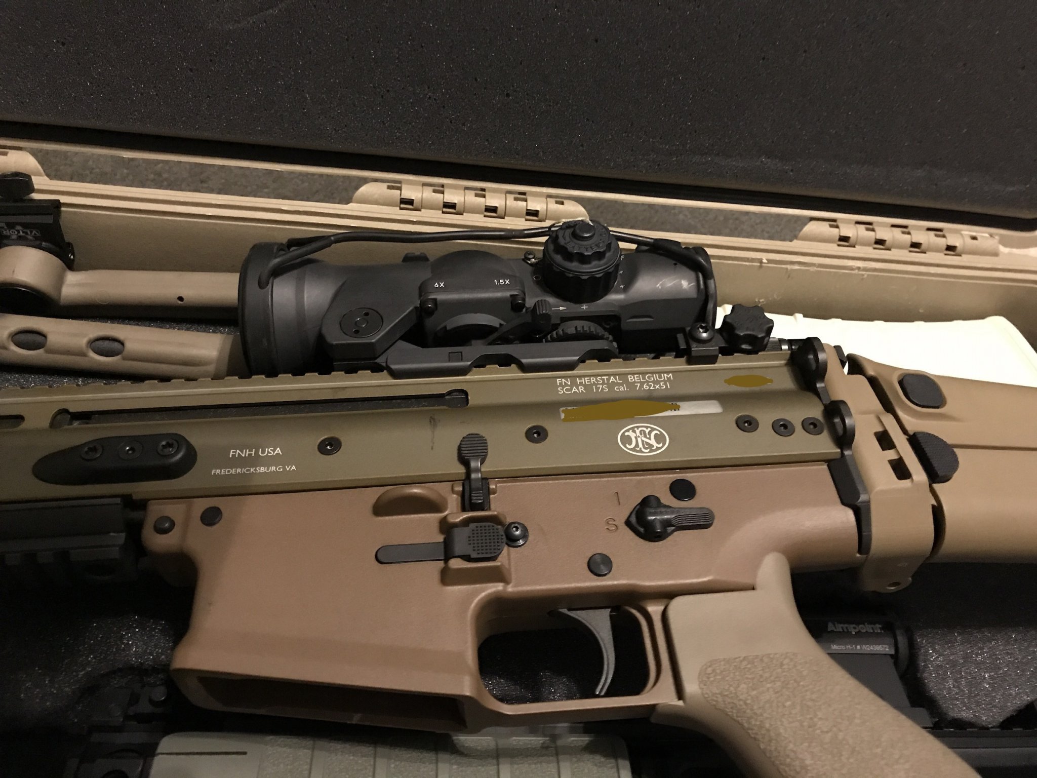

Never had an issue with mine...other than the mount itself. Still holds a zero and the optic has been great. I did realize that the stock flash suppressor is pretty brutal. The LANTAC Dragon is a softer shooting brake, IMHO.

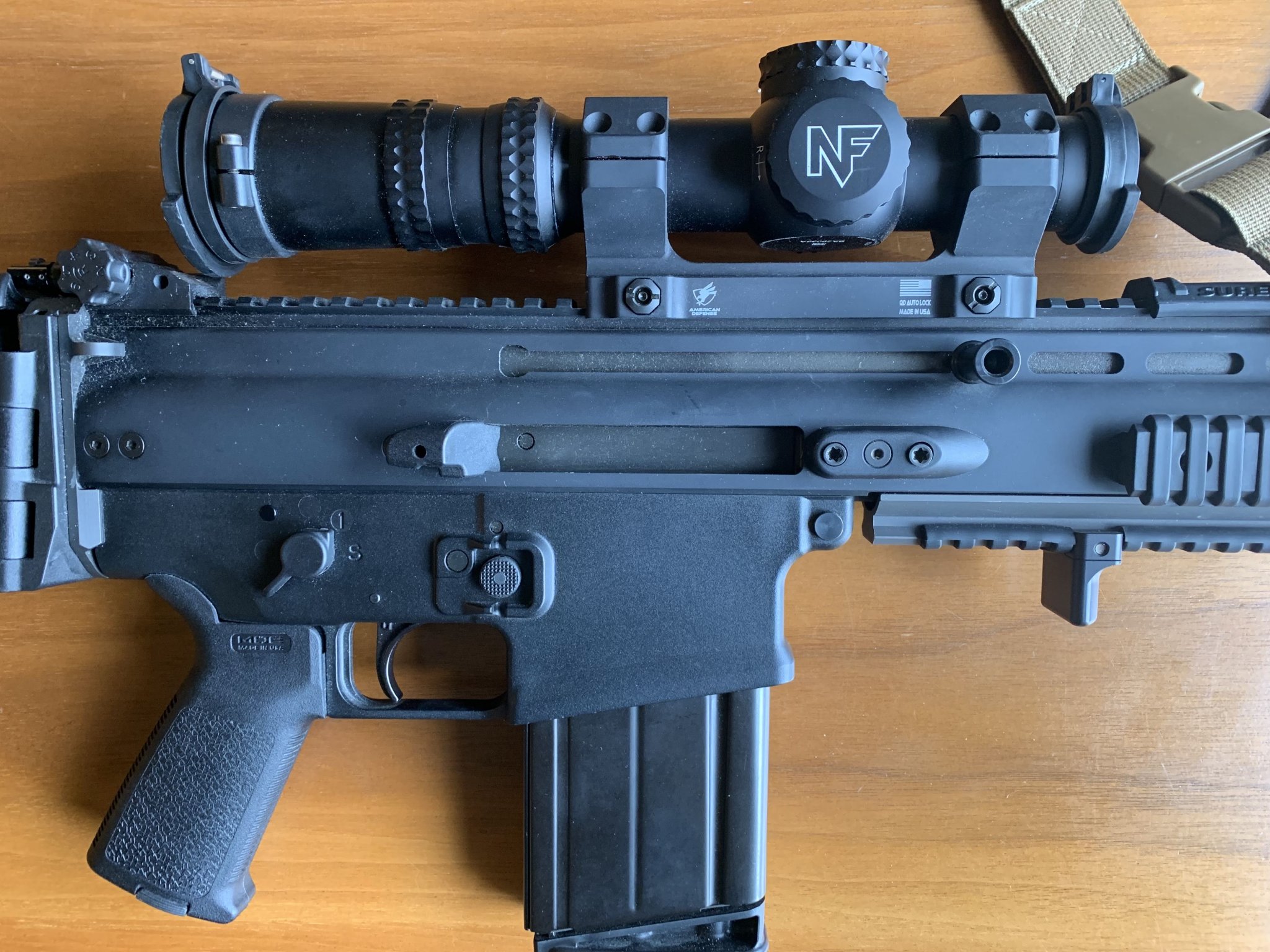

This is the first I’ve heard that they trash NF, Vortex Razor, or high-end Leupold (Mk5/6).
The optics that can take a beating have all the optical elements and modules epoxied into the tubes permanently, and use high quality gears/turrets.
There are scope mounts already on the market that were built specifically to add rigidity to the SCAR’s exuded aluminum receiver so that the combination of flex and resonant waveform harmonics don’t resonate as violently as they normally do.
The SCAR’s gas system length is the real challenge, as it was set to the short barrel configuration as the default, which also drove the length of the receiver/handguard length and gas system length on the 16” barrels too.
