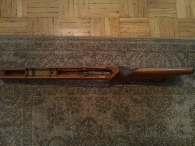

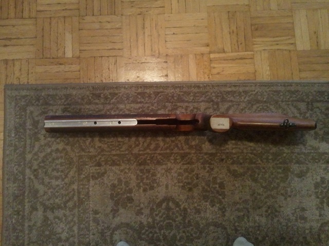

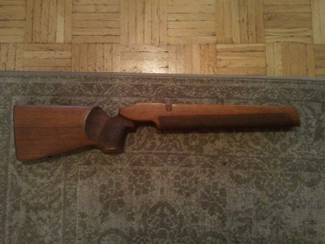

I have noticed that quite a many of you guys are interested in the finnish made Valmet 7.62 Tkiv 85 sniper rifle (7.62 Tkiv 85 - Wikipedia, the free encyclopedia) and yes you can not buy that gun from anywhere but what you can do is build your own. So where I'm going with this is that I currently have one 7.62 Tkiv-85 stock in my hands that I could sell if someone would like to build their own Tkiv-85.
P.s I might be able to get more through my contacts.
Contact me if interested.
