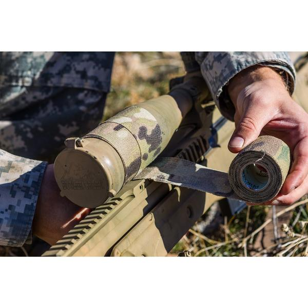

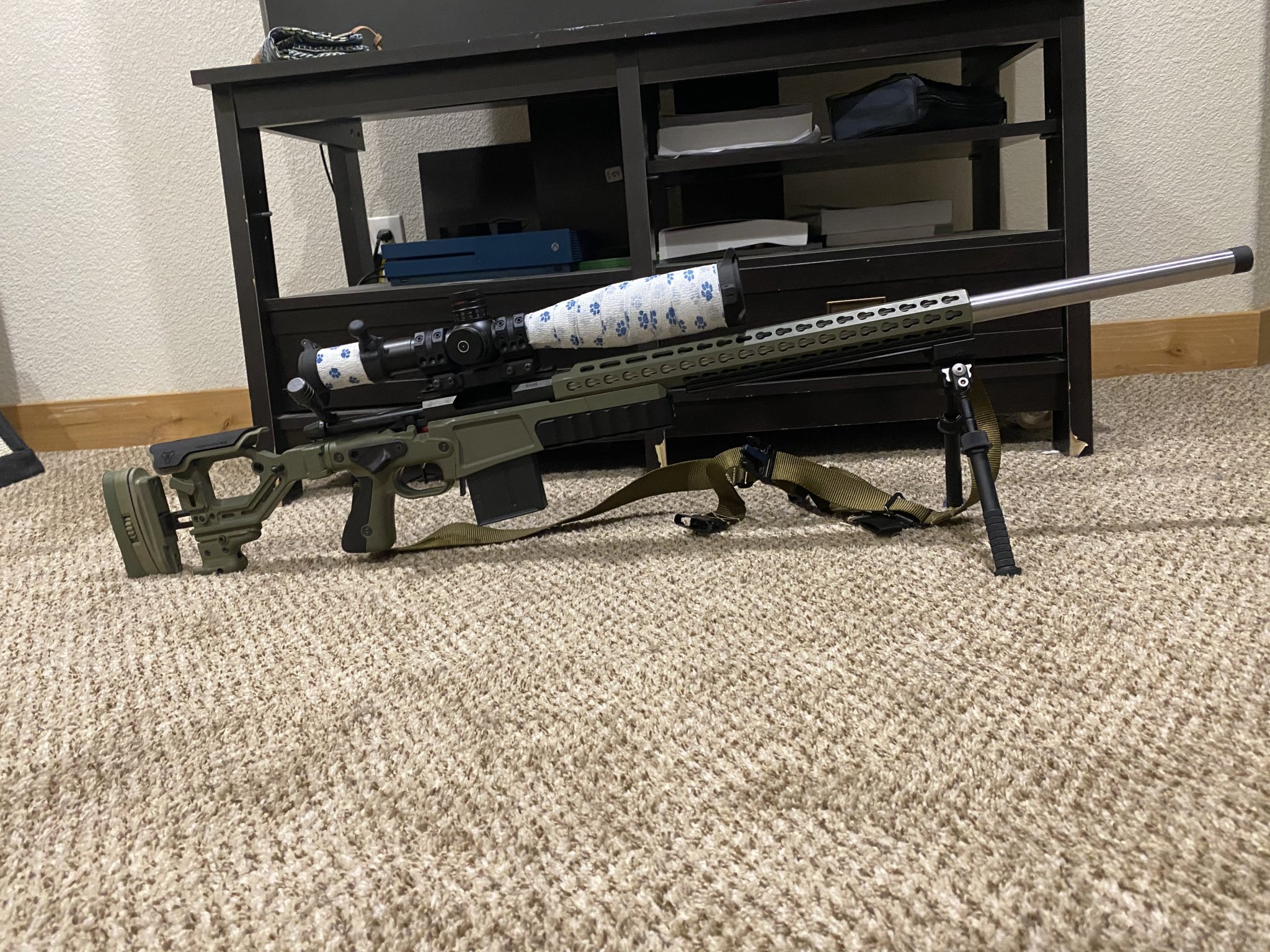

    Yep, self-adhering medical tape in the color you like. Don’t do the tube under the rings. Mount scope first, then wrap.
    Do NOT be one of those that use skateboard tape. That stuff will tear your hands up.
    last i used was sports tape (hockey/lacross stuff) and then sprayed it with krylon.
    peel it off and change colors etc.
    went hunting in canada, taped up scope and sprayed it white with some gray stripes.
    got home and peeled it off
    Reactions: Krazy_jim
